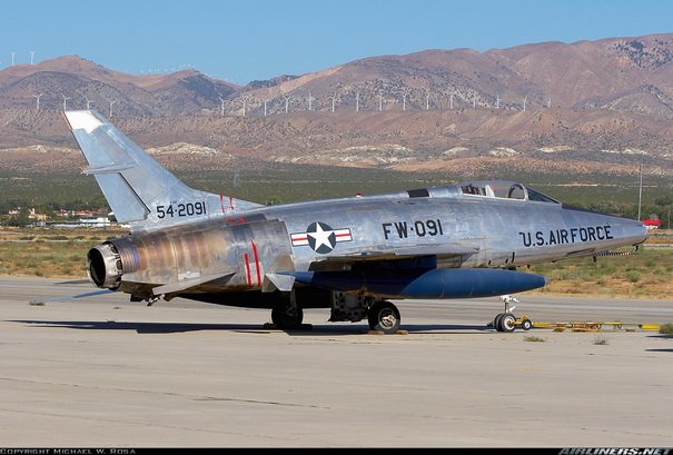

Bobo1953 Posted February 3, 2019 Author Share Posted February 3, 2019 dear ed and airmechaja. the picture attached was the stronger basis on which i decided for the type of burner you call 102. actually, i'm a bit of a perfectionist about philology, but i'm not really an expert, then i might well have misinterpreted this pic and the few others that now, for me, would need a whole afternoon of net surfing to find them back. i thank you for your keen and kind attention. if you'll feel like that, a comment on the picture accluded will be very welcome. tia. my very best ciaos...and happy modeling... yours, bobo. Quote Link to post Share on other sites
airmechaja Posted February 3, 2019 Share Posted February 3, 2019 Bobo, You did not misinterpret the picture. It does have the F-102 type exhaust installed. That picture was taken in 2005 in Mojave, California. It was with the Turkish Air Force in 1973. Hard to tell when the exhaust was replaced. The plane has been restored and is now at a museum in Chino, California. Quote Link to post Share on other sites
TheRealMrEd Posted February 4, 2019 Share Posted February 4, 2019 Hi Bobo-- A check over at the serial number repository Here: reads as follows: "2091 (MSN 217-352) was with 435th TFS Jul 1956. To MASDC Dec 6, 1971. To Turkish AF Jan 8, 1973 as 54-2091, code 3-091. Returned to USA Aug 1989. Registered to Tracor Flight Systems Jul 1989 as N2011M. To Global Aerosapce May 1992. To Albert Hansen of Mojave, CA as N2011M Sep 9, 1998. Now with Yanks Air Museum, Chino, CA." The Turks and other forces used them after 1973, just NOT the regular USAF. Ed Quote Link to post Share on other sites

Bobo1953 Posted February 4, 2019 Author Share Posted February 4, 2019 and no argument intended...just, your answers were so sharp that it loked like i was challenging you with my pic. speaking of which, not to contradict you, or show a hard head, but to satisfy completely my curiosity, i have found another pic that inspired my choice. please find it atached herebelow. naturally, comments are mostwelcome. thank you again fo your attention and your appreciating my hun all notwithstanding... great ciaos, and happy modeling! Quote Link to post Share on other sites
