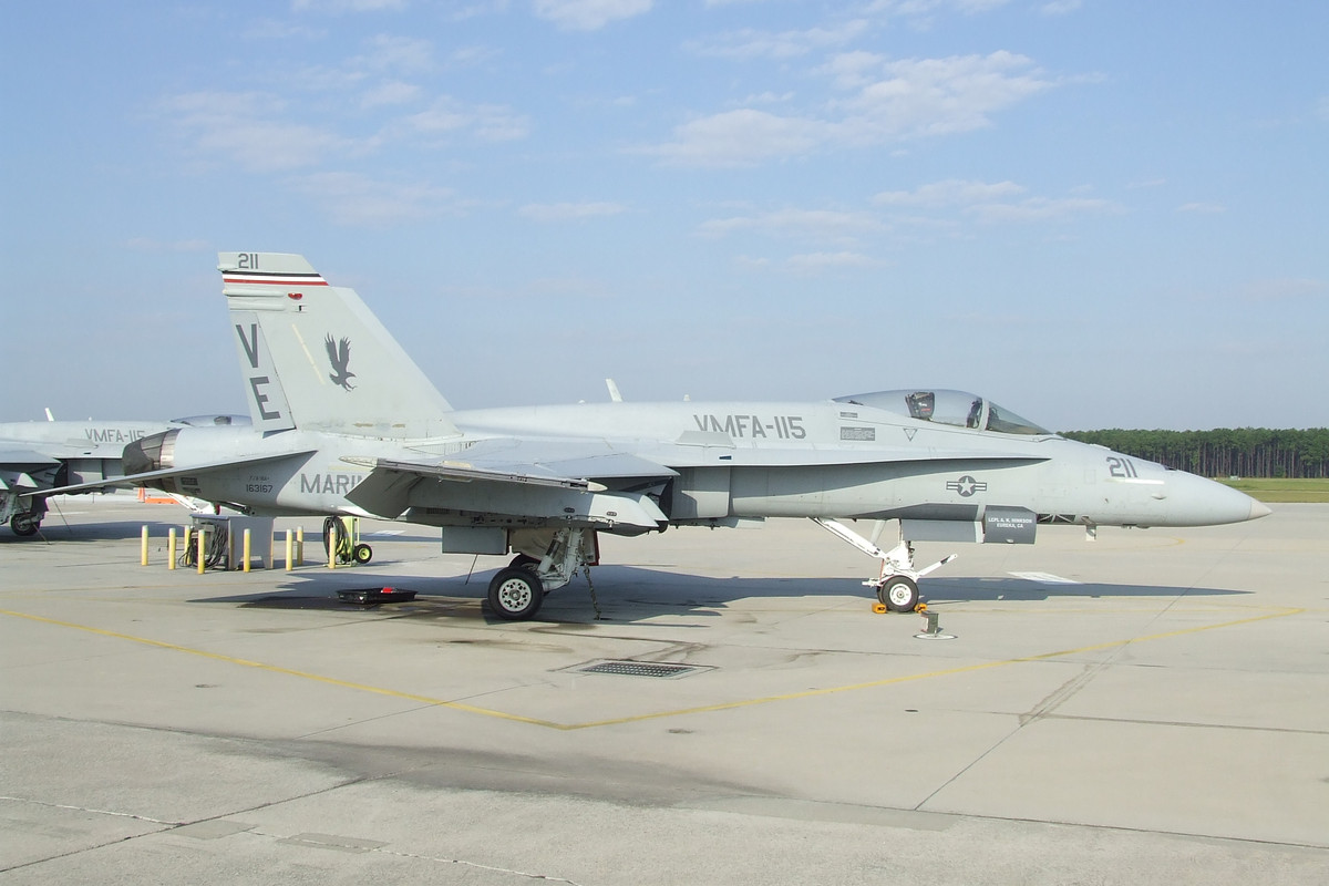

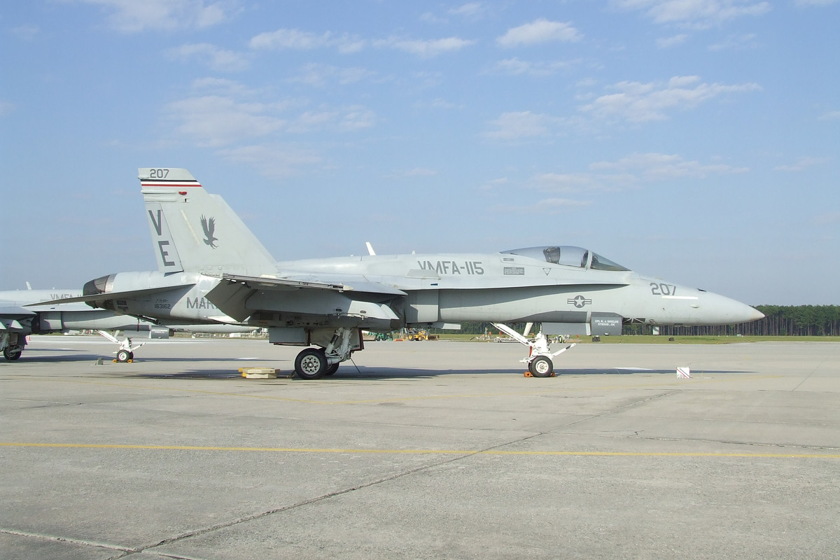

Mustang381 Posted March 15, 2024 Share Posted March 15, 2024 (edited) Hello dear friends, I have Kinetic F/A-18C kit from Gold series,box "Royal Maces". And I don't like paint scheme in the box, but I could not get other box of that kit.I want to make representation of aircraft that flown in VMFA-115 "Silver Eagles" Marines. I have buyed fantastic set of decals from Flying Leathernecks and there is paint scheme for two aicrafts from that Marine sq. VMFA-115. I like that blue,white and red line on vertical stabilazers and shadows profile of eagle too.But in instruction manual of decals says that there is specific markings for F/A-18A+ variant. Also, I have Eduards brassin SJU-17, but there is written that this specific two aircrafts from the set had SJU-5/6. Question for experts is: 1.) Can I make A+ variant from C variant, and did these aircrafts eventualy get SJU-17? 2.) Would it be wrong to make them with that ejection seat, and does cockpit of C variant can be used to present A+ variant? 3.) Did airframe had any deferences betwean these two variants etc... ? 4.) Can I use exact markings and serial numbers, 163167 and 163162, from that set to present aircraft who had eventualy SJU-17? 5.) Do, Marine F/A-18A/C have stencils on pylons?If do, who makes them in 1/48, and where to buy them.Kinetic kit is naked gun, so one needs a lot of money to make decent kit. Thank you in advance. Edited March 16, 2024 by Mustang381 Quote Link to post Share on other sites

Dave Roof Posted March 18, 2024 Share Posted March 18, 2024 Instrument panel and exterior details would be the same as that found on an F/A-18A. GPS Dome, swept back upper and lower UHF/VHF antenna, AN/APX-111 antenna on nose, SJU-5/6 Both aircraft, 163167 and 163162, got upgraded to F/A-18A++ and got the SJU-17, but several years after their OIF deployment (which the markings on the decal sheet depict) Quote Link to post Share on other sites
