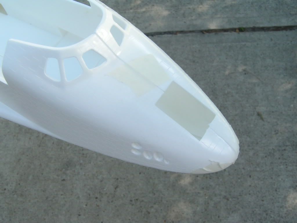

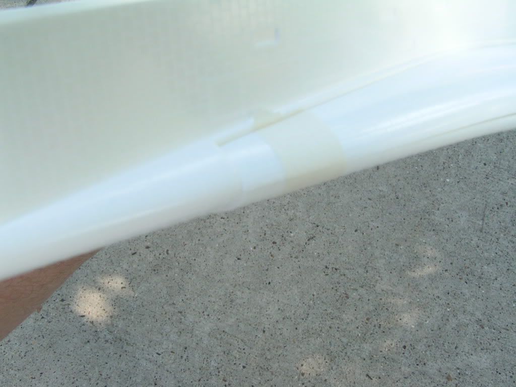

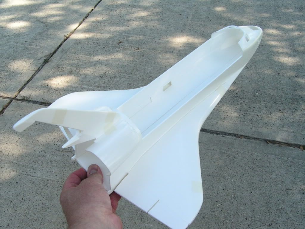

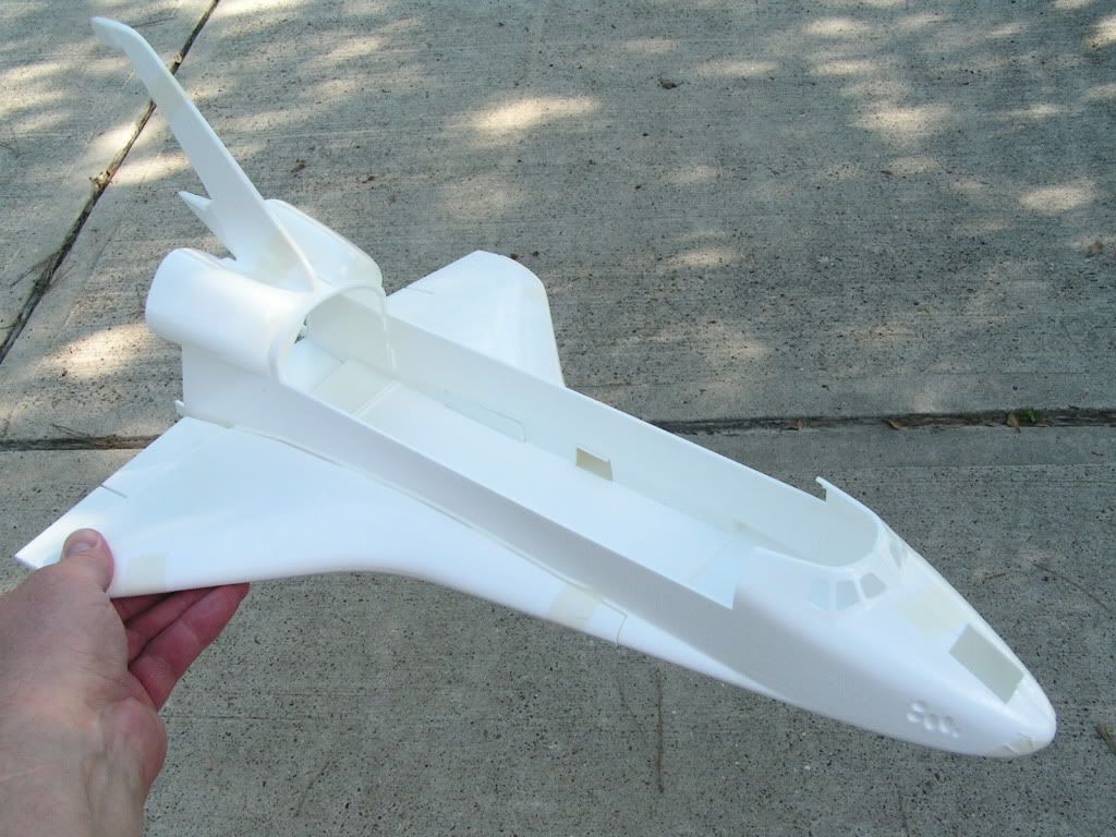

MasterJedi Posted September 22, 2010 Author Share Posted September 22, 2010 Pulled some of the larger parts for dryfitting. Just removed the sprues and trimmed, no sanding of the mating surfaces, and the major sections com together pretty darn good. Some of the nightmares might have been averted. I purchased the Shuttle decal set from Ed and it looks really nice. I going to weather this one up, gear up, in prep for the stack. Right now those kits are going for insane money and I don't know why, is there all of the sudden a ton of interest in the orbiter system? The real pain in the tail (hands to be exact) is going to be sanding all of this raised detail off the entire spacecraft! I was thinking I might rebuild the reaction control nozzles with tube and such but it is more realistic to have them covered for prep to flight than open, saves time too. Now I just need to find a way to reaplicate those thermal blankets. I have recently seen a builder of paper models (unreal stuff) that uses tissue papers for the various textures, I think I can get away with it on 1/72 but not 1/144. Gonna have to practice a bit. Randy Quote Link to post Share on other sites

Jay Chladek Posted September 24, 2010 Share Posted September 24, 2010 (edited) Nice work so far Randy. Most of the fit problems will likely crop up when the internals go into the model. I am pretty certain it was the cockpit interior that was the culprit on the last two Revell shuttles I did. So if you can engineer it so it falls in AFTER the fuselage is glued, I think you will end up with better fit. I've also heard of some modelers having problems in the previous Revell USA pressings with tail warpage, but Revell of Germany seems to use slightly softer plastics then what Revell USA does, so that will hopefully benefit this project in being able to massage pieces into place. The availability of the full stack shuttles has been crazy ever since Columbia burned up. Prior to 1999 when Revell Monogram reissued the kit as an SSP, I didn't even know they existed as I never saw them for sale at retail where I was (and the Star Realm shop in LaVista, NE was known for getting ANYTHING either SF or real space related in the 1980s before it closed shop). I finally did locate one from a local club member and we negotiated a fair price for it (I had to resin cast a couple replacement parts though). The SSP reissue made them available again and demand was okay, but not great. At the LHS I worked for until 2000, we had a couple sitting on the shelf for almost a year, but they finally did sell. When 2003 rolled around and STS-107 failed to return to Earth, demand spiked a bit (and so did the prices), then leveled off for the next year or so. I was able to obtain a complete SSP reissue from a vendor at the Oklahoma city Nationals that year, but I knew if I had waited even an hour, it would likely have been gone. When it was announced that shuttle would be retired in 2010, demand began to go up for these again, starting with STS-114 and 121. I was still able to obtain a couple more examples with some lucky eBay scores, but the days of getting a 1/72 full shuttle stack for less then triple digits are likely gone unless somebody wants to offer one as trade. Usually the prices tend to be the highest around a flight, since then the shuttles are in the public consciousness and collectors think more about obtaining them. But as I said, I think the days of inexpensive 1/72 shuttle stack kits are over. Of course, Revell USA could help solve the problem if they were to reissue the kit again. At the KC Nationals in 2006, I talked to Ed Sexton and he mentioned they still had the tooling and it was still useable, but it wasn't all that likely it would get reissued, given it is a BIG mold (mainly the external tank). Of course, somebody next to me mentioned it wasn't really any bigger then the 1/72 GATO sub which came out that year and Ed conceded that point. There had been rumors circulating that Revell USA might repop the kit, but nothing has firmed up and Ed moved onto Academy a few years ago, so who knows WHO is in charge of kit selection. It could still get reissued, but considering the original plan for shuttle retirement was by the end of 2010, I would have expected it to be available again by now. Revell of Germany's reissue of the Revell 1/72 orbiter complicates things a little as Revell of Germany stuff for real space typically isn't imported if there is an equivalent Revell USA kit already on the market. For instance, the Revell of Germany 1/96 Saturn V, Apollo astronaut and 1/48 LM were not offered in the US because the Monogram kits of the 1/144 Saturn V and the Apollo 11 diorama in 1/48 were issued here. Only kit that did make it over was the 1/32 Apollo CSM. Since the Revell of Germany shuttle kits in 1/144 and 1/72 are being imported by Revell USA, I don't see it all that likely that Revell USA will offer the 1/72 full stack again. I've also heard rumblings that except for Revell of Germany tooled kits that can be reboxed by Revell USA (i.e. the Star Wars pre-painted snap kits), space subjects have not been kind to Revell USA's pocket book. So they are apparently reluctant to offer anything new if they have to bankroll it themselves. The one wildcard I can see in the whole thing would be if a third party like Stevens International were to put fourth the funding for a limited exclusive run of full stack shuttle kits. They did it for the Monogram Apollo kits about four years ago (my LHS still has an Apollo CSM as a shelf sitter from that production run). Given the size and nature of the kit though, I don't think it is going to fly off the shelves, even if it does come out. But that being said, Revell is still milking their 1/48 B-1B molds for all they are worth and that kit is also a monster. So I suppose it could still happen. If we don't hear about one coming out by the Ihobby show in Chicago next month, I won't hold my breath though as once the shuttle fleet retires, the chances for demand for such a kit among the general public will start to go down. If eBay and collections are the only source for these kits though, then I also anticipate those prices will start to drop as well once the shuttle leaves the public eye. As for me, I have enough full stacks to keep me happy. All are earmarked for builds with one in the workshop right now as a Moonraker stack and a second one intended to become STS-1 by next April (June at the latest). After doing two of them (Moonraker is 90% assembled), I've got the pitfalls of the kit pretty much down pat. My one stack on display at the Strategic Air and Space Museum still sits proudly in its display case. Technically it is still my model, but I know it is highly unlikely it will ever leave the museum again unless I have to repair something on it. Of course, if the kit does get reissued again, I will still likely add two more to the pile since I KNOW it will probably be the last time the kit ever gets produced again. And I can find things to do with them. Edited September 24, 2010 by Jay Chladek Quote Link to post Share on other sites
