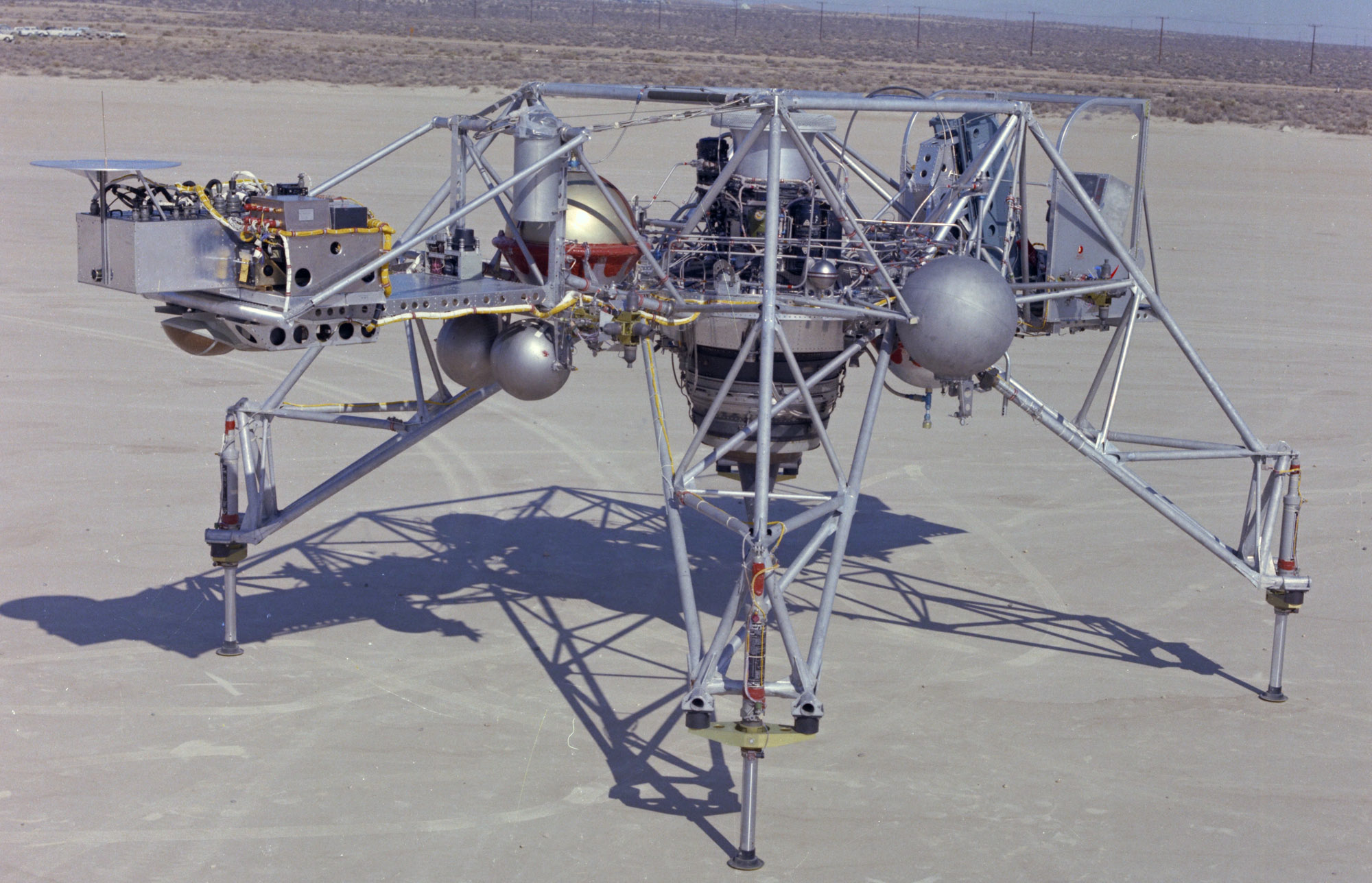

And X-Plane Fan ... thanx for the photos ... your generosity in sharing the archive pix on this thread, and others I must add, is really appreciated by us observers too!

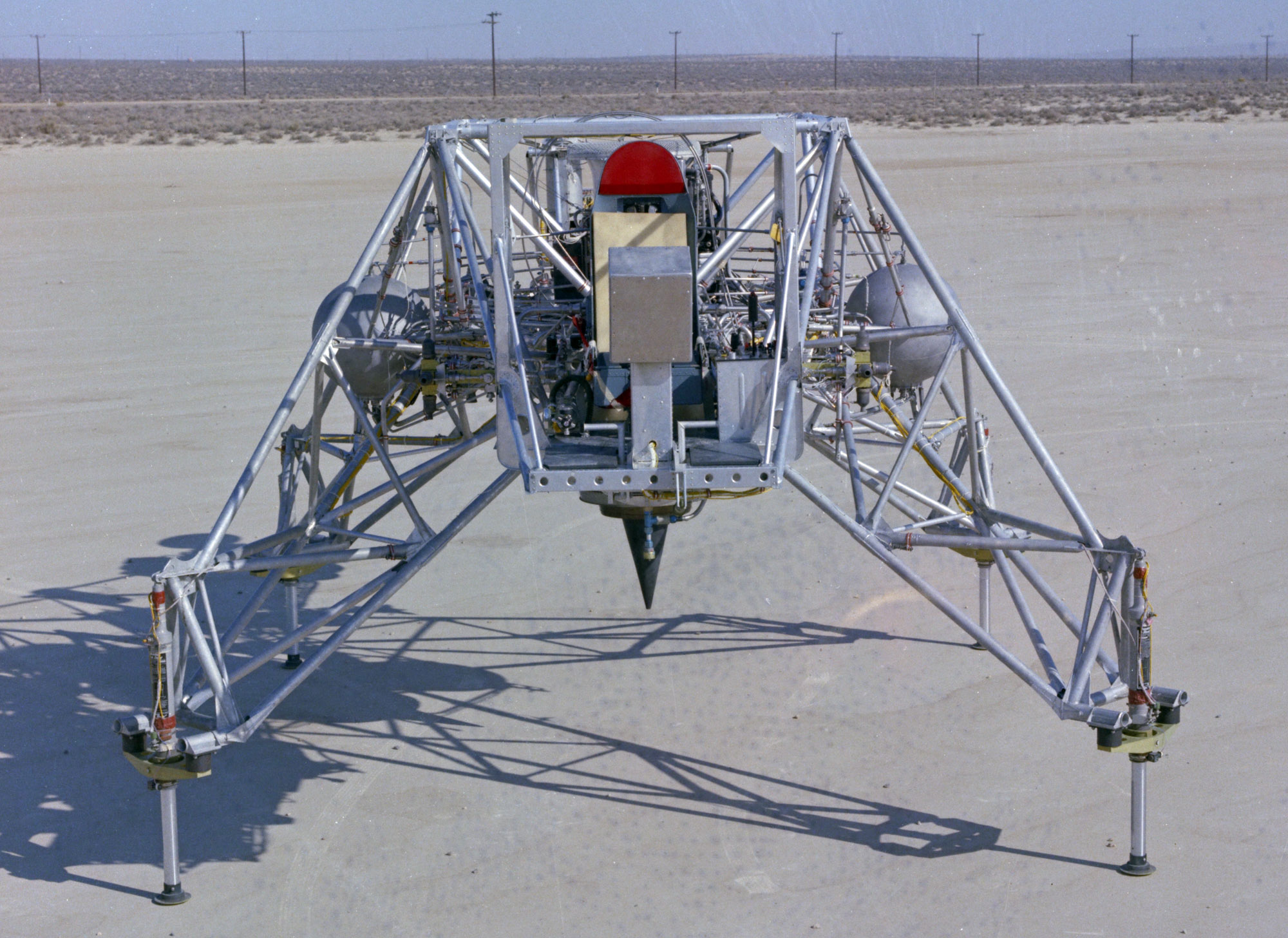

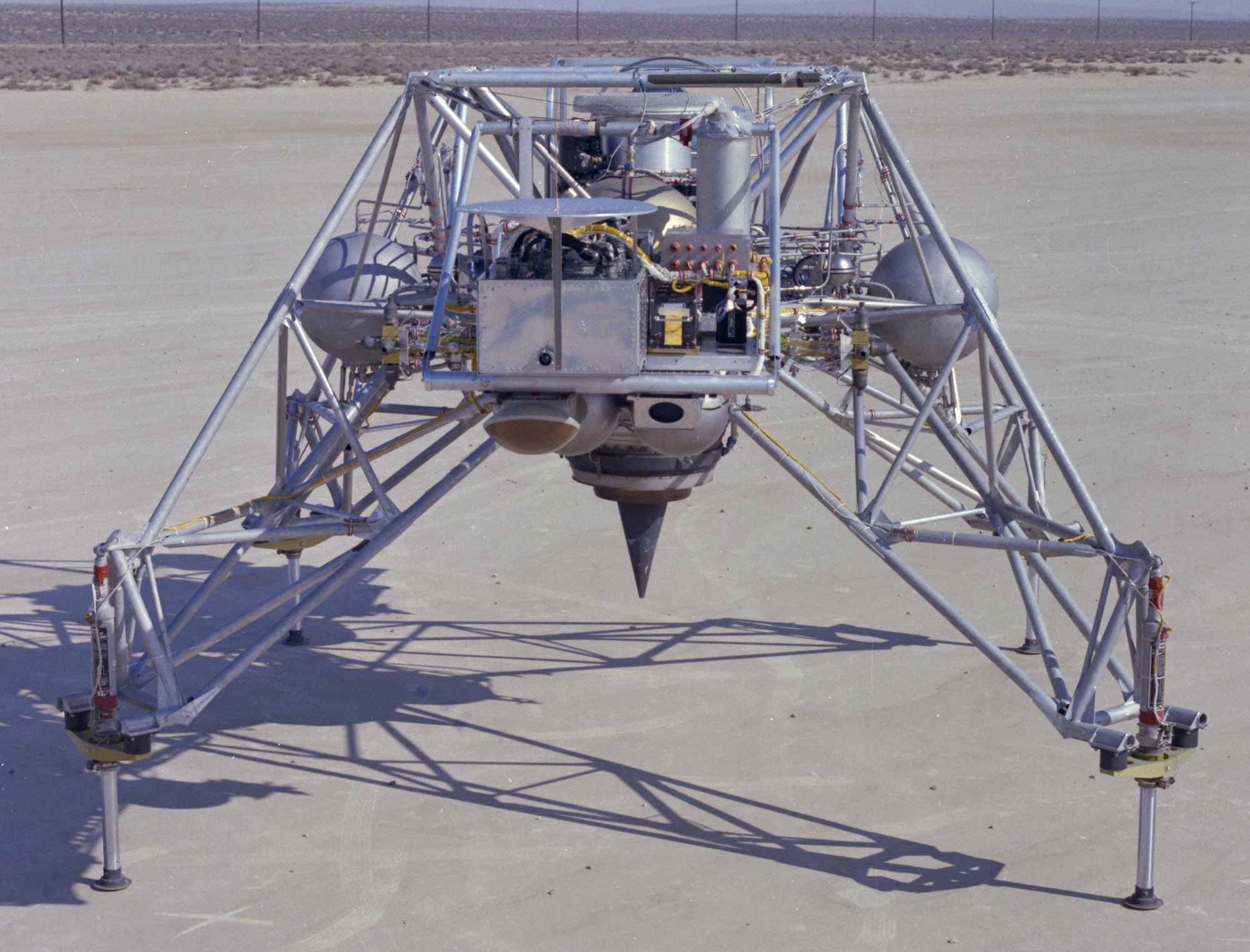

In other models that I've seen, the bulletnose/guide vanes/compressor face are close to the air intake opening, but it seems that this isn't really the case.
Any overlay I do brings them at a good distance from the intake opening.
This image shows an unpainted tank with that metal pouch. One can clearly see the openings.
It seems as if the openings have been filled with some red goop?

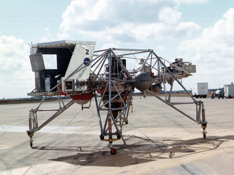

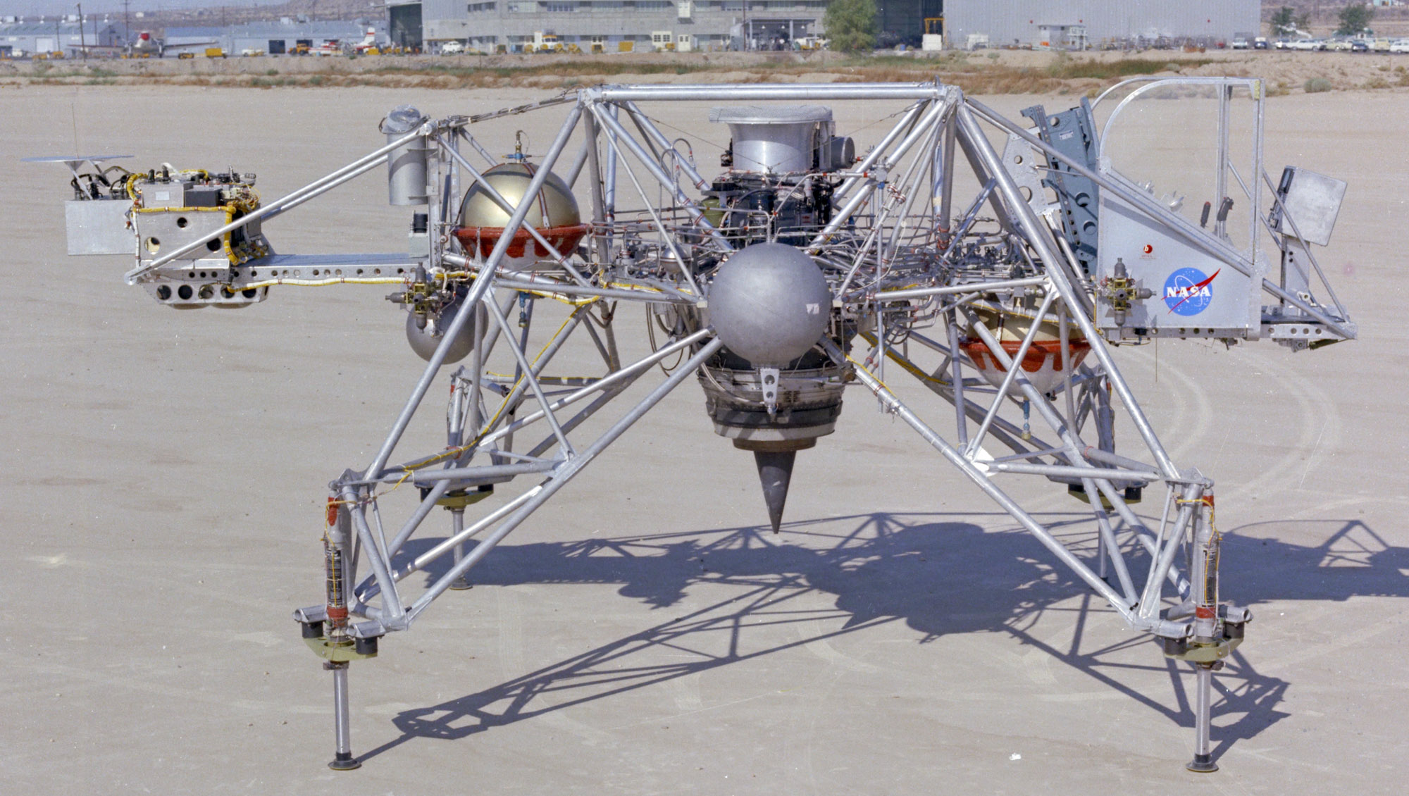

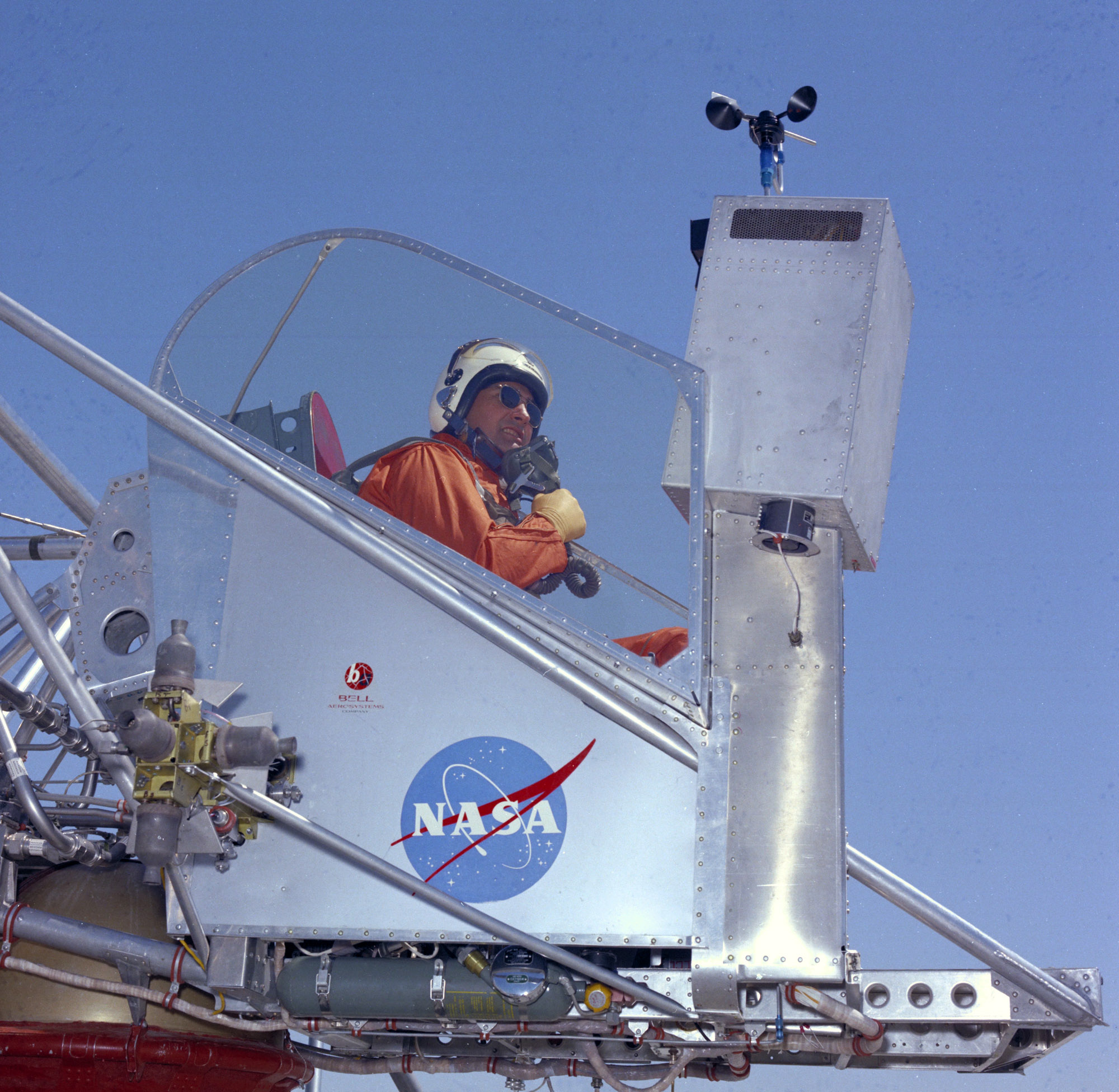

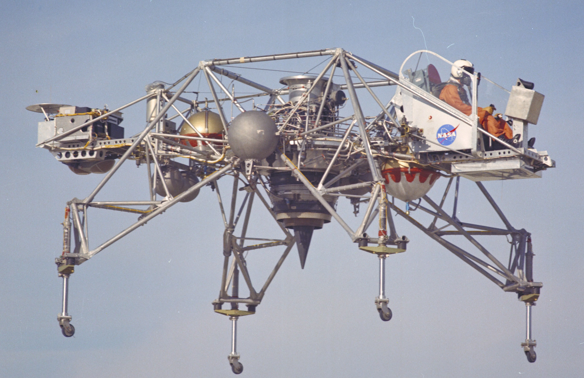

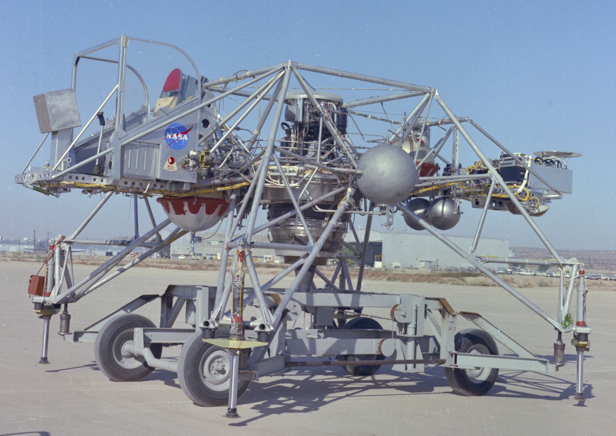

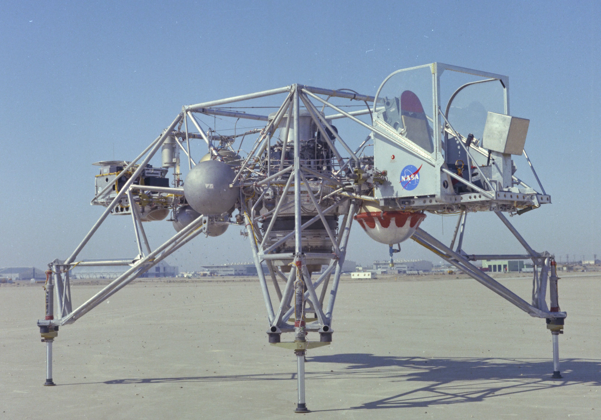

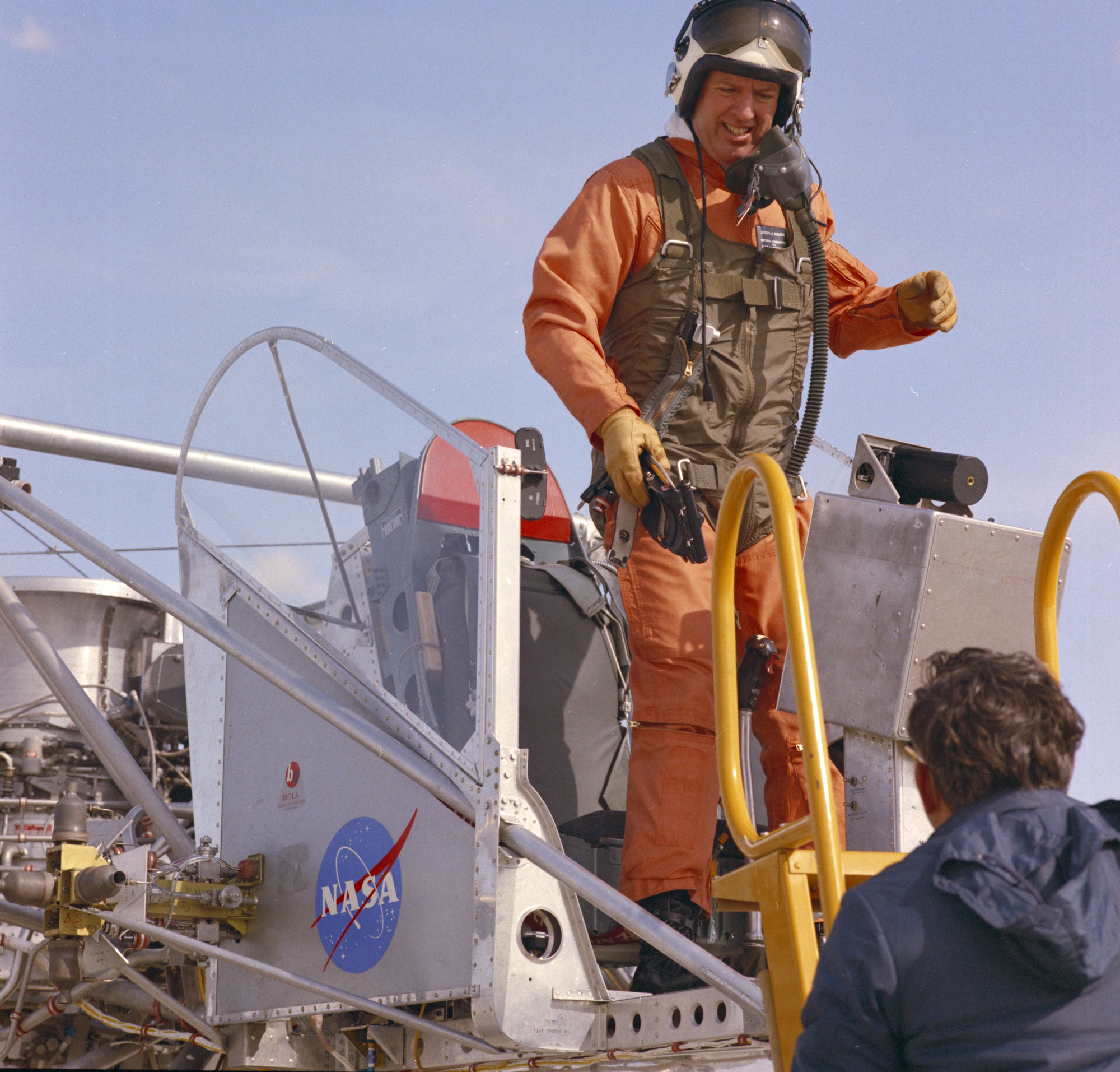

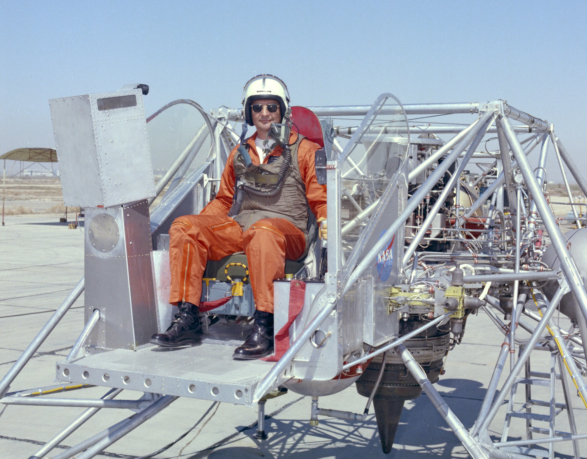

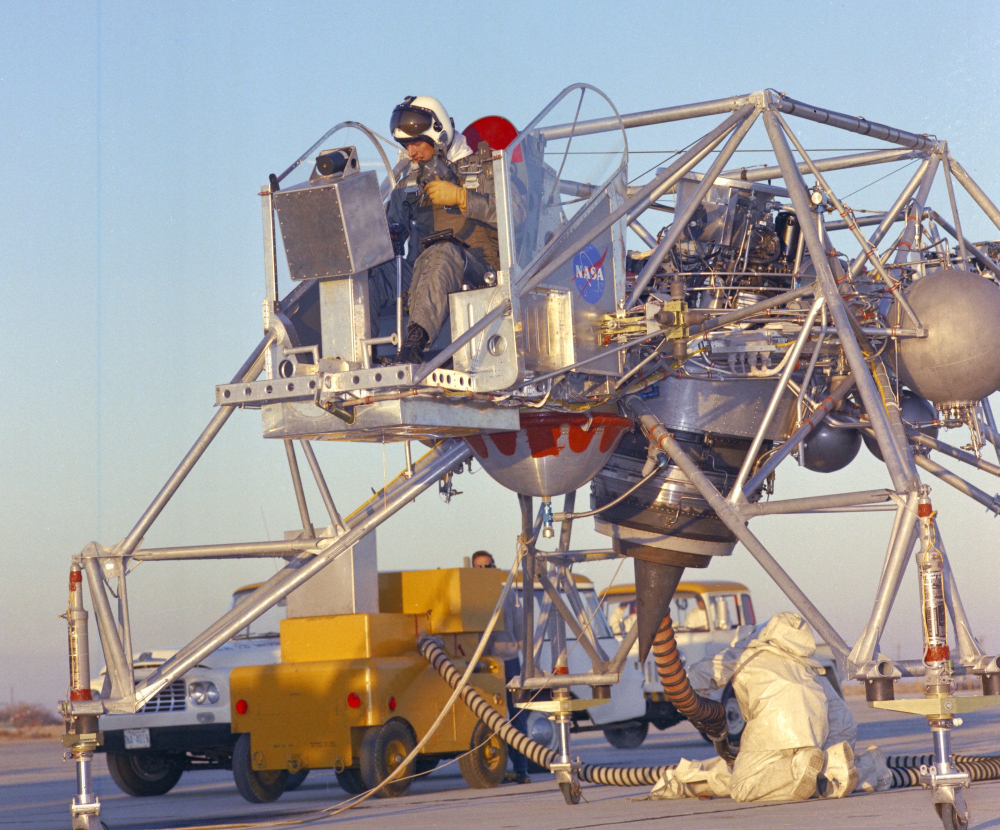

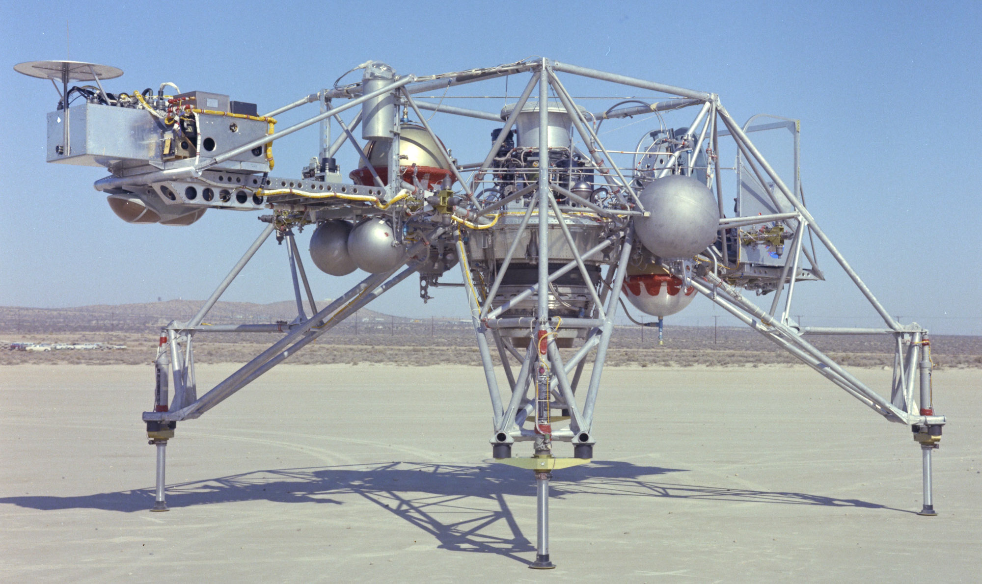

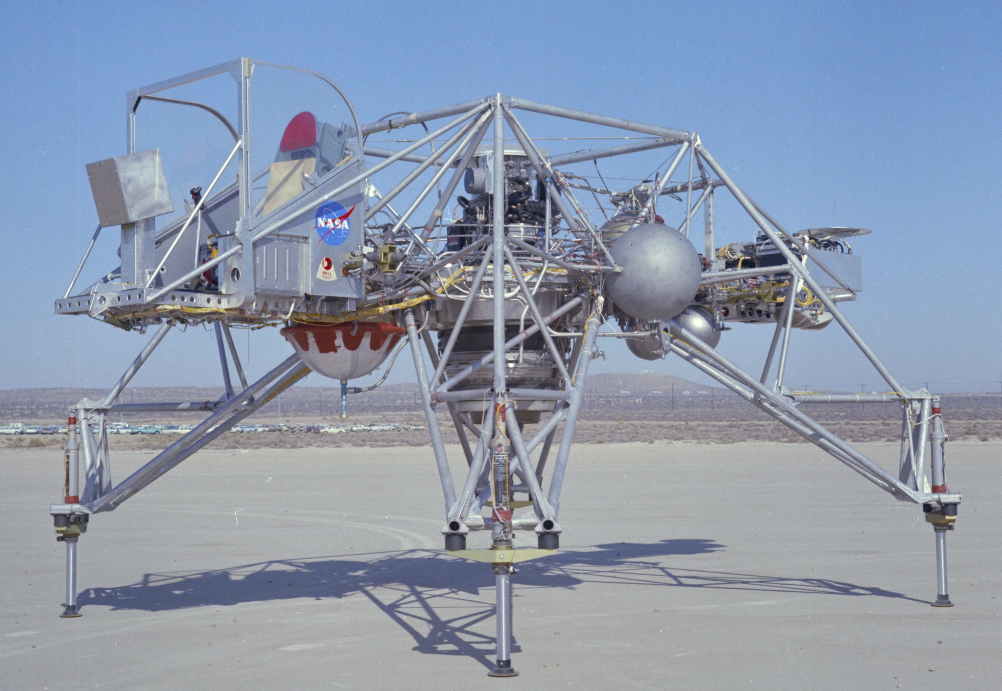

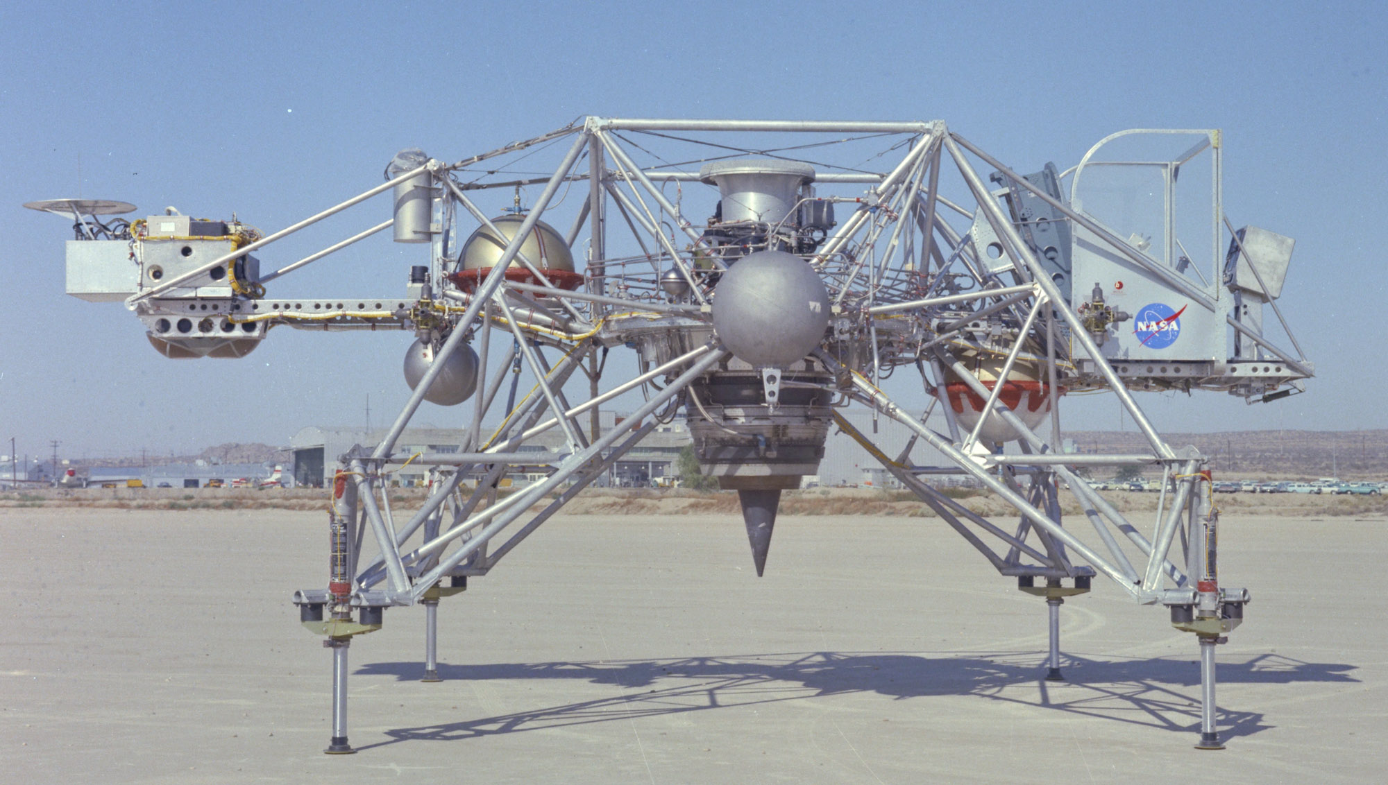

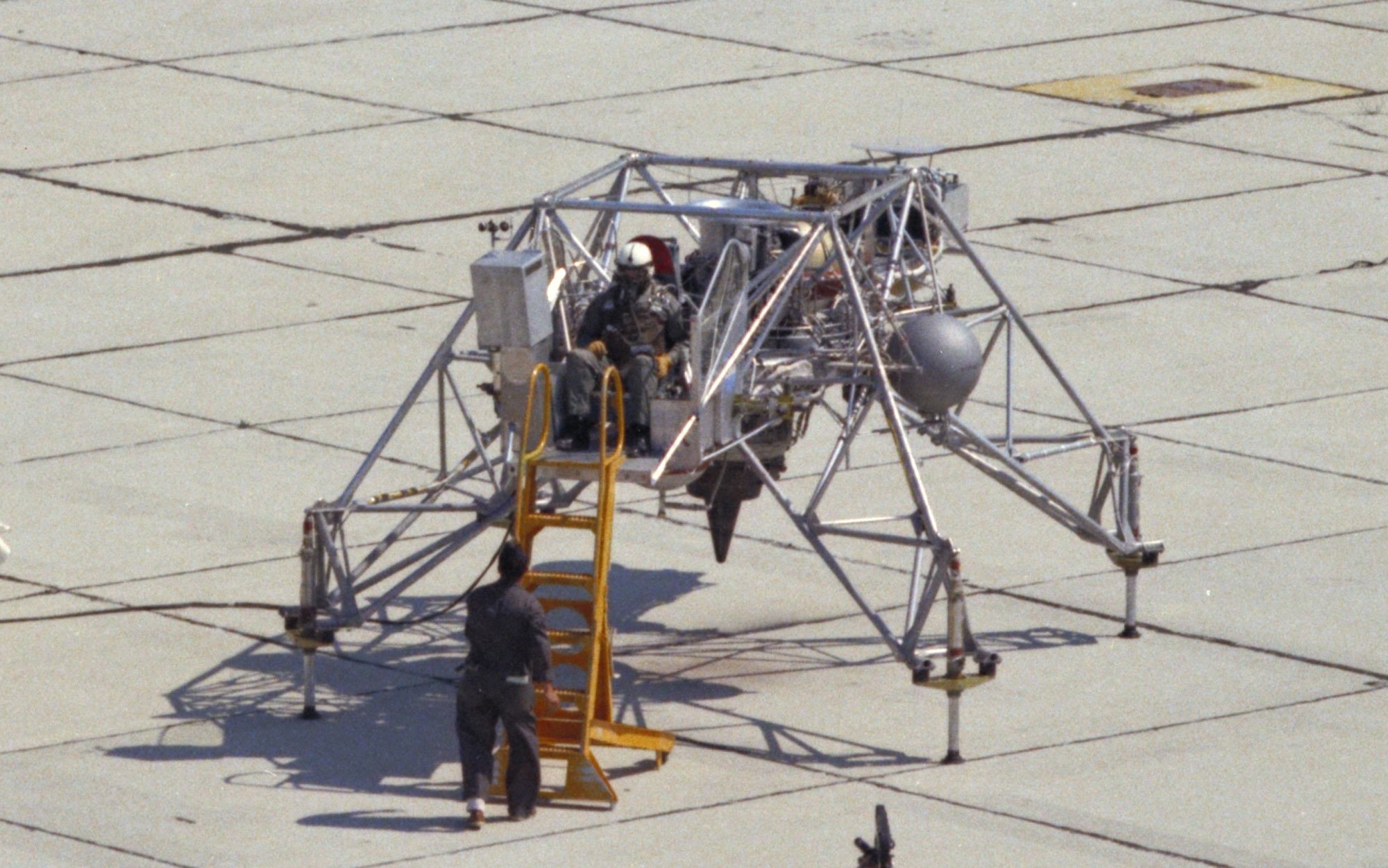

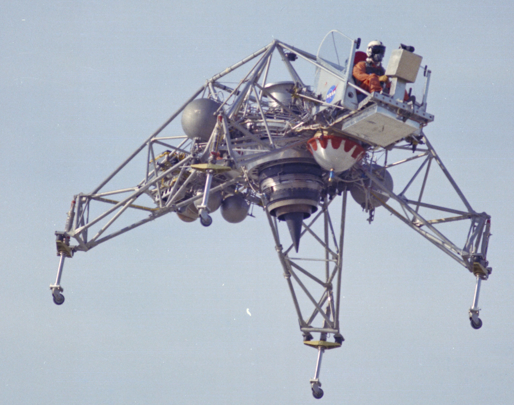

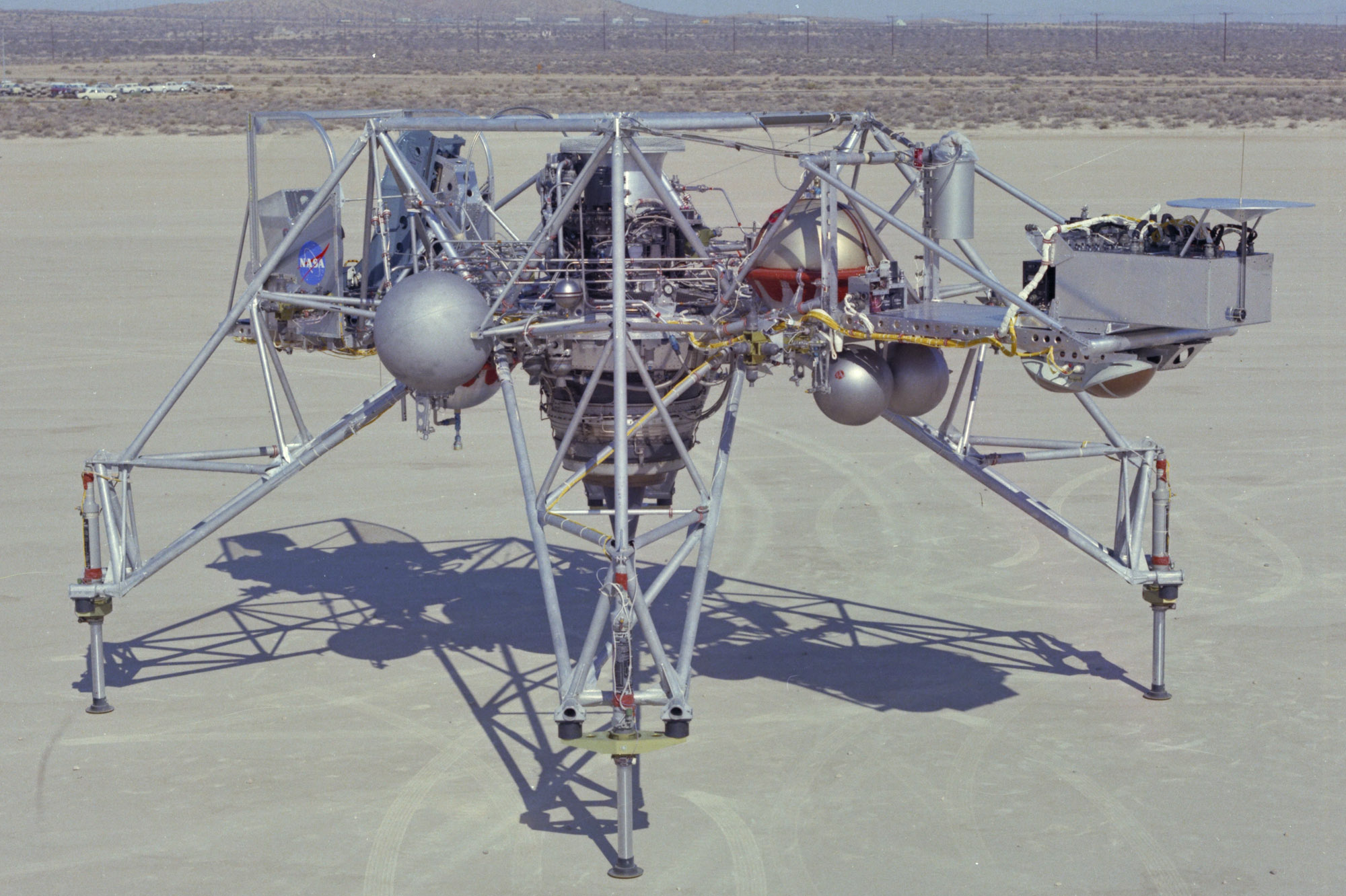

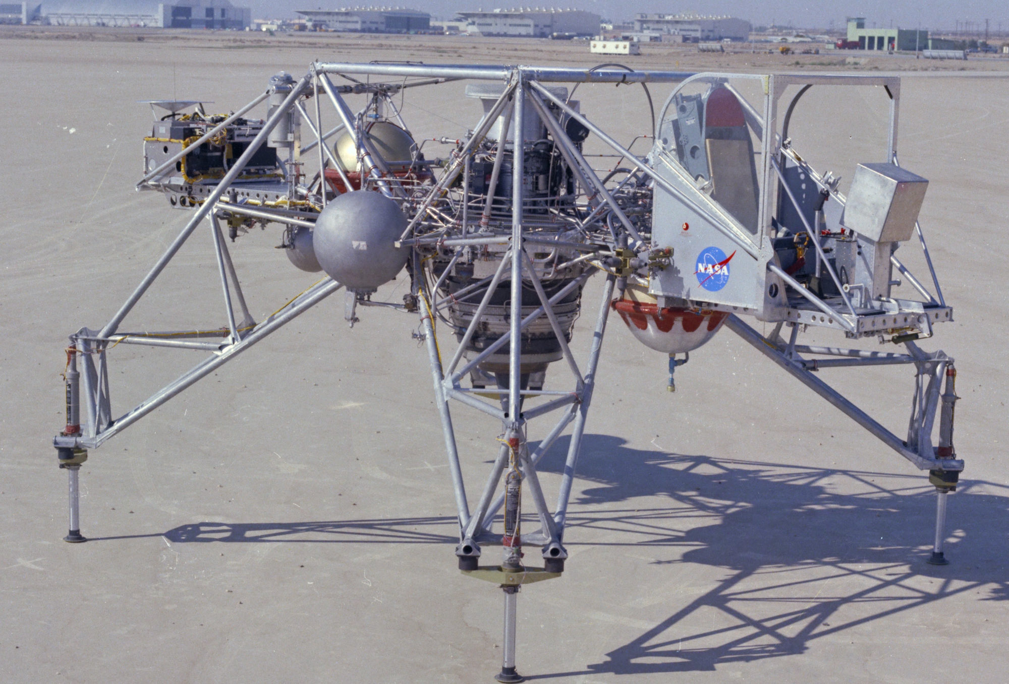

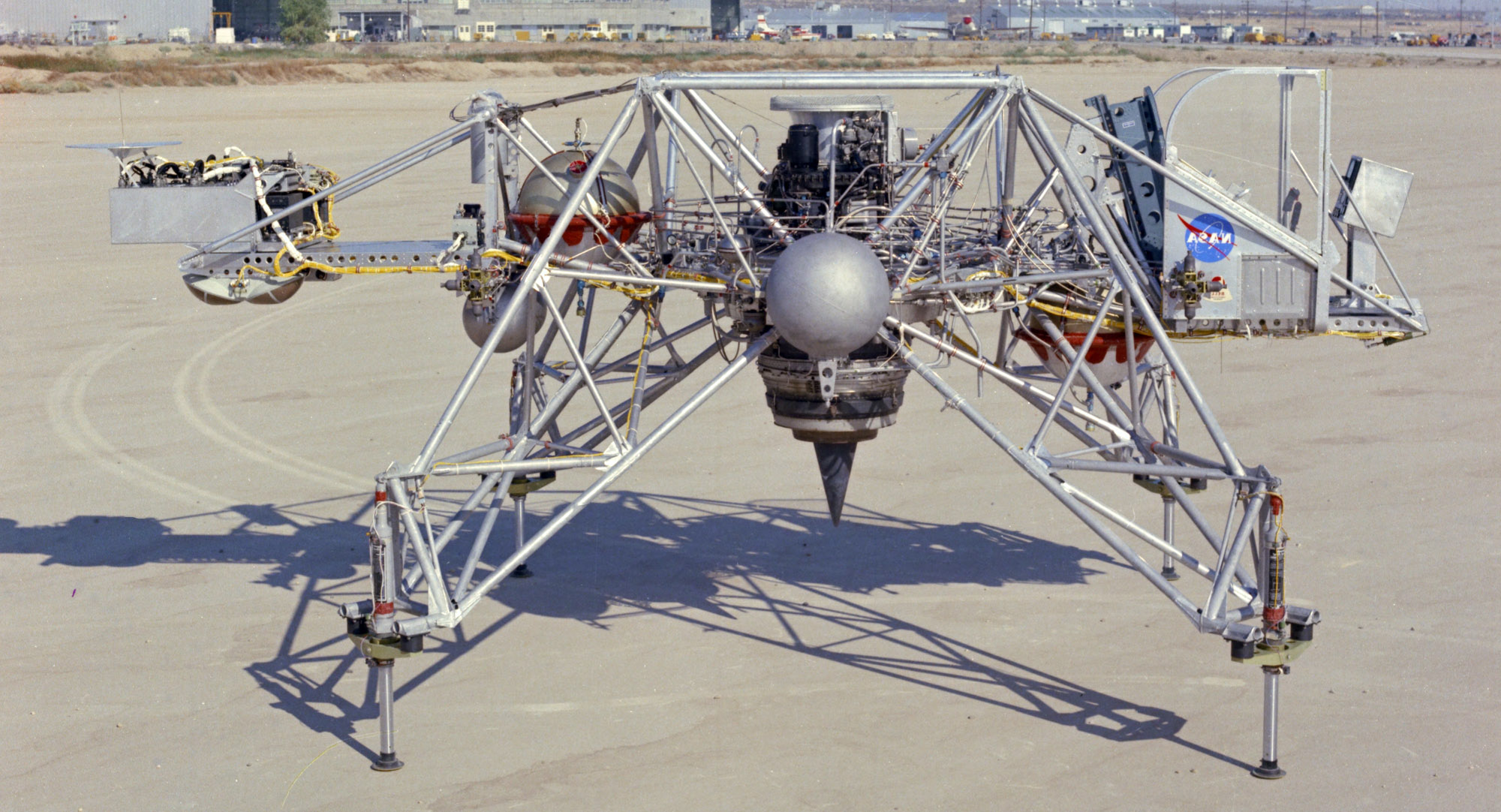

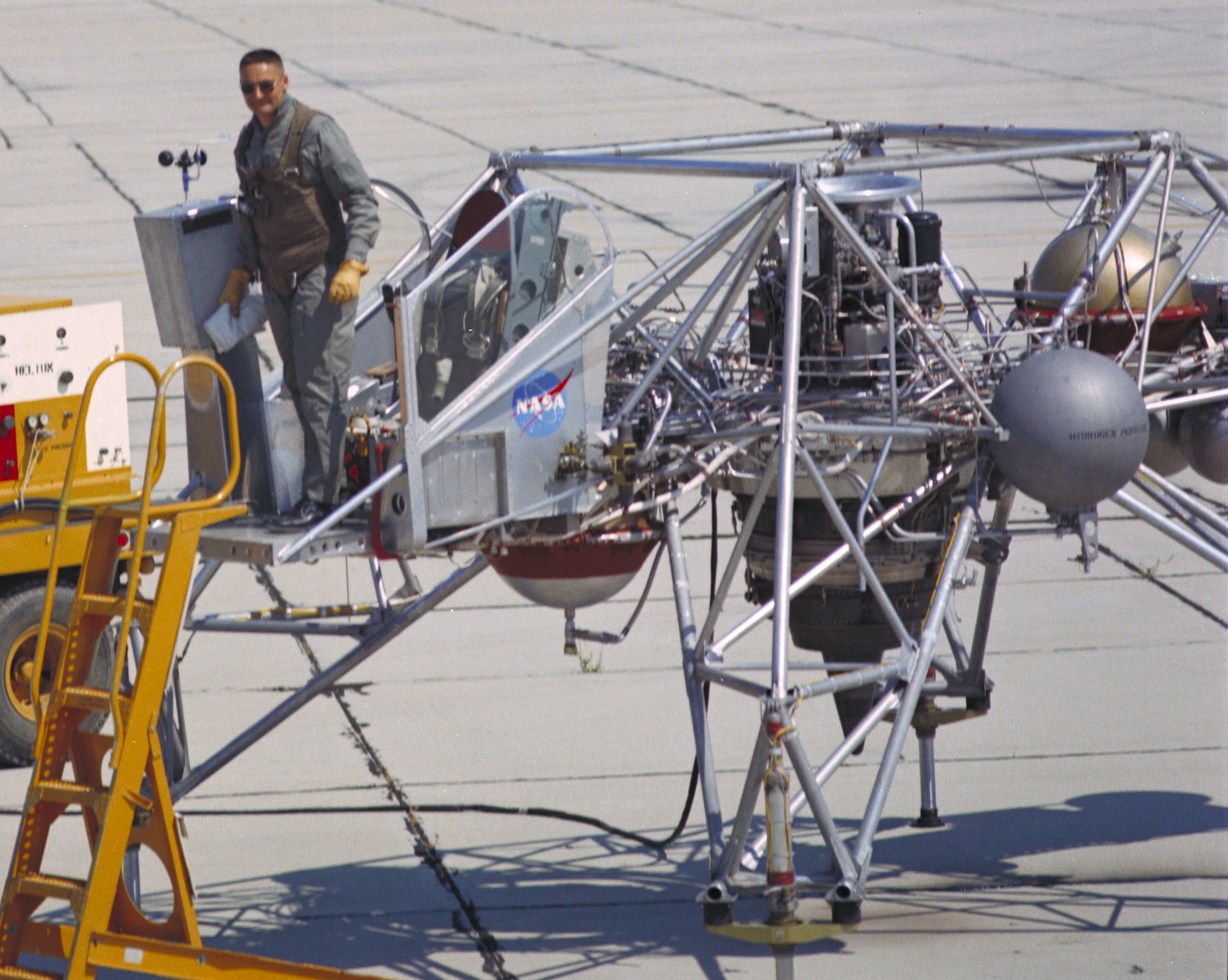

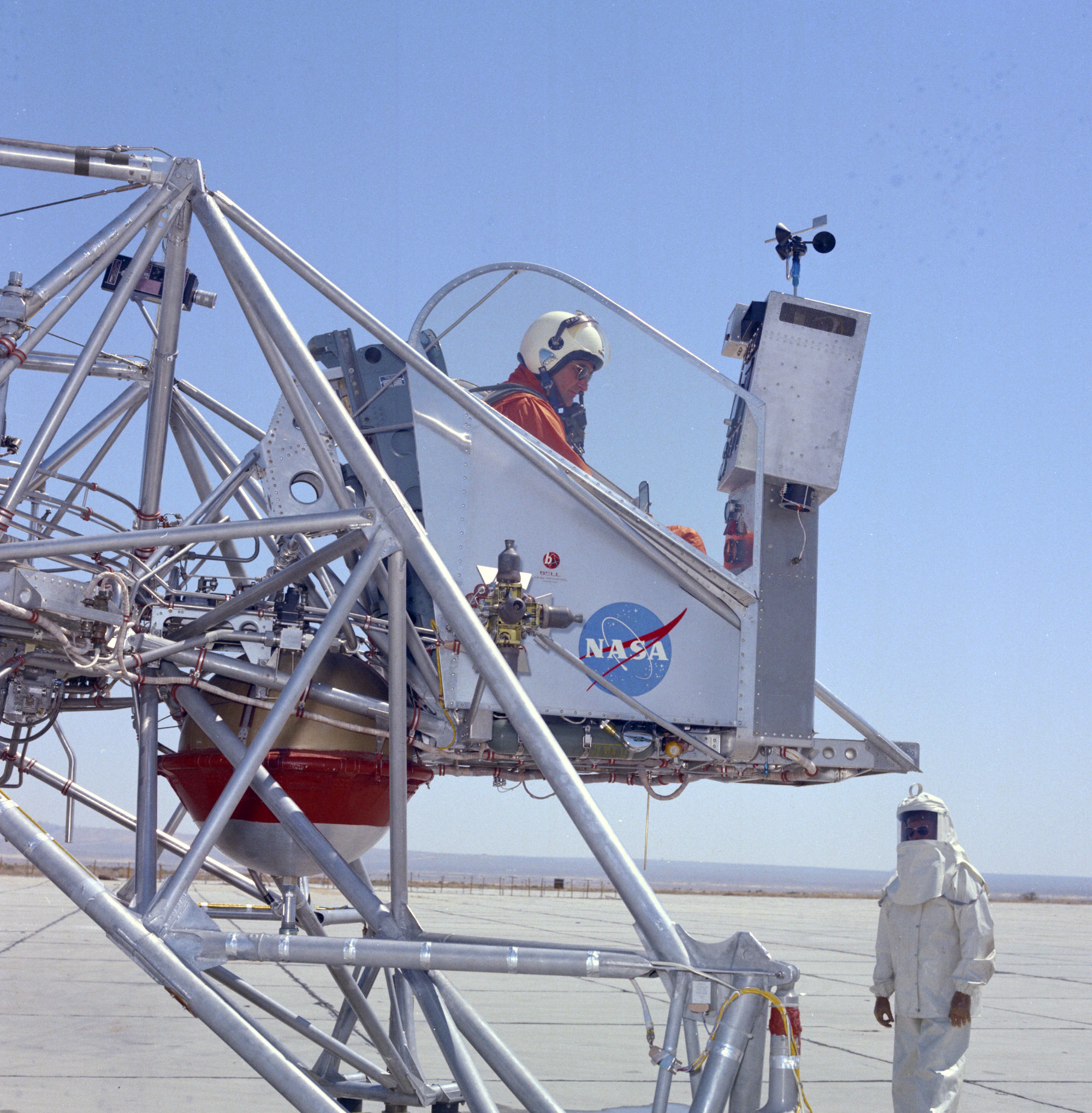

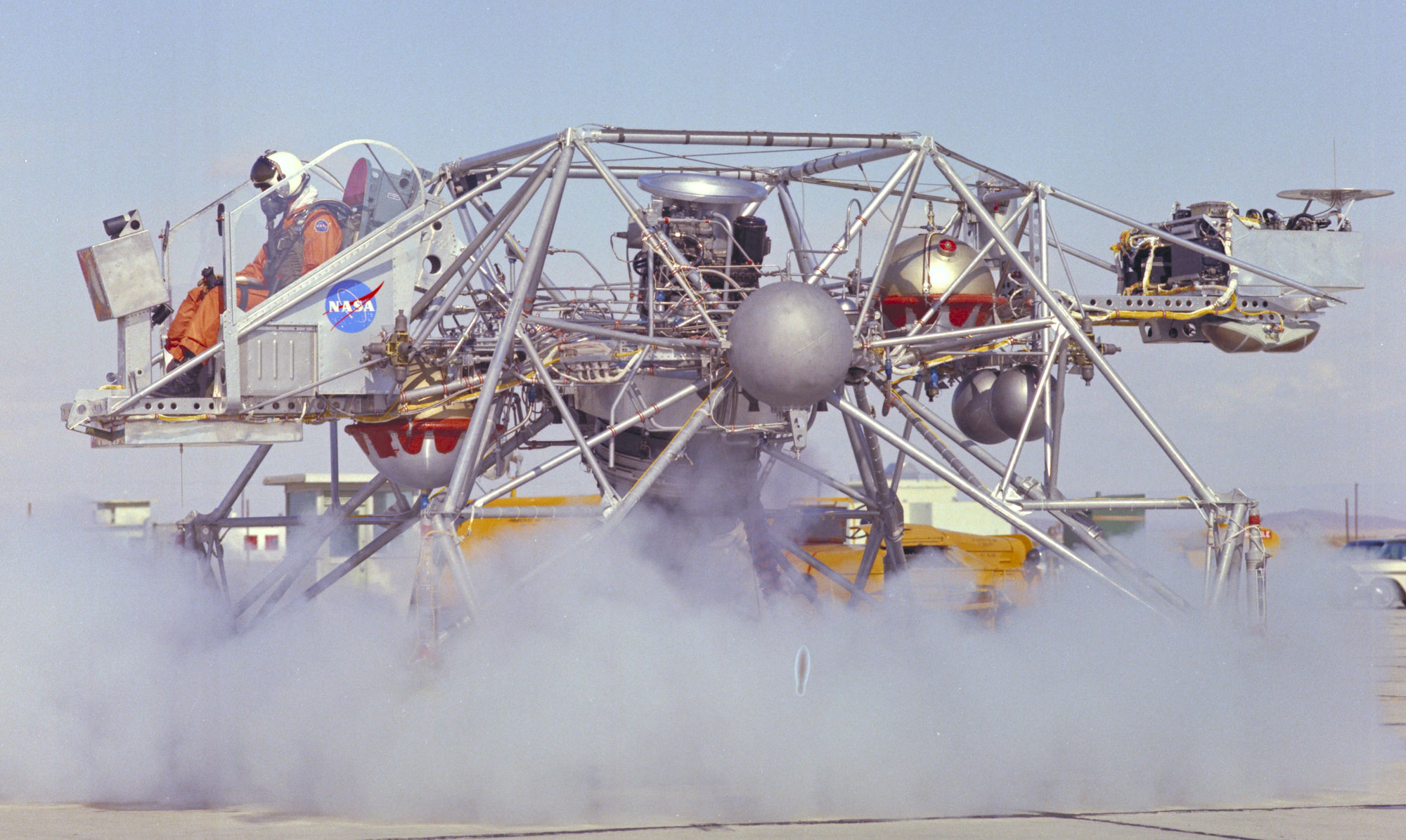

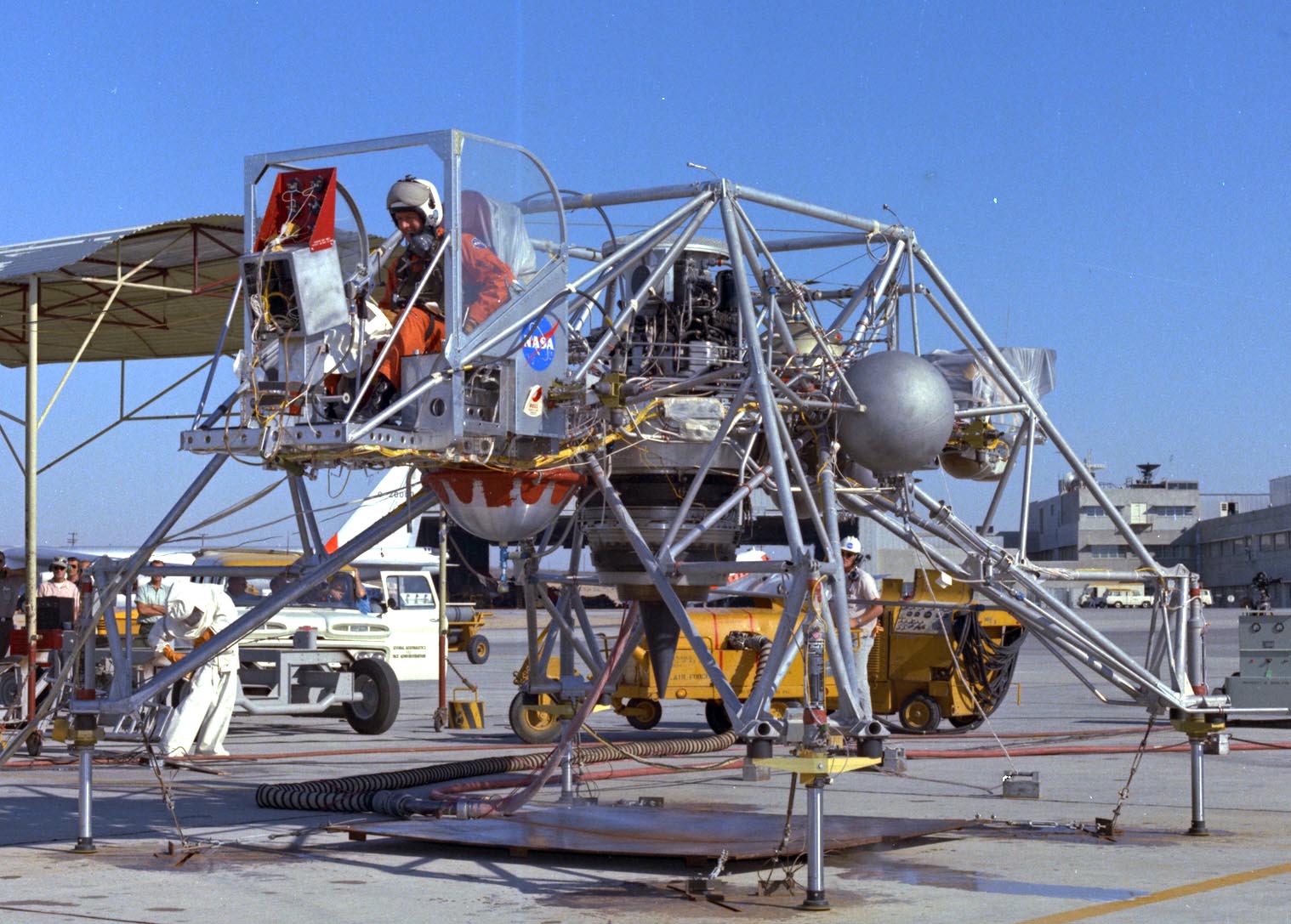

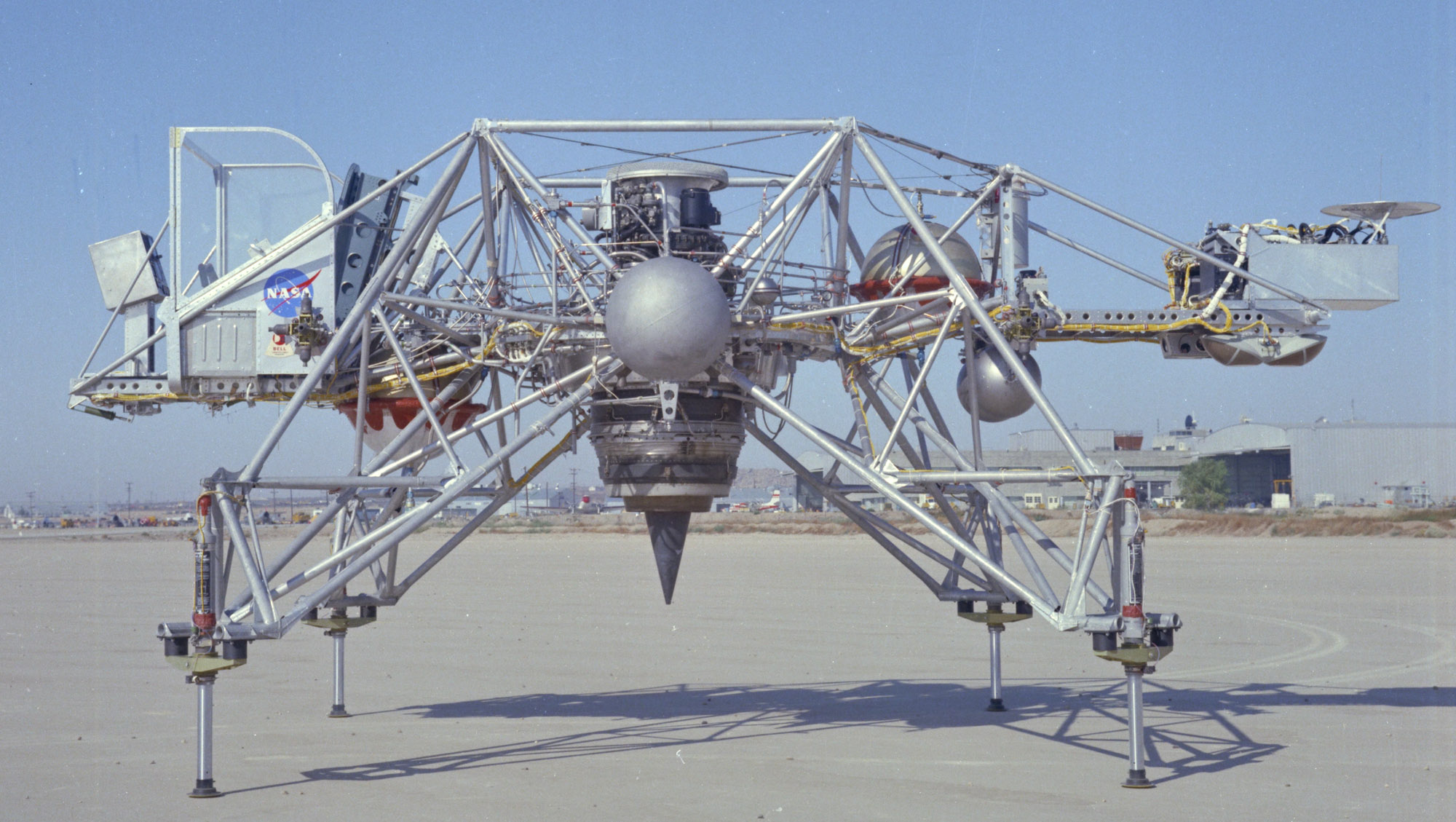

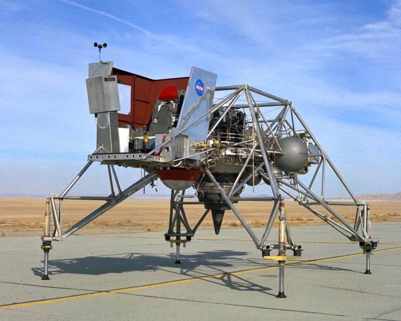

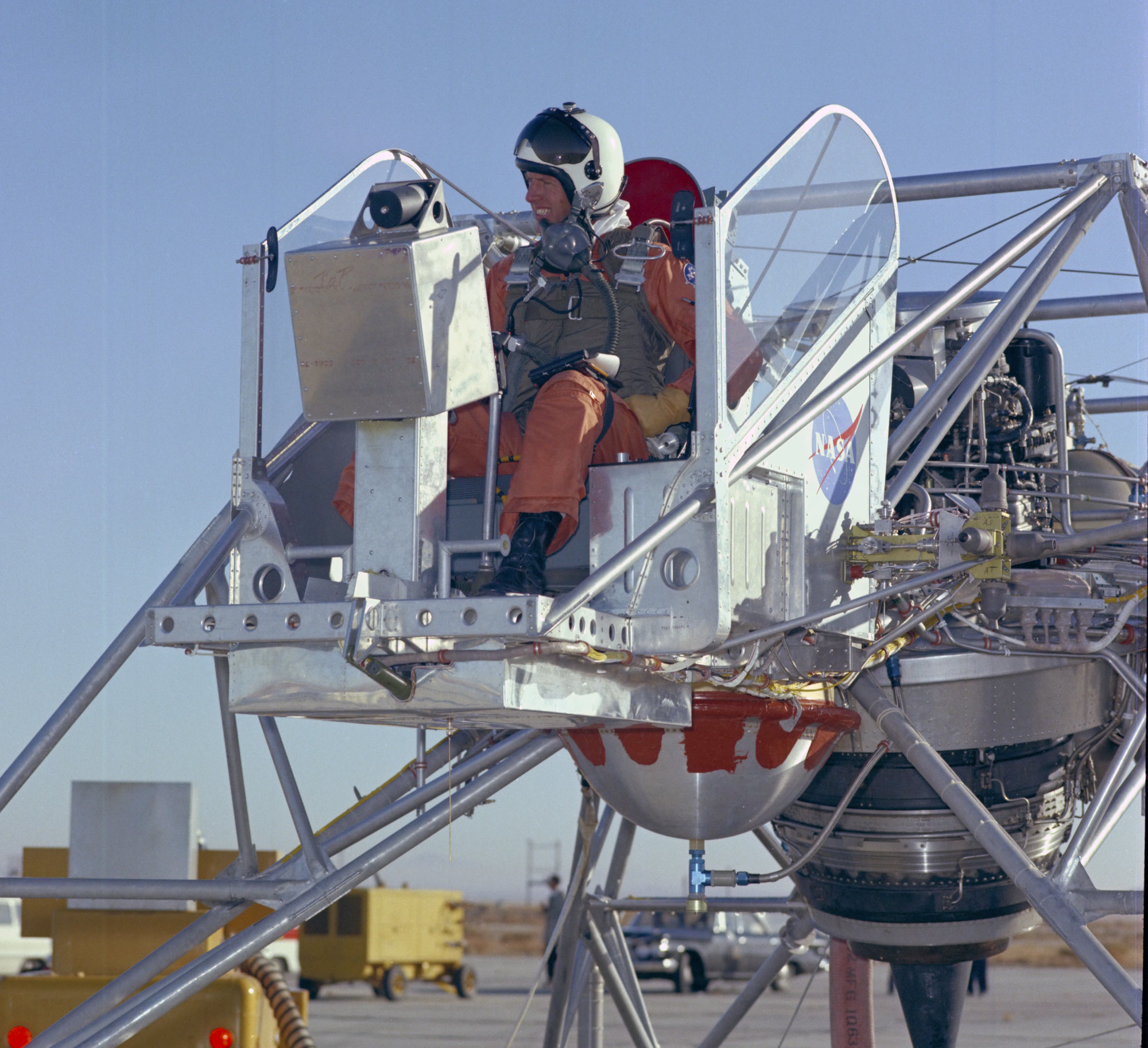

Do you know which configuration you'll be modeling? The unveiling version as shown in your B/W photo (which never flew), the early version:
The partially enclosed cockpit version:
or the fully enclosed cockpit version:
It'll be easier to assist you with the details once I know what you're going for.

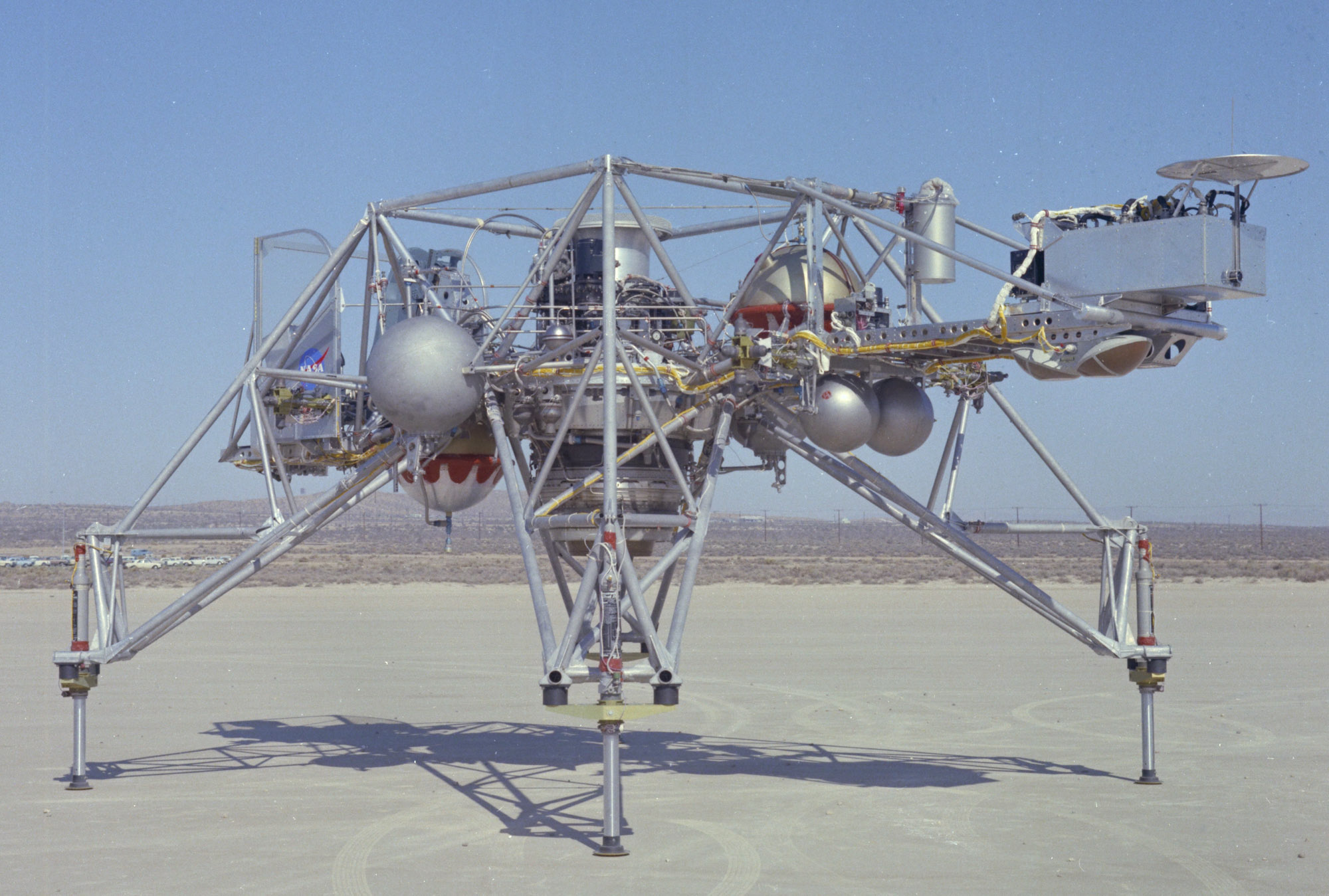

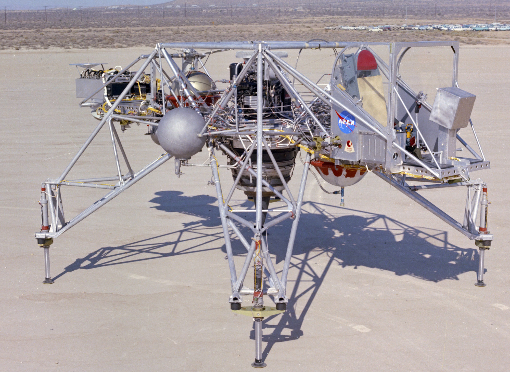

Hi X-Plane Fan, I want to model the version in this photo you posted. I understand they all share the same frame? I'm trying to make out the details
for that that multiple-joint connector on the square frame at the top - would you have anything on that? Thanks in advance!

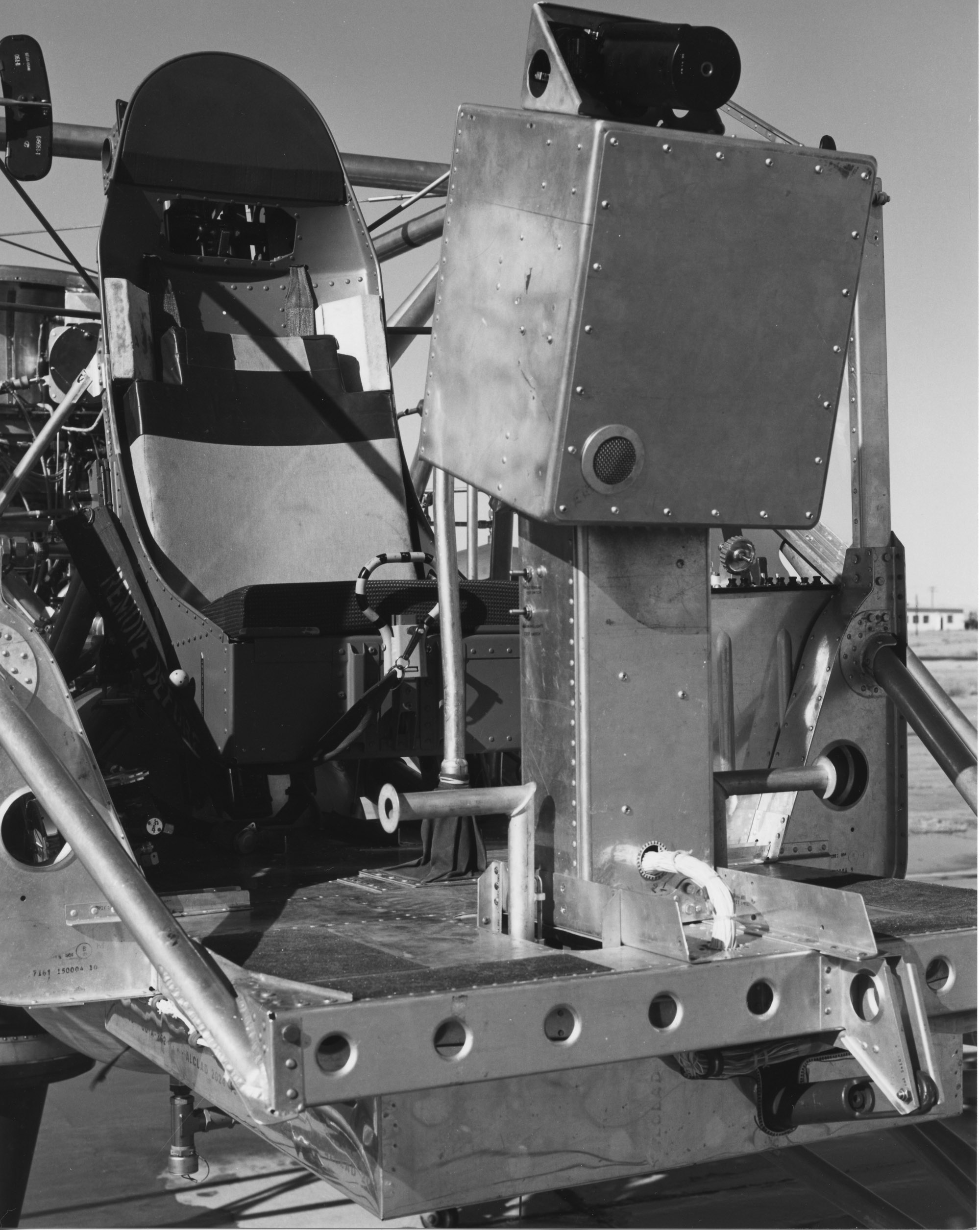

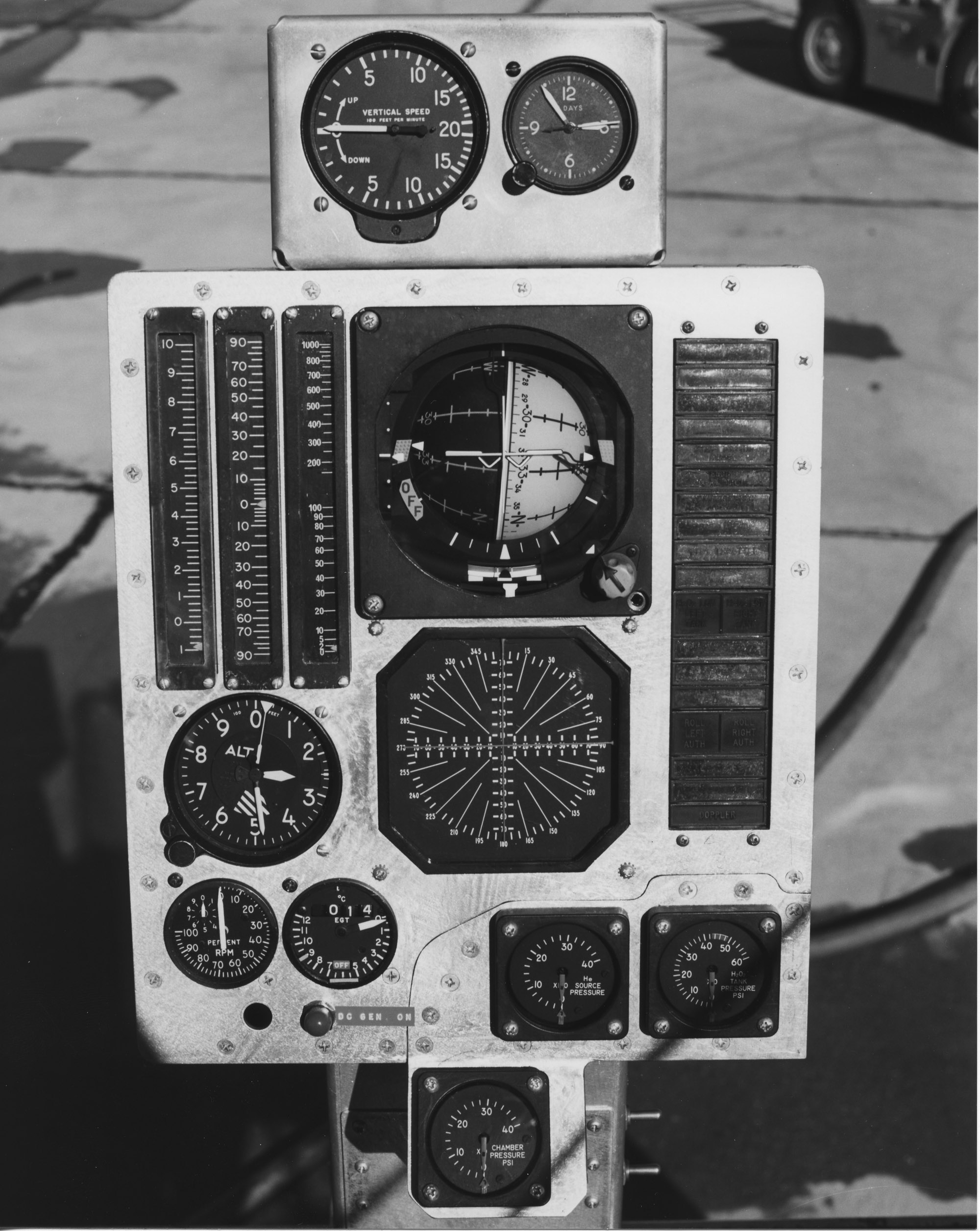

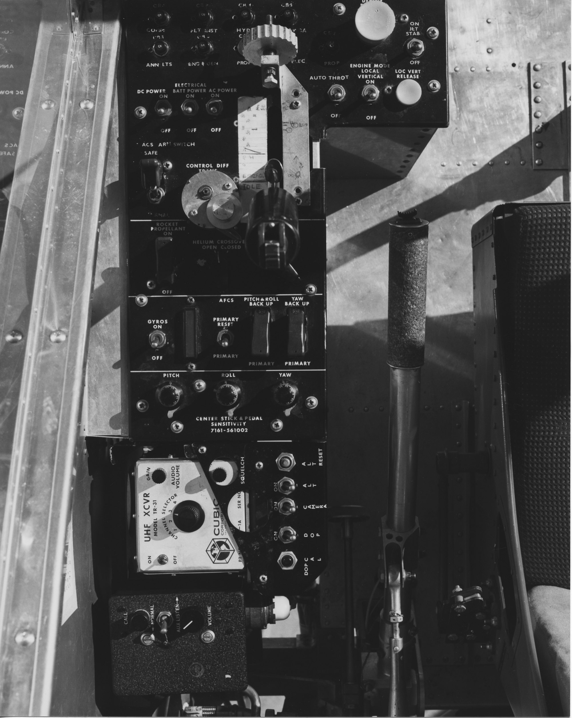

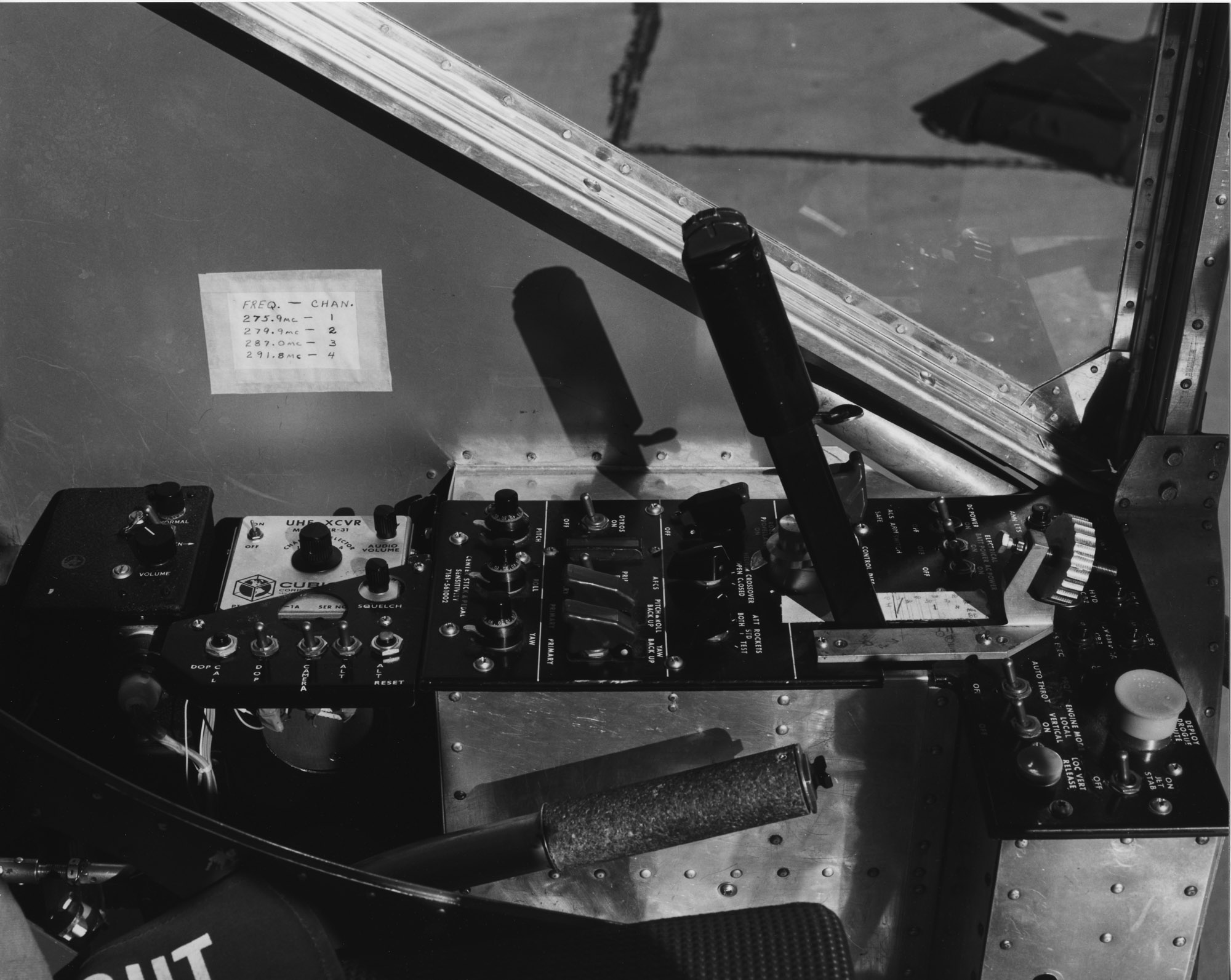

Jumping onto another area of the aircraft. Printed Tony's cockpit photo at 1/18 and adjusted for distortion. Tried different shades - I wanted a really dark one but the dark ink washes out the while lines and numbers and makes them unreadable so I settled this lighter shade. I just painted the panel aluminum in between the instruments then made styrene bezels to glue on top. I wish I knew how to make better-looking instruments. For now I guess this will do.
Also found something from the parts bin to use as an 8-ball.
Edited by crackerjazz
Dang ... those photos are Out-STAND-ing! ... it almost makes me want to build one o' these contraptions myself!
And your Instrument Panel looks mighty good Crackerjazz! The little 8 ball solution is lovely!
Keep up the great work!
Pete
What a wonderful & extraordinary collection of pics ....thanks Xplane...will have to create a file for them just in case a future project beckons....
Lovely work Crackerjazz as always. With pics like the above I look forward to seeing how you will render the detail.
