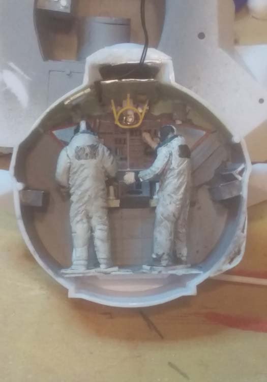

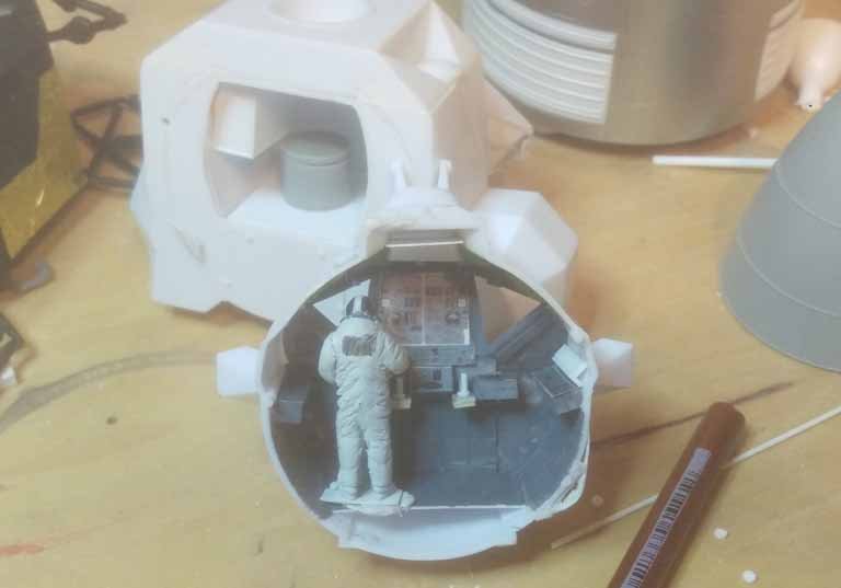

niart17 Posted February 4, 2019 Author Share Posted February 4, 2019 ok, sorry, didn't get much posted here over the weekend...things and life and such. Here is another shot from my non-starter thread. This is just a crudely modified 1/48 scale German mechanic figure so there will be some life in the model. I've gotten a little bit of the interior detailed just to cover what you can see through the openings, which isn't a whole lot. But I wanted to at least hint at the interior. Quote Link to post Share on other sites

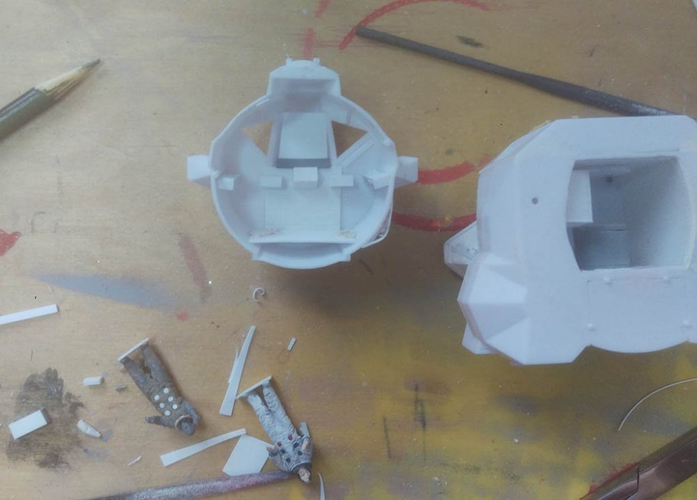

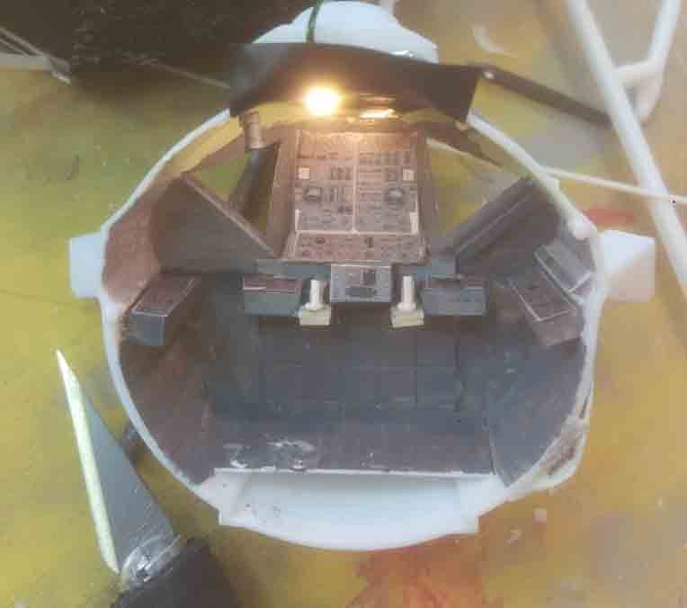

niart17 Posted February 4, 2019 Author Share Posted February 4, 2019 And here is the roughed out interior. I'll likely go with either decals or just printed card stock for the instrument panels. I don't think they need to be raised details as it mostly can't be seen, especially with the 2 figures inside hiding a good part of it. Quote Link to post Share on other sites

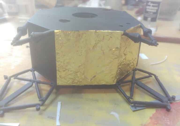

niart17 Posted February 5, 2019 Author Share Posted February 5, 2019 Got a little more done on this. Painted the interior (very rough brush painting) and added some print outs of the instruments from an image i found online. I think this will be good enough for what little can be seen through the windows, especially if I do double panes like the real one. I also started playing with some gold foils to see what might work. I intend to start looking closer at Vincent's build and try to get a better foil technique like he uses. But for now at least it's looking sort of like a thing. As always comments, critiques and suggestions are very welcome. Quote Link to post Share on other sites
K2Pete Posted February 7, 2019 Share Posted February 7, 2019 How are you applying the foil? What adhesive are you using? I ask because it looks like you're smoothing it out onto the surface a little too much. And some of the 'gold' colour on the Quads of the LM will be more Copper coloured. ... just sayin' And this is gonna be fun for me as I haven't seen a Dragon CSM. Pete Quote Link to post Share on other sites

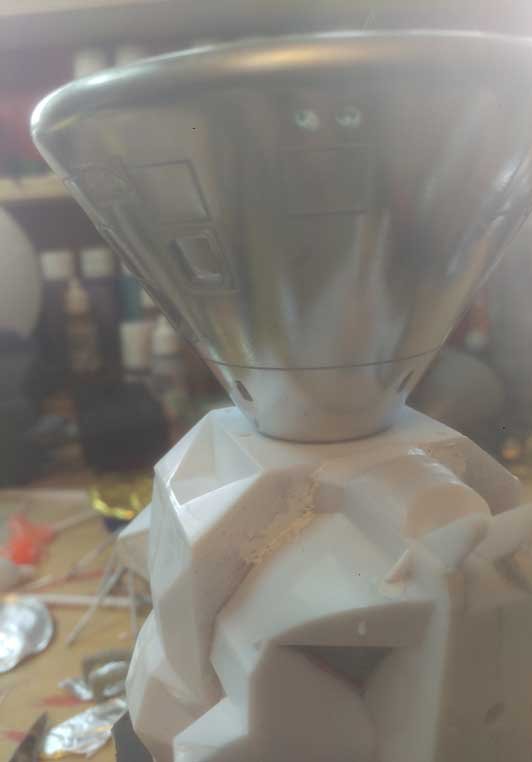

niart17 Posted February 7, 2019 Author Share Posted February 7, 2019 Thanks for the input Pete. The foil that's there now is just temporarily glued with plain ol Elmers school glue. I mainly wanted to see if it would fit the bill. It's a thicker foil from chocolate coin wrappers. It was the largest thick foil I could find cheap without writing on it. I may still use it and paint over with clear orange to vary the colors. Werther's caramel has a great color that I used for the 1/72 scale LM but it's hard to get large enough sections because of the writing. I'm going to investigate some more and rely on you guys to point out the error of my ways. Quote Link to post Share on other sites

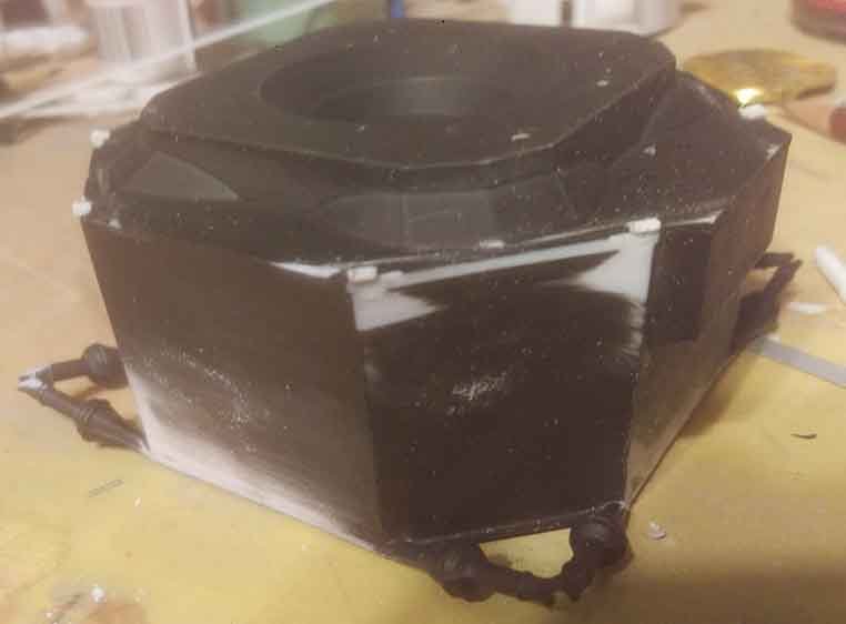

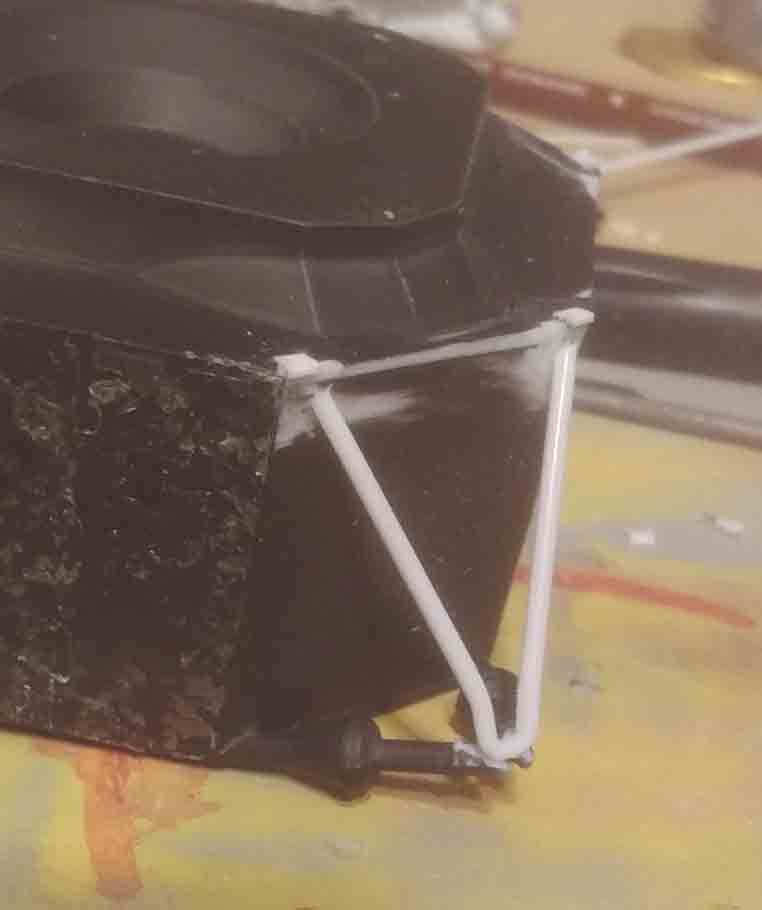

niart17 Posted February 8, 2019 Author Share Posted February 8, 2019 Slow but sure progress. I decided I am going to go with the folded leg set-up. Worse case if I fail is I can buy or print some of Vincent's as replacements and be more accurate anyway. To accommodate I added some small channel pieces along the bottom edge of the decent stage to represent the pivot hinges. I'm also going to try a different approach and built the support structure for the legs on the main body and then carefully cut it all off to make foiling easier. In theory that will help get everything all lined up and ease of foil application. We shall see. Quote Link to post Share on other sites

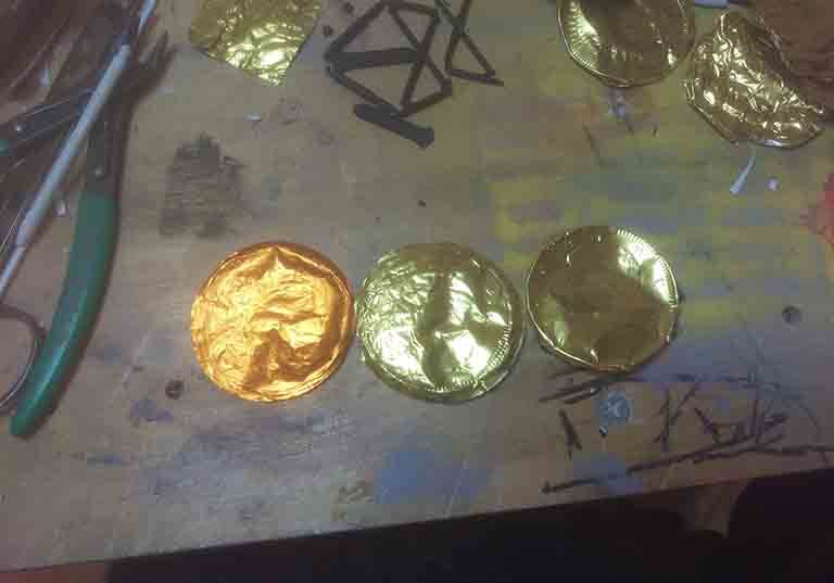

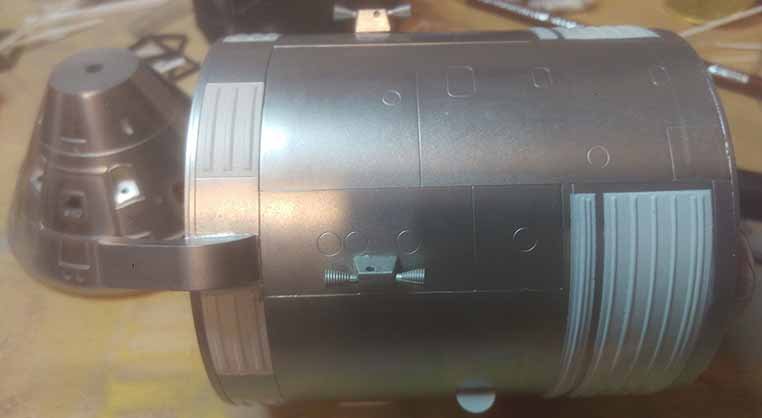

niart17 Posted February 8, 2019 Author Share Posted February 8, 2019 Here is the foil I was playing with. You can see that one of them actually has a darker more bronze color. Unfortunately it was the only one in the package that was like that and I'm not sure WHY it was different. The quest continues. (I do find it pretty cool and coincidental that the candy coins have the Kennedy profile. Seems rather fitting to me. Also here is a pic of the Dragon kit SM main body and in the background the CM. I'd sorta built these a while back but I think I'm going to redo and add details. Pete, you can see that there are nice panel lines on the kit....it looks good, but wrong. As you know, the surface of the CSM was anything but smooth. So I will be referring to your build and follow closely to see how to dress up the surface textures. Until next time, comments, critiques and suggestions solicited. Bill Quote Link to post Share on other sites

K2Pete Posted February 9, 2019 Share Posted February 9, 2019 I agree with John, your figures are excellent! At that size, your proportions and ... just the 'look' of the suit, is top drawer! And the Service Module is smooth. The Dragon SM looks pretty good. The only textures were around the RCS thrusters, bubbled up paint and structural elements. yours looks okay to me-e-e. This image on the Wikipedia site is pretty indicative. https://en.wikipedia.org/wiki/Apollo_command_and_service_module And on your LM, to adhere the foil I use Bare Metal Foil Adhesive. You paint it on, let it dry and it's tacky ... therefore fairly easy to remove and readjust. I also apply the foil loosely to try to get that 'billowy' effect. When I do my LM for this build, I'll try to show the process. Pete Quote Link to post Share on other sites
niart17 Posted February 9, 2019 Author Share Posted February 9, 2019 Perhaps smooth isn't the word I should of used, featureless is more apt. The Dragon kit body doesn't have any raised features at all other than the radiator panels. None of the access panels are raised and there is no rivet details represented. That's what I meant. You replicated those features very well in your CSM builds. Quote Link to post Share on other sites

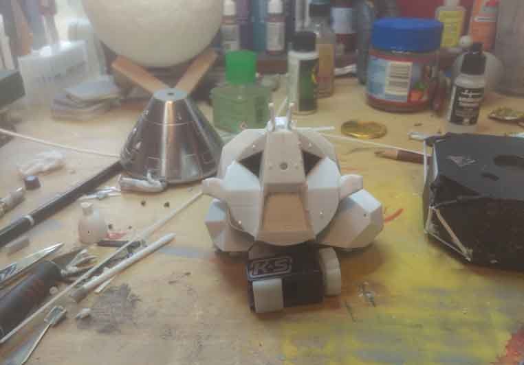

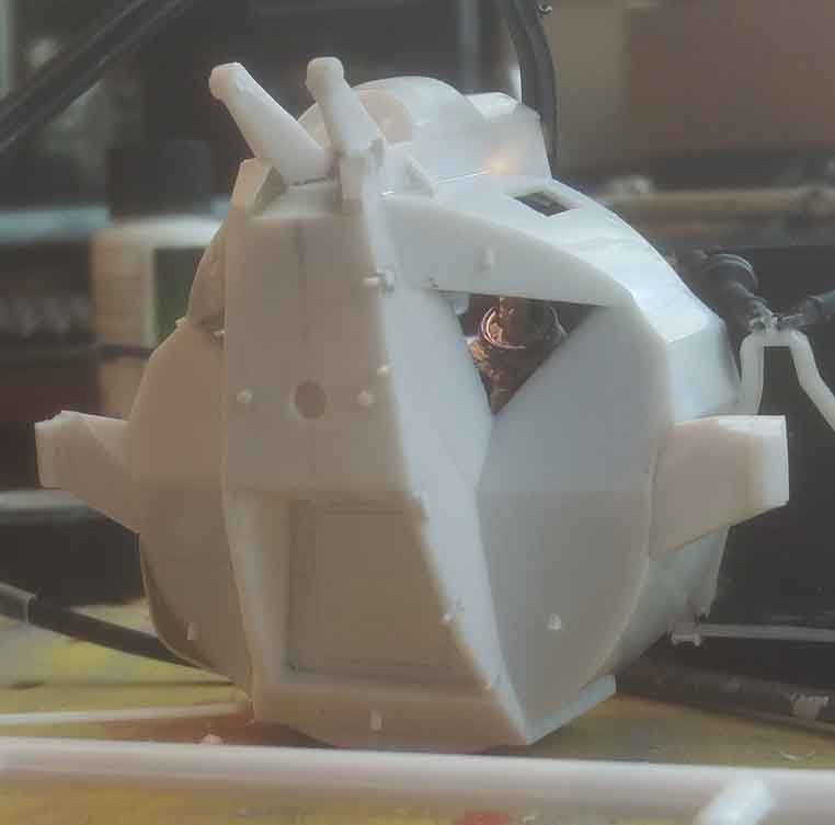

niart17 Posted February 10, 2019 Author Share Posted February 10, 2019 Turning back to some facial work, I added some more details to the front of the ascent stage. The vents are just small plastic rod cut at a sharp angle and filed down. I also decided to maybe run a small LED into the cabin to light it up a little. It's not going to make a huge difference but just make the interior a little bit more visible. Since it may be lit up I'll likely touch up the painting a little so it's not horribly sloppy. I am now looking for some better nozzles for the RCS clusters. The kits are really crude and misshaped. Quote Link to post Share on other sites
niart17 Posted February 10, 2019 Author Share Posted February 10, 2019 And this is an idea of how the light will look in the cabin. Just enough to light up what can be seen. Thanks for checking it out. As always, comments, critiques and suggestions are welcomed. Bill Quote Link to post Share on other sites

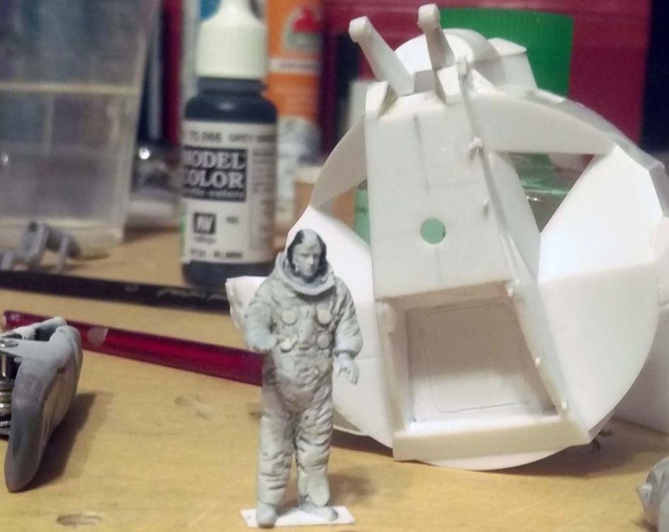

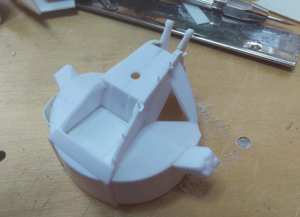

niart17 Posted February 17, 2019 Author Share Posted February 17, 2019 Thanks ApolloMan. Here they are completed just before I buttoned them up and glued the fore section to the aft. Hopefully everything will look ok once I get it wired up and see if the lights still work. Also guys, I have a quick question. I THINK I'm correct but can anyone confirm that when the CSM and LM are docked, there isn't anything visible between the two crafts? AS far I can tell, they should be flush as shown in the image posted below. But since obviously there were no cameras to get that angle, I am not 100% sure, maybe 95%. Anyway, thanks for checking in. Quote Link to post Share on other sites
