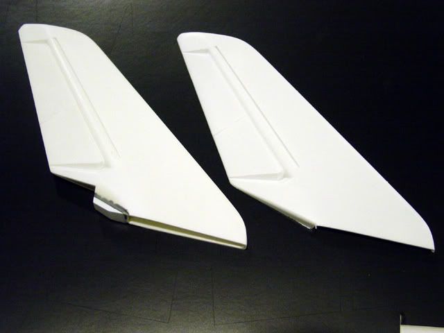

PBoilermaker Posted January 27, 2008 Share Posted January 27, 2008 Jay, you are the man! Do you have rough dimensions or a drawing showing the cut lines for the drogue chute? Is that the only tail mod? -Mike Quote Link to post Share on other sites
Jay Chladek Posted January 27, 2008 Share Posted January 27, 2008 (edited) The basic drawing came from the SIM 3 book in the section on Endeavour. Since it was a 1/144 image, I just blew it up 200% to 1/72 scale. The other mod I did was the diagnal flat spot on the top rear of the tail and that was done with a few swipes of a sanding stick. All orbiters except Columbia and Enterprise have this flat area back there. I haven't been able to find a reason for it, but talking to one engineer that worked on shuttle in the early days, he thinks it was just an aerodynamic cap that was left off the vertical tail of the last four orbiters built (Challenger onwards). Only reason I can theorize for it is that data from Columbia's flight tests showed no excessive high heat loads on reentry in that area that might require a fairing to smooth out the aerodynamic flow, so this cap was removed to save a little weight. Columbia on the otherhand kept that round area, even when it gained the SILTS pod in 1985. Edited January 27, 2008 by Jay Chladek Quote Link to post Share on other sites

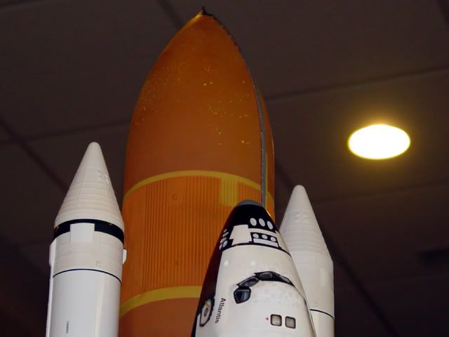

simon atkinson Posted June 30, 2010 Share Posted June 30, 2010 Hi, You might be interested in taking a look at a model I built some years ago as a commission for the London Science museum - the orbiter used the (much rebuilt) Monogram orbiter but the SRB's and ET were scratch built as was the launch pad. www.simonatkinsoncreativearts.com click on Simon Atkinson Modelmaking. Any questions about the model contact through the website. Cheers, Simon Atkinson. Quote Link to post Share on other sites
crowe-t Posted June 30, 2010 Share Posted June 30, 2010 Hi,You might be interested in taking a look at a model I built some years ago as a commission for the London Science museum - the orbiter used the (much rebuilt) Monogram orbiter but the SRB's and ET were scratch built as was the launch pad. www.simonatkinsoncreativearts.com click on Simon Atkinson Modelmaking. Any questions about the model contact through the website. Cheers, Simon Atkinson. Hey Simon, That's a real nice Shuttle build! I'm glad you bumped this thread, I hadn't come across this one yet and there is a lot of good info that Jay provided. Quote Link to post Share on other sites
Youngtiger1 Posted July 1, 2010 Author Share Posted July 1, 2010 Hey Simon, I think I have seen that build before. Didn't it appear in the Fine Scale modelers magazine? I have the mag but not sure of the vol. # of my head at the moment. You shuttle sure is awesome build. I love how much detail you put into the pad. I'll be sure checking your site soon and pick you brain for information on "how to". BTW, Welcome to ARC and thanks for stopping bye. Mike Quote Link to post Share on other sites

HOLMES Posted July 4, 2010 Share Posted July 4, 2010 (edited) Simon ,, I have seen that in the Science Museum a while back ...I did not know you built it..WOW !!! it is awesome... WELL constructed ...Truly inspiring.. Thnak you HOLMES Edited July 4, 2010 by HOLMES Quote Link to post Share on other sites
simon atkinson Posted July 22, 2010 Share Posted July 22, 2010 Thanks, You're right, the model was in Finescale Modeller some years ago. The model is apparently in storage at the moment, was put back on display when Columbia crashed but is waiting for the Space Gallery to be refurbished. Love to chat with you any time - there's a contact page on my website - www.simonatkinsoncreativearts.com Best regards, Simon. Simon ,, I have seen that in the Science Museum a while back ...I did not know you built it..WOW !!! it is awesome...WELL constructed ...Truly inspiring.. Thnak you HOLMES Quote Link to post Share on other sites
