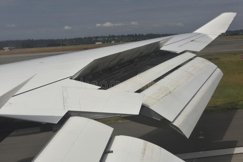

Cubs2jets Posted February 12, 2022 Share Posted February 12, 2022 The leading edge of the flaps you are cutting away rest under the trailing edge of the top skin / spoilers thus the bottom leading edge of the flap sections is further forward. You can see in the last picture the small amount of flap that still needs to be cut away. Looking at this picture, you can see from the rub marks just how much of the flap is under the top skin / spoiler when retracted. C2j Quote Link to post Share on other sites
