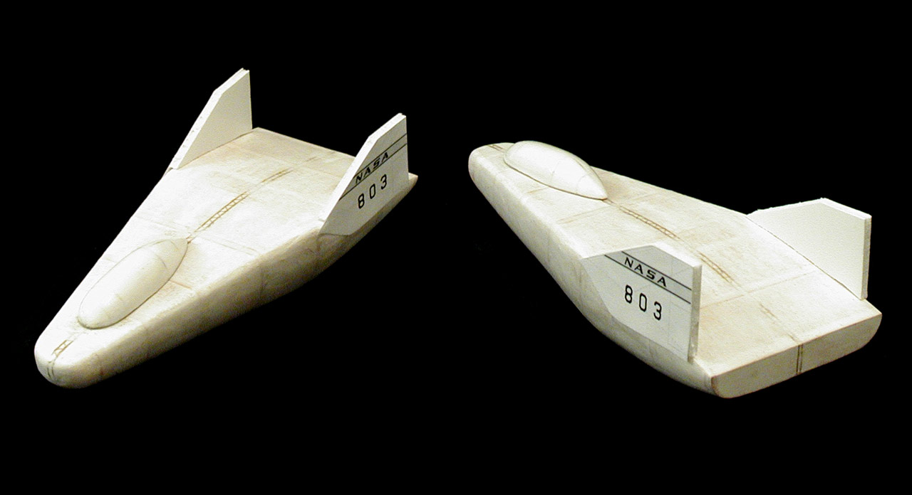

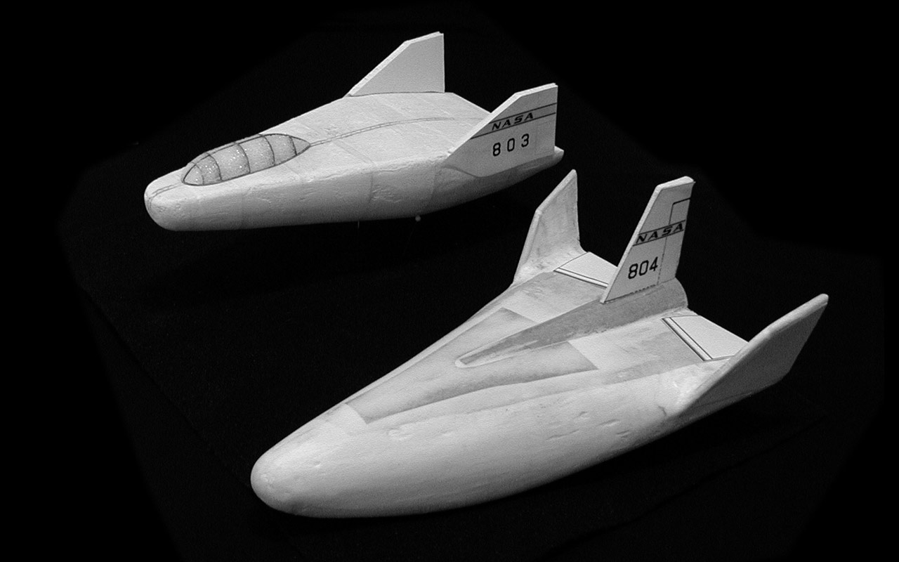

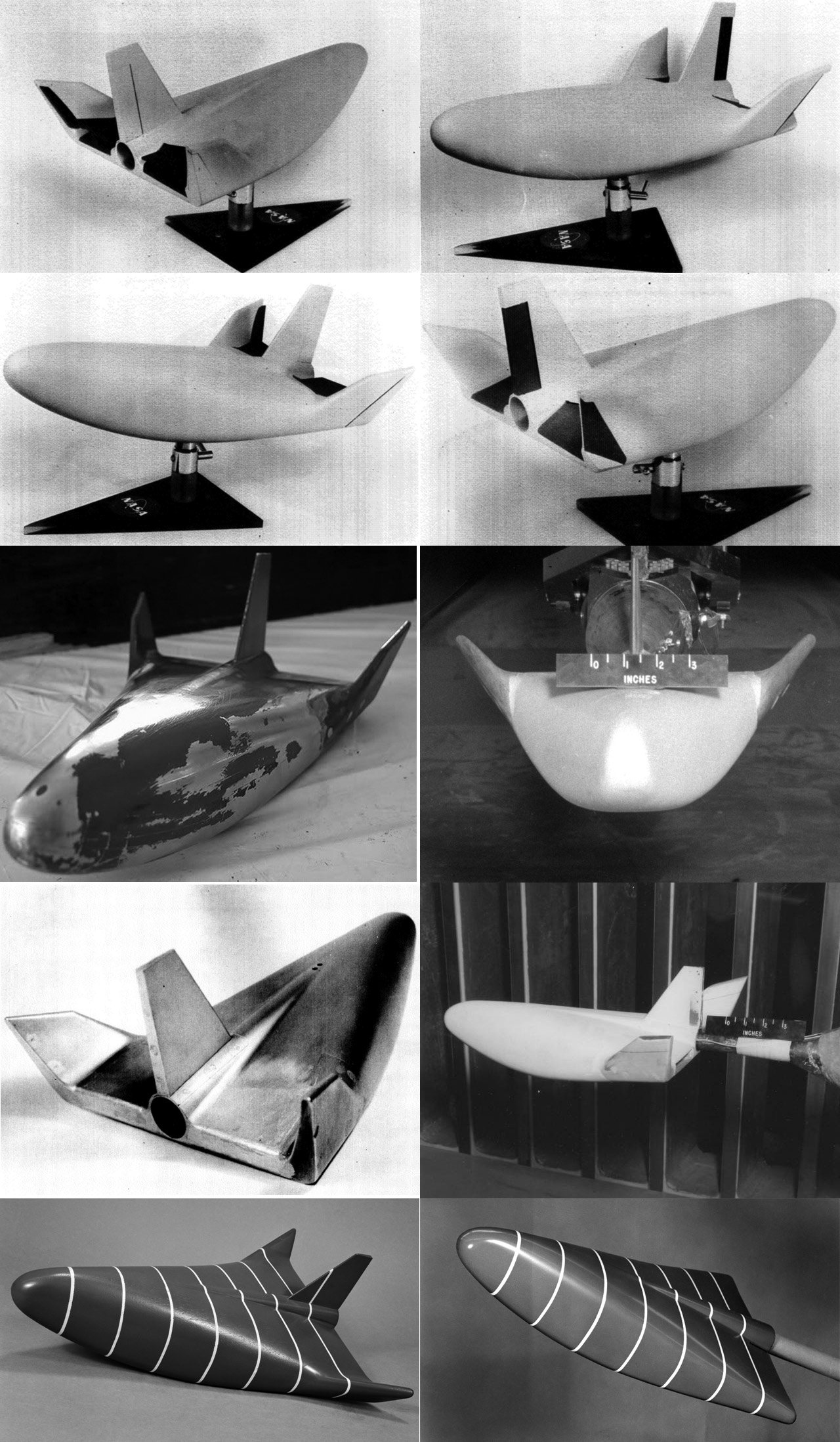

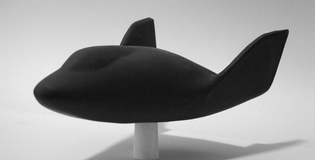

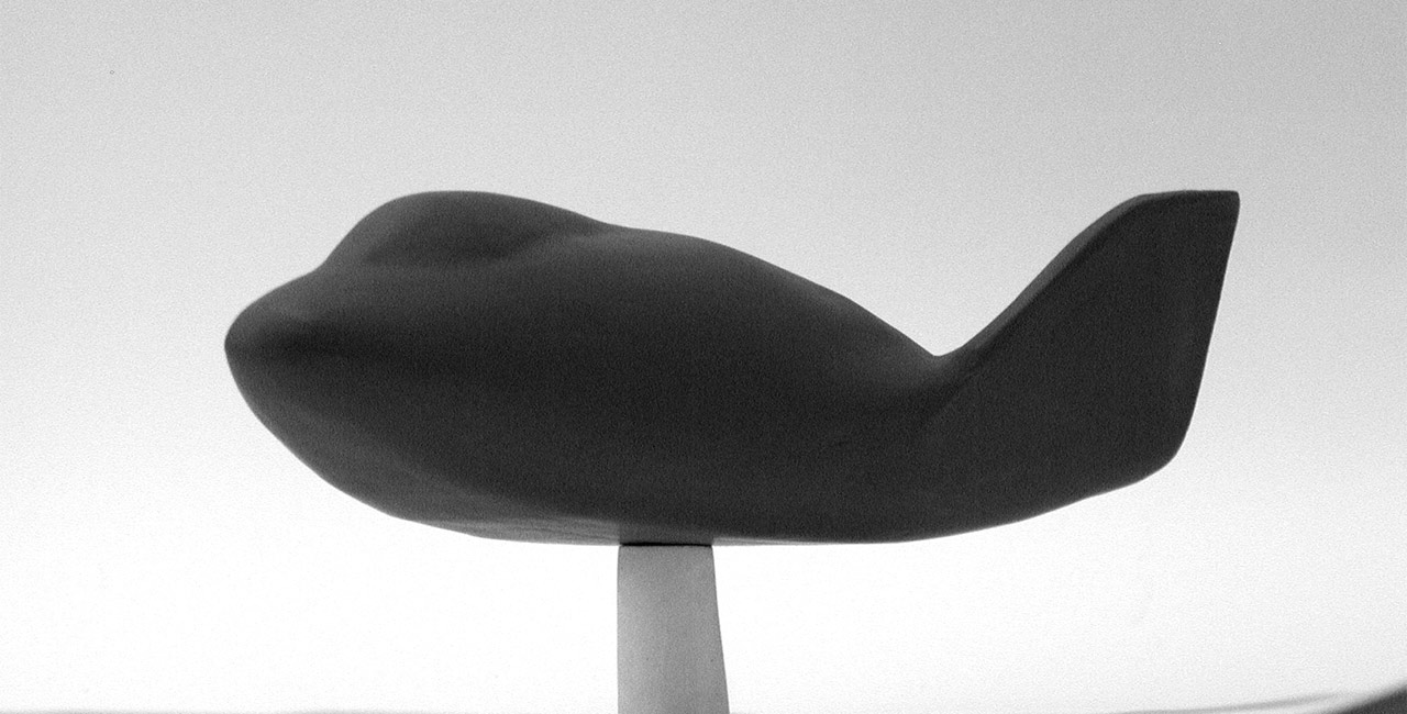

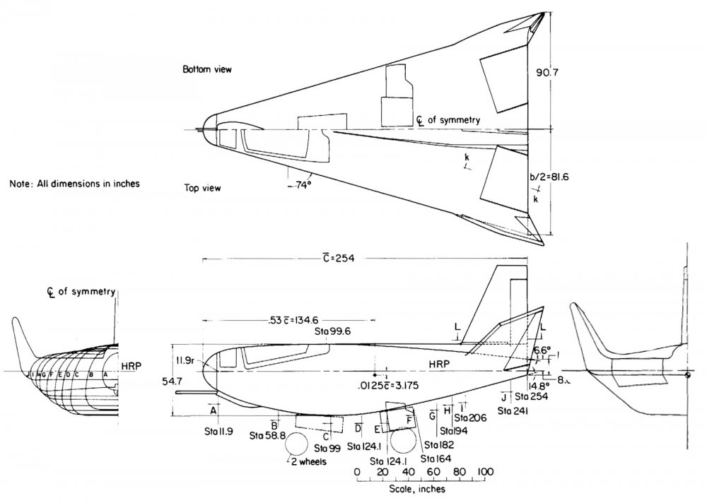

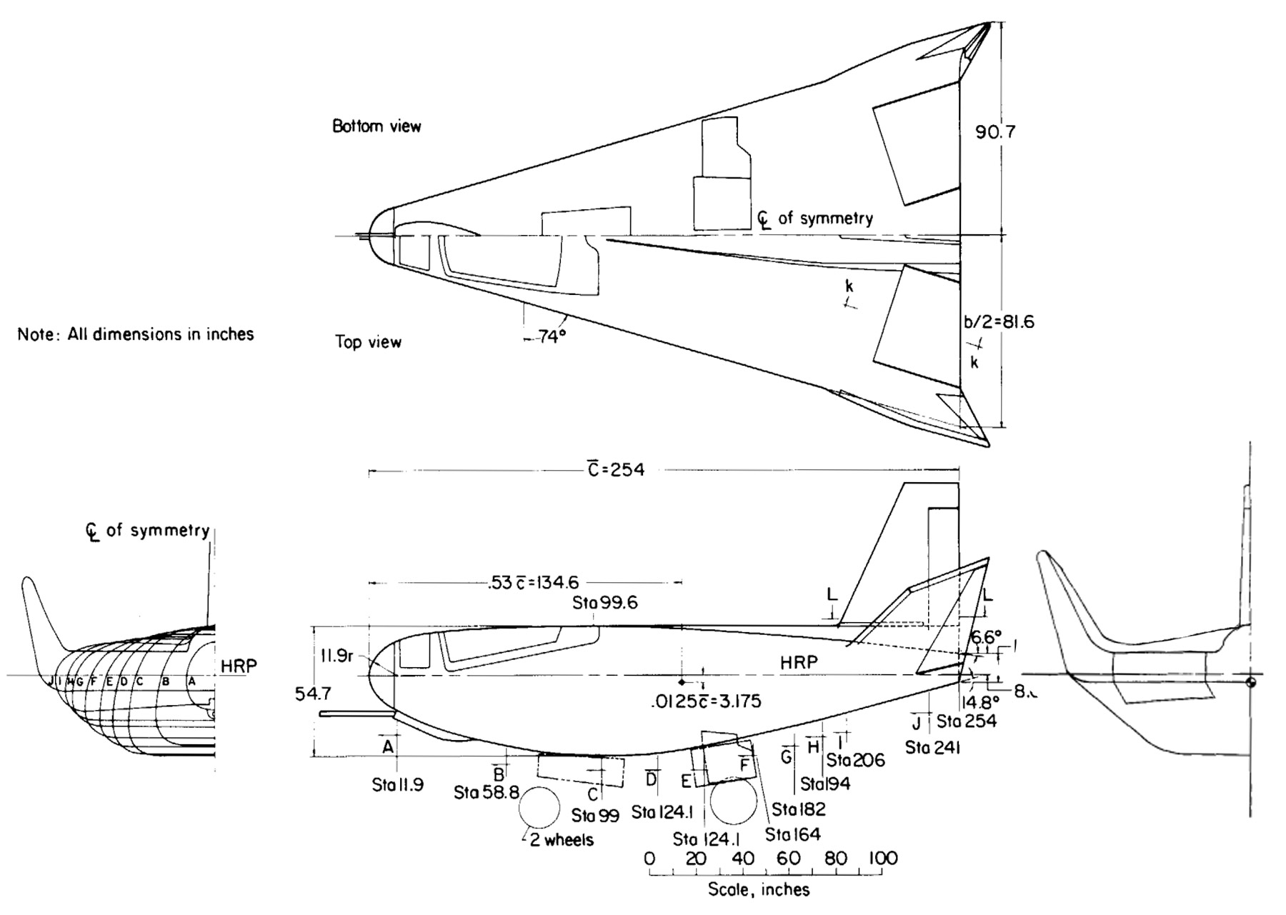

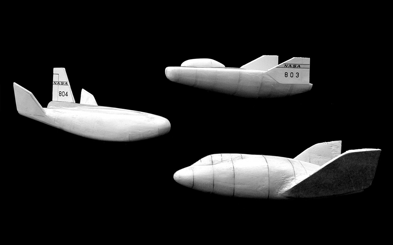

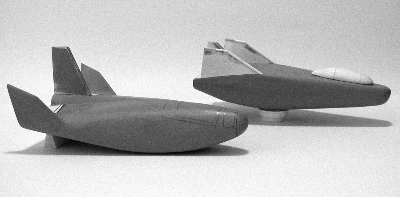

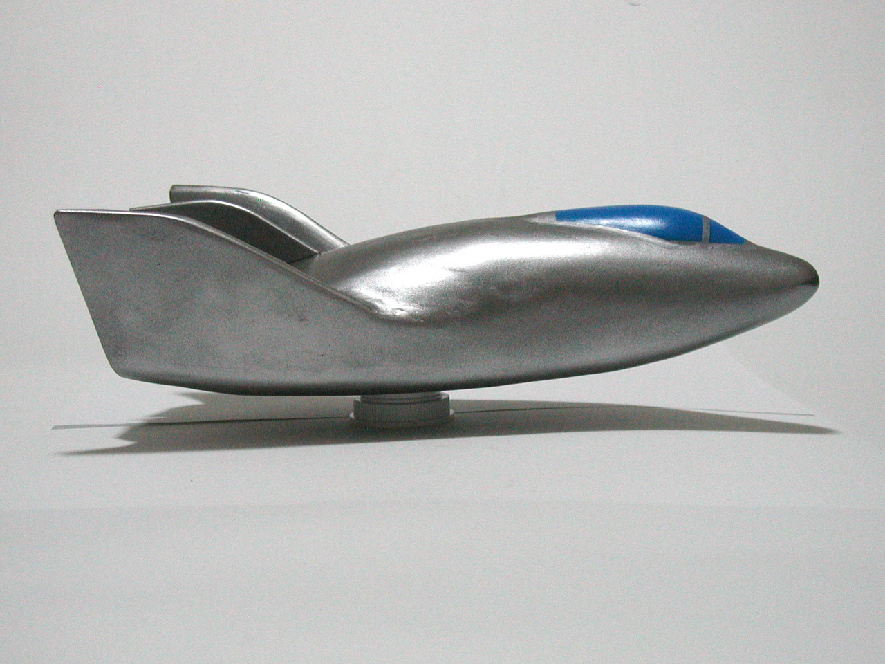

Shaw Posted November 5, 2022 Share Posted November 5, 2022 Forward Hello. I'm new to posting here, but I've been following the site for a while... mainly to keep up with the progress of Tracy's (Vidar_710) incredible Excelsior project. I don't build a lot of models, and usually only when I'm actively studying a subject. Consequently, I'm not nearly as skilled as someone who practices the craft on a regular basis. That having been said, I figured that my current subject of interest might be worth sharing. My study models I've always had a fondness for the lifting body program of the 60's and 70's (similar to my love of the X-15 program, if not nearly as strong). A few months back I started looking into what info I could find on the HL-10 and along with the data collection I started building a study model at about 1/24th scale. The study of the HL-10 led to studying the M2-F2/3, and more recently the SV-5 project (X-23 and X-24a). What was surprising was that while I found a fair amount of data on the designs of the HL-10 and SV-5, there was very little on the M2-F2/3. So while plans could be pretty easily worked out by comparing and contrasting available drawings of the HL-10 and SV-5 with photos of the actual vehicles, there weren't any good drawings of the M2-F2/3 to start with... so I reverse engineered my own. Often times I don't take study models very far (which is why I rarely share them). In some cases I might only assemble sections to get a feel for a design... like these of the M2-F3 and SV-5P (X-24a). As I started getting deeper into the history of the M2-F2/3, I figured I'd build a more fleshed out version like my HL-10. And even though I hadn't originally planned on it, I got interested enough in the SV-5 project to start in on a more fleshed out version of that one too. Leading to a set of three 1/24th scale builds (at various stages of completeness). So I'm sure the question has cross some of your minds... where do I go from here? The HL-10 hasn't changed much as the other models have progressed. At this point my next overall step would be to hit the models (when they all reach the same stage as the HL-10) with automotive primer and start working out the remaining defects with glazing putty (repeating as needed). When I'm actually happy with the quality, I'll use these as masters for molds. I can then continue adding details to the models pulled from those molds. The masters for the M2-F2/3 naturally lends themselves to being able to make both versions of the craft. I'm working on keeping the SV-5 study model as generic as possible so that it'll work for both the SV-5D (X-23) and SV-5P (X-24a). At any rate, I figured I finally had something worth sharing with you guys. Quote Link to post Share on other sites

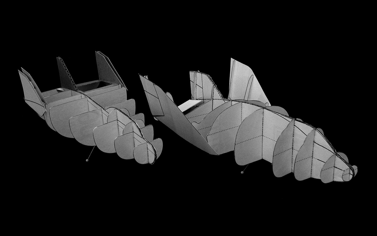

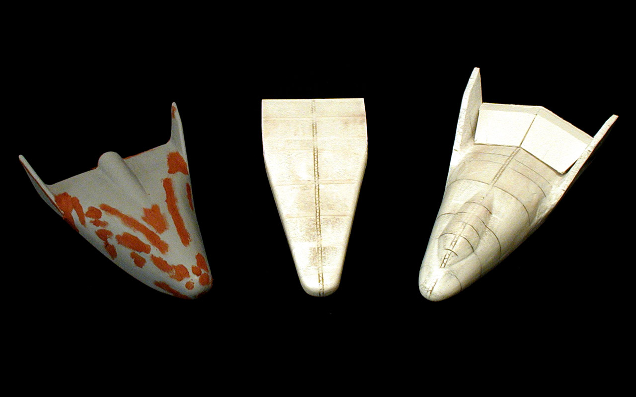

K2Pete Posted November 6, 2022 Share Posted November 6, 2022 Nicely done Shaw and glad to see you posting here! Now, I'd love to know how you built these ... between the ribs, is the material Bondo or Sheet Insulation or Wood and then lotsa sanding? And it certainly is fun to do a little research, build something to visualize your mental images and then ... flesh it out to a relatively finished model. I think we all understand the evolution of your models. And we'd love to see more, in whatever stage of completeness you wanna post. ;- D If you've done the research and one of us needs a little advice, we'll know whose thread to turn to! Thanx! Pete Quote Link to post Share on other sites

Shaw Posted November 8, 2022 Author Share Posted November 8, 2022 Thanks for the encouragement guys! On 11/6/2022 at 1:41 PM, K2Pete said: Now, I'd love to know how you built these ... between the ribs, is the material Bondo or Sheet Insulation or Wood and then lotsa sanding? Its styrofoam cut to the general shape using a hot wire. I then applied spackling and sand to get the shape more refined. I then started glazing the model with Elmer's glue to get the surface sorta "plastic", which is about where I need it to be to start applying Rust-Oleum auto primer. Honestly, I only planned on making the HL-10 and M2-F2/3. But because it is best to let the Elmer's glue on the surface dry for about a week, I decided to build the SV-5 body to keep me occupied. So sometime this week I'll start applying Rust-Oleum auto primer to the first two models and working out the remaining surface flaws using a glazing putty. After I'm happy with the results, I'll hit them with a gloss coat and they'll be ready to make silicon rubber molds. I've used a similar process in scratch building other models in the past (like these... here and here). Right now I'm mostly interested in learning the contours of these vehicles. Making molds is sorta like hitting save as on them before trying out other possible options with them. I know I'd like to make simple display models from them, but maybe someday I'll spring for a used dental vacuum former to make clear canopy parts and build more detailed versions. Quote Link to post Share on other sites

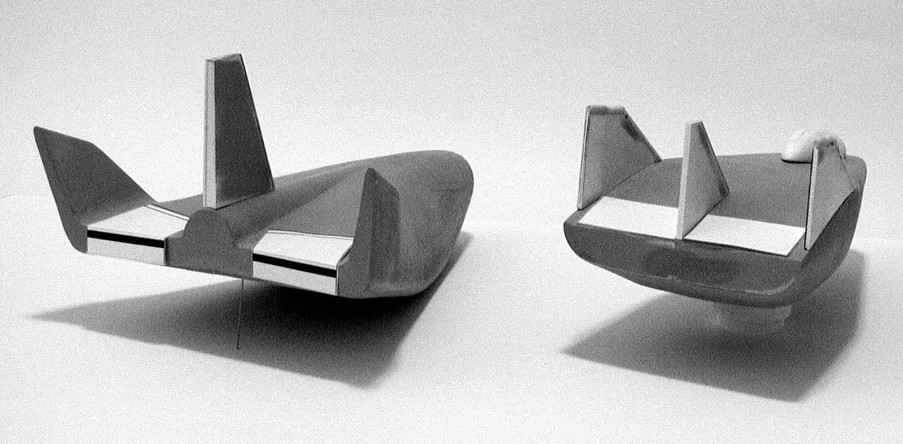

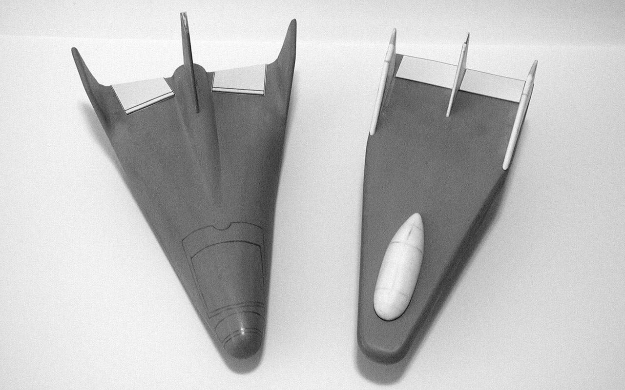

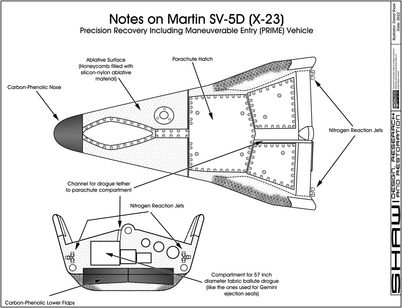

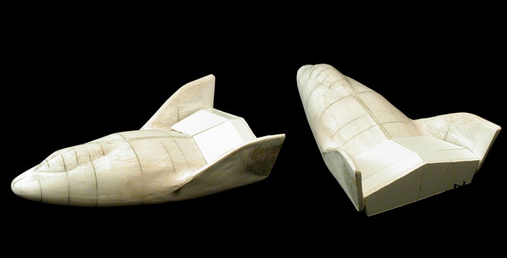

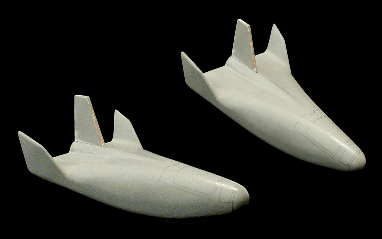

Shaw Posted November 18, 2022 Author Share Posted November 18, 2022 Thanks! So I've been doing some research on the SV-5 program, mostly trying to flesh out the SV-5D (X-23). Below is a sketch I drew up with some notes. Nailing down the details of the rear panel has been my main focus because there are surprisingly few good reference images. I have been slowly plugging away on the SV-5 body. Here it is mocked up as the SV-5P (X-24A) with stand-in center fin and flaps. And here it is mocked up as the SV-5D (X-23) with stand-in rear ramp. On the M2-F3 body, I decided I wanted to address some issues before starting in on the primer, so here it is after a few touch ups (with the stand-in fins). As for the HL-10, still plugging away at it. Here it is after the most recent primer pass. It still has spots I need to address, but I'm making progress. Quote Link to post Share on other sites

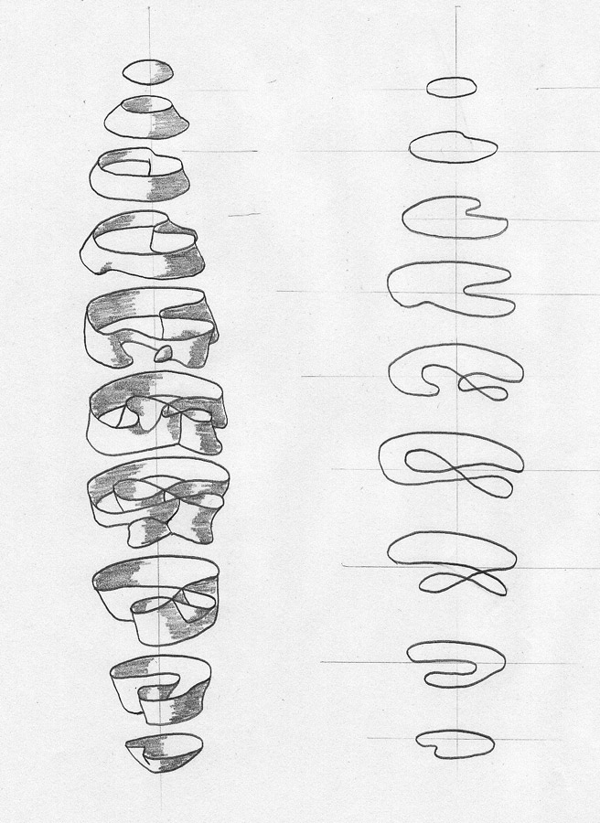

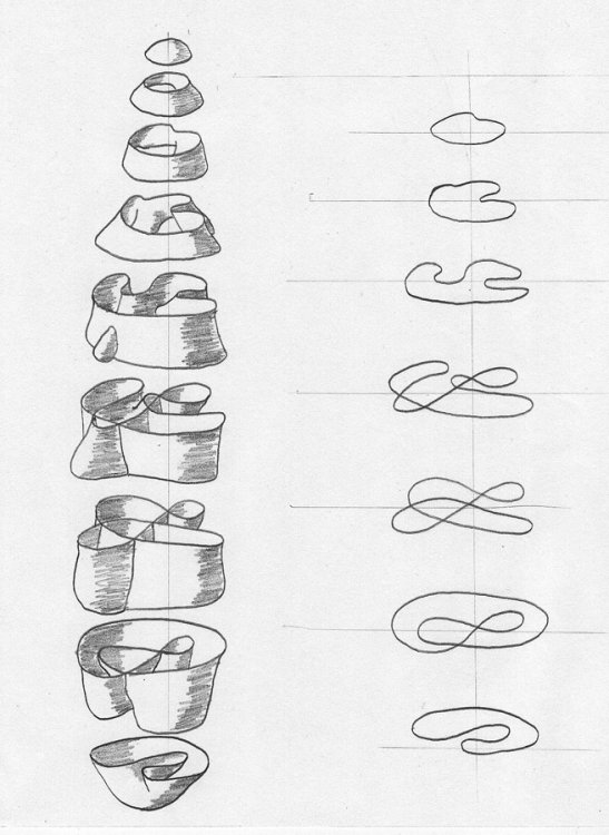

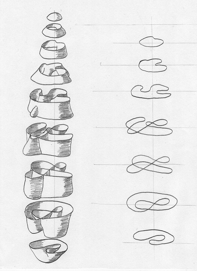

Shaw Posted November 22, 2022 Author Share Posted November 22, 2022 Thanks! Yeah, for me the effort of recreating things like this is an important part of learning the subject. It is similar to how I used to study surfaces back when I was doing mathematics. I would sit down with a pencil and paper a draw surface like an immersion of the real projective plane... Doing it this way (starting with only what I knew about the topology of the surface), I had to really under stand the nature of it. And the drawings of the surface could be different depending on how I envisioned the immersion... I have applications that can create very beautiful versions of the same surface (like this), but I don't think I (personally) get as much out of passively looking at a computer generated version as I do when I have to do it myself. Back to this learning experience, because my HL-10 is still quite featureless, I've been using photos of the HL-10 wind tunnel models for comparisons... I know I'm late to the study of this and that you guys have seen much of this before, but I thought I'd share some of my references. Here are a couple sheets assembled from those sources... And here is where you can find some of those sources... (1) HL-10 diagrams, Part 1 (The Unwanted Blog) (2) HL-10 diagrams, Part 2 (The Unwanted Blog) (3) NASA Tech Memo on HL-10 Wind Tunnel Model 1971 (4) NASA Tech Memo on HL-10 Wind Tunnel Model 1974 (5) Development and Testing the HL-10 1994 As for my models, because the first versions are going to be low detail display models, I've been trying to work out what to include for decals. Here is what I'm planning on for the HL-10 and M2-F3 (I'm not close enough to an X-24A to worry about decals at this point)... Thanks again for the encouragement! Quote Link to post Share on other sites

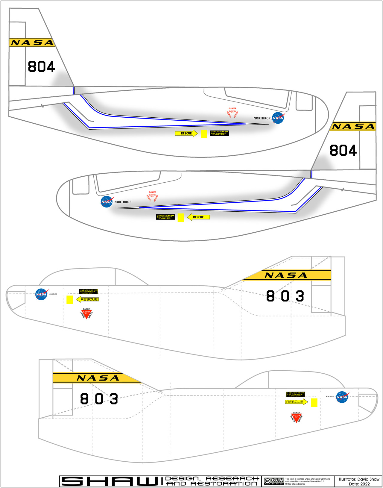

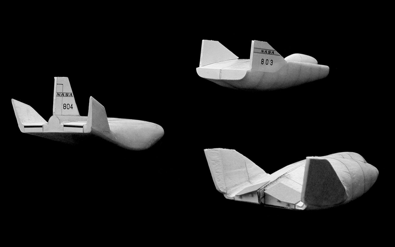

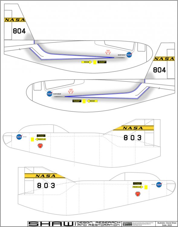

Shaw Posted December 17, 2022 Author Share Posted December 17, 2022 Quick update... A couple weeks ago I started in on the primer/putty stuff on the M2-F3, and I started building the fins for both models out of styrene. Because I'm getting close to the last primer coat on the HL-10, I figured this would be a good time to sketch out the canopy details on the model. I'll use clear packing tape to lift the pencil lines off the surface and place the tape on a sheet of paper to scan it in. From that image I can create a clean version for making masks (windows) and decals (hatch outline). I've gone through a few more rounds of primer/puttying on the M2-F3, and refined the fins a bit more. Originally I was only going to make molds of the bodies, but considering how involved of a process it has been to create the fins, I'll be using these as masters as well. Here are a few more shots of the models with test versions of the decals for the elevons and upper flaps in place (making sure that my illustrations actually fit the models). I have been working on the SV-5, but the progress hasn't been that visually interesting. I figure that I'm within a week of starting the primer/putty stuff on it... which should make the remaining flaws show up nice and clear. Quote Link to post Share on other sites

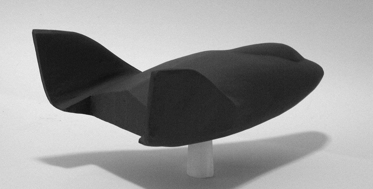

Shaw Posted January 9, 2023 Author Share Posted January 9, 2023 Thanks! I'm still waiting on some supplies I need to move forward, but here is the first primer coat on the SV-5... Quote Link to post Share on other sites
crackerjazz Posted January 9, 2023 Share Posted January 9, 2023 Very nice, Shaw. And that info about how you took the outline of the windows is extremely useful. Thanks for sharing : ) Quote Link to post Share on other sites

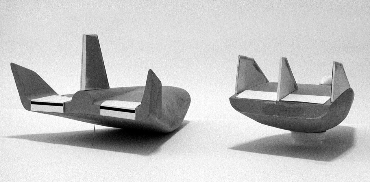

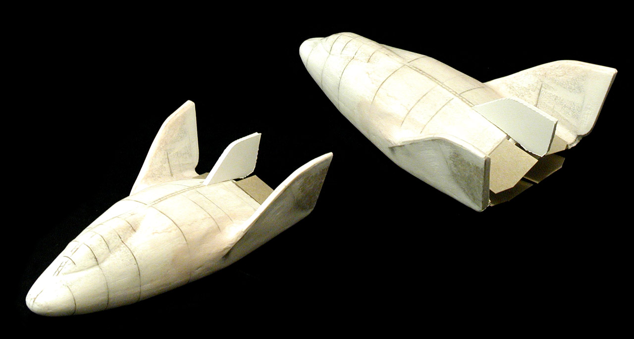

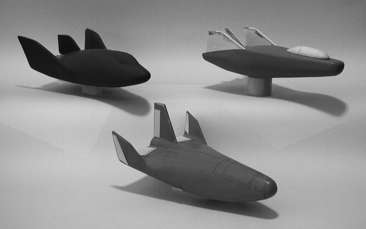

Shaw Posted January 14, 2023 Author Share Posted January 14, 2023 Thanks! Sometimes I'm not sure what to include as far as build details because I figure you guys have so much more experience at this stuff than I do. Here is a quick family portrait of the masters... The SV-5 has had its first puttying and second primer pass, and I made the X-24A center fin master out of styrene. They're darker because my wife couldn't find Rust-Oleum so I'm using Krylon primer on this one. I believe these are all of the masters (bodies, fins and the M2-F3 canopy) I'll be making molds of. I'm still working out how I'm going to approach this with the odd shapes of the bodies. Quote Link to post Share on other sites

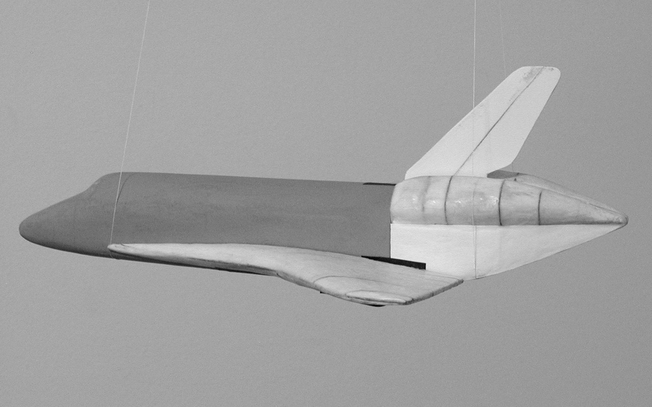

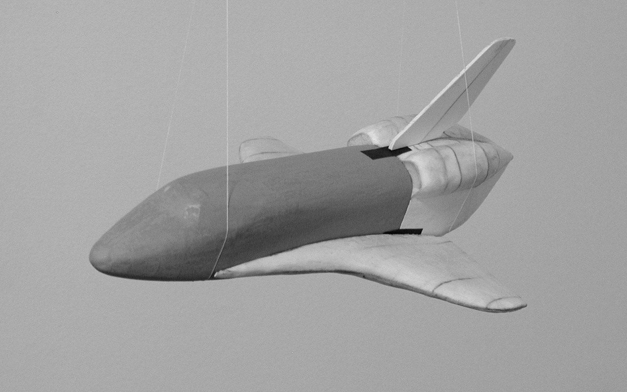

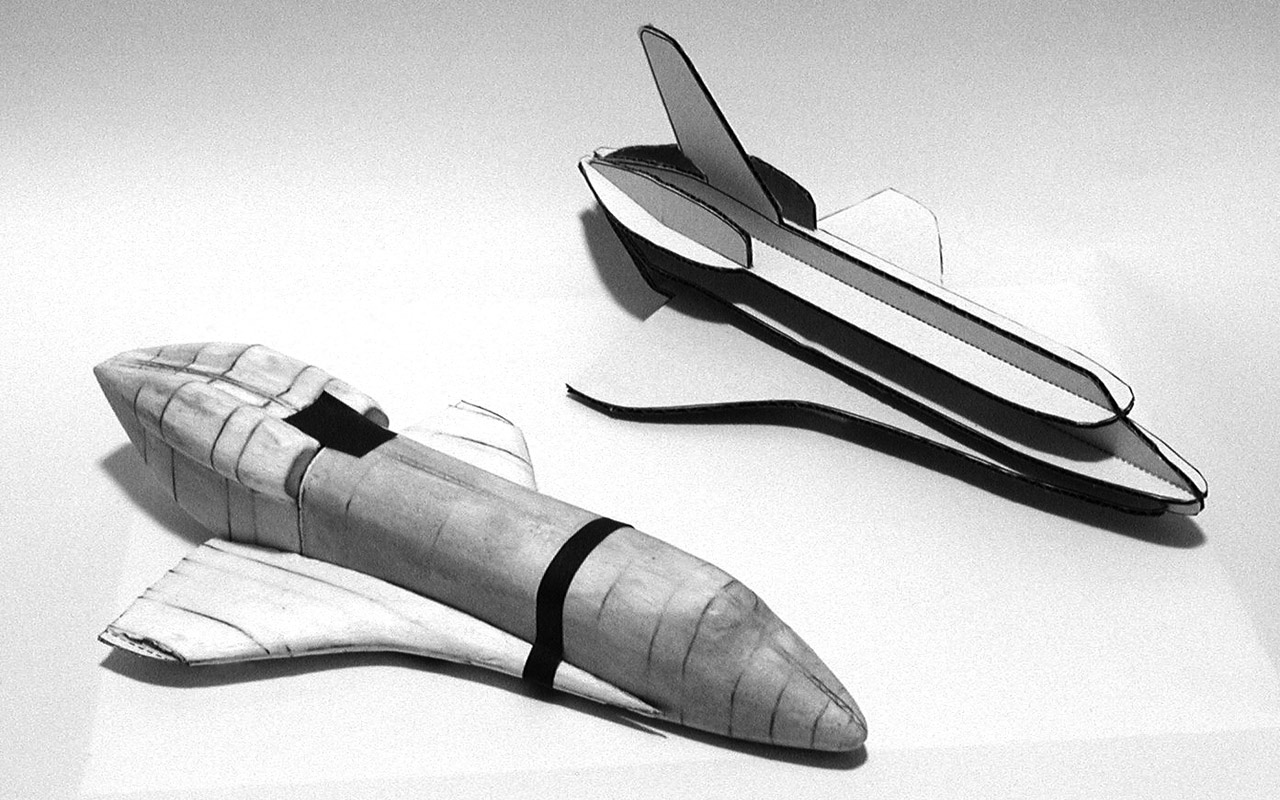

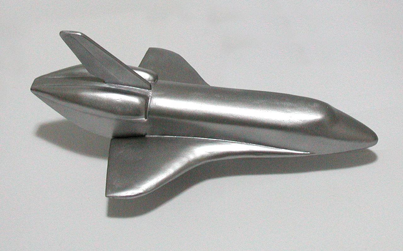

Shaw Posted June 27, 2023 Author Share Posted June 27, 2023 (edited) So I was slowly able to piece together enough silicon rubber to make molds of the M2 parts. The next step is getting the resin I'll need. I had enough resin to make a test canopy, here is that part with the other M2 masters... I had also been plugging away at the SV-5 masters (which are nearly done). But I still wanted to do something more than deal with fixing surface imperfections on that model, so I started in on something else... the Enterprise. I've only ever seen one space shuttle in-person, and that was the Enterprise back in 1978 (it had stopped at our local airport on the carrier 747 to refuel). I figured I'll build it up in her first flight configuration (with the tail cone) because that was pretty much the same way she looked when I saw her. I started by picking a size (1/125 scale, which fit nicely on a 8.5" x 14" sheet), and then I built a mock-up to be sure I was happy with it. After that I started in on making my dumpster diving masters (made out of whatever I could find). Here is the mock-up and the WIP masters as they currently stand... This isn't meant to be a hyper accurate/detailed model, just something to do while I wait for the materials I need to finish my other models. Edited June 27, 2023 by Shaw Quote Link to post Share on other sites
Shaw Posted July 10, 2023 Author Share Posted July 10, 2023 Still waiting on some stuff I need, but here are a few shots of my progress on the Enterprise... Quote Link to post Share on other sites

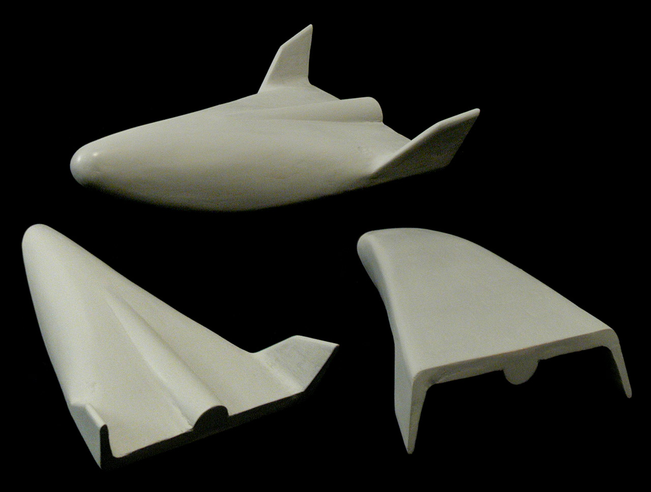

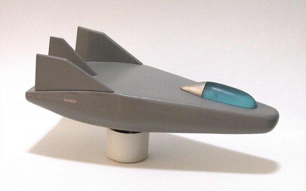

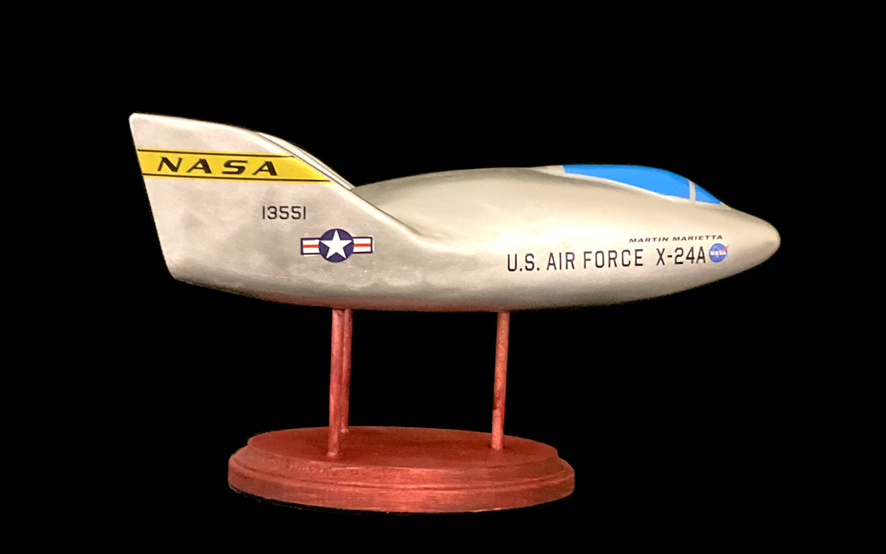

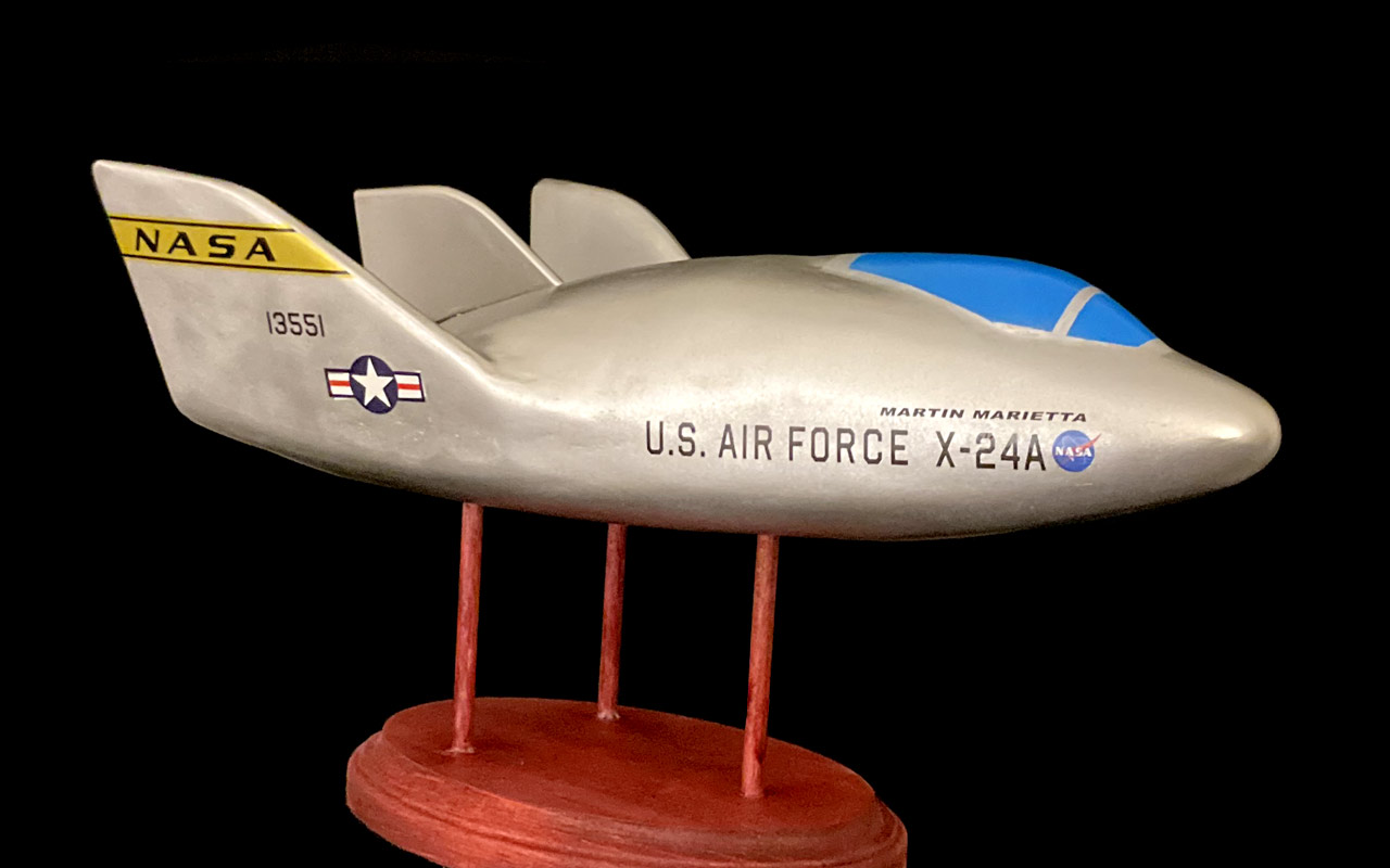

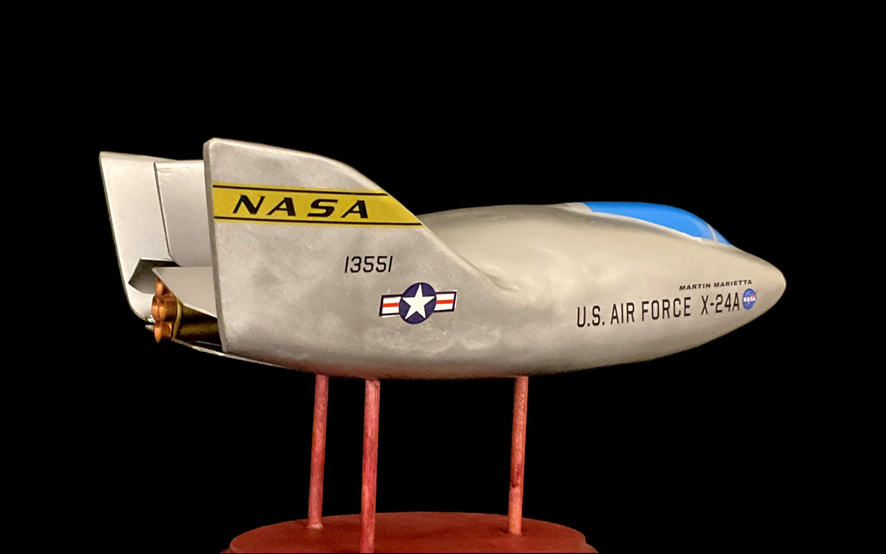

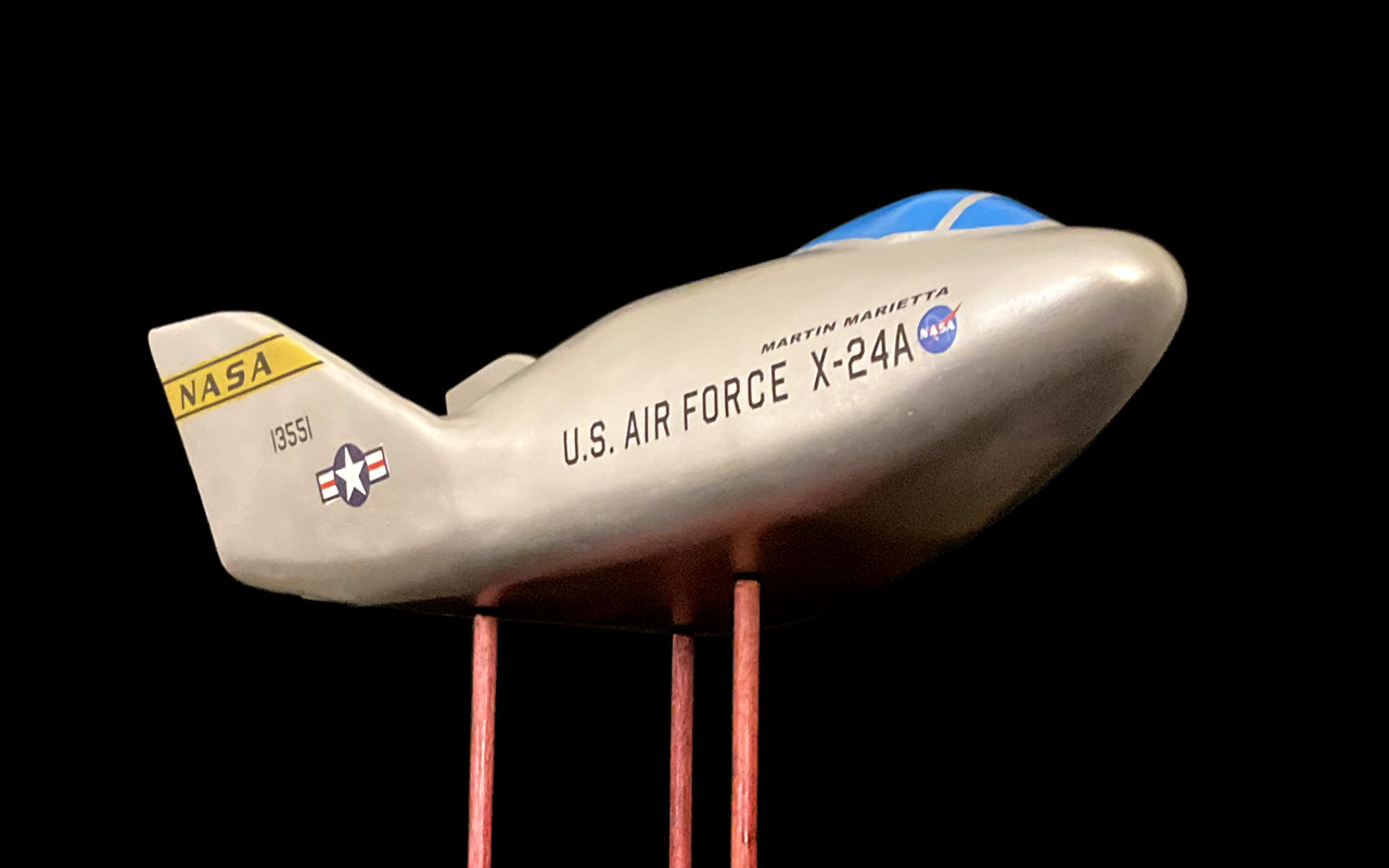

Shaw Posted June 25 Author Share Posted June 25 Thanks! This project had stalled a bit, but I hope to make some more progress on it soon. I did finally get some silicone rubber, and made molds of the Enterprise parts. With those molds ready, I figured I'd test how all the parts fit together by assembling the masters. Here is how that test turned out... I also really wanted to see one of the lifting body designs completed, so I decided to throw together the masters of the X-24A (as it is the one I was least invested in). Here is how it turned out... This is the model right after painting... And after I applied some decals I created for it... Quote Link to post Share on other sites
southwestforests Posted June 25 Share Posted June 25 Looks like the tests got a passing grade. 😁 X24-A very much captures the look of an industry model you'd see in someone's office. Don't know/recall whether that is the goal you were shooting for, but it very much hits the mark if that was indeed the target. 🎯 Quote Link to post Share on other sites
