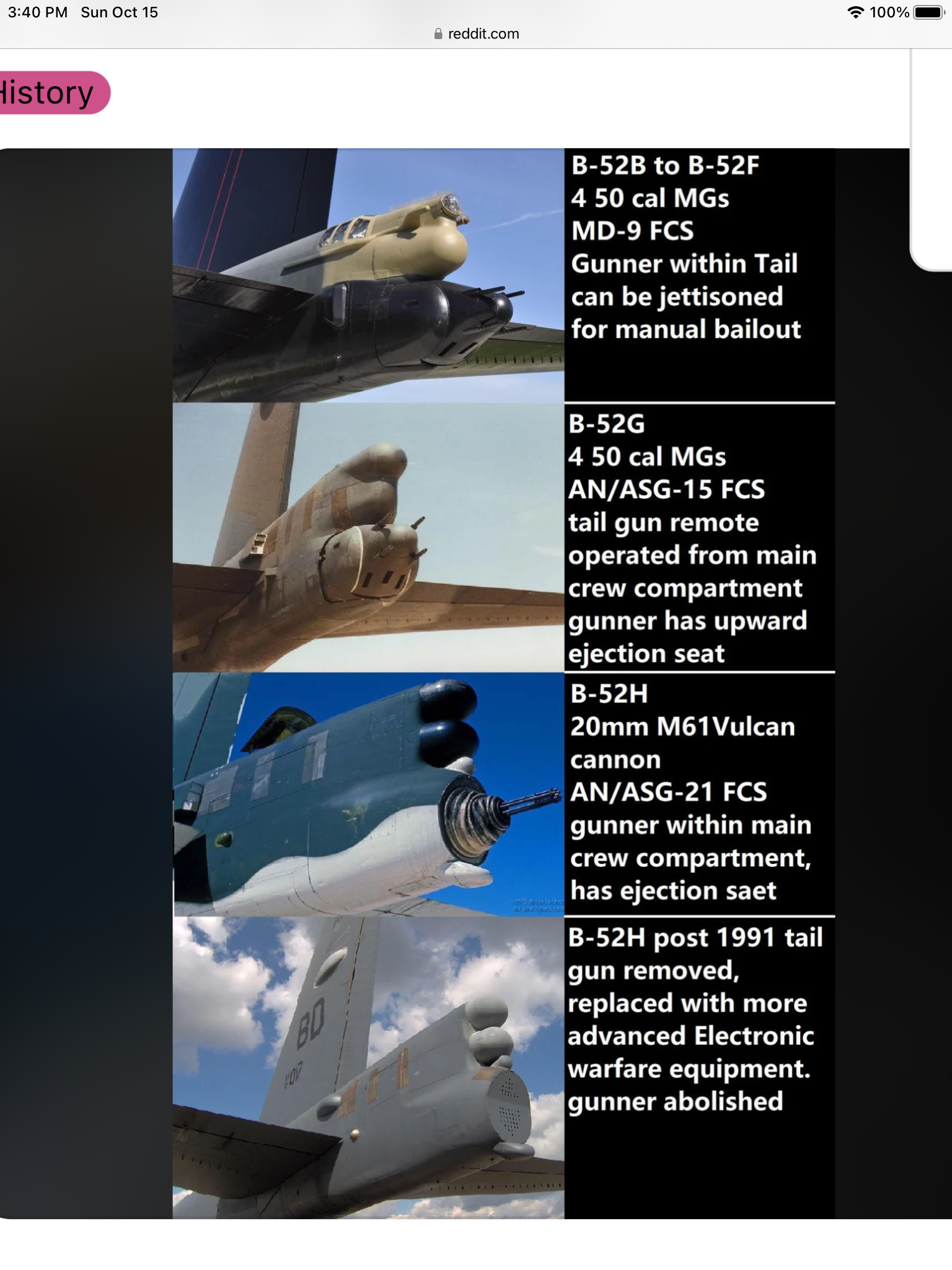

serendip Posted October 15, 2023 Author Share Posted October 15, 2023 Thanks again for the info Norm. I'll check the engines and see how far off they are. Regarding the droop, thanks. So a combination of a lack of a downward angle at the root and between the engines. Regarding the tail section you're sure the D would have the same dimensions? - i.e., all they did was fill the gunner's position with ECM instead? Regarding the TF-33 I get it now. I can't find Titan on the internet. Some good 3D printed J57's including nacelles would be a godsend also but again I cannot find much on the internet and Scalemates, though a great site, seems not to have discovered 3D printing yet. Marc. Quote Link to post Share on other sites
serendip Posted October 15, 2023 Author Share Posted October 15, 2023 Here's the rear of a 'G from the rear: http://data3.primeportal.net/hangar/bill_spidle2/b-52g_57-6509/images/b-52g_57-6509_108_of_173.jpg http://data3.primeportal.net/hangar/bill_spidle2/b-52g_57-6509/images/b-52g_57-6509_111_of_173.jpg Quote Link to post Share on other sites
serendip Posted October 15, 2023 Author Share Posted October 15, 2023 It would seem the left and right pivotable gun housing defines the breadth: http://data3.primeportal.net/hangar/bill_spidle2/b-52g_57-6509/images/b-52g_57-6509_109_of_173.jpg Quote Link to post Share on other sites
Norm DUbay Posted October 15, 2023 Share Posted October 15, 2023 Hi Marc, Look on EBay with the username heavykits or search for Click2details on the internet. The same quad 50 cal was the same on both the D and the G so they have to be the same dimension at this point. I’m pretty sure I compared the the guns from the Monigram D and Italeria G and the G kit was undersized. Quote Link to post Share on other sites

Norm DUbay Posted October 15, 2023 Share Posted October 15, 2023 Quote Link to post Share on other sites

serendip Posted October 16, 2023 Author Share Posted October 16, 2023 On 10/15/2023 at 3:52 PM, Norm DUbay said: Hi Marc, Look on EBay with the username heavykits or search for Click2details on the internet. The same quad 50 cal was the same on both the D and the G so they have to be the same dimension at this point. I’m pretty sure I compared the the guns from the Monigram D and Italeria G and the G kit was undersized. And agreed Norm the guns do look somewhat scrawny on the AMT / Italeri kit. Quote Link to post Share on other sites

serendip Posted October 19, 2023 Author Share Posted October 19, 2023 If the breadth of the rear fuselage aft of the tail is too narrow this should be fixable. I think someone mentioned 6 mm which is some .2 inches in real money. That's doable. But as Norm and others pointed out the whole gun unit on the AMT kit is also probably underscale. How will that then fit nicely with the widened rear section? I have no idea how to correct the gun unit to be compatible with a widened rear fuselage. All theories and / or suggestions welcome. Marc. Quote Link to post Share on other sites
