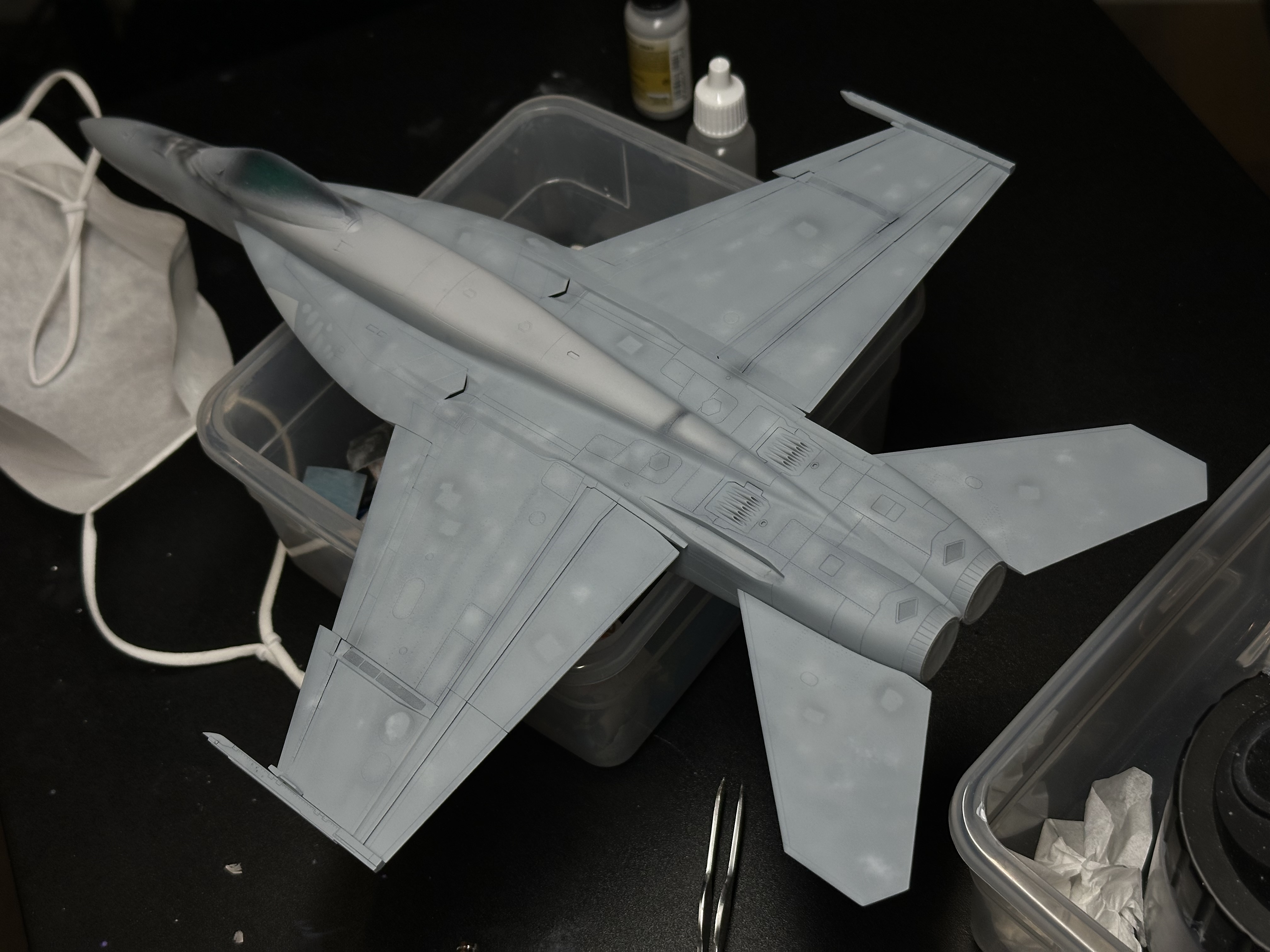

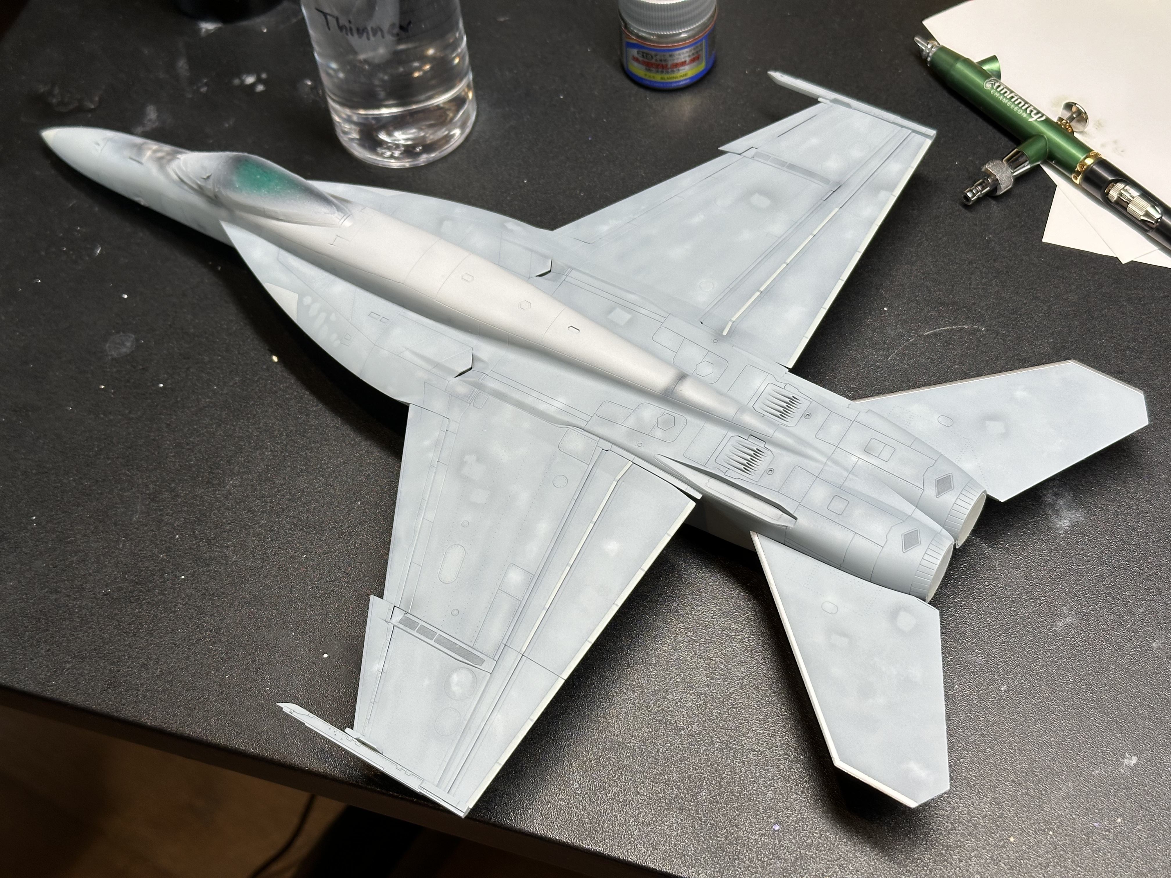

Kazu Posted February 1, 2024 Share Posted February 1, 2024 Last time I made an aircraft was almost 30 years ago, so I'm trying the preshading technique for the first time. This kit had some fit issues (or I get the sense that they didn't engineer it to be fool-proof), but overall is a nice kit. 3D-printed color cockpit details (Quinta) are a new thing for me too, and it's amazing how much more detail we can put in there with hardly any effort. I used a KASL resin ejection seat this time, but it seems like the best 3D-printed ones are now beating resin-cast ones in terms of quality consistency (my KASL piece had a lot of detail destroyed or unrecoverably warped in the casting process) so I'm looking forward to using them in my next projects. I'm also using Vallejo Model Air paints for the first time, and struggling to keep the airbrush tip from drying (and thus clogging) when doing fine work. In any case, while these iPhone photos aren't great, here are some in-progress shots. The studio-photography treatment will have to wait until it's done. Quote Link to post Share on other sites

Thadeus Posted February 3, 2024 Share Posted February 3, 2024 Nice project. It's looking pretty good. For the dry tip on Vallejo, they have a paint retarder that slows drying time a bit. Quote Link to post Share on other sites
Kazu Posted February 3, 2024 Author Share Posted February 3, 2024 I use a 0.2mm needle at 10-15 PSI, and thin the Model Air/Model Color paints using Vallejo's thinner and Flow Improver (inside the airbrush with a paintbrush) at about 1:1 paint to thinner and anywhere from 8% to 100% for the percentage of the flow improver for the thinning side. Even at those settings, it's hard to get a really smooth flow (one that isn't speckled when it comes out) and without dry tipping. I like the final results, the fact that it's less toxic, and that colors are more military-modeling friendly...but coming from using Gunze and Gaia lacquers, I'm finding this medium very difficult. Switching to a 0.4mm needle and trying not to do such fine spraying helped, but it's still dry tipping. Quote Link to post Share on other sites

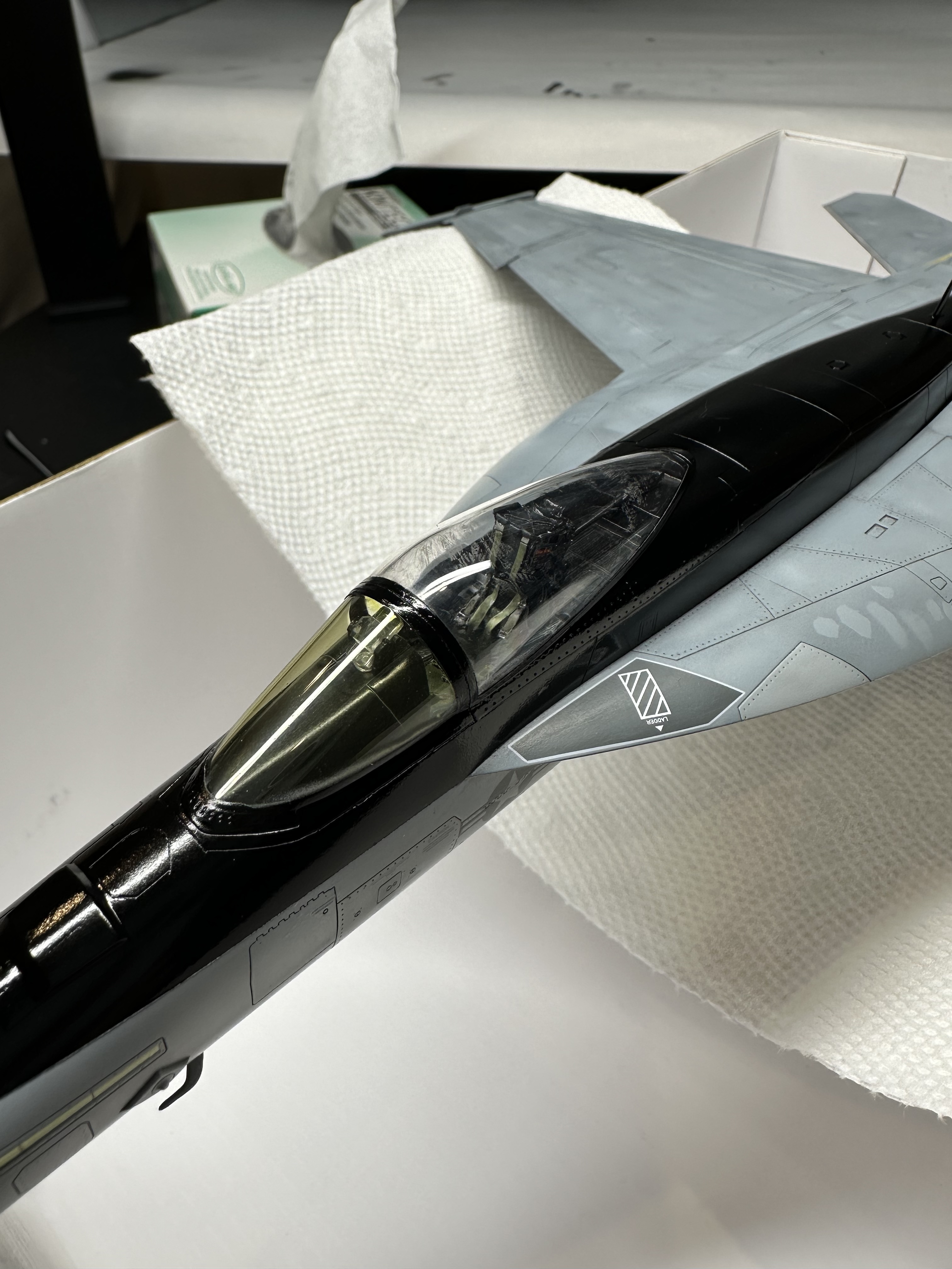

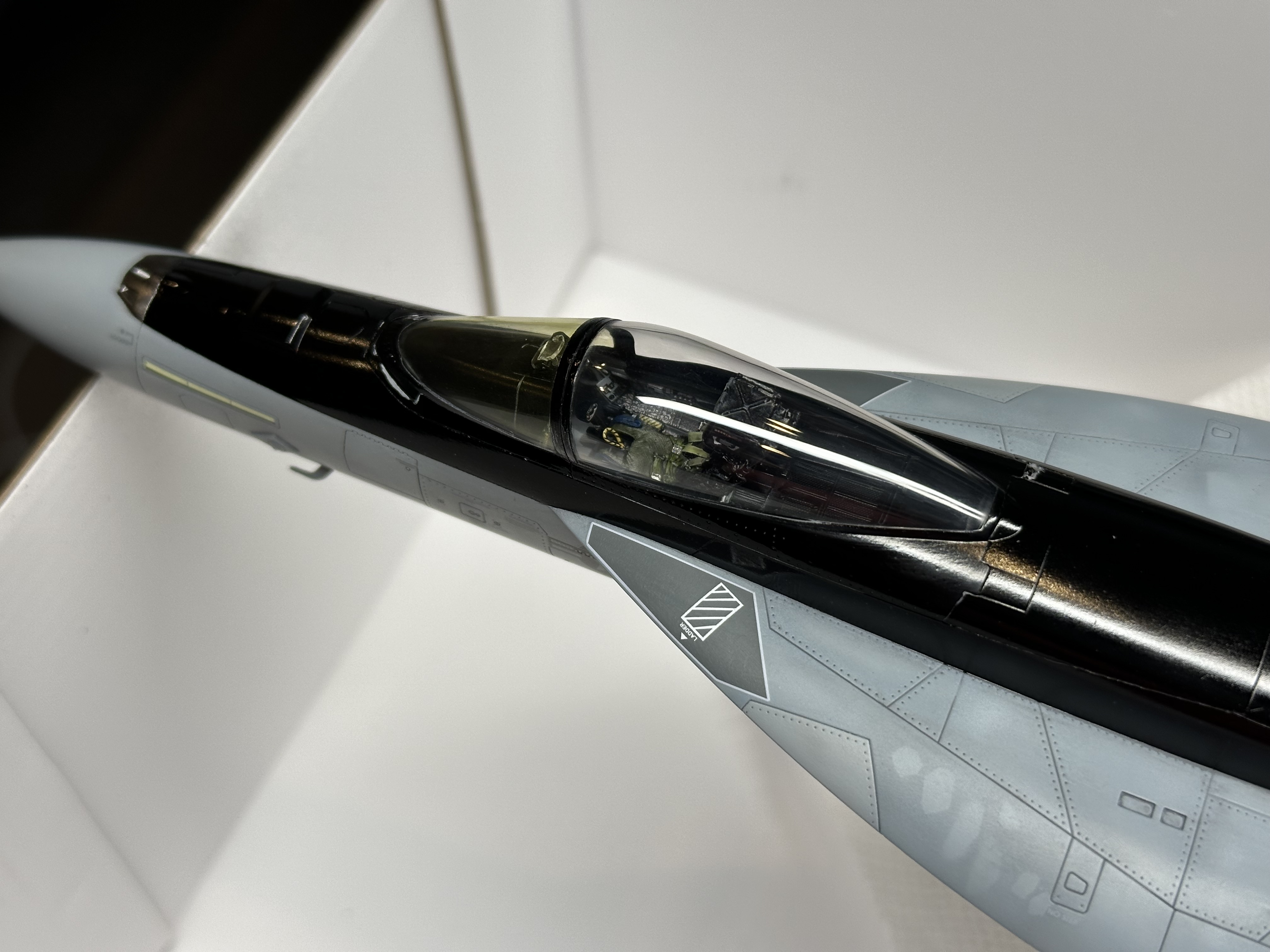

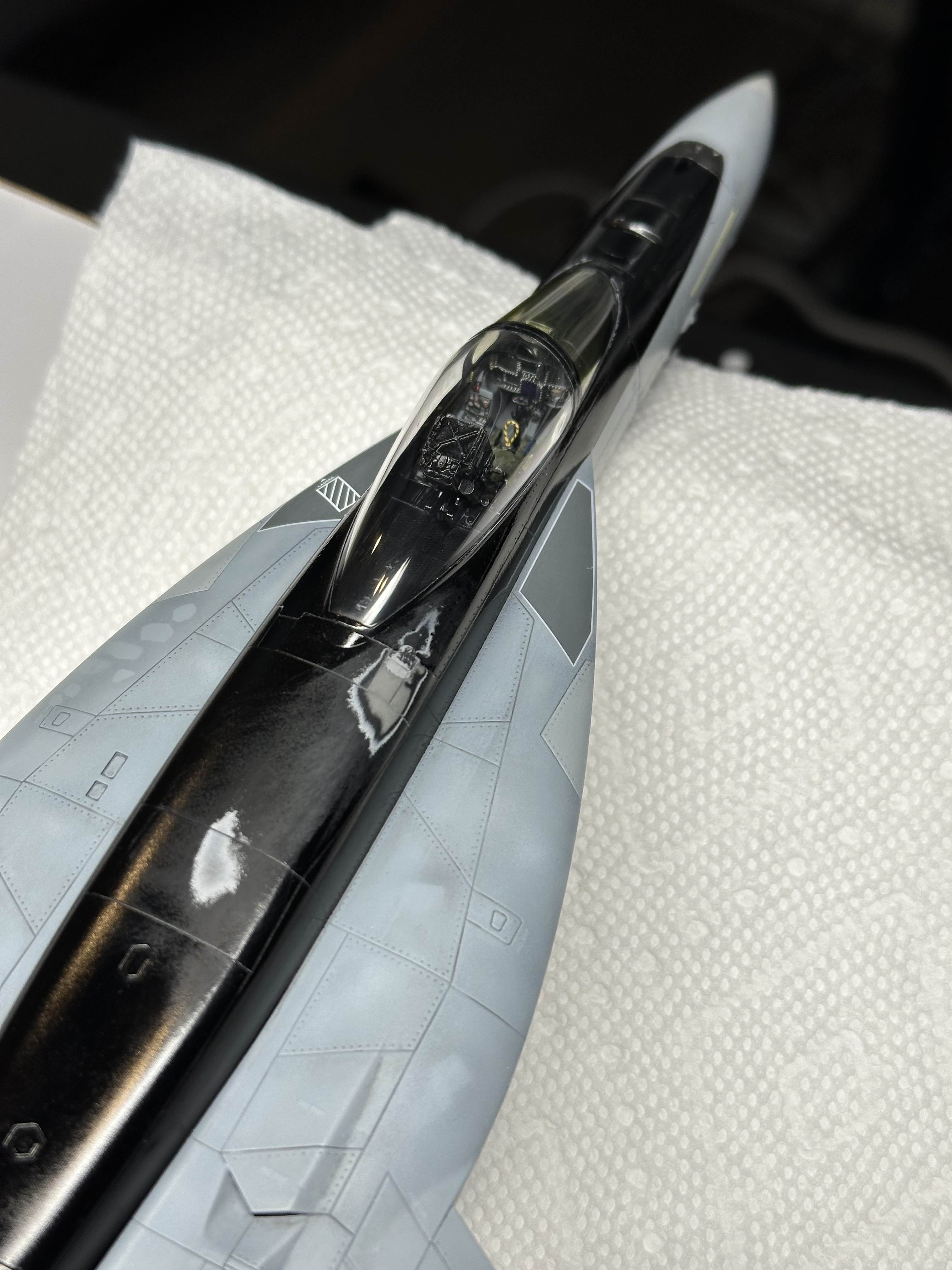

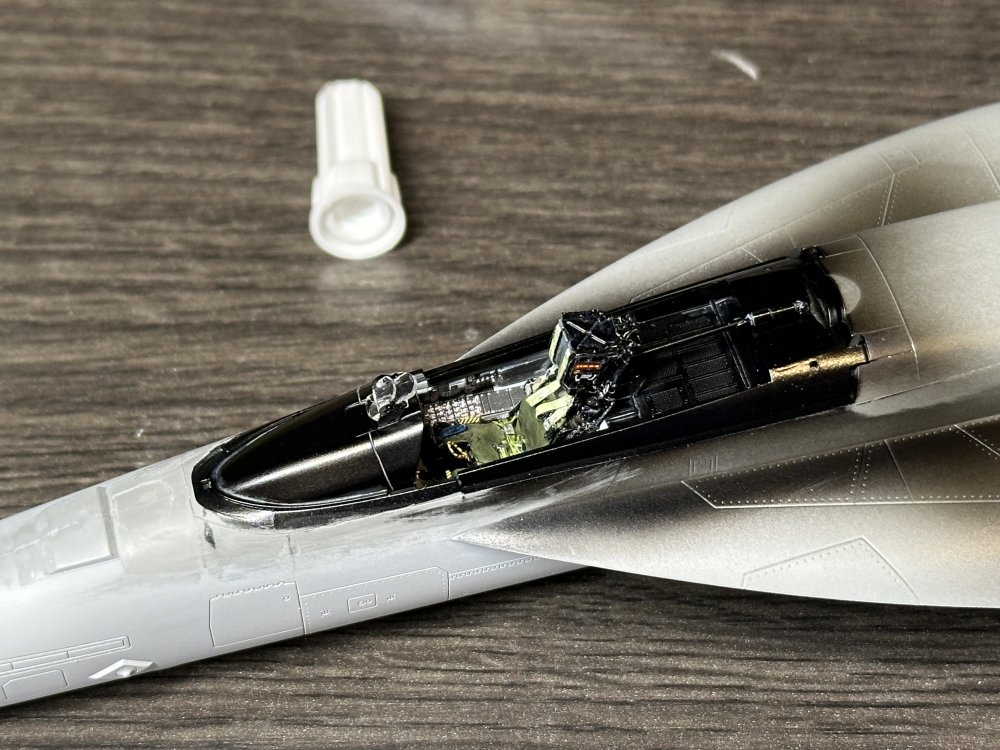

Kazu Posted February 11, 2024 Author Share Posted February 11, 2024 I've finished panel lining and applying most of the body's decals, so was able to start working on the glossy-black spine area. I peeled back the canopy masks and discovered some paint that sprayed underneath them as their edges had lifted over time (had to sand off and repolish), but then realized that patterned dust appeared inside the canopy. It's not CA glue craze because that's not what I used. Maybe paint fumes that got in from small holes that lead to the cockpit or the Extra Thin Cement. Anyway, given that the cockpit is sealed and the cement is supposed to fuse plastic together, I thought I was doomed because such surgery would have the risk of ruining the entire project. Turns out, the clear plastic is so dense, the solvent didn't penetrate it enough (that was my hope, which made me take the risk), so I drilled small holes behind the canopy where it's relatively easy to fix, and pried apart the area...and it worked with minimal damage. I cleaned out the insides, sanded/repolished the parts, and it looks better than ever now. Crisis averted... This time, I used tiny amounts of wood glue so it's not so permanently attached. The damaged areas have been filled and sanded, so I can get back to painting the black and applying the signature blue decals of Maverick's aircraft... Quote Link to post Share on other sites
CFster Posted February 14, 2024 Share Posted February 14, 2024 Prepare a thinner pre-mix to keep on hand for future airbrushing sessions: 80% Vallejo Airbrush Thinner 10% Liquitex Flow Aid Additive (Purple Label) 10% Liquitex Slow-Dri Fluid Additive (Purple Label - not Green Label) If you’re in an arid climate and/or are still experiencing tip dry then that mix can be adjusted as far as 60/20/20 for fine line work at low pressures (less than 12psi) but you may run into adhesion and drying issues. Dilute “airbrush ready” water based acrylic paints such as Vallejo Model Air and Game Air to 30% with your thinner mix: 70% paint : 30% thinner. Dilute regular water based acrylic paints such as Vallejo Model Color and Game Color to 70% with your thinner mix: 30% paint : 70% thinner. Quote Link to post Share on other sites
Kazu Posted February 14, 2024 Author Share Posted February 14, 2024 Thanks, CFster. It sounds like the process I'm using is very similar to your suggestions, except for the Liquitex stuff. Is their stuff really that different from Vallejo's? My experience is that while the thinned mixture doesn't come out totally smoothly (the pattern it makes out of the airbrush is speckled, unlike with GSI or Gaia lacquer paints), it's still thin enough that the final result is smooth after the layers build up. But it's so strange that I can't get very smooth flow out of the airbrush directly. I'm also thinning the Model Air and Model Color paints in similar ways...the guideline being that it has to be runny enough like skim milk to flow, but not so diluted that it'll affect drying or adhesion. Quote Link to post Share on other sites

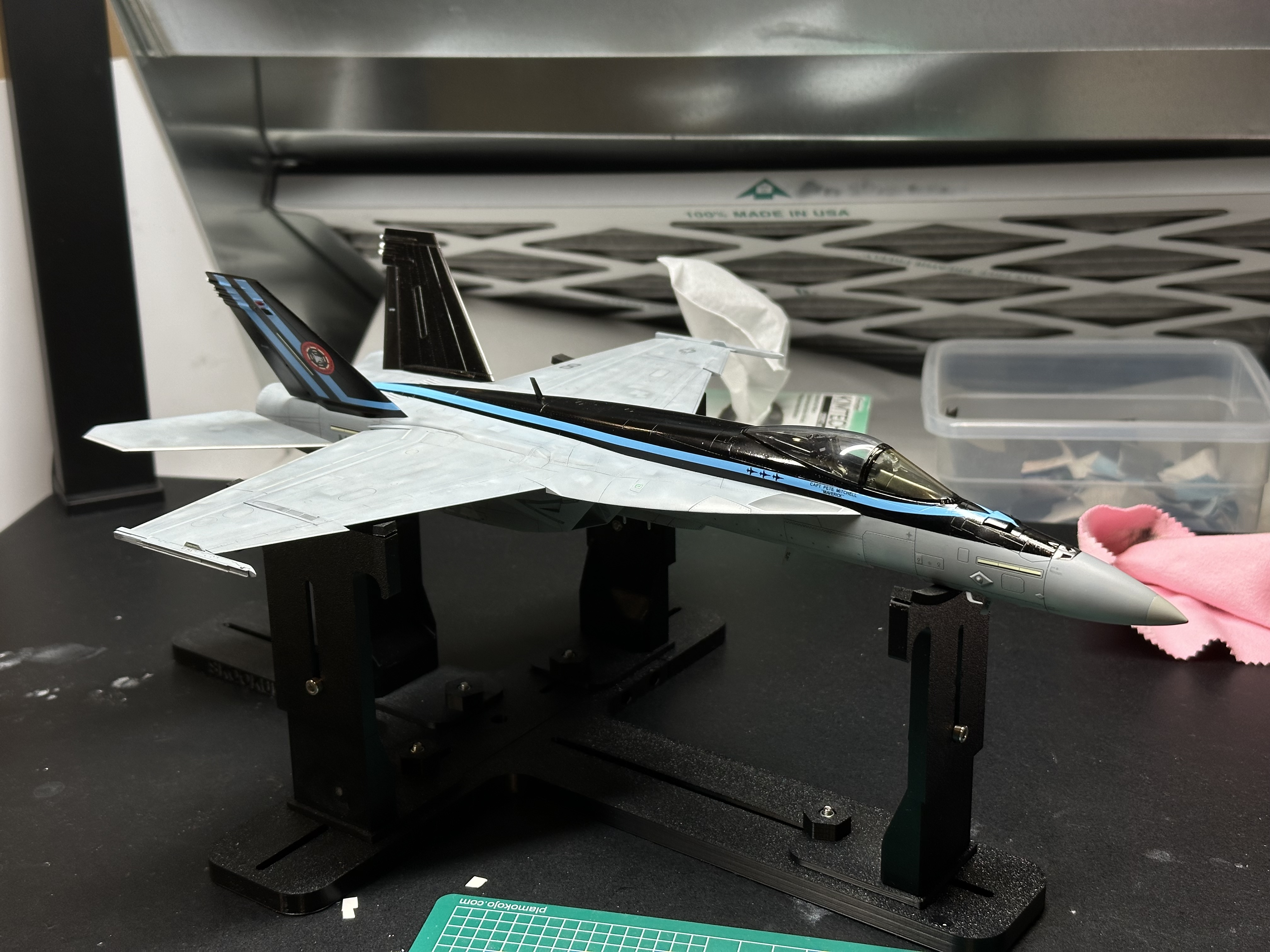

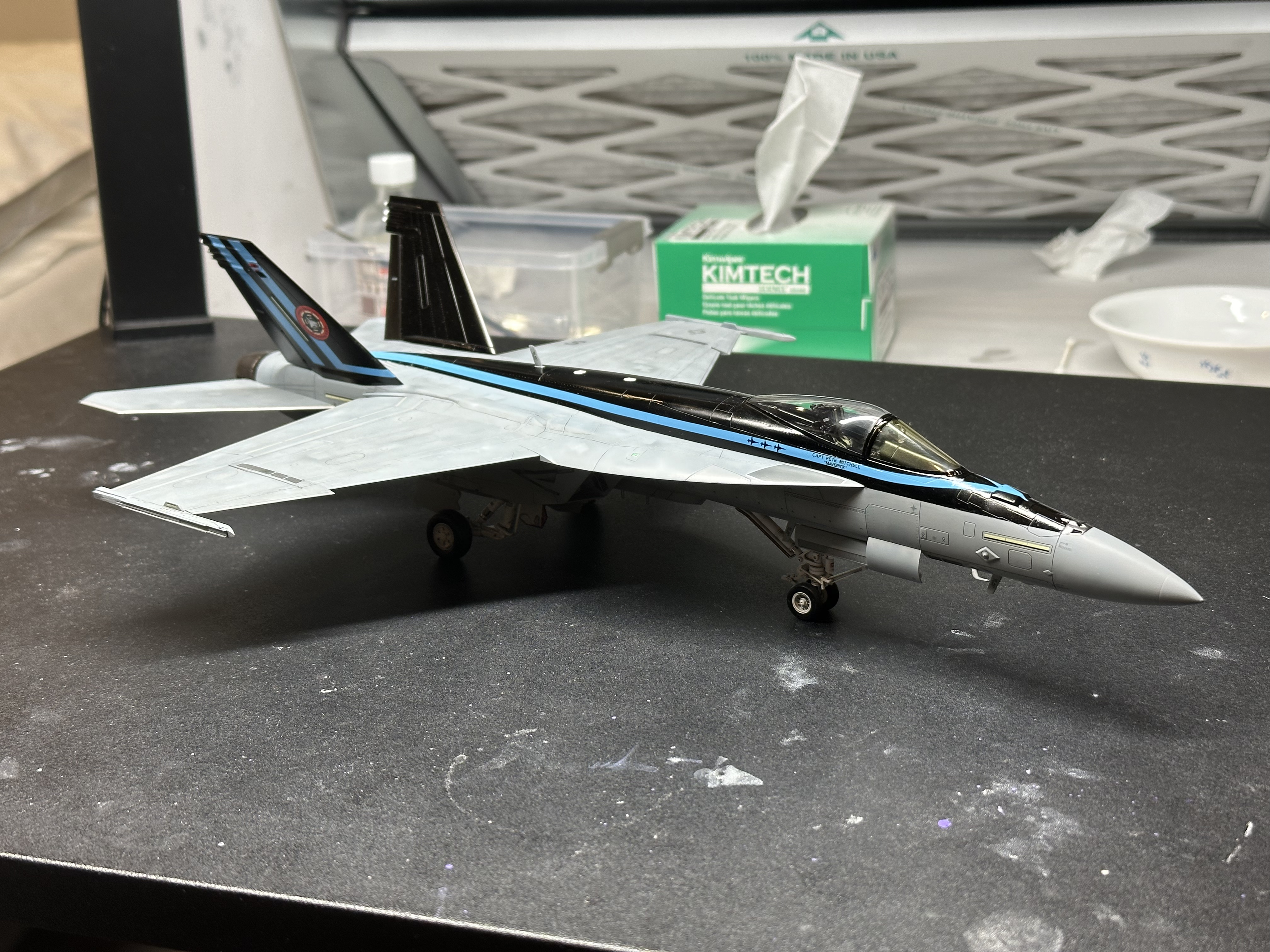

Kazu Posted February 27, 2024 Author Share Posted February 27, 2024 I'm almost finished with the aircraft itself. Some panel lining and weathering remain. Painting the 1/48 Tom Cruise figure with his motorcycle will be a project in itself. Still waiting for decals from China and the training ordnances from Japan. Quote Link to post Share on other sites
