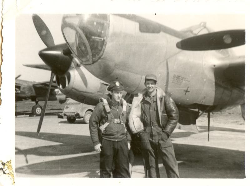

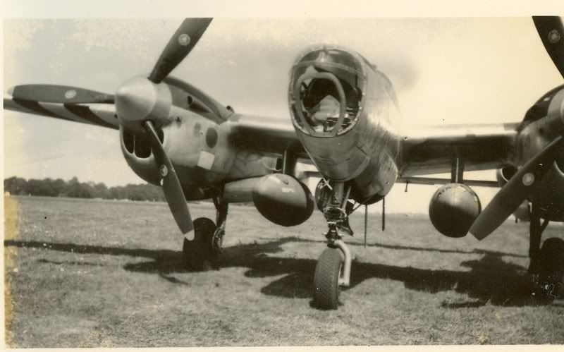

P-38 guy Posted January 5, 2008 Share Posted January 5, 2008 I think Airwaves make a PE set for the Droopsnoot in 1/48. I've never come across any photo's of the inside in any of the books or original pictures I have. I just got these 2 in a trade yesterday but there still not really any help. Mike Quote Link to post Share on other sites
latormentabritanica Posted January 6, 2008 Share Posted January 6, 2008 (edited) Great pictures! Any idea what unit they are from? Funny, I've never seen any detailed pictures or schematics for the droopsnoot P-38. Edited January 6, 2008 by latormentabritanica Quote Link to post Share on other sites
P-38 guy Posted January 6, 2008 Share Posted January 6, 2008 Top one is from the 474th FG not sure about the other one yet. Mike Quote Link to post Share on other sites

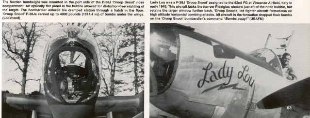

AX 365 Posted January 6, 2008 Share Posted January 6, 2008 Here's a couple of photos from page 148 of Roger Freeman's The Mighty Eighth "Col. Hough prepares to climb into the cockpit of the Droop Snoot while Col. Don Ostrander enters the nose through the top hatch." "Interior of the Droop Snoot nose. Stand for bomb sight forward of bombardier's couch. Instruments and control panel on right side. Note shadow of entrance hatch." These are digital photos of the photos in the book. I hope they help. Mike Quote Link to post Share on other sites
P-38 guy Posted January 6, 2008 Share Posted January 6, 2008 Wow! Thats the first picture I've seen of the inside. I have seen the top hatch before. Thank you! :blink: Mike Quote Link to post Share on other sites

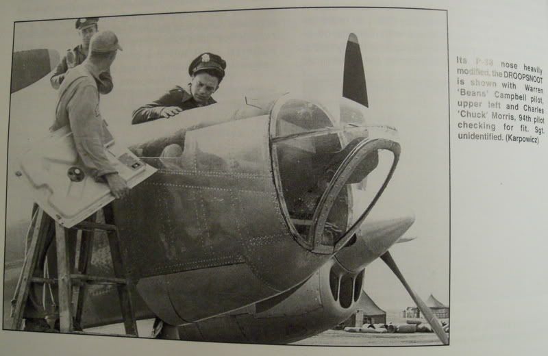

P-38 guy Posted January 6, 2008 Share Posted January 6, 2008 Ok, I've found some more info that might help. I found this discripition in the Warbid Tech on the P-38. I then found these pictures of the Droopsnoot that was modified for electronic surveillance. If you look under the picture there is a "next" to see a couple of more pictures of this plane. I would have to guess that the seat set up was the same in the regular Droopsnoot and the Pathfinder. http://www.littlefriends.co.uk/gallery.php...p;searchString= Also I would say that a Pathfinder would have a simular setup to the "electronic snooper" but with a radar scope instead of some of the other instruments. In this picture it looks like the bombardier is leaning forward and looking out the nose. http://p38assn.org/images/p38s/droopsnoot.jpg I'm going to keep searching for more info and will post what I find. Mike Quote Link to post Share on other sites
