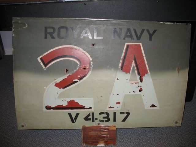

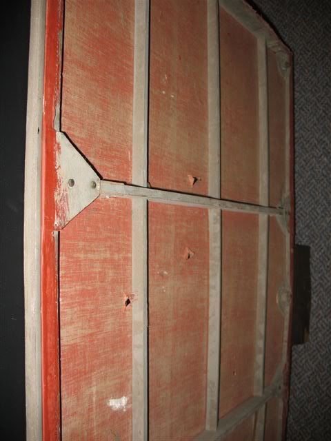

Mrp Posted March 26, 2007 Share Posted March 26, 2007 In my collection, I actually have a panel off a Swordfish. It is untouched and genuine . I have attached a couple of pictures to give you an idea of what it actually looks like. Hope it helps. MRP IMG]http://img.photobucket.com/albums/v703/MRLP/IMG_2325.jpg[/img] Quote Link to post Share on other sites
martin_sam_2000 Posted March 27, 2007 Author Share Posted March 27, 2007 great pics. that really gives me a good idea of waht i have to do. A good way to get the right effect, Sir, is to paint the surface white first, then go over it with streaks of Model Master 'British Crimson' Enamel, which is very close to the P.C. 12 dope shade, and then do a couple of thin coats of a buff or cream shade, that the streaks will show nicely through. i was thinking of reversing this process. paintthe crimson red on first then airbrush a very thinnned down coat of white. does anybody know if this will work?? does anybody have any other ideason how to do this?? Quote Link to post Share on other sites
