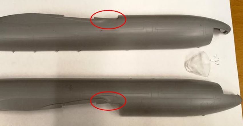

I have a couple AMP 1/144 KC-10s ordered since late October.  I expect them any day now!  They are based on the new Eastern Express DC-10-30 (late) kits which feature all the latest mods on the DC-10, including the forward wing to fuselage bulge that is missing from the Revell KC-10 kit.   I'll post phtos when they arrive, unless someone else beats me to it.

@okthree, The AMP / MikroKir KC-10 kit is the Easter Express kit plastic depicting a very late DC-10-30 passenger jet with all the latest mods. McDonnell Douglas kept adding improvements to the DC-10 as it was in production.  So, even though an operator may have two similar model airframes,  i.e. DC-10-30CF, depending on what line number they were, one may have certain aerodynamic mods versus the other one.  Some simple mods were retrofitted to earlier examples, such as the small fillet atop engine No 2 in front of the vertical stabilizer, but many were not retrofitted.  For a decent run-down of the DC-10/MD-11, see Dave Hingten's excellent article on AirlinerCafe. The USAF KC-10s were some of the last DC-10s to be produced, so they had all the aerodynamic mods built in, along with the military refueling mods.  Dutch KDC-10-30CFs were early to mid prodcution DC-10s from the Martinair batch that received some retrofit mods.  To depict a Dutch KDC-10-30CF, at a minimum you will need to remove the forward fuselage-wing bulge. Check photos online. HTH, Dutch
