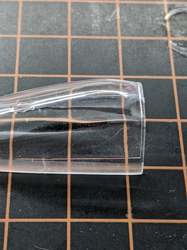

I ran an experiment using the Micromesh sanding pads, and some Novus #2 and #3 polish with a motor tool.  The results aren't bad.  I deliberately scuffed a piece of clear styrene (an old Monogram SB2C canopy) with some 600 grit sandpaper.  Next, I used the entire Micromesh set, followed by the liquid polishes.  Although the canopy polished to a shine and was reasonably clear, it still had some noticeable scratching.
I also tried some Tamiya polishes, and they seemed to work about the same as the Novus stuff.
I suspected that I should have started with some of the finer grits in the Micromesh set, such as 2400 mentioned by @AlienFrogModeller.   I'll test again on that basis.
I've dipped canopies in Future in the past, with success.  But I'd like to see if I can do without that step, for various reasons, and I suspect it's possible.
