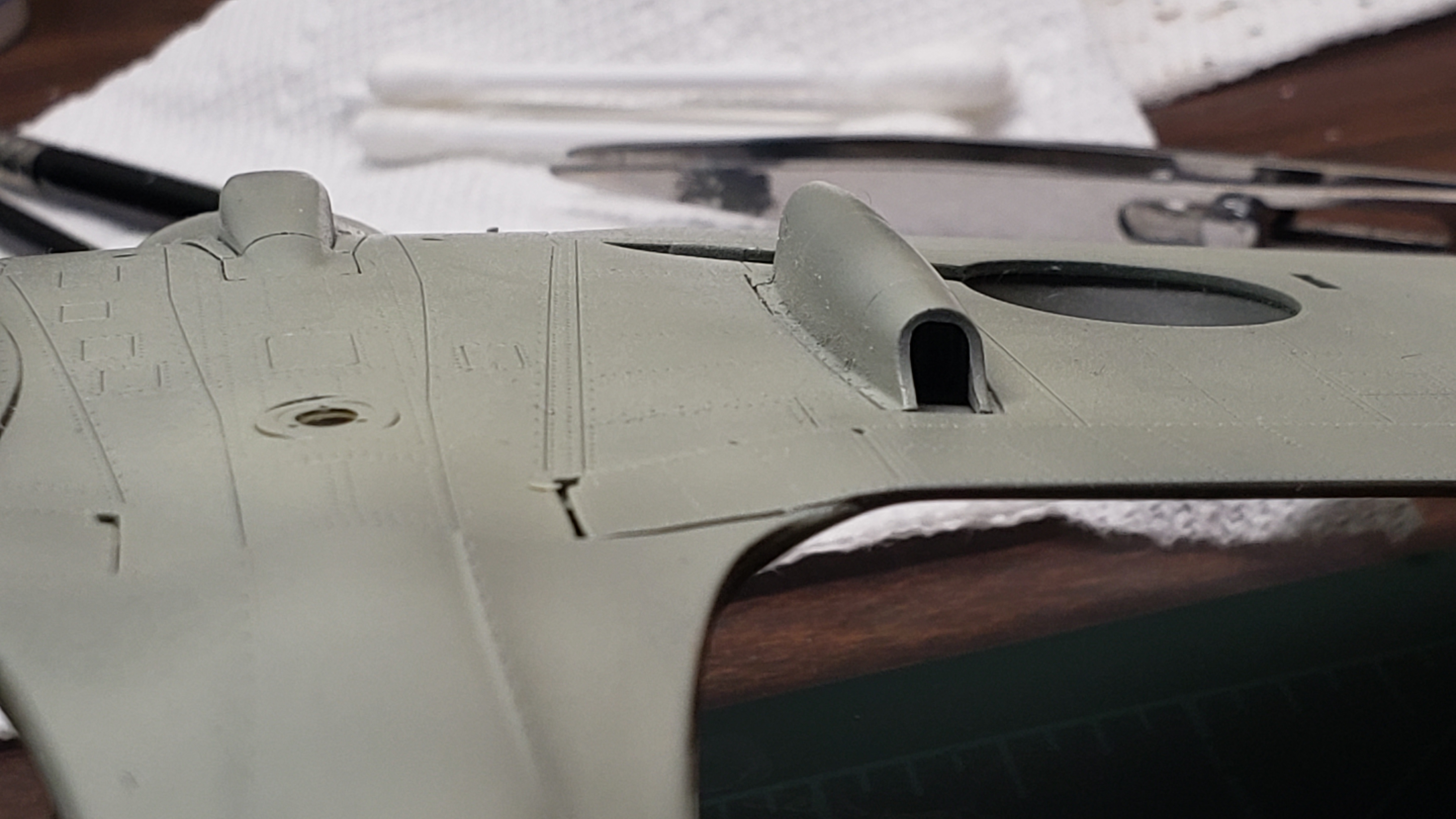

MA Cooke Posted March 22, 2021 Share Posted March 22, 2021 You all have been quite helpful. Now I'm stymied again - I'm (trying to) using the Mr Color clear gloss, and think I may not be thinning or spraying properly. I doing 1 part clear plus 2 parts MC Levelling Thinner, spraying at 15 psi (dynamic), doing a couple of light mist coats first, then when I go to spray a heavier coat, I'm getting a TON of pebbling on any flat surfaces that are in a "valley" of sorts. (Think the underside of an F-14 between the engines, or the underside of a Spitifre near the wing intakes. It's frustrating me to no end. I used half of a 10 mL bottle last night clearcoating the undersides of a 1/48 Tomcat and a 1/32 Spitfire. Argh! Any tips or suggestions? Quote Link to post Share on other sites
Phantom726 Posted March 22, 2021 Share Posted March 22, 2021 Any chance you could show a photo of the pebbling? I've been using GX112 for a coulpe of years now and there's no going back to Tamiya or similar! This stuff rocks! Usually give one or two light coats followed by one heavier and use roughly one part of GX112 to two parts of MLT. Following the last coat I'll typcally give it a good spray of pure MLT and leave it to gas off/dry for at least 24 hours. This really brings out the gloss sheen. Using half a bottle of this stuff for one 1/48 Tomcat and a 1/32 Spit does sound a bit excessive. I'm on my second bottle now and have completed around 10 1/48 jets on the first bottle. This includes additional coats after applying decals and prior to weathering. I'd say beef it up to 20-25 psi and try that on a paint mule! HTH Quote Link to post Share on other sites
MA Cooke Posted March 22, 2021 Share Posted March 22, 2021 6 minutes ago, Phantom726 said: Any chance you could show a photo of the pebbling? I've been using GX112 for a coulpe of years now and there's no going back to Tamiya or similar! This stuff rocks! Usually give one or two light coats followed by one heavier and use roughly one part of GX112 to two parts of MLT. Following the last coat I'll typcally give it a good spray of pure MLT and leave it to gas off/dry for at least 24 hours. This really brings out the gloss sheen. Using half a bottle of this stuff for one 1/48 Tomcat and a 1/32 Spit does sound a bit excessive. I'm on my second bottle now and have completed around 10 1/48 jets on the first bottle. This includes additional coats after applying decals and prior to weathering. I'd say beef it up to 20-25 psi and try that on a paint mule! HTH 20 to 25 psi - I'll try that. One clarification - is that pressure on the gage with no air moving, or what the gage shows when you've got the air valve open on the airbrush? (I'm using an Iwata Eclipse, usually go to 0.5mm nozzle/needle combo for clear. Curious as to the air pressure, though.) Quote Link to post Share on other sites
Phantom726 Posted March 22, 2021 Share Posted March 22, 2021 (edited) That would be the pressure with the airbrush air valve open - so a nice and steady flow of air. I'm using a Badger 200 myself with a fine nozzle although I don't recall the nozzle diameter. Also, when applying the thicker coat(s) don't be too heavyhanded. The last spray of pure MLT will bring out the sheen if you don't achieve it during the last coat of varnish One word of caution: When doing the last spray of pure MLT be very careful: Too much might ruin your entire paint job - too little may have no or just a minor effect on the sheen. I'd highly recommend testing this on a mule first! Let us know how it pans out! Edited March 23, 2021 by Phantom726 Quote Link to post Share on other sites
MA Cooke Posted March 23, 2021 Share Posted March 23, 2021 14 hours ago, Phantom726 said: Let us know how it pans out! The higher pressure worked! I was around 22 - 23 psi, thinned as discussed above, and I'm quite pleased with the results. Here is pic of the underside - it may not be readily apparent, though. I'll probably do some light sanding in the troubled areas with 1500 grit paper, then re-spray the gloss. And you're right, I was using too much. I did the entire upper surfaces of the Spitfire and ancillary parts of my Tomcat with 2 mL of the gloss (with 4 mL of MLT). I appreciate the help! Quote Link to post Share on other sites
Phantom726 Posted March 23, 2021 Share Posted March 23, 2021 Good to hear! Glad it worked out for you. Re. the troubled area you may not need to do a complete respray with the gloss. I'd sand it down gently and possibly just give it a light spray of pure MLT. This will re-hydrate (is that the right word?) the paint and could possibly be enough to restore the sheen. HOWEVER, it may also ruin you paint job if you sand too much of the gloss varnish off so proceed with caution! Phantom out Quote Link to post Share on other sites
