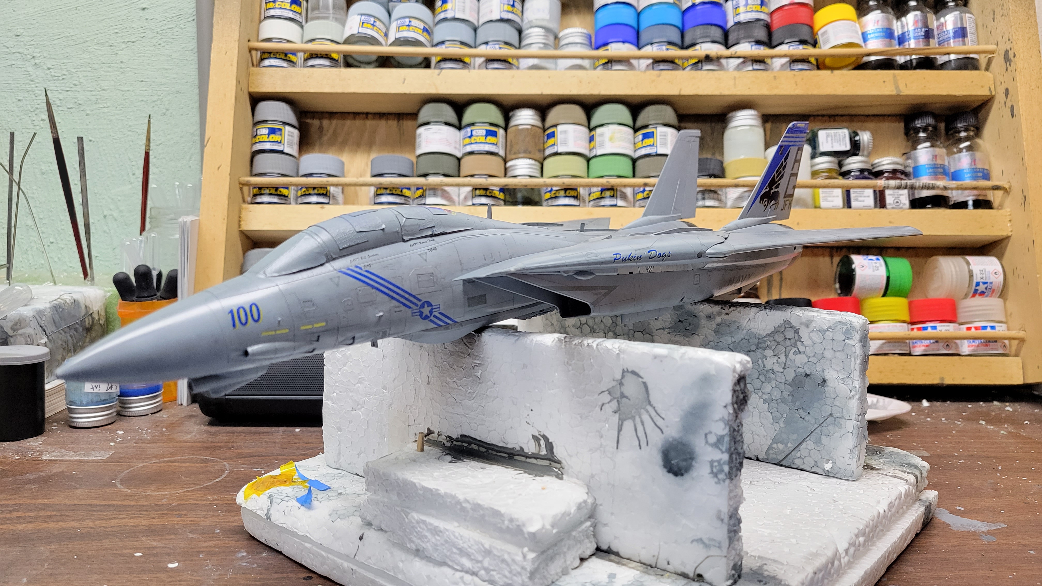

MA Cooke Posted February 18, 2023 Share Posted February 18, 2023 Follow up queation: is it OK to spray Mr. Color lacquers onto (dried/cured) X-22 gloss? Quote Link to post Share on other sites

MA Cooke Posted February 19, 2023 Share Posted February 19, 2023 4 hours ago, viper730 said: Sure can..... Tamiya X-22 It's an Acrylic Lacquer so spraying a Lacquer over top would not be an issue and at any point to be honest. Just be careful to not go too heavy it could reactivate and can ruin the finish. Using Tamiya and MLT I have done all colors including clear coats in one session. Never had one issue with 100's of models completed. To your original question. I do just that for almost every build Seal with X-22 thinned with MLT. Then I use Tamiya Panel Liners cleaned up with mineral spirits. I also use store brand enamel thinner when I run out of mineral spirit. That's what I'm thinking of. I'm almost done with decals on Dog 100, and wanted to seal them up. Quote Link to post Share on other sites
viper730 Posted February 19, 2023 Share Posted February 19, 2023 12 minutes ago, MA Cooke said: That's what I'm thinking of. I'm almost done with decals on Dog 100, and wanted to seal them up. That's one Sexy Centerfold for sure! Currently building Nickel 102 OEF .....and yes that one or a similar VF-143 A/C is on the list. Quote Link to post Share on other sites
MA Cooke Posted February 19, 2023 Share Posted February 19, 2023 1 hour ago, viper730 said: That's one Sexy Centerfold for sure! Currently building Nickel 102 OEF .....and yes that one or a similar VF-143 A/C is on the list. Thanks. This one's sort of running concurrent. Quote Link to post Share on other sites
