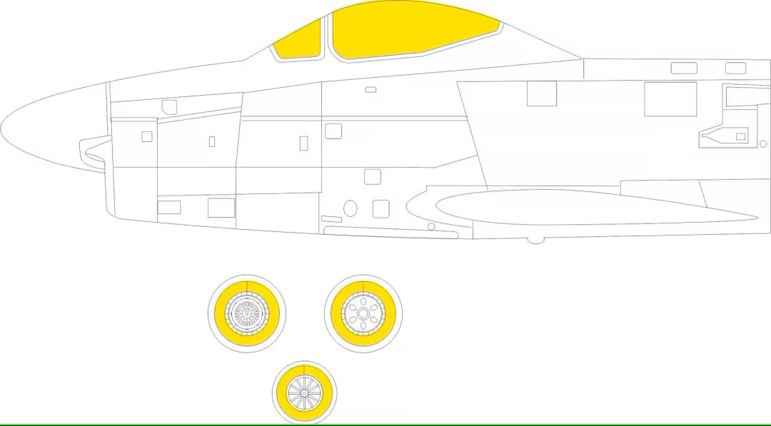

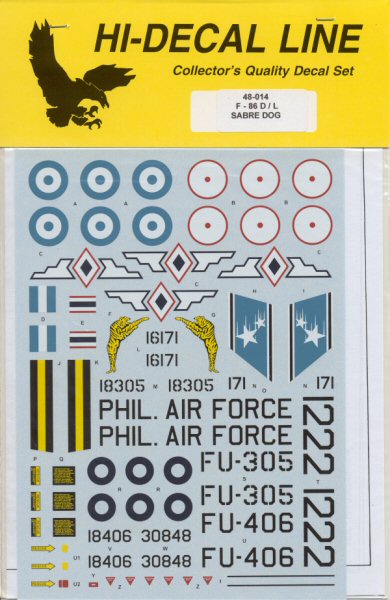

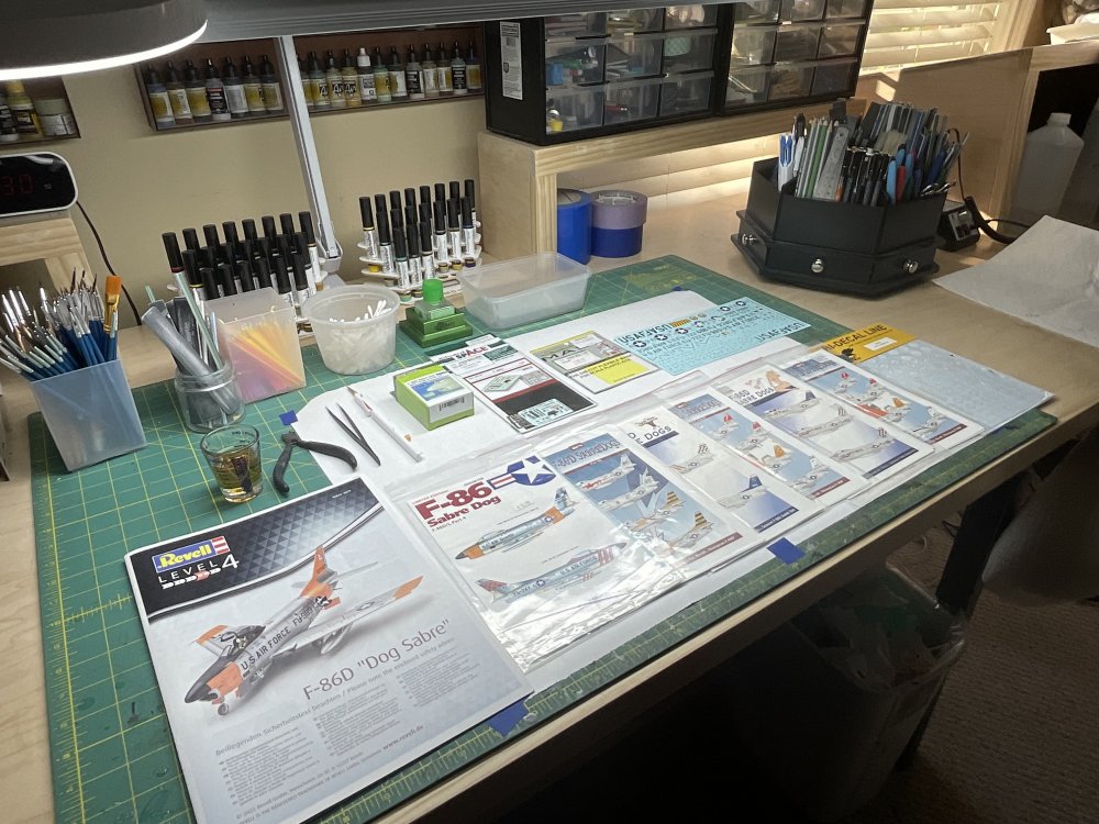

dai phan Posted February 27, 2024 Author Share Posted February 27, 2024 (edited) Hi all, Ordered some stuff for this build. Dai Edited February 27, 2024 by dai phan Quote Link to post Share on other sites
dai phan Posted February 27, 2024 Author Share Posted February 27, 2024 (edited) Other than some after market resin cockpits, there are nothing as far as detail sets offered. The kit already has slats and detailed rocket tray. There are some areas that could use resin bays. However there are ample beautiful decal sheets available. It appears this project should be completed quickly. Dai Edited February 27, 2024 by dai phan Quote Link to post Share on other sites

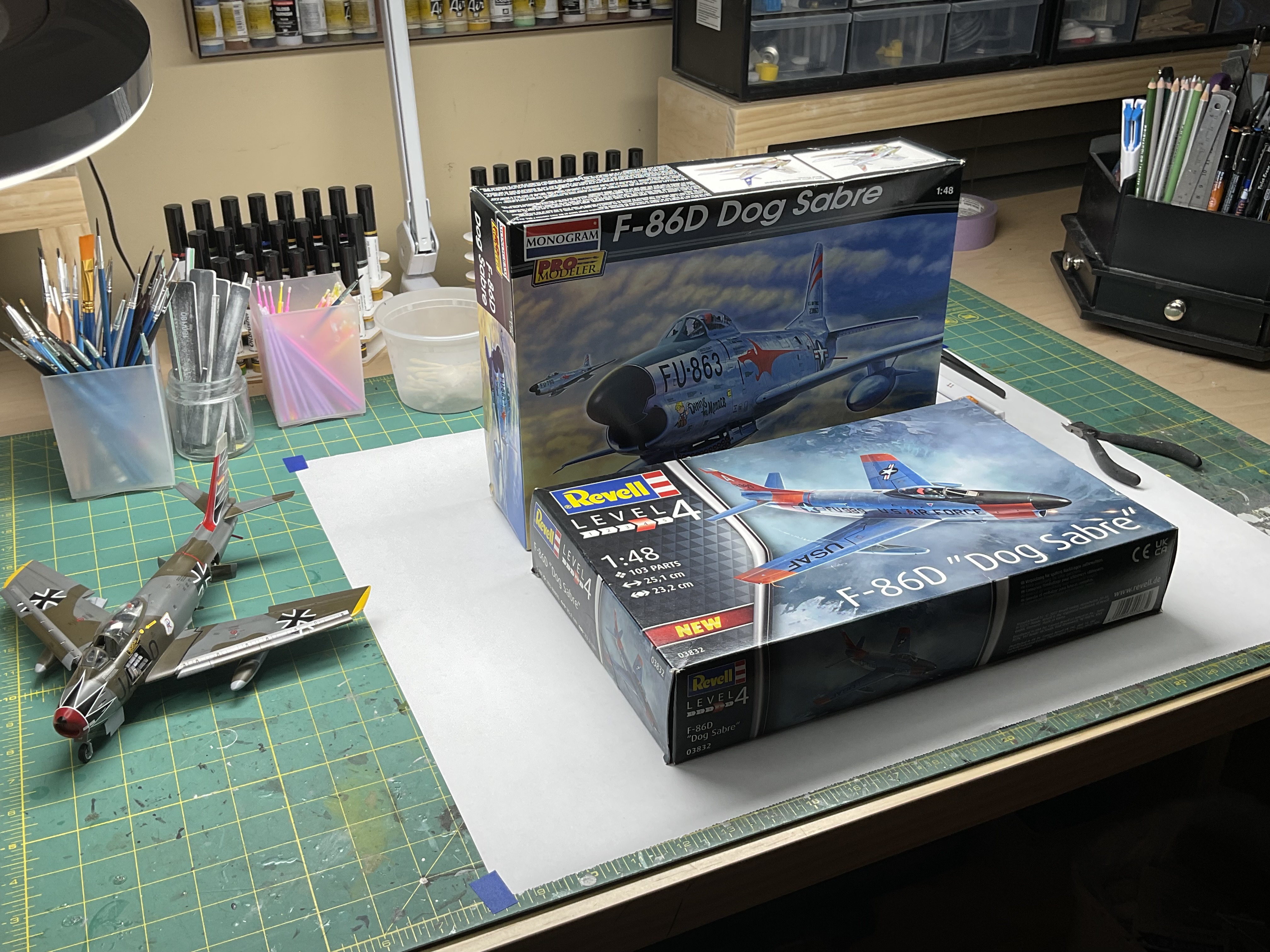

dai phan Posted April 22, 2024 Author Share Posted April 22, 2024 (edited) Howdy all, With the F-86 project coming to a close, I will start on this project this weekend. The Revell and Promodeler kits differ in the early or later tail type. I will have to look into the decal sheet to determine the correct variant. Dai Edited April 29, 2024 by dai phan Quote Link to post Share on other sites
dai phan Posted April 25, 2024 Author Share Posted April 25, 2024 Howdy modelers, Will start on this project tomorrow. Since the kit has excellent fit and no resin parts to deal with or wait to be shipped from overseas, it should move along quickly. Dai Quote Link to post Share on other sites
dai phan Posted April 25, 2024 Author Share Posted April 25, 2024 (edited) Hello all, The version I choose will be the late type (Revell) as this is the most preferred variant by many modelers as well. I just need to make sure the decals are appropriate for the type. Dai Edited April 25, 2024 by dai phan Quote Link to post Share on other sites

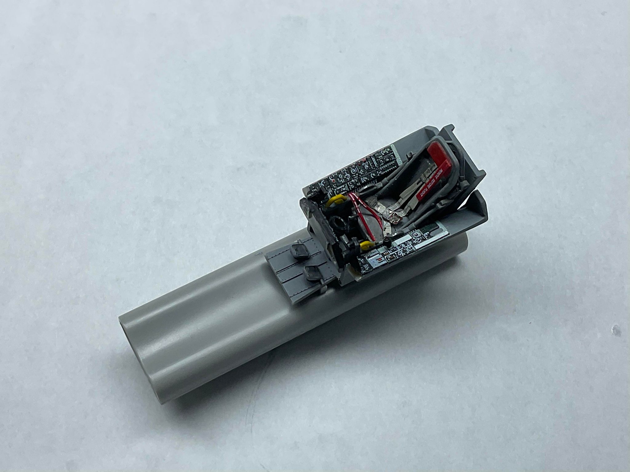

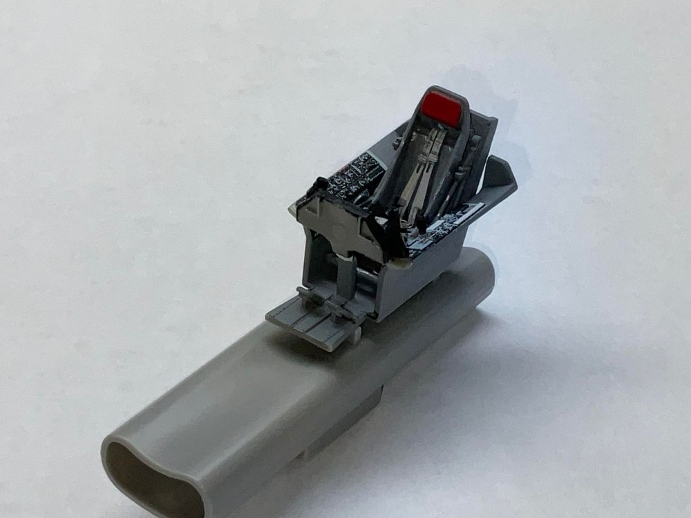

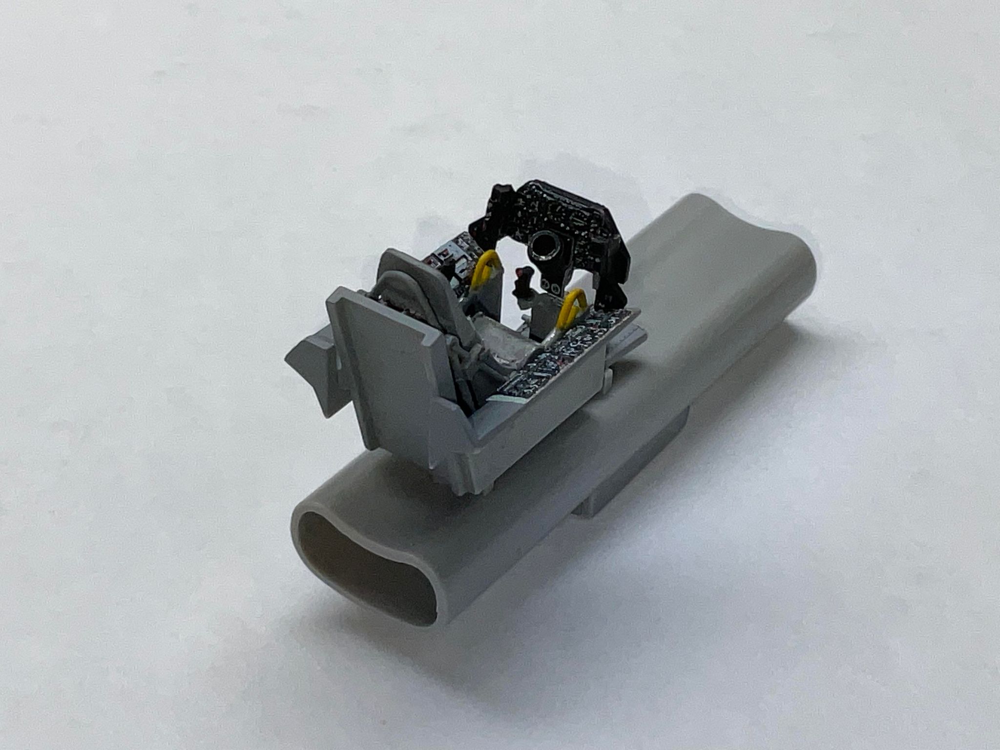

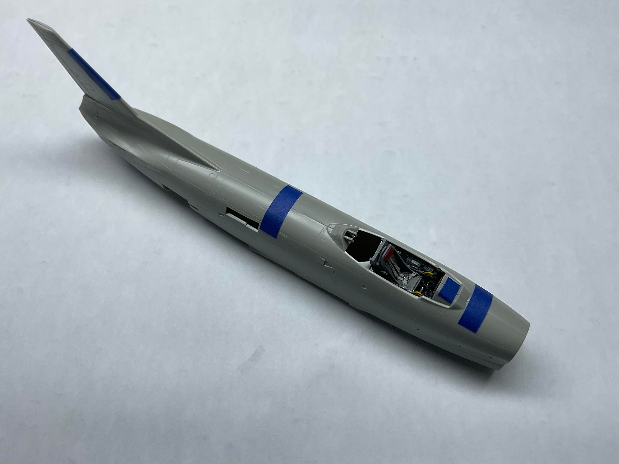

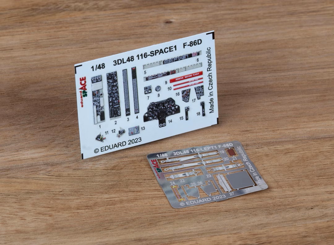

dai phan Posted April 26, 2024 Author Share Posted April 26, 2024 (edited) Greetings Friday everyone, Started the project today using Eduard' Space 1 set. Interesting discovery... Eduard's provides the correct dimensions for the vertical side panels (PE parts 25/26). However when the cockpit tube is inserted into the fuse, these stand at a weird angle. These side panels should be perpendicular to the cockpit floor rather at a 30 degree stance. The reason is because the instrument panel should be tilted forward but on the kit, it is perpendicular to the cockpit tube. As such that causes the side panels to be off and cannot be used. Luckily I have a spare kit so the kit's side panels can be used. The other thing is Eduard's instruction calls for parts 1,2 to be placed at the edge of the plastic. You need to move back 1/2 mm to allow the IP to be cemented onto the tub. Dai Edited April 26, 2024 by dai phan Quote Link to post Share on other sites
dai phan Posted April 26, 2024 Author Share Posted April 26, 2024 (edited) A little more progress. I will have to paint the gray on the decal to dark gull gray to match the rest. Dai Edited April 29, 2024 by dai phan Quote Link to post Share on other sites

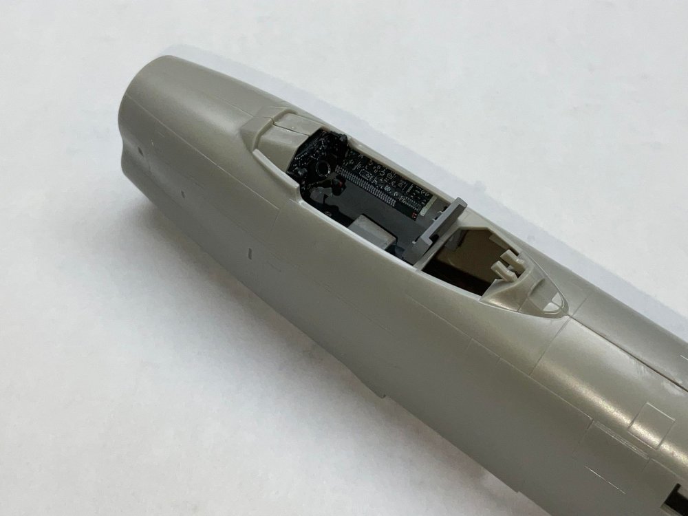

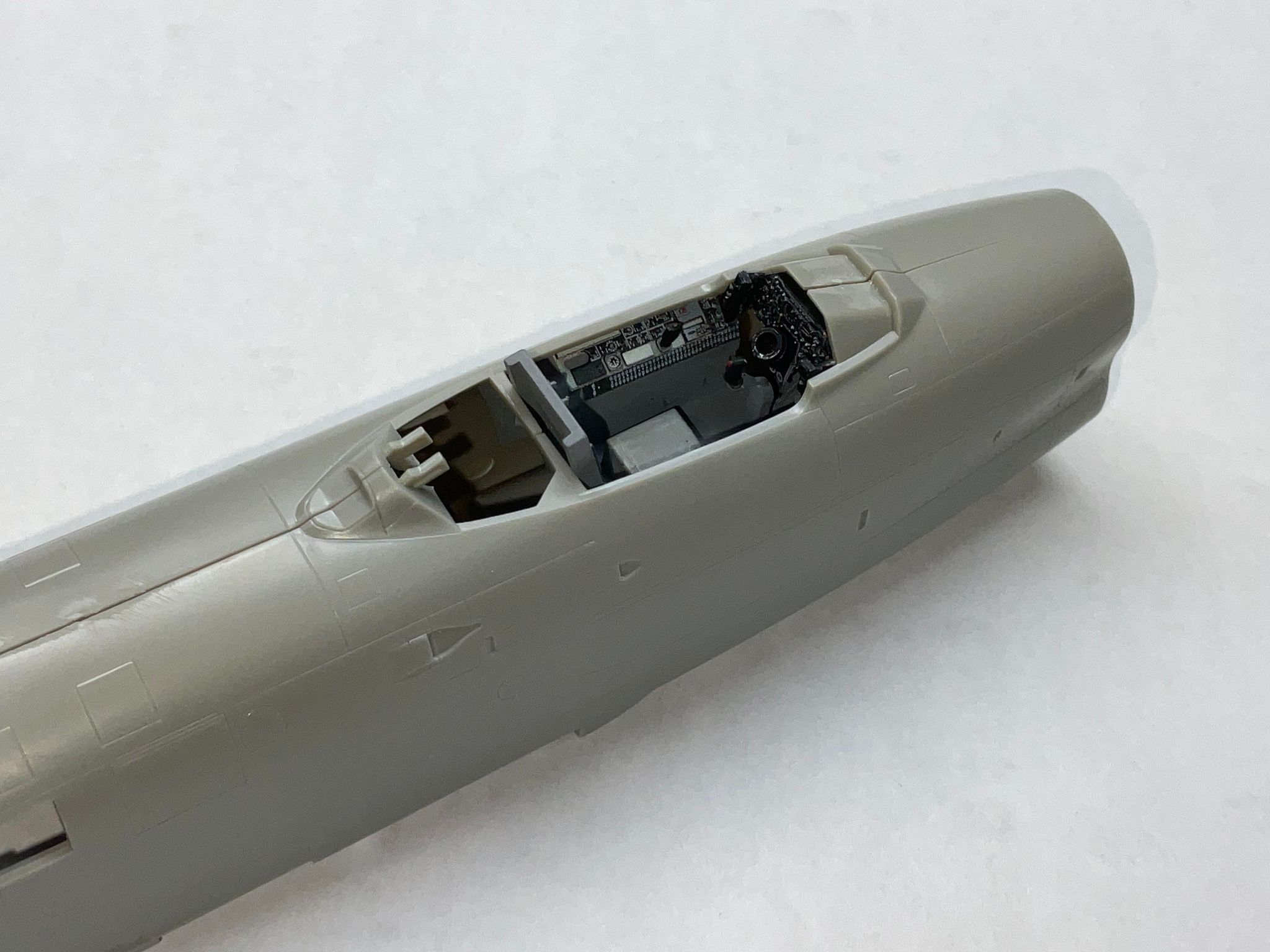

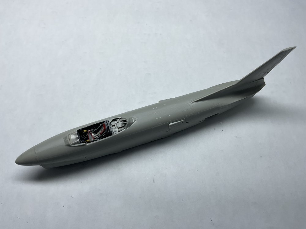

dai phan Posted April 27, 2024 Author Share Posted April 27, 2024 (edited) Greetings, The fuse is assembled. The Revell kit sports the later version with shorter instrument panel and correct vertical tail. The Eduard's instruction calls for shortening the front of the IP and install the PE part. Dai Edited April 27, 2024 by dai phan Quote Link to post Share on other sites

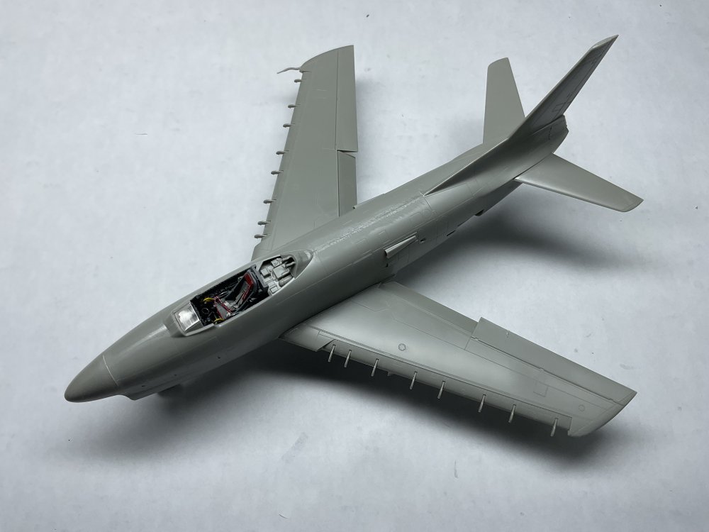

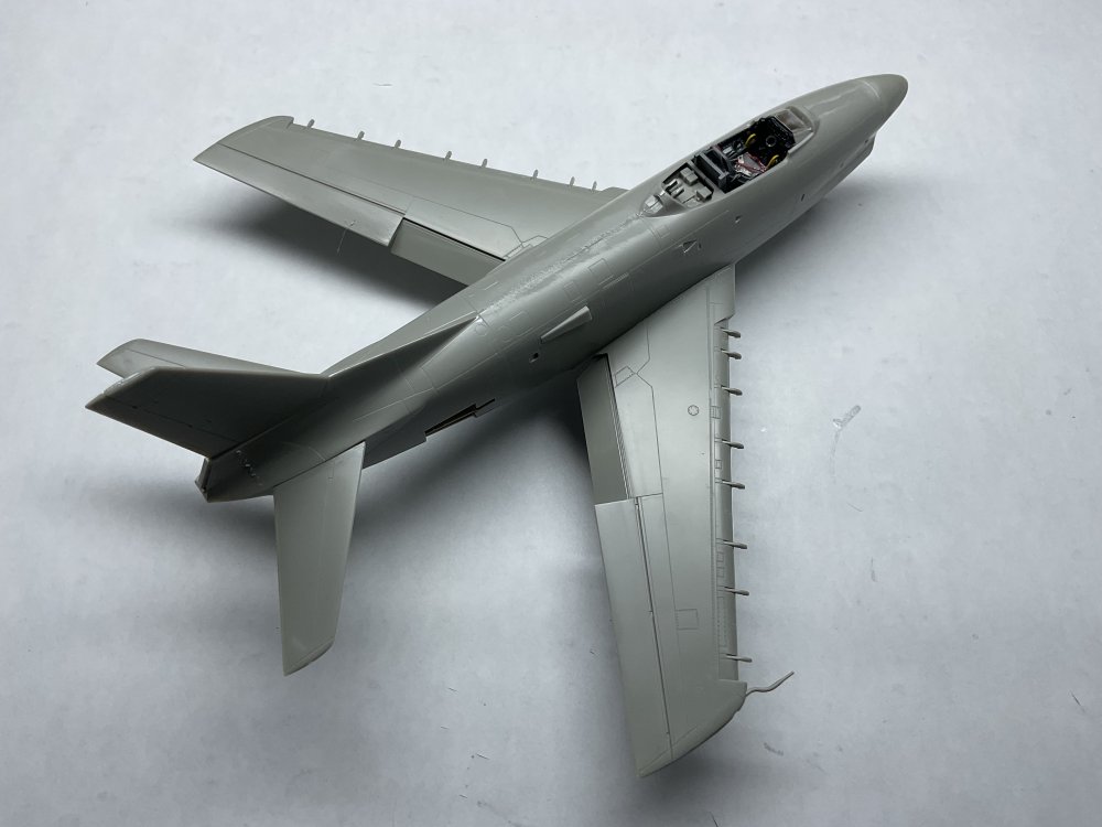

dai phan Posted April 27, 2024 Author Share Posted April 27, 2024 (edited) Hello all, The plane is ready to be sanded. If you are building the Revell version, please note that parts 28/29 are reversed in their locations according to the illustration. The vortex generators are on the bottom. I see some errors in the Net due to the wrong instruction. The drag chute (part #18) are not shown any where in the manual. Make sure the rectangular horizontal piece is on the bottom. Dai Edited April 27, 2024 by dai phan Quote Link to post Share on other sites
Crutch Posted April 28, 2024 Share Posted April 28, 2024 Wow, she's pretty already! Quote Link to post Share on other sites

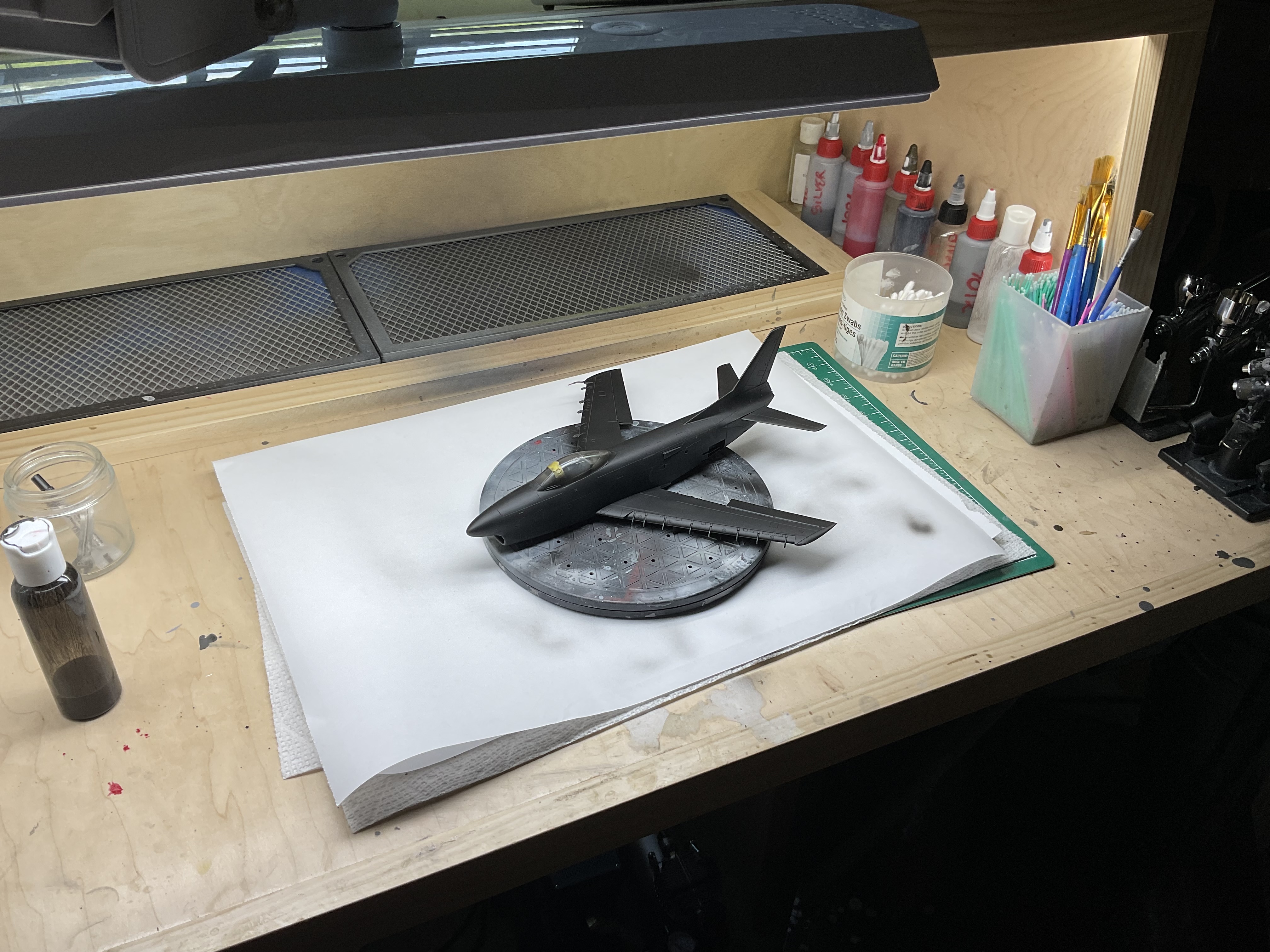

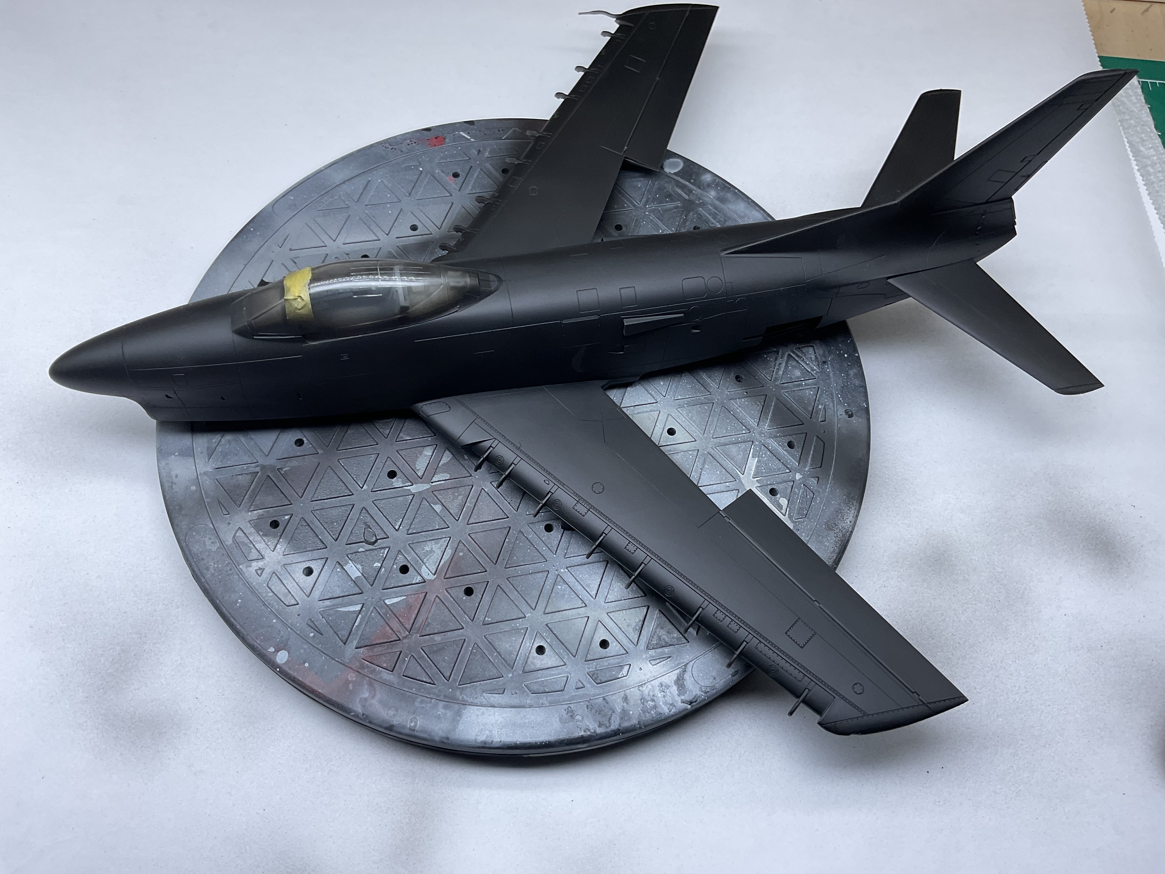

dai phan Posted April 29, 2024 Author Share Posted April 29, 2024 (edited) Hello all, Started to prime today. Not much to clean up due to excellent of fit. Dai Edited April 29, 2024 by dai phan Quote Link to post Share on other sites
dai phan Posted April 29, 2024 Author Share Posted April 29, 2024 (edited) Hi all, If you plan to do the F-86D, buy the Revell version instead. The Promodeler model is based on early, research aircraft with oversized rudder trim that is not accurate for planes in service. Also the IP is not accurate for in-service planes either. You can use the Promodeler version if you plan to use the kit's decals. Dai Edited May 2, 2024 by dai phan Quote Link to post Share on other sites
dai phan Posted May 3, 2024 Author Share Posted May 3, 2024 (edited) Hi all, I will step out of my comfort zone and try Alcald II for the first time ! Any advise greatly appreciated. Dai Hi Edited May 3, 2024 by dai phan Quote Link to post Share on other sites
Crutch Posted May 4, 2024 Share Posted May 4, 2024 I hear that the black undercoat needs to be glossy and dry before applying AlClad II... Quote Link to post Share on other sites
Crutch Posted May 4, 2024 Share Posted May 4, 2024 I'd most assuredly break out a paint mule first! Quote Link to post Share on other sites
dai phan Posted May 4, 2024 Author Share Posted May 4, 2024 5 hours ago, Crutch said: I hear that the black undercoat needs to be glossy and dry before applying AlClad II... I read that you must prime or the paint will craze the plastic. I have to paint some bare spots that you see on the model. Glossy black coat if you only want chromic shine. I will do some test before I do on the model. Dai Quote Link to post Share on other sites

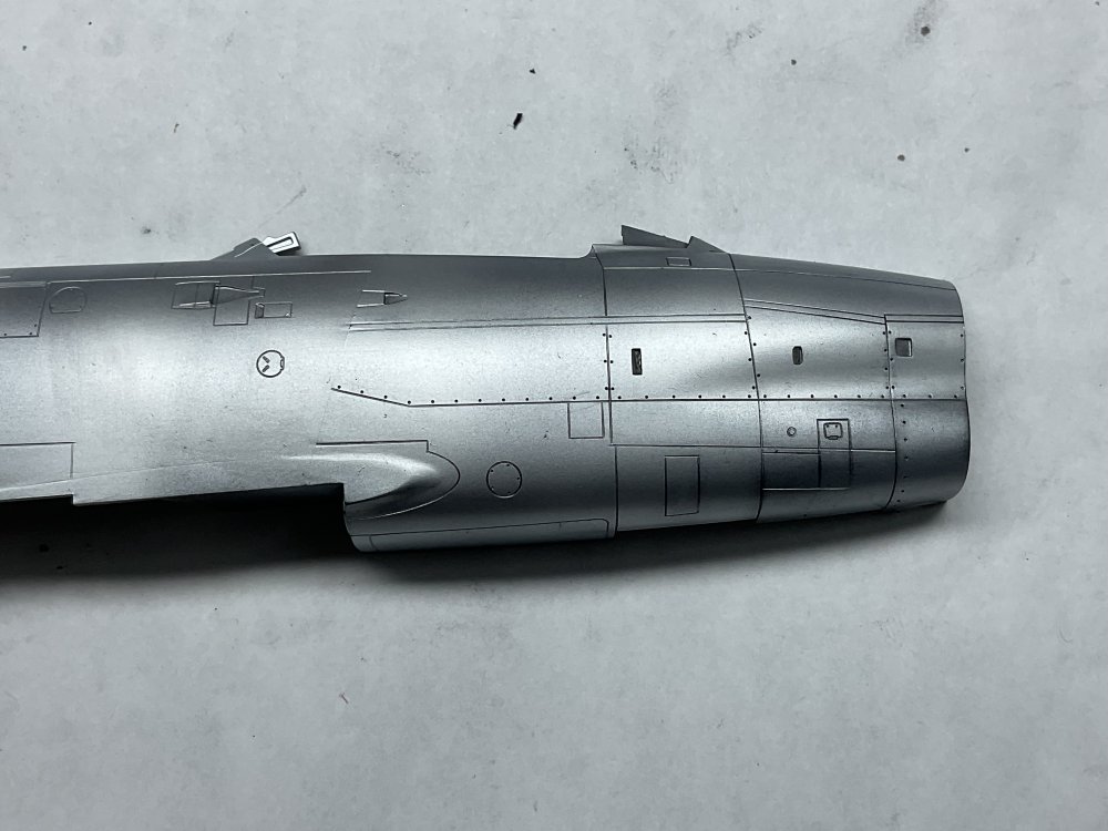

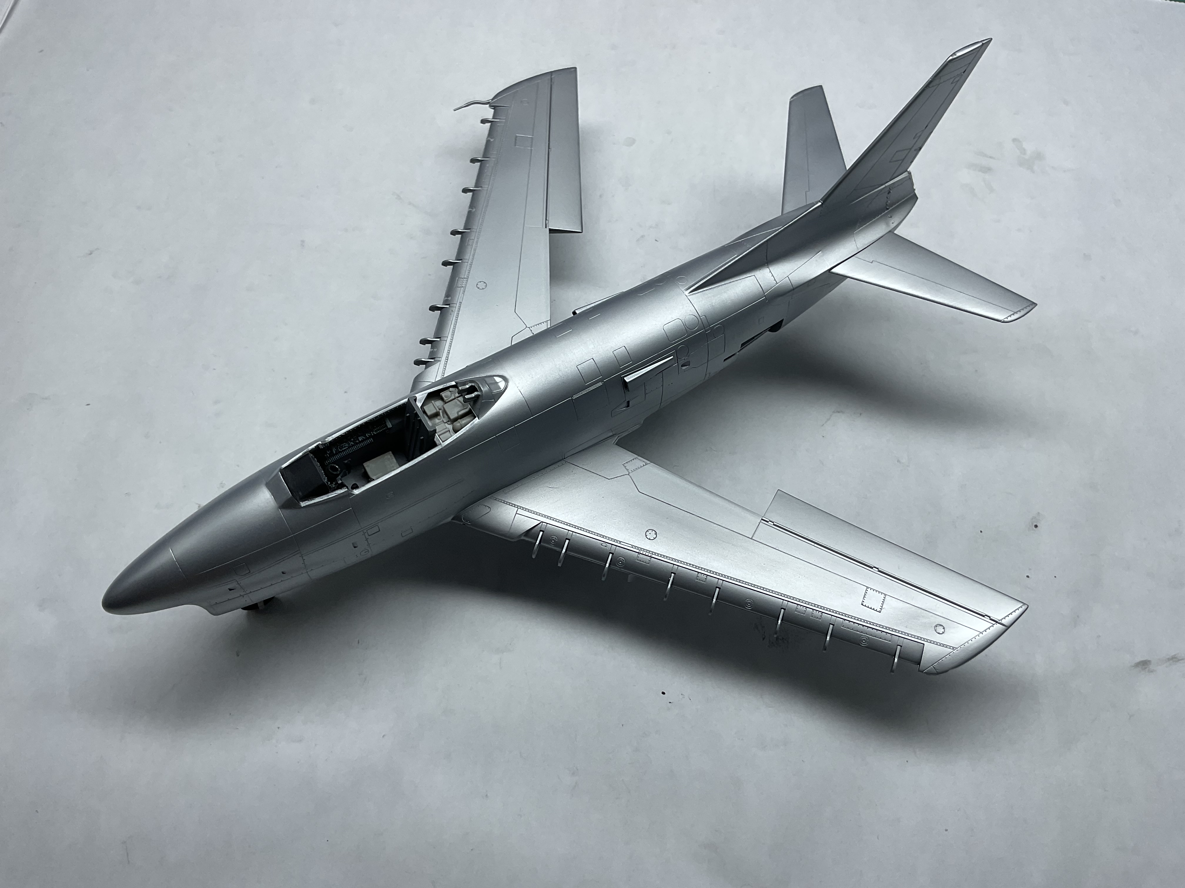

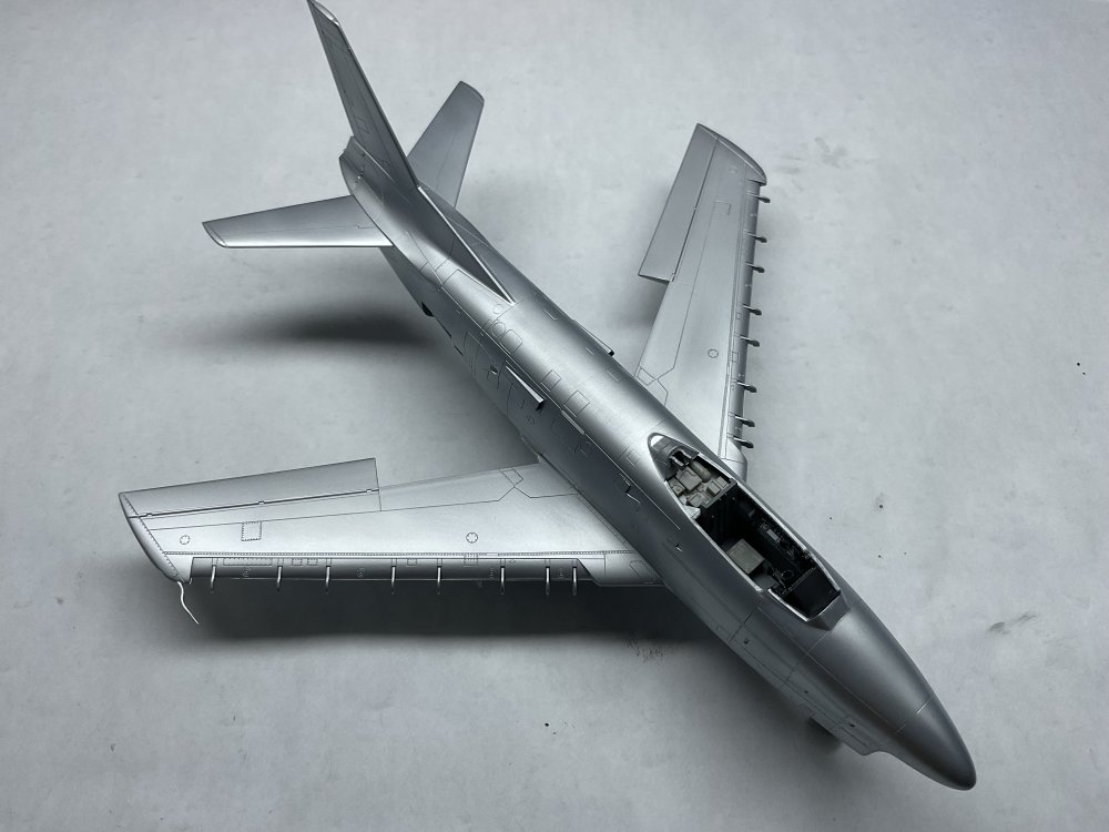

dai phan Posted May 4, 2024 Author Share Posted May 4, 2024 (edited) Hello all, OK, I am going to try a different paint. When I bought the Luftwaffe 1960 paint sets for my Sabre, it came with 2 bottles of White Aluminum. I have read AK Extreme Metal is much better than Alclad II so I did a test. I was very pleased with the result. It sprays well, dries fast, can be sanded to feathered edge and is resistant to masking tape. It can be sprayed directly over bare unprimed plastic without crazing it unlike Alcald II. So I am going to use this paint. However I will do some test on the Alclad II to see how it fares. I am not into high shine chromic finish because in real life it does not exist. Dai Edited May 4, 2024 by dai phan Quote Link to post Share on other sites
dai phan Posted May 4, 2024 Author Share Posted May 4, 2024 (edited) Greetings, I painted white aluminum and I thought the color is too bright and white. The photos appear much darker than in real life. I have ordred a numbers of AK Extreme Metal paints and plan to use the aluminum for a darker shade. I do not know if the paint is not fully cured but enamel thinner does makes the paint slighty tacky that will attract finger prints. Since the model sports rather heavy panel lines, another coat or 2 of paint will not hide any details. Dai PS: AK users, please advise me what paint from AK Extreme Metal is best for NMF finish please. Maybe I did not use other AK colors to judge but a single sample I used I did not see any improvements over Mr Color Super Metallics 2 range. Edited May 22, 2024 by dai phan Quote Link to post Share on other sites
