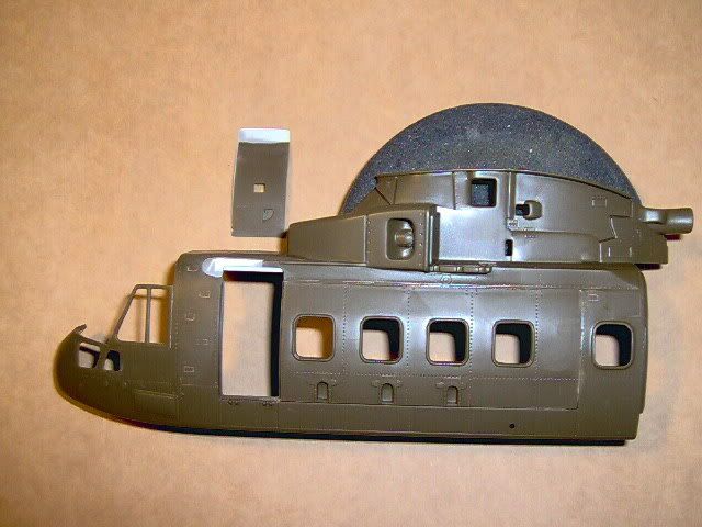

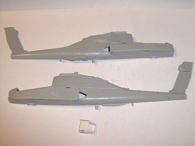

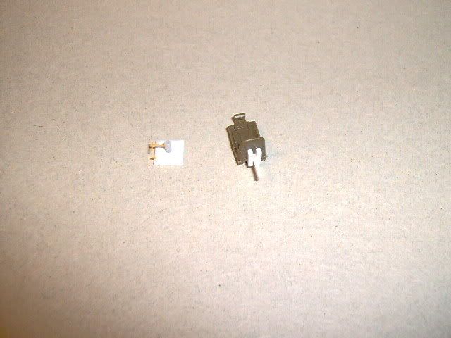

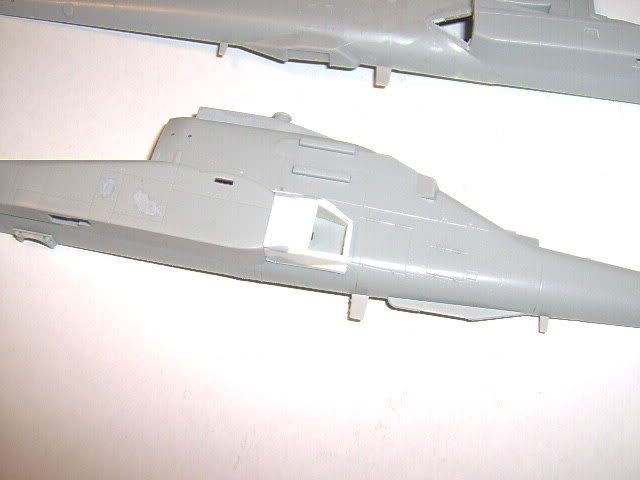

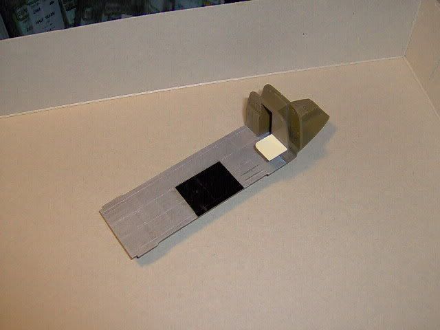

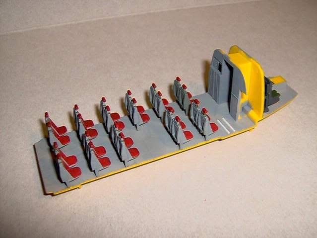

Flyboyf18 Posted June 12, 2008 Share Posted June 12, 2008 OK started with the Hobby Boss AH-64D; the first cut is the deepest then stated building the end of the l/h cheek housing Then I decided I had to do an EH-101 so pulled out one and stated playing? It is going to be a 'What If' build added a fictional hoist then got onto the interior, the table on the r/s is for the Sensor Op then started building his seat then glued the tail together and cleaned up the inside as an aside (this kit is not for the GB was started long ago) this is the interior for my Oil Rig supply version of the EH-101. It will be done in Canadian Helo markings. That's all for now got toget to the Mustang Club meeting. Cheers Quote Link to post Share on other sites

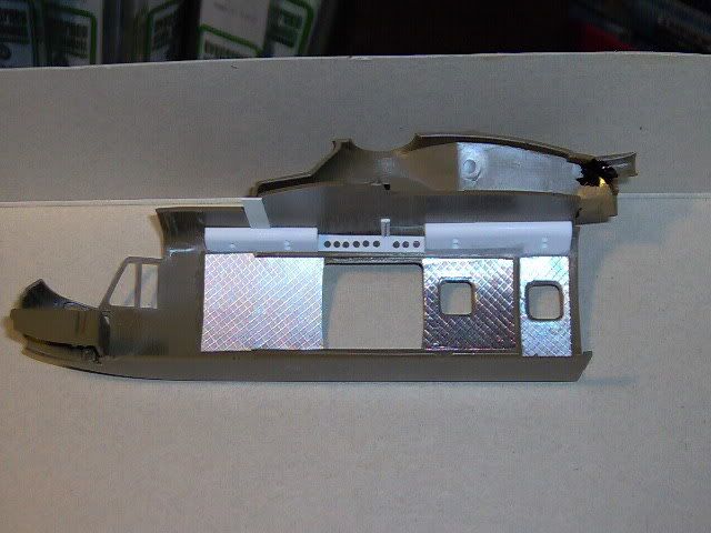

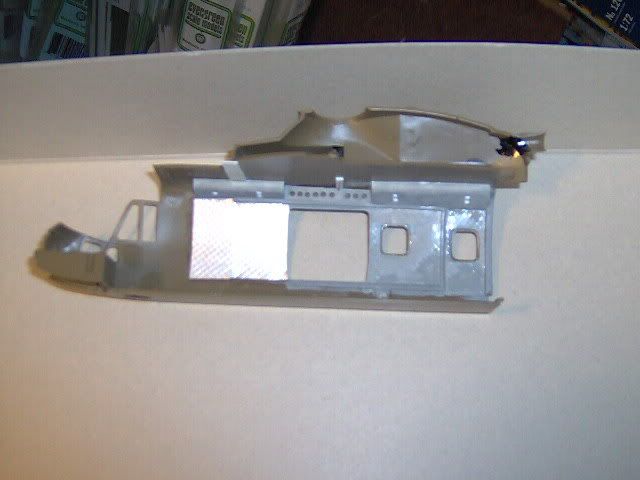

Flyboyf18 Posted June 17, 2008 Author Share Posted June 17, 2008 Thanks, continued work on the EH-101; put in some sound curtains on the interior, the piece at the front still needs windows cut out, the stuff along the roof is something I have picked up from interior shots of 101s. now the rear portions are painted. Quote Link to post Share on other sites
marine4 ever Posted June 17, 2008 Share Posted June 17, 2008 Thanks, continued work on the EH-101; put in some sound curtains on the interior, the piece at the front still needs windows cut out, the stuff along the roof is something I have picked up from interior shots of 101s. now the rear portions are painted. nice work! how did you get the diamond pattern on the noise proofing? and i noticed the evergreen collection behind your pic! looks like my bench semper fi Dan Quote Link to post Share on other sites
Flyboyf18 Posted June 17, 2008 Author Share Posted June 17, 2008 One can never have enough Evergreen stuff, unless of course ALL your kits are built OOB!! :) The diamond pattern comes from another Evergreen product ( the pic wasn't intended as link to this method) sheet Tile #4501 with 1/16" squares. I cut a piece of tin foil to the shape needed, then lay it on the tile plastic with the straight(est) edge cutting the boxes in half diagonally, then work the foil into the plastic with a pencil eraser. Then using Micro's Foil Adhesive stick it to the kit and let dry completely, then trim what is not needed with a very sharp knife. It busys up the interior and hides the junk from the molding process. Quote Link to post Share on other sites
marine4 ever Posted June 18, 2008 Share Posted June 18, 2008 (edited) One can never have enough Evergreen stuff, unless of course ALL your kits are built OOB!! :D The diamond pattern comes from another Evergreen product ( the pic wasn't intended as link to this method) sheet Tile #4501 with 1/16" squares. I cut a piece of tin foil to the shape needed, then lay it on the tile plastic with the straight(est) edge cutting the boxes in half diagonally, then work the foil into the plastic with a pencil eraser. Then using Micro's Foil Adhesive stick it to the kit and let dry completely, then trim what is not needed with a very sharp knife. It busys up the interior and hides the junk from the molding process. yes i think the same thing! one never knows when you need to build something!thanks for the tip. very nice job!!! semper fi Dan Edited June 18, 2008 by marine4 ever Quote Link to post Share on other sites

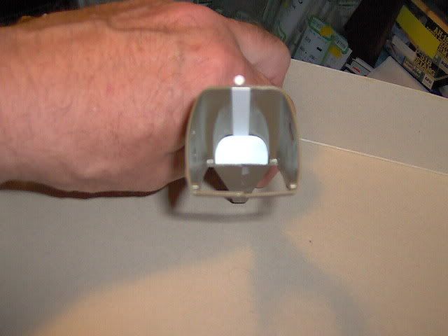

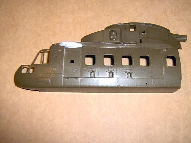

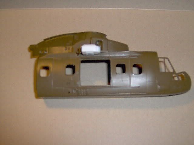

Flyboyf18 Posted June 22, 2008 Author Share Posted June 22, 2008 Thanks Guys, I am using the What If EH-101 to test mods for future 101 builds. The next shots show the extended height door that is used on the VH-71, this way when I do the actual kit the mod has been done before! The door test fitted in place: and here they are separately; Quote Link to post Share on other sites
