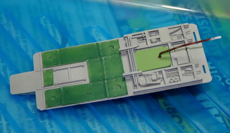

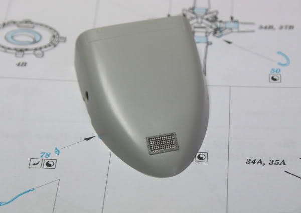

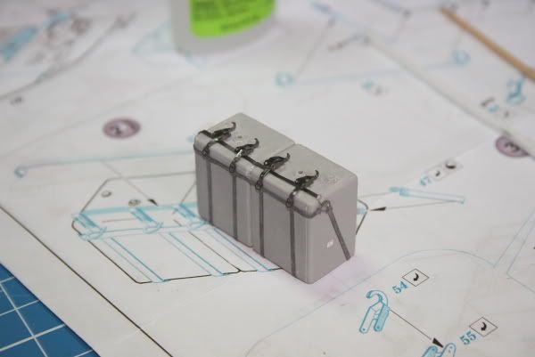

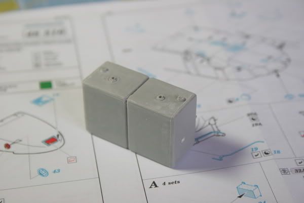

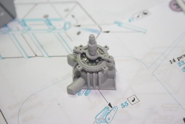

Ian Cooper Posted September 3, 2010 Author Share Posted September 3, 2010 So, here's the start of my MH-60G. Some photo-etch work using the Eduard set..... Thanks for looking, Ian Quote Link to post Share on other sites
chukw Posted September 3, 2010 Share Posted September 3, 2010 Looks like you;re doing just fine with that pe- excellent work! Cheers- chuk Quote Link to post Share on other sites
Netz Posted September 3, 2010 Share Posted September 3, 2010 It's best to use a pair of scissors to remove the pe from the frets, I trim away the large frets that will get in the way, the scissors can then be laid flush against the part and cut leaving virtually no stub protruding. I see on your grill all the attachment points from the fret, if you do get some extra material, it can be removed easily with a machinist file. I'll have to take some pictures to better explain. Curt Quote Link to post Share on other sites
Ian Cooper Posted September 3, 2010 Author Share Posted September 3, 2010 (edited) Looks like you;re doing just fine with that pe- excellent work!Cheers- chuk Thanks Chuk Kind words - and very welcome from a master like yourself! Ian Edited September 3, 2010 by Ian Cooper Quote Link to post Share on other sites
Ian Cooper Posted September 3, 2010 Author Share Posted September 3, 2010 (edited) It's best to use a pair of scissors to remove the pe from the frets, I trim away the large frets that will get in the way, the scissors can then be laid flush against the part and cut leaving virtually no stub protruding. I see on your grill all the attachment points from the fret, if you do get some extra material, it can be removed easily with a machinist file.I'll have to take some pictures to better explain. Curt Thanks for the tip, Curt. I'll take your advice on that - it was a problem for me Still lots of PE to do on this so I'll have plenty of opportunity to try the scissors out! I do have some small files but find it tricky holding the small pieces and then filing without bending the PE. Lots to learn, I feel. Cheers Ian Edited September 3, 2010 by Ian Cooper Quote Link to post Share on other sites

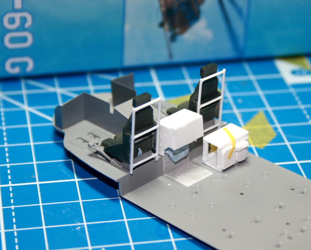

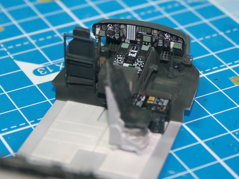

Ian Cooper Posted October 24, 2010 Author Share Posted October 24, 2010 Here's a short update ... A little work on the cockpit area. I've been looking at some threads under Helicoptor Modelling and have decided to try to replicate a recently updated MH-60G which includes new seats for the gunners in the back. More on that later. So - a start to detailing the back of the pilot/co-pilot seats and scratch building the rear of the central console. Also, the start of scratching the gunner control 'box, in the rear compartment. Cheers Ian Quote Link to post Share on other sites

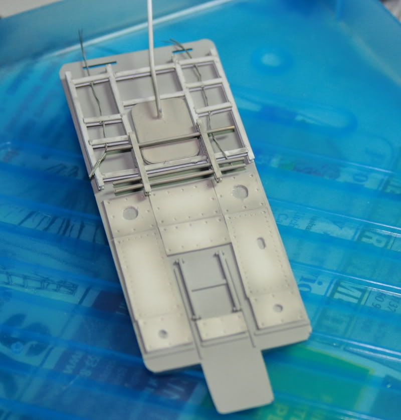

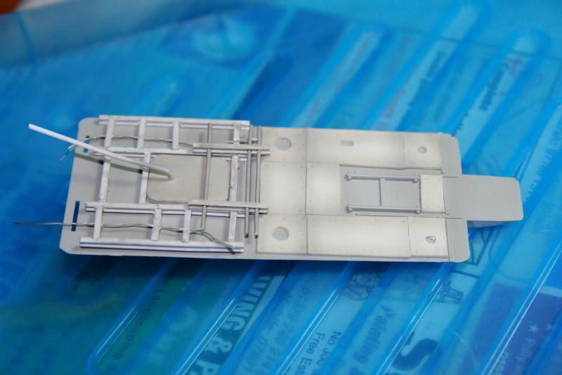

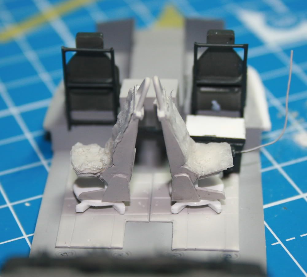

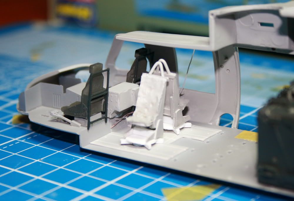

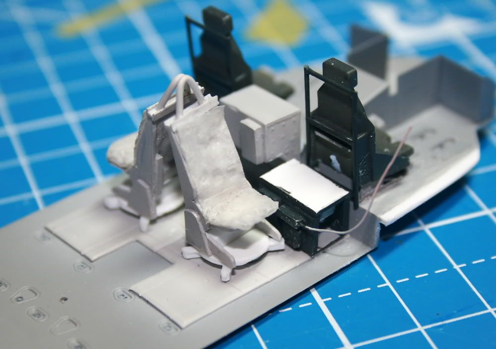

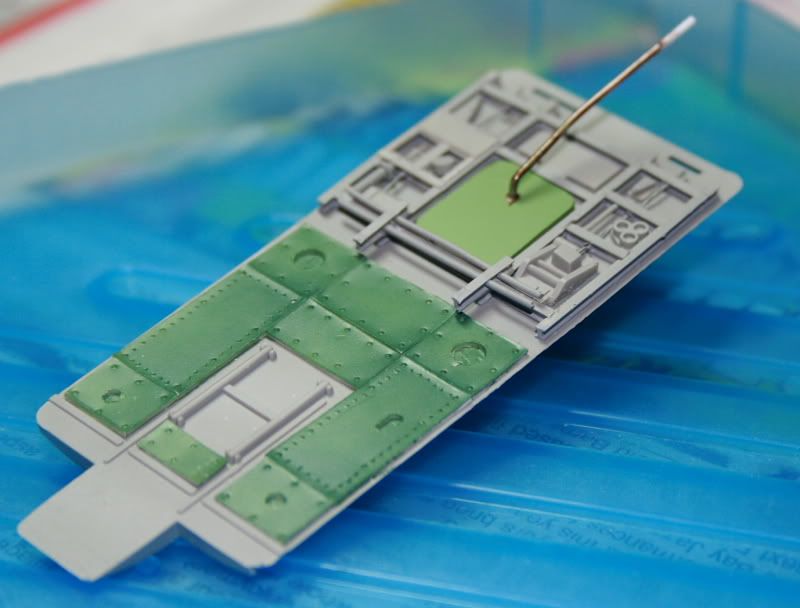

Ian Cooper Posted October 24, 2010 Author Share Posted October 24, 2010 Thanks Norbert Here is another update. This includes the beginning of the scratchbuild gunner seats and the armoured floor that goes with them. More work to do on the seats yet. The padding needs to be finished more neatly and then belts need to be added before painting. Cheers Ian Quote Link to post Share on other sites
CW4 Erick Swanberg Posted October 24, 2010 Share Posted October 24, 2010 Cut the seat supports for the pilot seats down to about mid way. They dont go up as high. PE detail on the internal Robbie tank is very impressive Erick Quote Link to post Share on other sites
Ian Cooper Posted October 24, 2010 Author Share Posted October 24, 2010 Cut the seat supports for the pilot seats down to about mid way. They dont go up as high. PE detail on the internal Robbie tank is very impressive Erick Thanks for your comments, Erick. I'll check my reference on the pilot seats and make the correction. I look forward to you popping in again on the thread and offering more advice, seeing as you're the Black Hawk guru! All the best Ian Quote Link to post Share on other sites
CW4 Erick Swanberg Posted October 25, 2010 Share Posted October 25, 2010 (edited) Actually hold off on that seat support cutting I was going off on pics of the older style seats my bad, We have 2 styles of seats in the Army those are the newest seats so disregard. The crewchief seats look great as well I doubt the Army will see those since they look like they are way more comfortable hahaha Erick Edited October 25, 2010 by CW4 Erick Swanberg Quote Link to post Share on other sites
Ian Cooper Posted October 25, 2010 Author Share Posted October 25, 2010 Actually hold off on that seat support cutting I was going off on pics of the older style seats my bad, We have 2 styles of seats in the Army those are the newest seats so disregard. The crewchief seats look great as well I doubt the Army will see those since they look like they are way more comfortable hahaha Erick Ha, ha. Too late. :huh: I've cut the seat supports back a little already but not too much. I'll go with that now - not a problem. :D Glad the scratchbuilt seats look OK to you, Erick Cheers Ian Quote Link to post Share on other sites

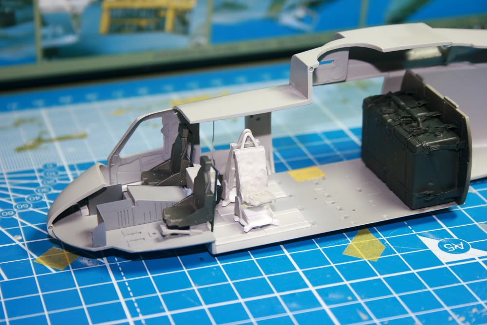

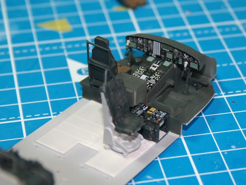

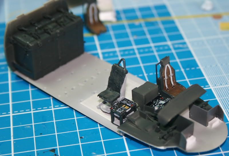

Ian Cooper Posted October 28, 2010 Author Share Posted October 28, 2010 Small update. A little more work done on the interior, getting the cockpit further along. Here are some pics. One of the gunnery control boxes has been scratchbuilt and finished using a spare Eduard panel. Need to build one for the other side now and get those seats finished. Then there's a whole load of other stuff to do with the interior including some detailing on the ceiling, bags, bits and pieces, blah, blah. This is going to be a long one! Thanks for looking Ian Quote Link to post Share on other sites
