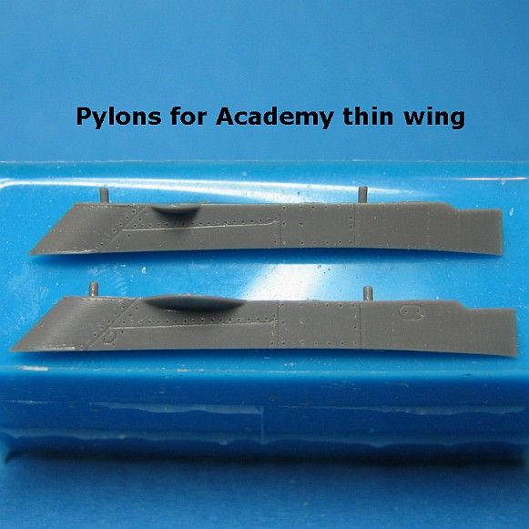

JeffreyK Posted February 4, 2014 Share Posted February 4, 2014 Hi, this is a quick opinion survey if there is general interest in building the new Academy F-4C kit with the early type McDonnell wing tanks/pylons. I have a resin set for such tanks in the works and getting it very near release and so far I have made two separate pylon sets shaped to fit Academy F-4B wings and Hasegawa wings. When my Academy F-4C kit arrived recently I discovered that the whole wing profile was changed from the thin wing when they re-tooled it for the wheel bulges and now my pylons don't fit as nicely as they do on the F-4B wing. A bit of sanding can take care of the issue, but making another separate, modified set of pylons for the Academy "thick wing" is not completely off the agenda... Most of the pictures I've seen of the McD tanks is on F-4B's, but at least the very first batch of F-4C's delivered to McDill AFB in '63 had those tanks as well. I don't know how long they were used operationally though. What's your opinion? Cheers Jeffrey Quote Link to post Share on other sites

JeffreyK Posted February 7, 2014 Author Share Posted February 7, 2014 Thanks for your help Gene, really much appreciated! I'll send you a PM. I didn't put the F-4B in the title as I have pylons for the Academy B and pylons that fit both the thin and thick wing of Hasegawa kits already. Most of the pictures I've seen of the early tank in use is mounted on F-4B's and F4H-1's so that was my priority. I just wanted to gauge whether there's much interest in the very early phase of F-4C's with those tanks. All in 1:48 of course. 1:72 is next. Jeffrey Quote Link to post Share on other sites

JeffreyK Posted February 7, 2014 Author Share Posted February 7, 2014 Really? Great food for thought - seems like the argument is made for an extra thick wing pylon for the Academy kits. As for 1:72: I hope the manufacturers didn't vary in wing profiles too much, at least not between thick and thin wing of the SAME manufacturer... Quote Link to post Share on other sites
