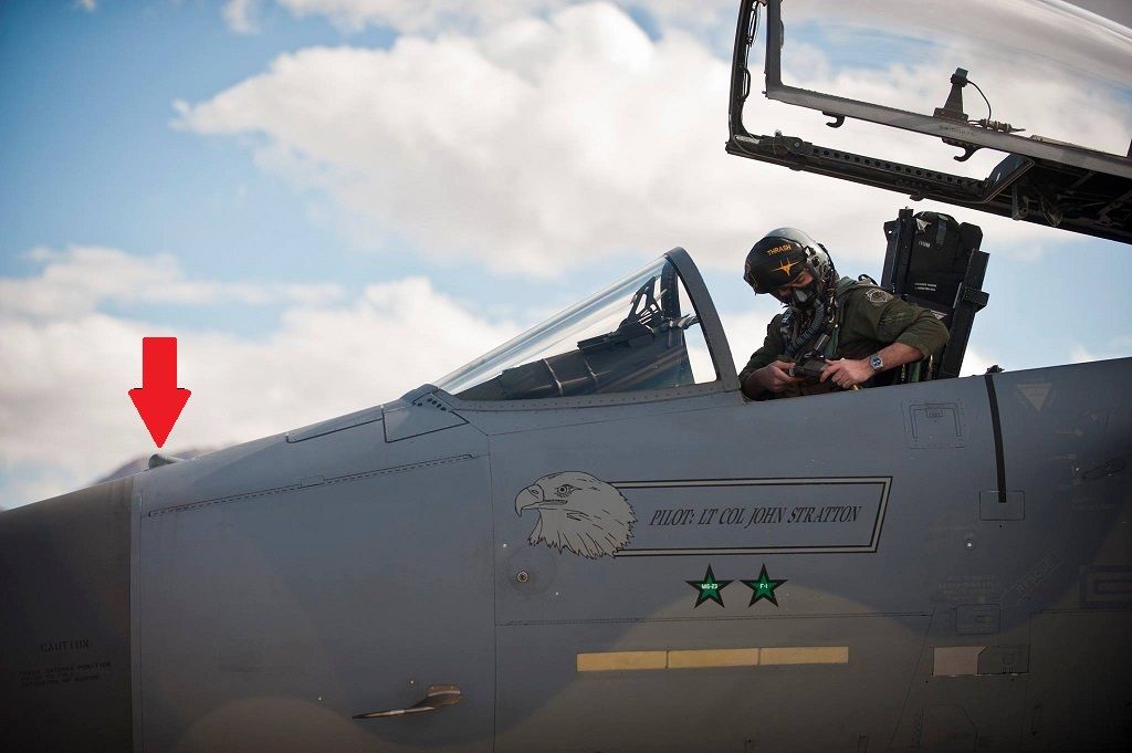

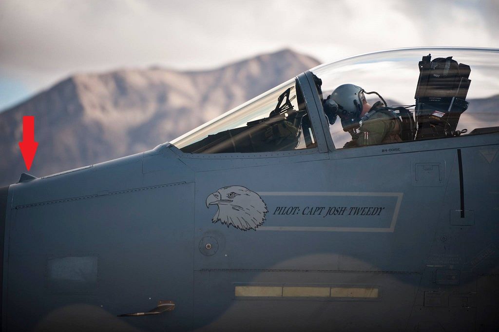

82Whitey51 Posted January 30, 2015 Share Posted January 30, 2015 (edited) OK, F-15 experts out there, what is this little "wart" on the nose of these Lakenheath F-15Cs? Is it only on frontline "C" models or do the "E" and MSIP "C" models have it as well? Also, it may just be the slight difference in photo angle but, they appear to be slightly different in shape??? Edited January 30, 2015 by 82Whitey51 Quote Link to post Share on other sites
gonzalo Posted January 30, 2015 Share Posted January 30, 2015 It's an RWR antenna that MSIP II F-15C's have. It is not on the E model. Quote Link to post Share on other sites
gonzalo Posted January 30, 2015 Share Posted January 30, 2015 I should say it doesn't have that bumping on the nose. Quote Link to post Share on other sites
gonzalo Posted January 30, 2015 Share Posted January 30, 2015 (edited) It's a AN/ALQ-135 Band 3 ICMS (Internal Counter Measures System). On the E model it's mounted flush to the fuselage. (Courtesy of Jake Melampy's The Modern Eagle Guide). There is an identical one on the bottom as well. Edited January 30, 2015 by gonzalo Quote Link to post Share on other sites
82Whitey51 Posted January 30, 2015 Author Share Posted January 30, 2015 It's a AN/ALQ-135 Band 3 ICMS (Internal Counter Measures System). On the E model it's mounted flush to the fuselage. (Courtesy of Jake Melampy's The Modern Eagle Guide). There is an identical one on the bottom as well. OK, thanks for the info. I see a lot of Air Guard F-15 pics and never noticed it on theirs. Quote Link to post Share on other sites
Waco Posted January 30, 2015 Share Posted January 30, 2015 As mentioned, it's an antenna associated with the ALQ-135 system. There is a blister on both the upper and lower forward fuselage, just aft of the radome. I'd wager to guess many of the Guard jets you saw were older A-models, and thus not equipped with the system. As C-models have migrated to the Guard, most of them are now equipped with these blisters. Notably, back when Tyndall had the F-15C training mission, those aircraft did NOT have the ALQ-135 installed, and did not have the blister antennas. Also note, D-model aircraft lack the avionics boxes in Bay-5 found on the single seaters, so they likewise do not have the nose blisters. In other words, it depends, check references and timeframes, etc. etc.... Quote Link to post Share on other sites
gonzalo Posted January 30, 2015 Share Posted January 30, 2015 OK, thanks for the info. I see a lot of Air Guard F-15 pics and never noticed it on theirs. You are welcome! Quote Link to post Share on other sites

jmel Posted January 31, 2015 Share Posted January 31, 2015 Waco, did all of Tyndall's jets head to AMARC? Or were they shot-gunned out around the fleet? If the latter, will they be upgraded to receive the system? Jake Quote Link to post Share on other sites
