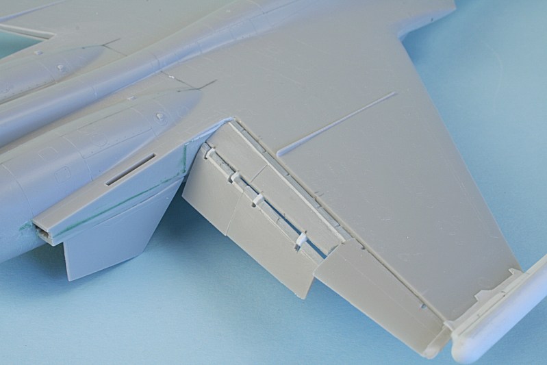

Flankerman Posted March 7, 2015 Author Share Posted March 7, 2015 One thing that Trumpeter have got wrong is the ailerons. On take off - which is the configuration I am doing - they are slightly drooped along with the flaps. There is no provision made in the kit for this - nor any mention on the instructions :bandhead2:/>/>/>/> It is a simple matter to cut off the ailerons - ready to be applied in the drooped position later. This photo shows the wing with the complete trailing edges removed - flaps and ailerons - on the right the distinctive drooped PL-8 wingtip missile rail has been added - as well as a joining piece at the root - the parts are shown on the left.... I was going to point out and photograph the optional wingtip 'Sorbtsya' ESM pods - but they are not included in the kit - despite being shown on the instruction sheet (as part Q10) !!!...... There is no 'Q' Sprue in the kit :woot.gif:/>/>/>/> - maybe that's for the later Su-33 release ?? Ken Quote Link to post Share on other sites
