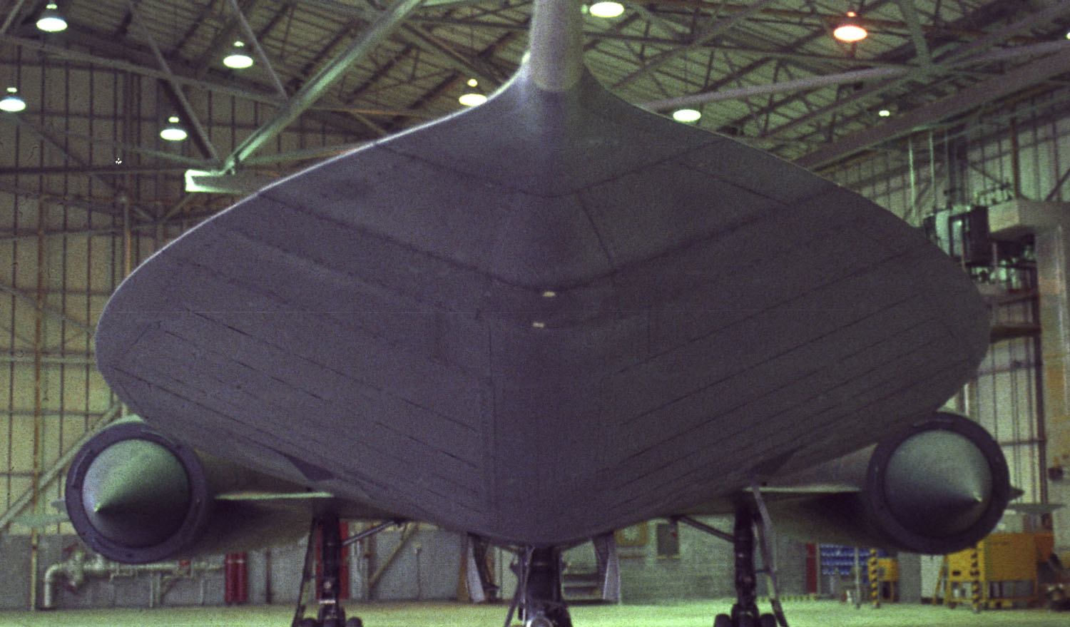

nimrod77 Posted September 28, 2011 Author Share Posted September 28, 2011 :blink: Sorry, lad; I don't think I'm followin' ya there... :wacko: Would ya please elaborate on it as though I were a five-year-old toddler with learnin' issues? I was thinking of using this rib as a template for the shape of the nose. Cut this out and fit it into the front of the kit's fuselage to help reshape it. Would take a fair bit of cutting and trimming.... Not something I am considering but would be possible if one was willing. HTH Quote Link to post Share on other sites

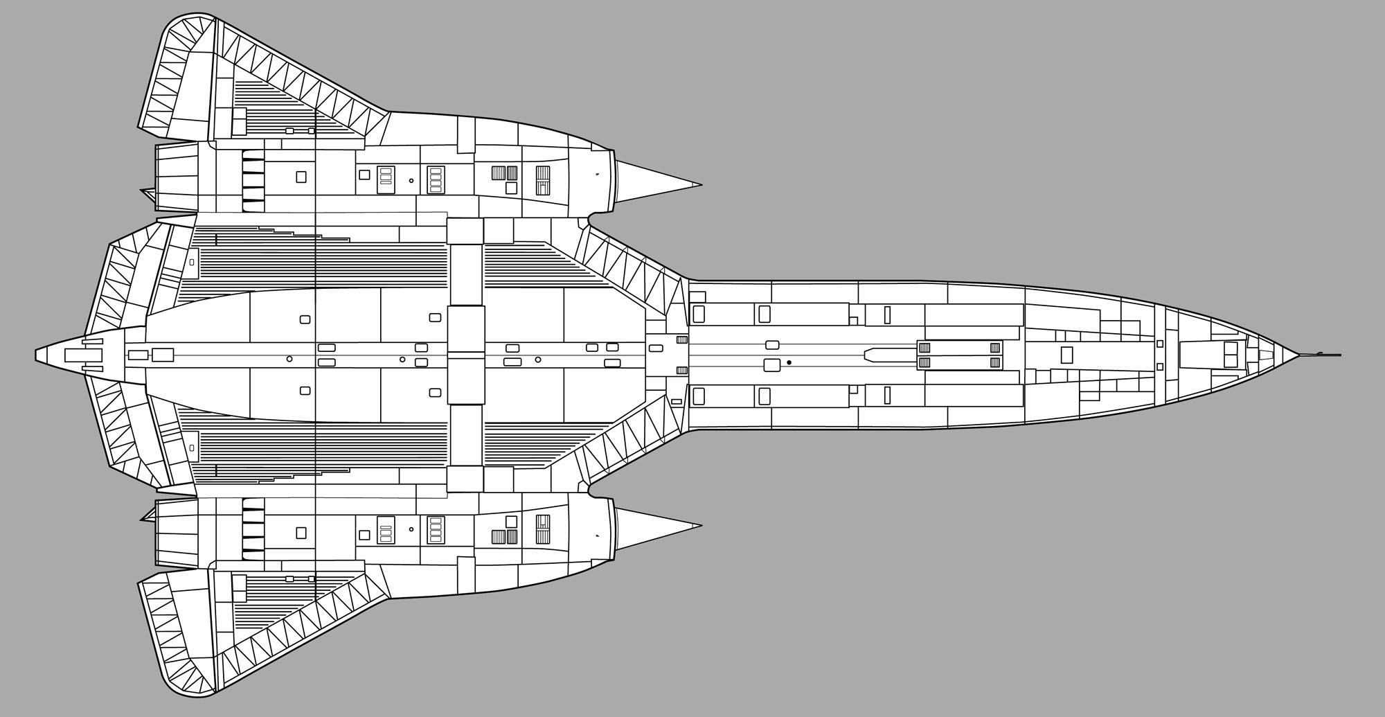

MiG31 Posted November 11, 2011 Share Posted November 11, 2011 Does anyone have an accurate dimension of the nose length from where it joins the main fuselage to the front (minus the pitot tube)? Something along the lines of 139.61", if I'm reading one of the drawings in the Warbird Tech Series book correctly. Quote Link to post Share on other sites

Uncle Uncool Posted November 12, 2011 Share Posted November 12, 2011 I was thinking of using this rib as a template for the shape of the nose. Cut this out and fit it into the front of the kit's fuselage to help reshape it. Would take a fair bit of cutting and trimming.... Not something I am considering but would be possible if one was willing. Thanks, Nathan, my fella! I'm plannin' to reshape the whole nose, with chines 'n' cockpit elevation accordin' to Roberto's post on Britmodeller. Sure it's gonna take quite more than just a fair bit of cuttin' 'n' trimmin,' but both yer work on the nose + Roberto's on the cockpit area have inspired me. Real fancy yer ASARS nose. Incidentally; there're a lot of good piccies for reference on Britmodeller's walkaround section; dunno whether ya've checked 'em out already. Thanks once again, mate. Hope ya're enjoyin' yer weekend over there in beautiful Oz. Funny, I was visiting my cousin a few weeks ago, and he reminded me of the airshow that we attended when we were much younger. We got to see the SR-71. We are both in our 40's now, so you know she made an impression. :lol: Indeed! Nay nearly 30 yet, but certainly think I'd have given ten years of my life in exchange for the privilege to see the SR-71 throw off some booms up close 'n' personal. Cheers now, lads Unc² Quote Link to post Share on other sites

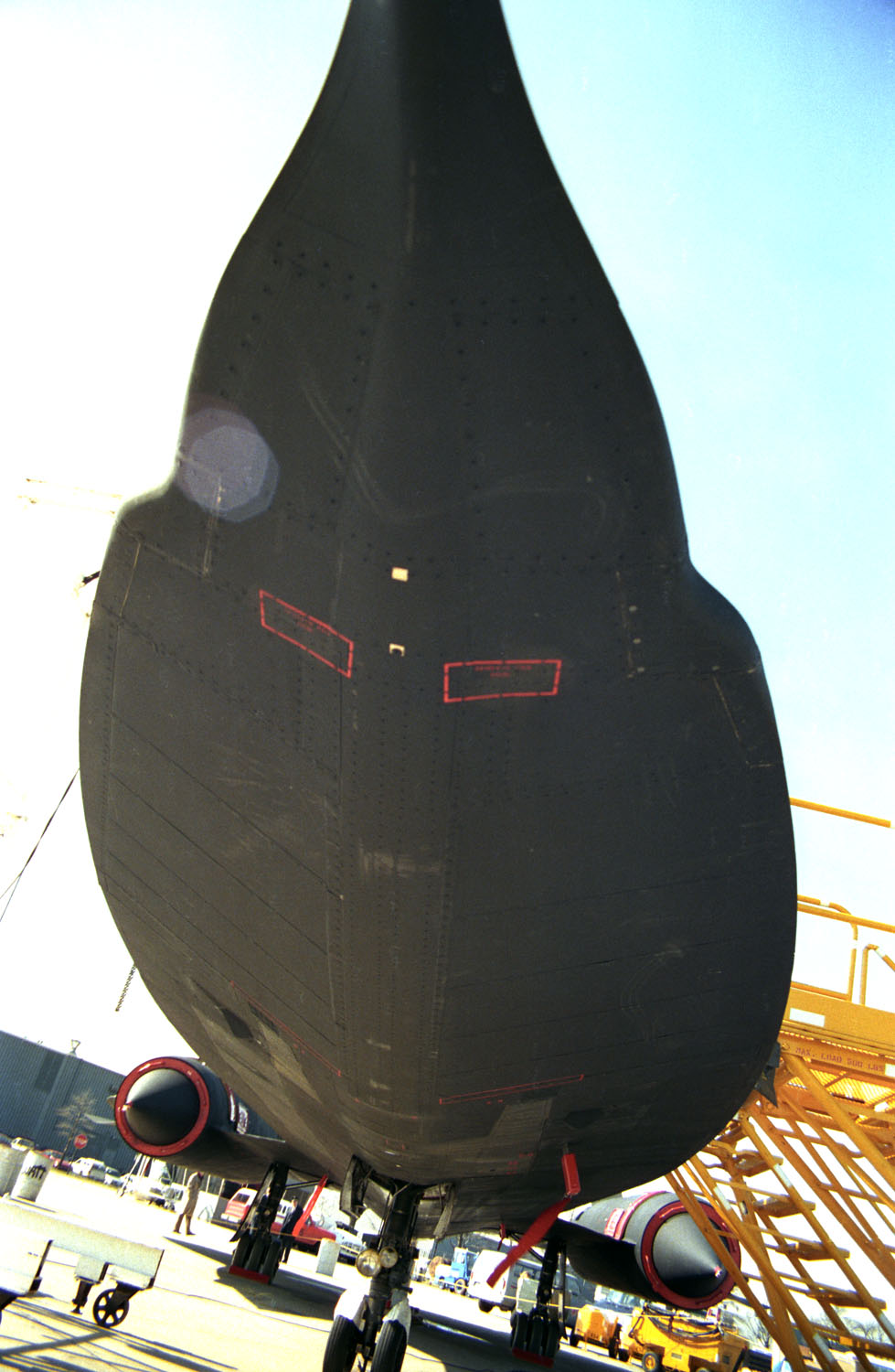

nimrod77 Posted January 2, 2012 Author Share Posted January 2, 2012 I have another question for the Sled Lerned.... If the TEOC and OOC cameras were not fitted in the aft equipment bays were there still windows fitted or were they blanked over? In the picture below that X-plane fan showed, there only apears to be two windows. For the TEOC's? Thanks guys! Quote Link to post Share on other sites
ReccePhreak Posted January 2, 2012 Share Posted January 2, 2012 I have another question for the Sled Lerned.... If the TEOC and OOC cameras were not fitted in the aft equipment bays were there still windows fitted or were they blanked over? In the picture below that X-plane fan showed, there only apears to be two windows. For the TEOC's? Thanks guys! Because of the high cost of the windows, they were not installed unless cameras were installed in those positions. The photo you posted shows a plane carrying 2 TEOCs and one OBC. I am surprised it is not carrying a TROC, but they may have been retired by the time that picture was taken. Larry Quote Link to post Share on other sites

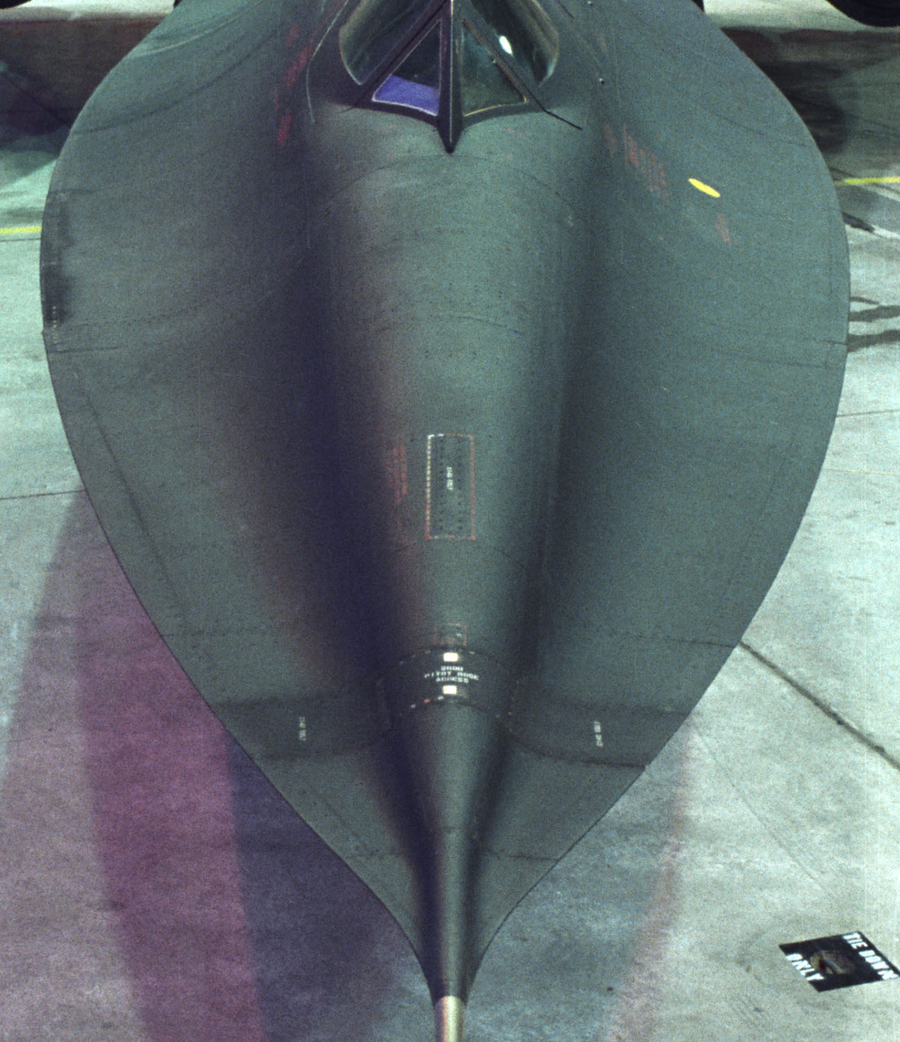

nimrod77 Posted January 3, 2012 Author Share Posted January 3, 2012 How does this look to you Larry and Co. ?? Quote Link to post Share on other sites

nimrod77 Posted January 5, 2012 Author Share Posted January 5, 2012 (edited) Hi again Larry, Does the location of the windows on this pic look right? Also, is the TROC' window shown on this pic? Is it rounded or square? Thanks again Edited January 5, 2012 by nimrod77 Quote Link to post Share on other sites
ya-gabor Posted January 5, 2012 Share Posted January 5, 2012 I was stationed at Beale AFB, from '77 to '80, and was assigned to the Photo Sensor Shop. While there, we had all 4 camera types in the shop: OBC (Optical Bar Camera), TEOC (Technical Objective Camera), TROC (Terrain Objective Camera) & OOC (Operational Objective Camera). I never saw the OOC loaded for operational missions, only for training. Optical Sensor Technicians were usually trained for one type of camera, mine was the OBC's, both 24" & 30" versions. We all uploaded & preflighted all the cameras, as well as downloading them from the aicraft. The TROC was installed in front of the nose wheel well, not behind. Later, that space was taken up by the ASARS datalink antenna, which was after I left Beale. We were still flying the original SLAR system while I was stationed there. You're right about the OOC's being loaded in the chine bays behind the TEOC's, but as I mentioned, they were no longer being used operationally by mid-1977. WOW Larry, that must have been a job from 77 to 80 It must have been very interesting working with this aircraft. I saw in 1983 the SR-71 in the UK in person and it was an amazing site, a trully fascinating aircraft even if at that time we were on opposing sides of the iron curtain. One has to give credit, it was something special! Lockheed did create one of the best aircraft of the last century! As to the threat during a live mission for the SR-71. In the mid 80's i spoke with Russian pilots and by then they had an "answer" to the SR-71. Best regards Gabor Quote Link to post Share on other sites
