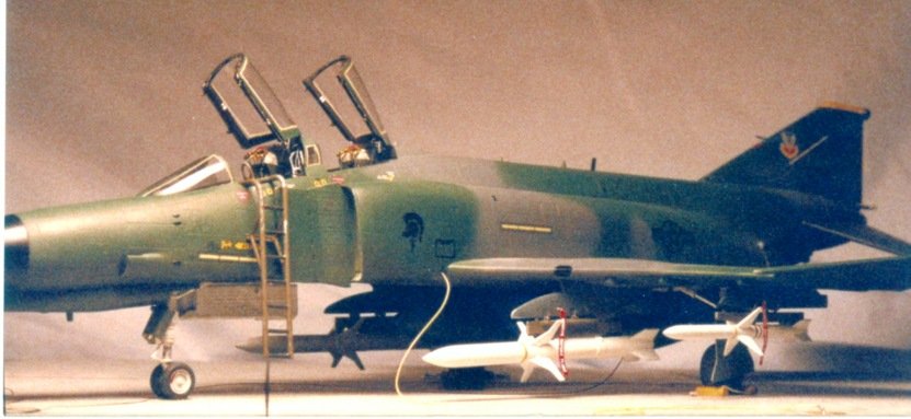

Will be an awesome end-product, Benner.  I did one way back in 1985.  There was no aftermarket for it and George AFB was still open, using the Euro 1 camo scheme.  I spent quite a number of hours detailing each seat, adding swaybraces, safety pins, etc.  Painted with MM FS colors and the  radome was then new Tamiya semi-gloss blacks.  Much use was also made of then Metalizer® paints for the titanium burner areas and their awesome "smoke" for making the typical soot all over the same area.  Mirrors, compass cards, I think I added a landing gear handle.
It's a great kit and went together well.
nice work.  did you put the safety pins in all the areas like landing gear, arrestor hook, ECM dispensers, etc?

 The F-4 uses collars to safe the gear and I had it posed as either ready-to-launch or just returning.  The EOR crew would've put the safety pins in the MAU-12's before it taxied back to the ramp.  So no arrestor hook pins (I believe it's a bracket with a braided steel cable) and the AN/ALE-40's (Chaff/Flare)  would normally be pinned but I opted to just leave them uninstalled.  That is, the dispensers are not on the pylons. The seats are "safed" with some of the RBF streamers showing but the collars for the canopies are not installed.  Since the parachute pack door is closed, it would have to be "ready-for-launch" I suppose.
As for ailerons, I found cutting them out after wing halves glued together, used EVERGREEN® styrene tubes that match in width to top/bottom of control surface, glued to the front of the aileron and then filled with modest amounts of putty.
The AOA probes you have a sweet.  I used hypodermic tubing for pitot probes...two different sizes for the nose and vertical stab.
Edited by VADM Fangschleister
