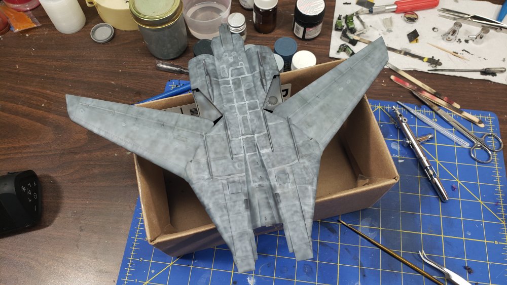

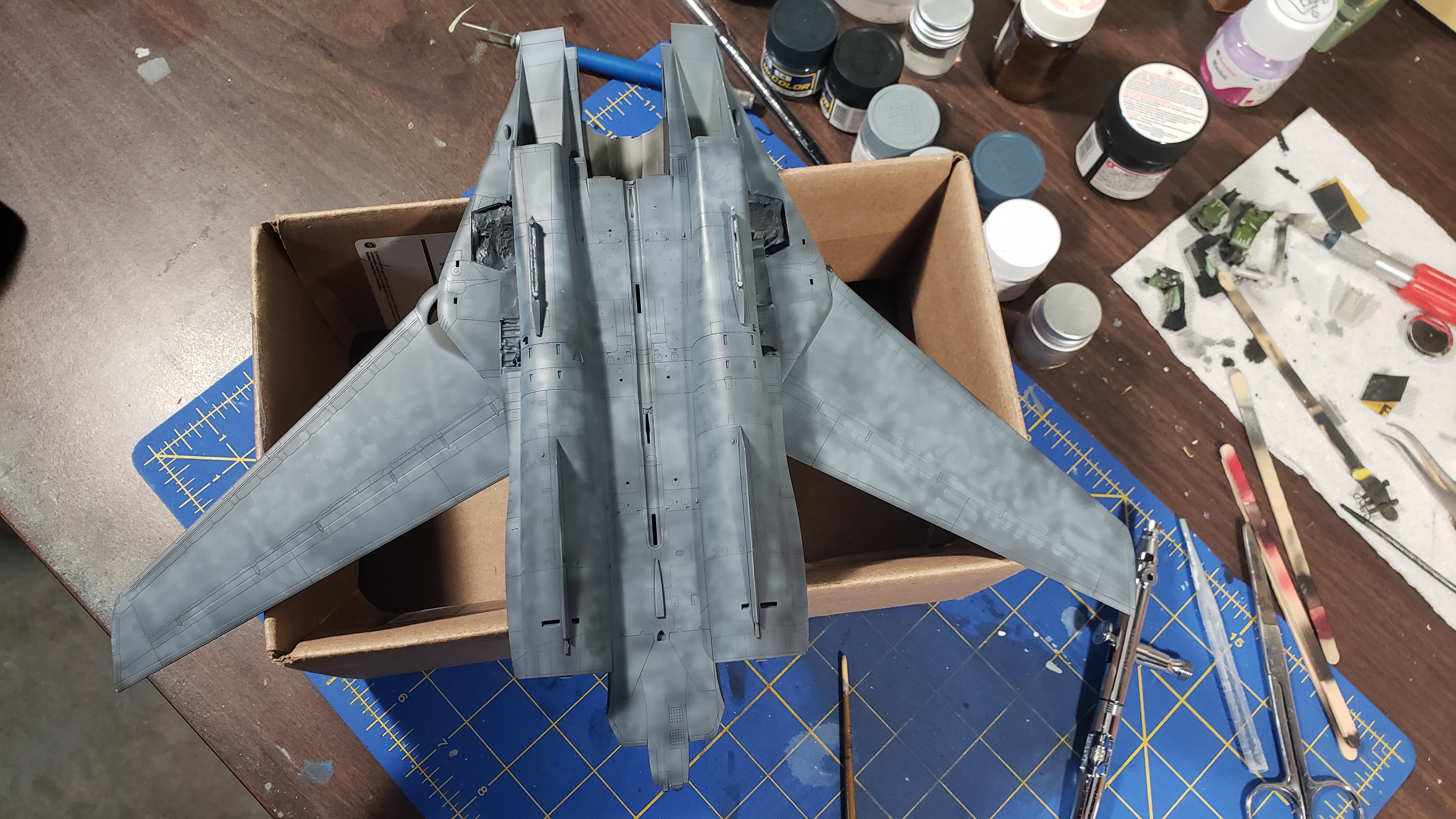

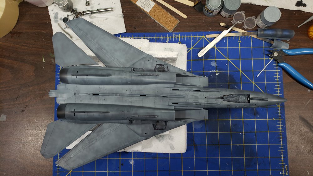

MA Cooke Posted April 28, 2021 Author Share Posted April 28, 2021 Got the upper wings darkened a bit, as well as the underside. And I pulled up the Maskol on the panel lines. THAT was satisfying, like pulling up a spider's web. Too much? Quote Link to post Share on other sites
phantom Posted April 28, 2021 Share Posted April 28, 2021 Love the wings, middle could be toned down a little. Quote Link to post Share on other sites
MA Cooke Posted April 28, 2021 Author Share Posted April 28, 2021 18 minutes ago, phantom said: Love the wings, middle could be toned down a little. Agreed - I plan to blend some with 375, then final blend with (lightened) 237. Quote Link to post Share on other sites
FASTEAGLE107 Posted April 29, 2021 Share Posted April 29, 2021 On 4/28/2021 at 2:50 AM, MA Cooke said: Got the upper wings darkened a bit, as well as the underside. And I pulled up the Maskol on the panel lines. THAT was satisfying, like pulling up a spider's web. Too much? Great marbling skills here. Maskol is a great idea. I also find my inspiration on the Doog's video (espacially the Intruder's one). Ready for more. Quote Link to post Share on other sites
MA Cooke Posted April 29, 2021 Author Share Posted April 29, 2021 1 hour ago, FASTEAGLE107 said: Great marbling skills here. Maskol is a great idea. I also find my inspiration on the Doog's video (espacially the Intruder's one). Ready for more. Thank you......thankyouverymuch. (Announcer: "Mitch has headed back to his workbench.") Quote Link to post Share on other sites

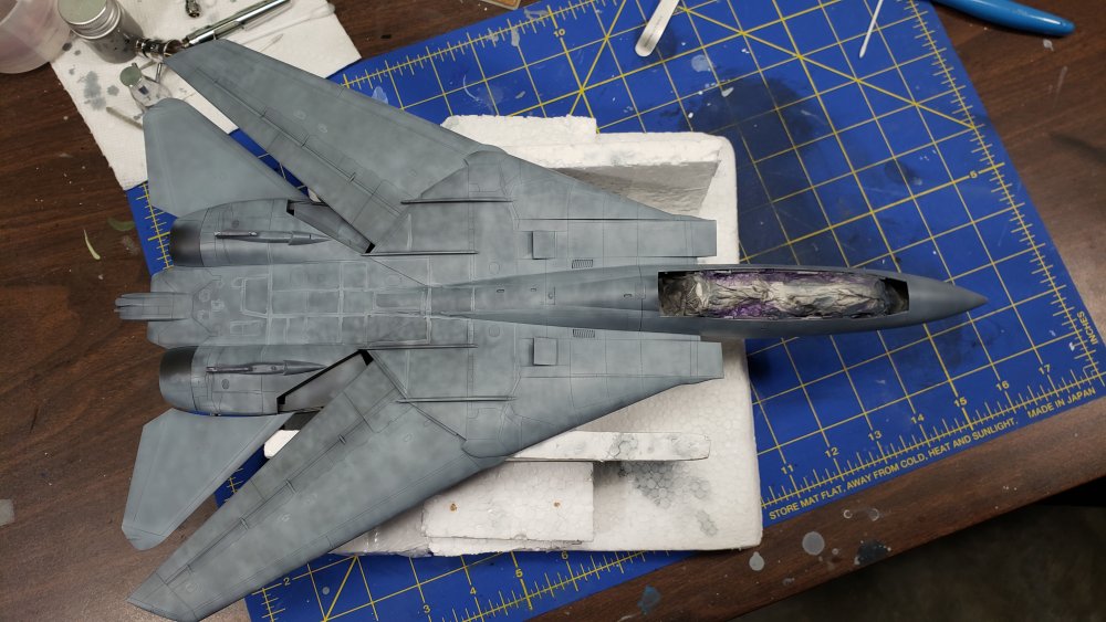

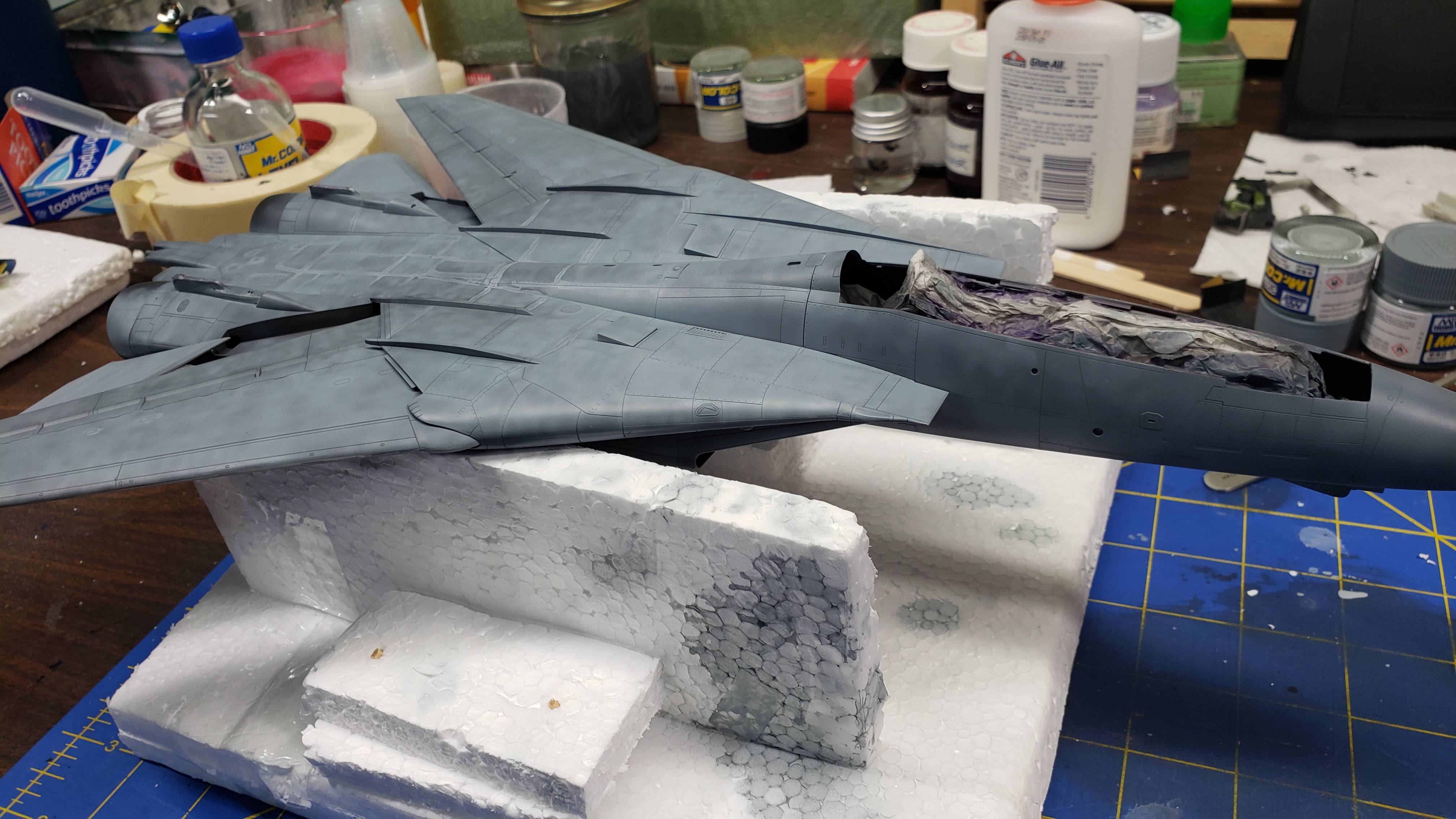

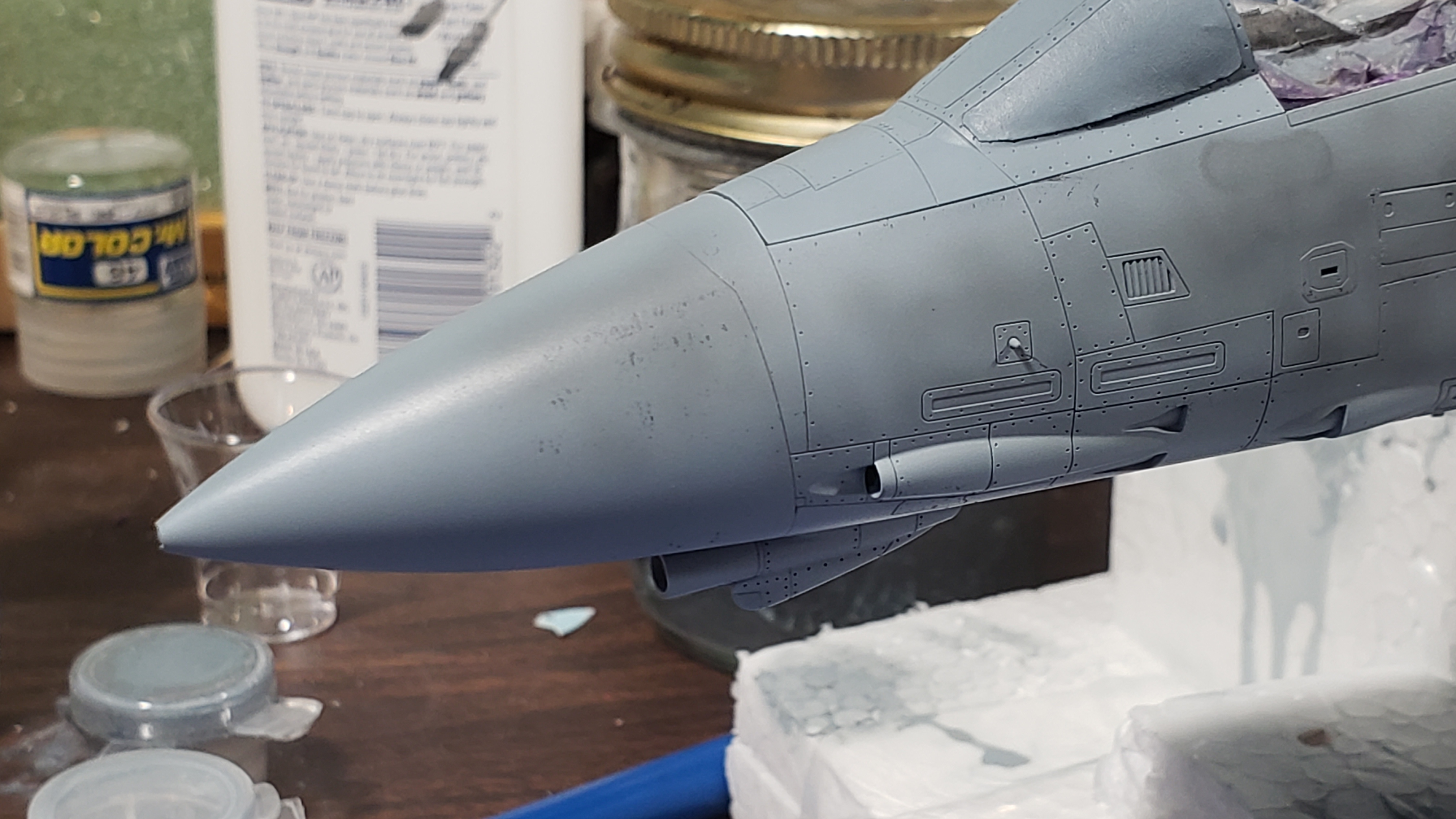

MA Cooke Posted May 4, 2021 Author Share Posted May 4, 2021 Moved into some blending layers last night. All the attachments are on sticks, and man, I feel like these alone are 2 to 3 hours of airbrushing alone. I'm thinking I'm going to do a bit of darkened marbling in the middle rear fuselage (wings back), then a lighter blend coat. Or maybe just the lighter blend, not sure. Thoughts from you all? I still need to lighten the underside, but I do want to keep the "tunnel" on the darker/grimy side. Quote Link to post Share on other sites
crackerjazz Posted May 4, 2021 Share Posted May 4, 2021 Yes, that is looking really good and realistic. That 3rd photo is already like a real F-14 zapped with a shrinking ray. I guess the randomness of the mottling is what makes it really effective. And this is all freehand, right? No templates or anything? Quote Link to post Share on other sites
MA Cooke Posted May 4, 2021 Author Share Posted May 4, 2021 14 minutes ago, crackerjazz said: Yes, that is looking really good and realistic. That 3rd photo is already like a real F-14 zapped with a shrinking ray. I guess the randomness of the mottling is what makes it really effective. And this is all freehand, right? No templates or anything? Thanks. Yes, freehand. Last night's was with the 0.5mm needle/nozzle set. The 0.35mm sizes are great for detail work, but dang, you sneeze and the tip of the nozzle is deformed. I ran to Hobby Lobby yesterday and picked up two more 0.35 sets, I had none. Quote Link to post Share on other sites

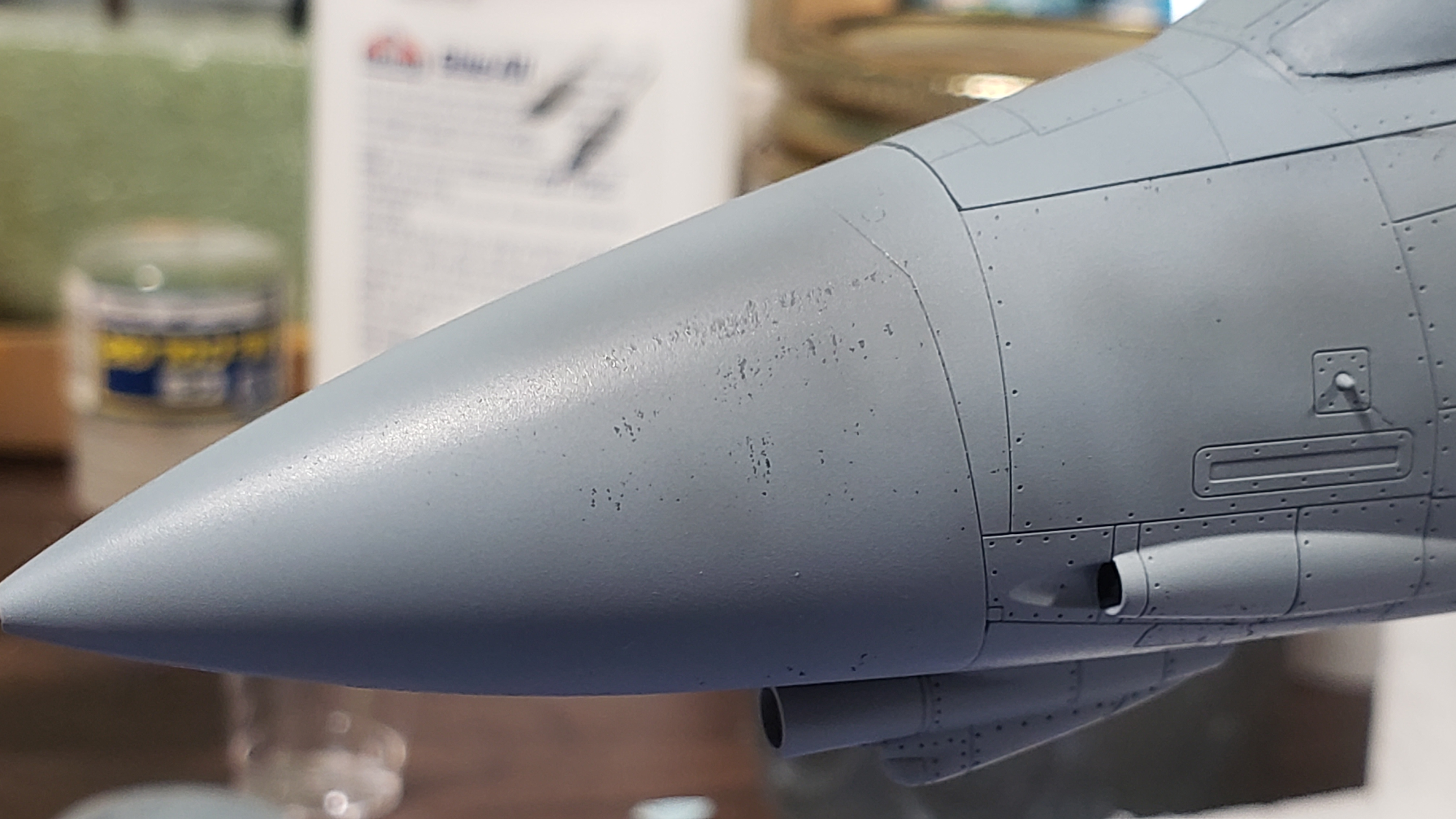

MA Cooke Posted May 15, 2021 Author Share Posted May 15, 2021 Quite frustrated....masked to paint the upper fuselage & canopy-surround area, painted, and when the masking tape was removed, it pulled some paint. I'm using the Scotch blue tape, supposed to be low tack....I haven't had issues with this before. Wondering if the "marbling technique" over black basing is leaving the paint vulnerable (due to how thin it goes down). Anyone else have this issue? Quote Link to post Share on other sites
phantom Posted May 15, 2021 Share Posted May 15, 2021 I think those little dings make it look real. Bug splats, salt spray. I like it. Quote Link to post Share on other sites
crackerjazz Posted May 15, 2021 Share Posted May 15, 2021 (edited) Yeah painters' tape can do that. Even Tamiya tape has done the same thing to me. Especially when I don't wash the oils off the kit parts first, cause I tend not to prime. Was the paint fully cured? You'll probably need to lessen the tack by sticking the tape to your wrist several times before using it and when you pull off the mask from the model, fold it over 180 degrees and go very slowly. Sometimes if I really need to mask bigger areas I use litter bags and just tape the very edge if necessary, or sometimes I just use cling wrap. Maybe you can sand down the area a little just to get rid of the ridges (but only if they are noticeable), then do the marbling again. The great thing about marbling and weathered paint schemes is how forgiving they are to retouches. Edited May 15, 2021 by crackerjazz Quote Link to post Share on other sites
FASTEAGLE107 Posted May 16, 2021 Share Posted May 16, 2021 13 hours ago, phantom said: I think those little dings make it look real. Bug splats, salt spray. I like it. Yes. You would have done it, you wouldn’t have succeeded... nice touch MAC ! THe weathering process will subdued it Quote Link to post Share on other sites
MA Cooke Posted May 16, 2021 Author Share Posted May 16, 2021 15 hours ago, crackerjazz said: You'll probably need to lessen the tack by sticking the tape to your wrist several times before using it... Nope. My nickname in high school was "gorilla wrists". LOL JK I have just enough hair that your suggestion is still a "nope", though. I do get the gist of the idea. Maybe I'll keep clean hands, and just do that with my fingers or palm. Quote Link to post Share on other sites
