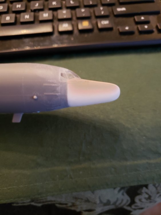

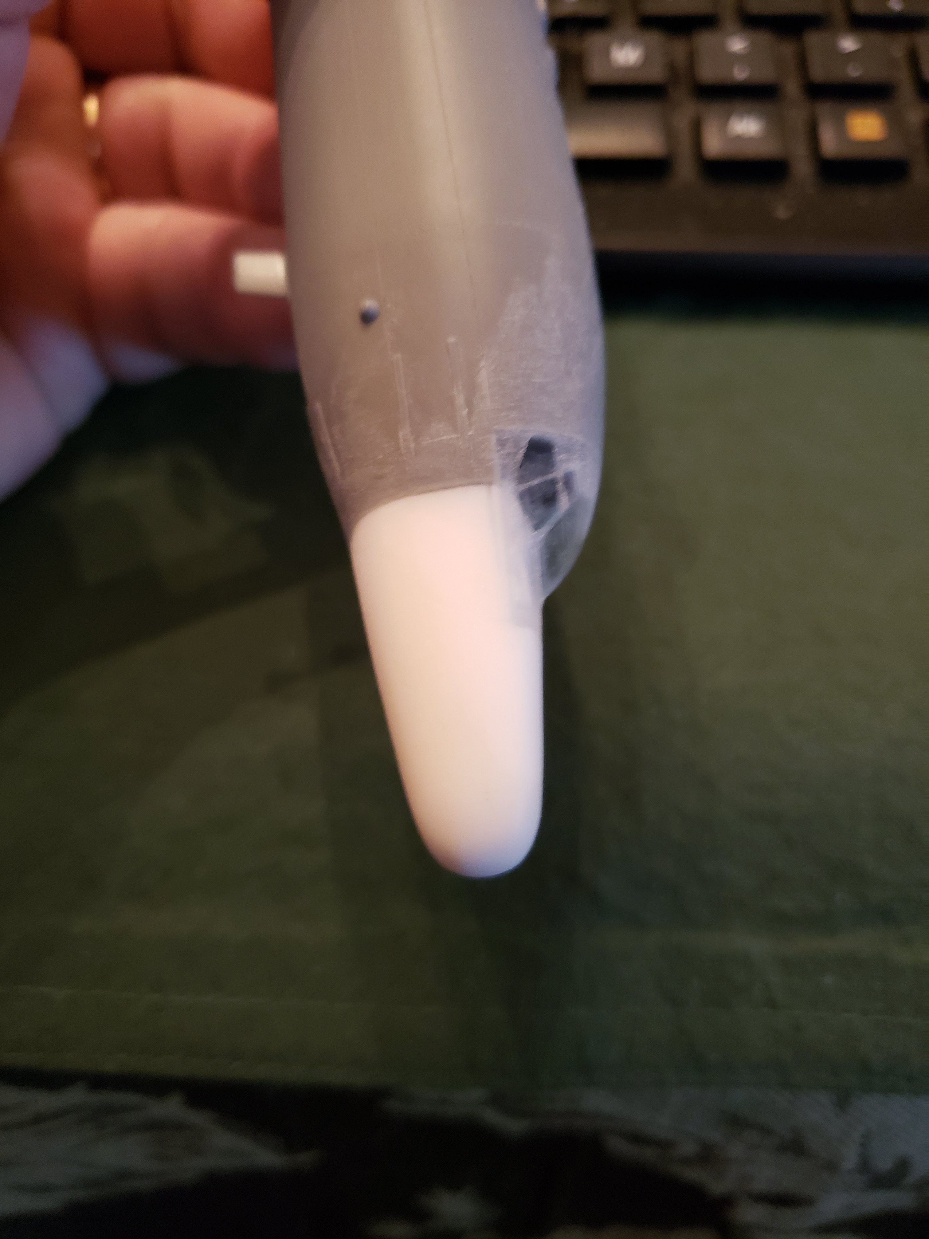

Drifterdon Posted July 5, 2022 Share Posted July 5, 2022 So not meaning to hijack your thread Dutchmaster but I just couldn't get past the pointy too small hog nose of the Roden kit. I cut off the kit nose and scabbed on one of my resin radomes. Still in the rough stages but it looks much better than the kit one. Quote Link to post Share on other sites
Dutch Posted July 5, 2022 Author Share Posted July 5, 2022 (edited) Don, I normally don't look at or comment about other guy's noses, but that looks really good! As far as I am concerned, post any photos of your progress here also. I will build mine "as is" as a sort of product review. I want to get most of mine done before I leave next week for a business trip. I hope to have it ready for paint by early August and then ready for decals whenever Kursad releases his set. Edited July 5, 2022 by Dutch Quote Link to post Share on other sites

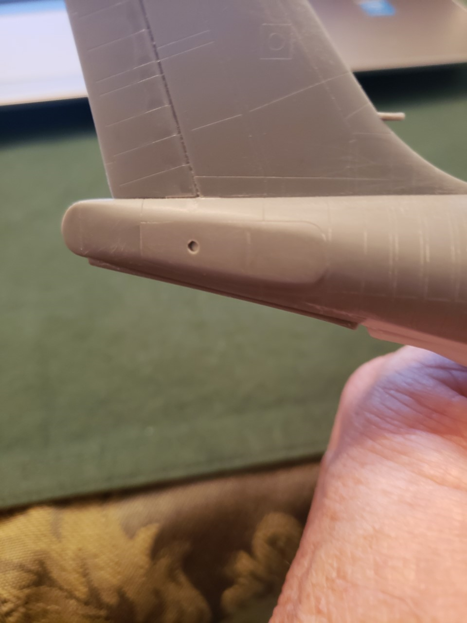

Drifterdon Posted July 6, 2022 Share Posted July 6, 2022 So the stabilizer attachment areas are super simple to clean up. Like Dutch, I glued a backing piece before I glued the fuselage halves together. I gave them a suitable amount of time to dry then hit the outside with a file. In less than 5 minutes I knocked the raised area down then finished up with a sanding stick and it was fixed. Looks as good as the Minicraft area. No need to hack the tail end off another kit and graft this the Roden kit. Just hit it with a file and then finish with a sanding stick. Easy peasy. I can post a pic later. Quote Link to post Share on other sites
Dutch Posted July 7, 2022 Author Share Posted July 7, 2022 (edited) I am almost up to speed with you Don. I have not started the engines, but hope to this weekend. I have to take care of a house issue first, then back to this little beastie. I concur about filing the horiz stab attachment area down to flat. It was pretty easy. I have to rescribe some panel lines still, but overall, not too bad. More importantly, not too hard! I will post photos later this weekend. Also, I have been thinking that the way the parts are laid out on the sprues, when Roden does release the KC-135R tanker version, the recon pieces should also be there as well. Only new fuselage halves should be required. So you will end up with enough spare parts for other recon variants that have the boomers station. JT3D/TF33 engines would be a nice plus though. We will see what Roden releases. I think if enough sales and positive reviews are garnered, then Roden will do a KC-135R. Edited July 7, 2022 by Dutch Quote Link to post Share on other sites

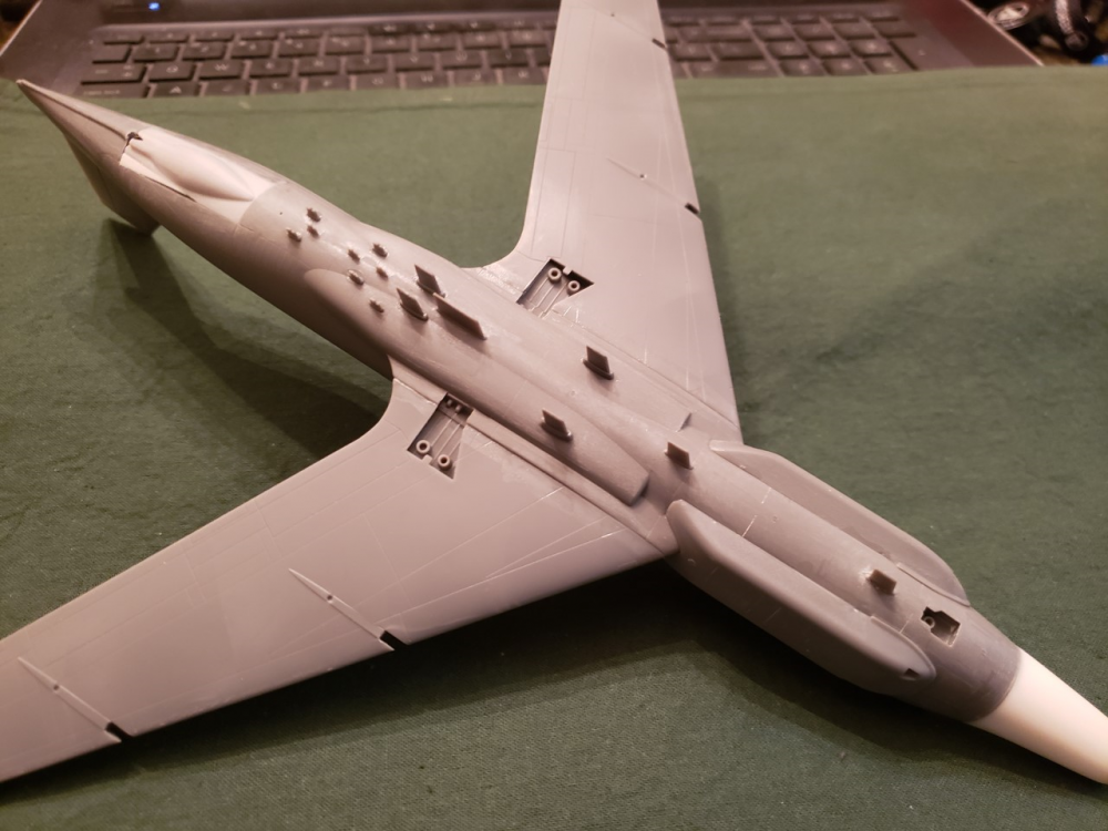

Drifterdon Posted August 7, 2022 Share Posted August 7, 2022 Hey hey Dutchmaster. Any work on your Rivet Joint? I've made a little progress on mine. I'm still cleaning up the engines. They aren't bad just need work. I've decided to go a different route with mine. I'm going to build it as a current Cobra Ball. Probably as 2662 as seen below. I've already replaced the ventral antenna area back where the boomer would reside with a Minicraft boomers section. I'll try and post some in progress pics later. Quote Link to post Share on other sites

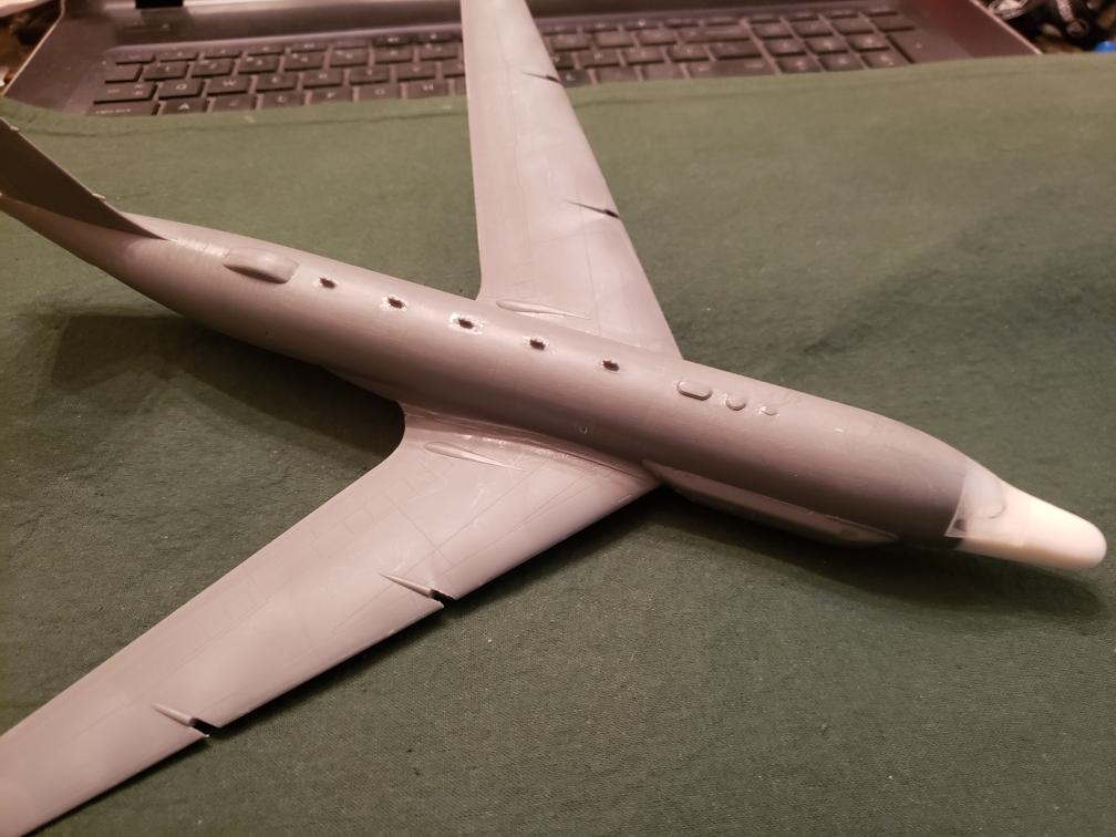

Drifterdon Posted August 8, 2022 Share Posted August 8, 2022 Some updated pics on where my Roden RC-135 kit stands. The bottom with the forest of antennas. The smaller antennas still need to have the small discs glued on. The boomers section that Cobra Balls have needs to have the glue dry then I can putty it in. The upper for now. One thing I discovered is the small Satcom antennas should be staggered and not all lined up down the centerline of the aircraft. Certainly makes it difficult in cleaning up the top seam. I may still cut them off and re-glue them staggered. Here is the horizontal stabilizer attachments cleaned up so they aren't the plateaus that Roden molded them as. Quote Link to post Share on other sites

Drifterdon Posted August 8, 2022 Share Posted August 8, 2022 (edited) Thanks Ray. From what I can tell, the current Cobra Balls, Rivet Joints, and Combat Sents all have similar antenna placements. At least for this latest Baseline. If your doing an earlier Baseline then you'll need to study photos as they are very different. Edited August 8, 2022 by Drifterdon Quote Link to post Share on other sites
