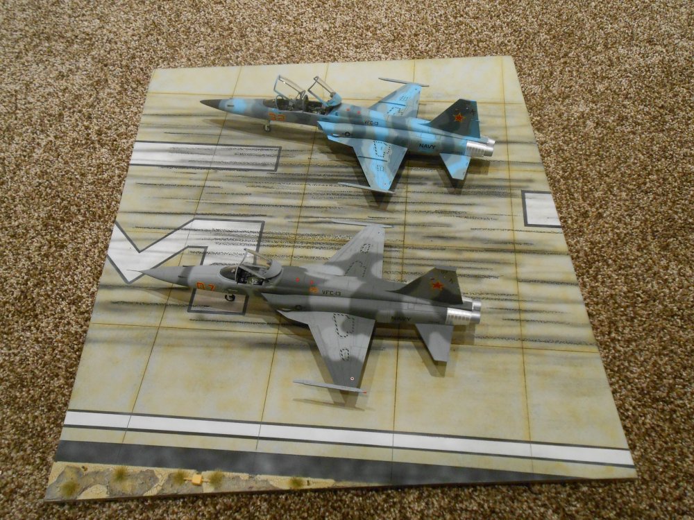

f5guy Posted April 30, 2023 Share Posted April 30, 2023 (edited) Hi everyone, Well now that my long term "Adversary Twins" build thread is complete, I've decided to tackle two more adversaries: two VFC-13 Saints F-5Es. To make things a bit more interesting, They're going to be configured for take off, and placed on a very cool base that my buddy Tony made for me last year. Here's a pic of the base with two of my previously finished Saints F-5s on it. The base is a copy of the take off end of NAS Fallon's runway 31L, which is the main runway there. I had wanted to build a pair of the AFV Tiger kits in take off mode for some time, but I had originally planned on doing a pair of Air Force aggressors taking off at Nellis AFB. While talking one day, Tony proposed the idea of doing runway 31 at Fallon, since he had some good pics of it. I was all for it, but making bases isn't really my thing. However, Tony loves to build them, so he volunteered. Who am I to say no?! So he finished it up, and last May he and his wife drove out to Utah from California to deliver it, and hang out for a long weekend. The base has been staring at me since, so now is the time to get this project done 👍 Obviously the aircraft wouldn't be that close together on take off in real life, but space limitations dictated that the scene had to be compressed a bit. More to come. Fred. Edited April 30, 2023 by f5guy Quote Link to post Share on other sites

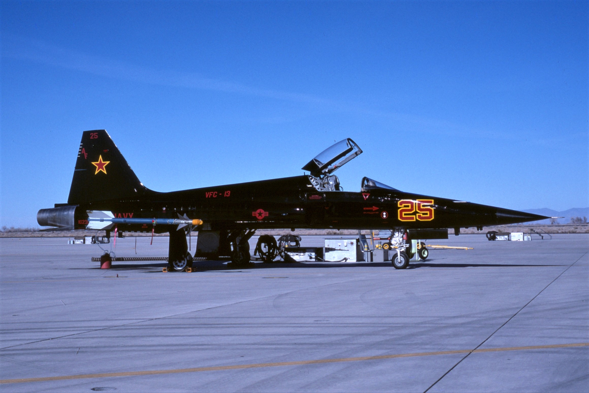

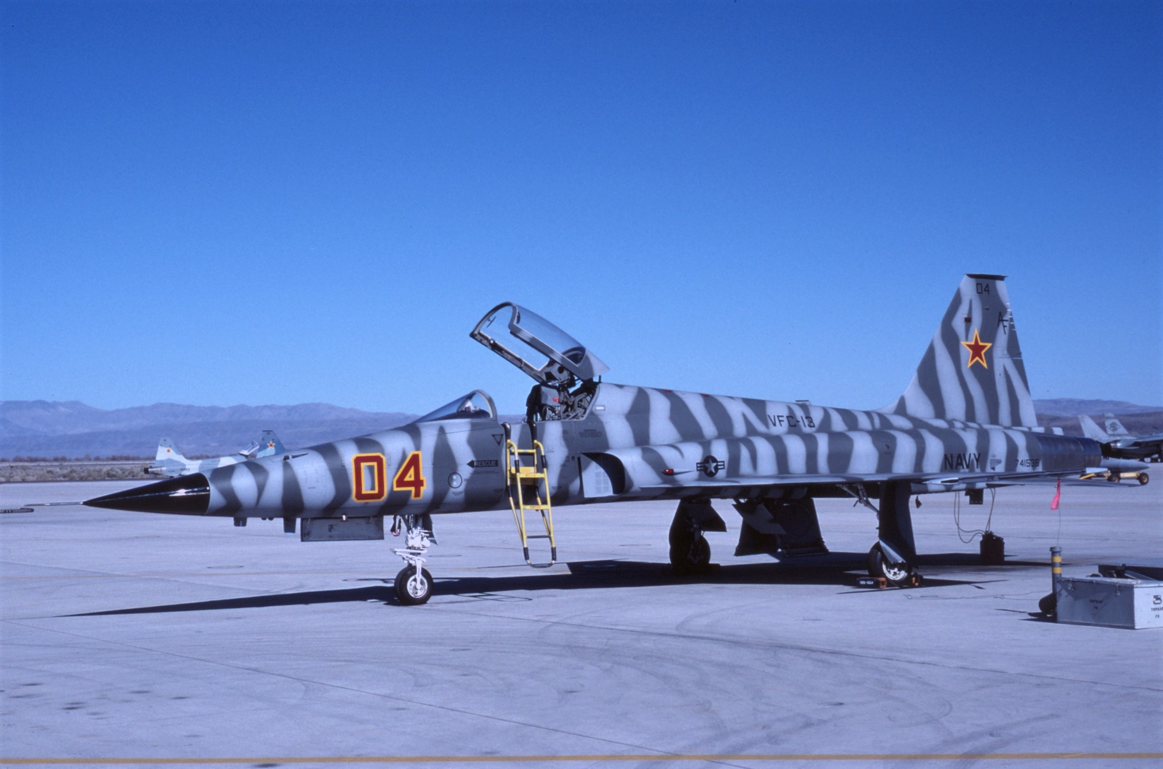

f5guy Posted April 30, 2023 Author Share Posted April 30, 2023 (edited) So here's the first kit that I'll be using in this build. I have actually already started both kits last year, so the kits pictured are from my stash. This is just to give you an idea of what I'm starting with. The first kit is the Sundowners version, which has the duckbill nose cone, and wing root leading edge extensions (LEXs) of a later built or upgraded F-5E (pic 1). All of the first two groups of Navy F-5Es and Fs had the round nose cone and no wing root LEXs when first delivered in the mid-70's, but upon going through depot level maintenance in the early 1980's, all came back with the duckbill nose cone and extended LEXs, which improved their flight handling. There are a couple of Navy F-5Es that I have singled out as ones that I'd like to build in every aggressor paint scheme that they've ever worn. F-5E BuNo 162307 is one of those Tigers. It was originally built for the South Vietnamese Air Force, but with the fall of that country, it, and about 40 other undelivered F-5Es were delivered to the USAF to use as aggressors instead. BuNo 162307 was originally USAF serial number 74-1533, and was delivered to the 527th Aggressor Squadron at Alconbury AFB in the UK, where it was their #33. After several years of service, it was selected to be transferred to the Naval Fighter Weapons School (NFWS) aka Topgun at NAS Miramar as an attrition replacement. It has the distinction of being the only former USAF F-5E airframe to be delivered as an attrition replacement to the Navy. All other former USAF Tigers that were later delivered to the Navy and Marine Corps kept their USAF serial numbers, but this one got a Navy BuNo. At Topgun it flew as their #41 for a number of years, and I have fond memories of photographing it many times as a teenager. When NFWS upgraded to Hornets and Vipers, their F-5Es were sent to VF-126, also at Miramar. After a brief stay with 126, it was sent to VF-43 at NAS Oceana. There it stayed until being sent to VFA-127 at NAS Fallon. When VFA-127 was disestablished on March 23rd 1996, VFC-13 took it on charge, along with all of the remaining original USN F-5Es and Fs. In the course of its career it wore at least six different paint schemes. The airframe stayed with the Saints until the mid 2000's, but decades of dogfighting finally caught up with all of these Tigers, and they were retired and replaced by former Swiss Air Force F-5E's, commonly called F-5Ns. This aircraft now resides at the Empire State Aero Sciences Museum in Schenectady N.Y. I took the ramp pic at NAS Fallon back in 2004, shortly before the aircraft was retired. (pic 2) I've never been a fan of these black "Top Gun" movie paint jobs. I always thought that they looked pretty dumb, and you probably couldn't pick a worse color for a camo job. But, since I want to do all of paint schemes that BuNo 162307 wore, and after the complexity of the scheme on my next build, I wanted an easy scheme, so here I go! The decals are from Fightertown sheet 48051 "Desert Bogeys". More to follow, Fred. Edited May 2, 2023 by f5guy Quote Link to post Share on other sites

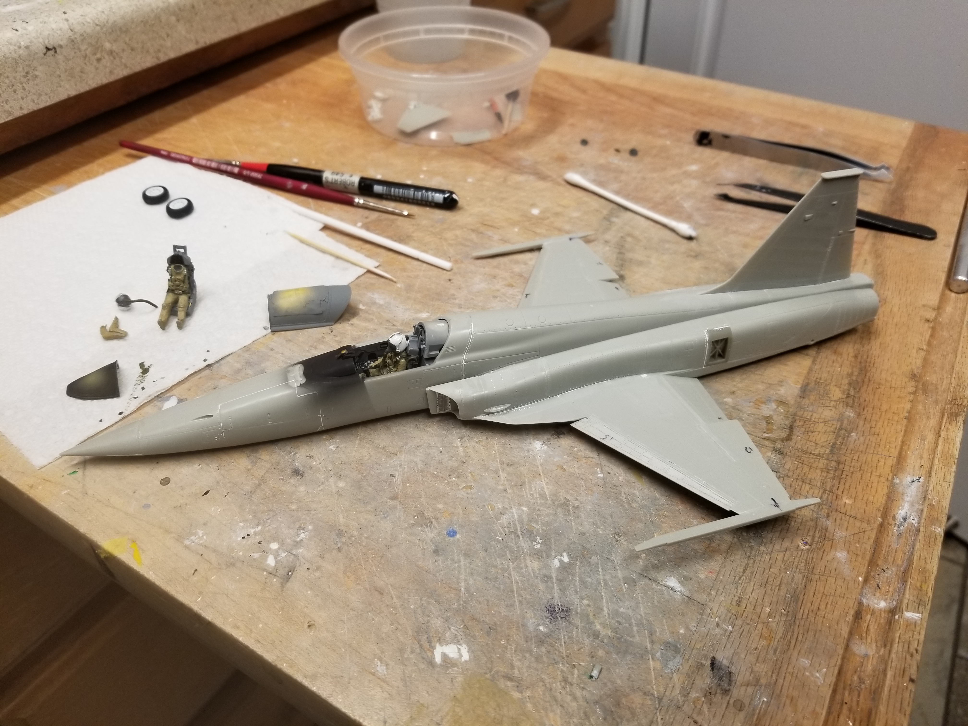

f5guy Posted January 26 Author Share Posted January 26 (edited) Hi everyone, Well after dropping the ball on this build almost two years ago now, it's back on. Recently I wanted to build a couple of USAF aggressor F-5Es, and made myself promise to drag these two along in the process, so here I go! As you can see, the build of #04 has progressed well, and is now just about to the painting stage. The only issues that I've encountered with the kit all revolve around putting a pilot into the tub. First of all, once installed, the canopy lifting mechanism doesn't really let the canopy sit flat on the airframe. The bottom of the mechanism parts need to be trimmed down, and the little rectangular alignment pin for the canopy on top of the "U" shaped part that sits inside of the canopy needs to be removed. Once this is done the canopy will sit flat on the cockpit side frame. The other problem has been the Aerobonus pilot/seat itself. The head provided for the pilot shows him with his visor up. Since these jets are about to roll, I want the visor down. I ended up substituting the heads from a Hasegawa F-18 pilot, which fit perfectly with a little adjustment to the oxygen hose. The pilot itself has two issues.... both relating to whoever carved the masters. Apparently they never checked to see if things line up. Simply put, the pilots hands don't get close to the throttle or control stick, and there's no way to get them there. This must be one of those upgraded "hands off launch" F-5s 🤣 Hopefully it won't be too noticeable once the lid is on. When I get to #25 I'll check if using the arms from the Hasegawa F-18 solves the problem. Tonight I will get the glass on and get it ready for paint. Hopefully I can get the Euro One gray down in the coming week. Thanks for being patient with me. Fred K. Edited January 28 by f5guy Quote Link to post Share on other sites

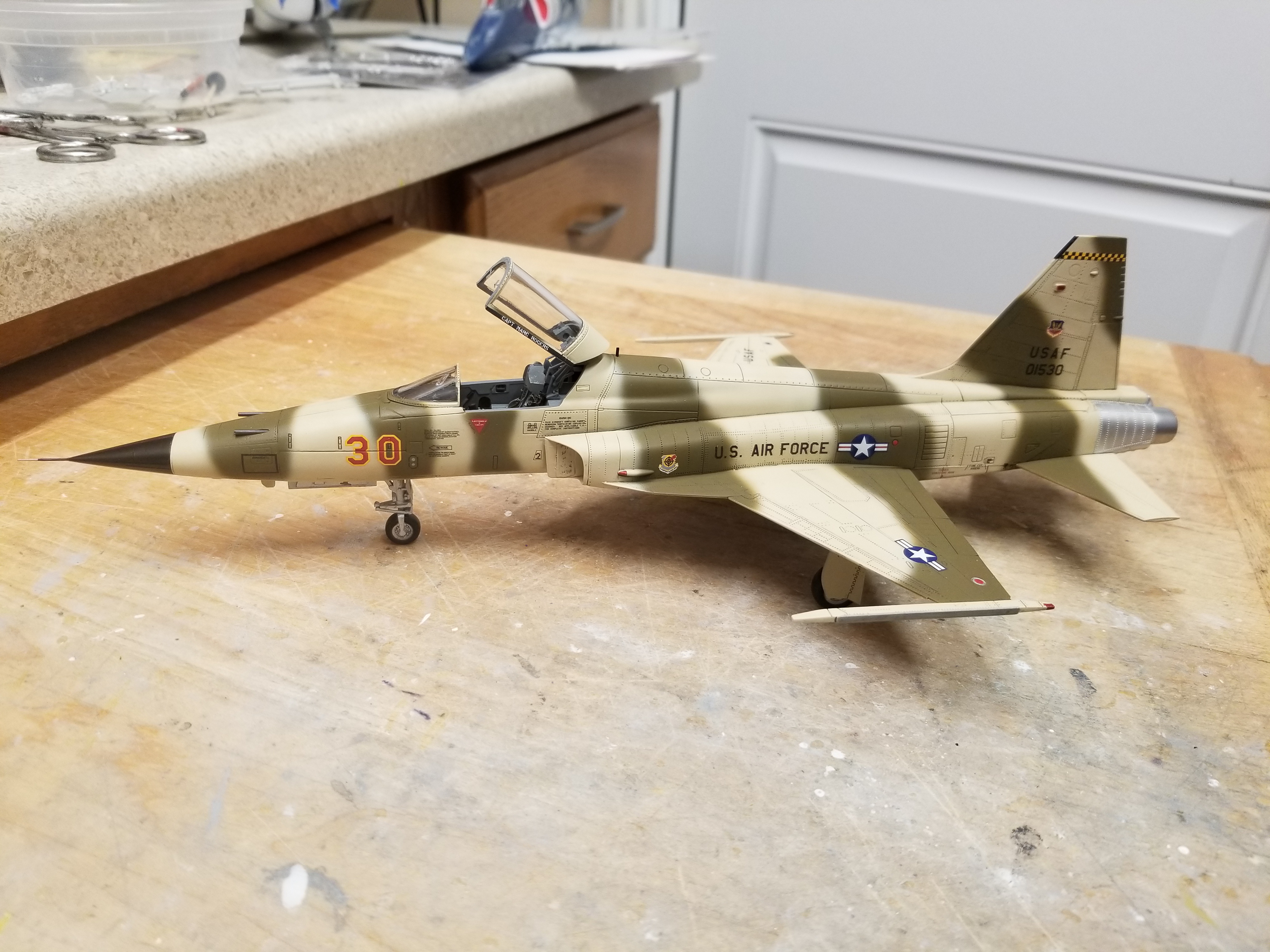

f5guy Posted January 26 Author Share Posted January 26 (edited) As a teaser, here's another AFV kit finished up as a USAF aggressor. I selected this jet because it later became VFC-13 #03, which I plan to build at some point. I think it's neat to see the history of the airframe during different time frames. All for now, Fred. Edited January 28 by f5guy Quote Link to post Share on other sites

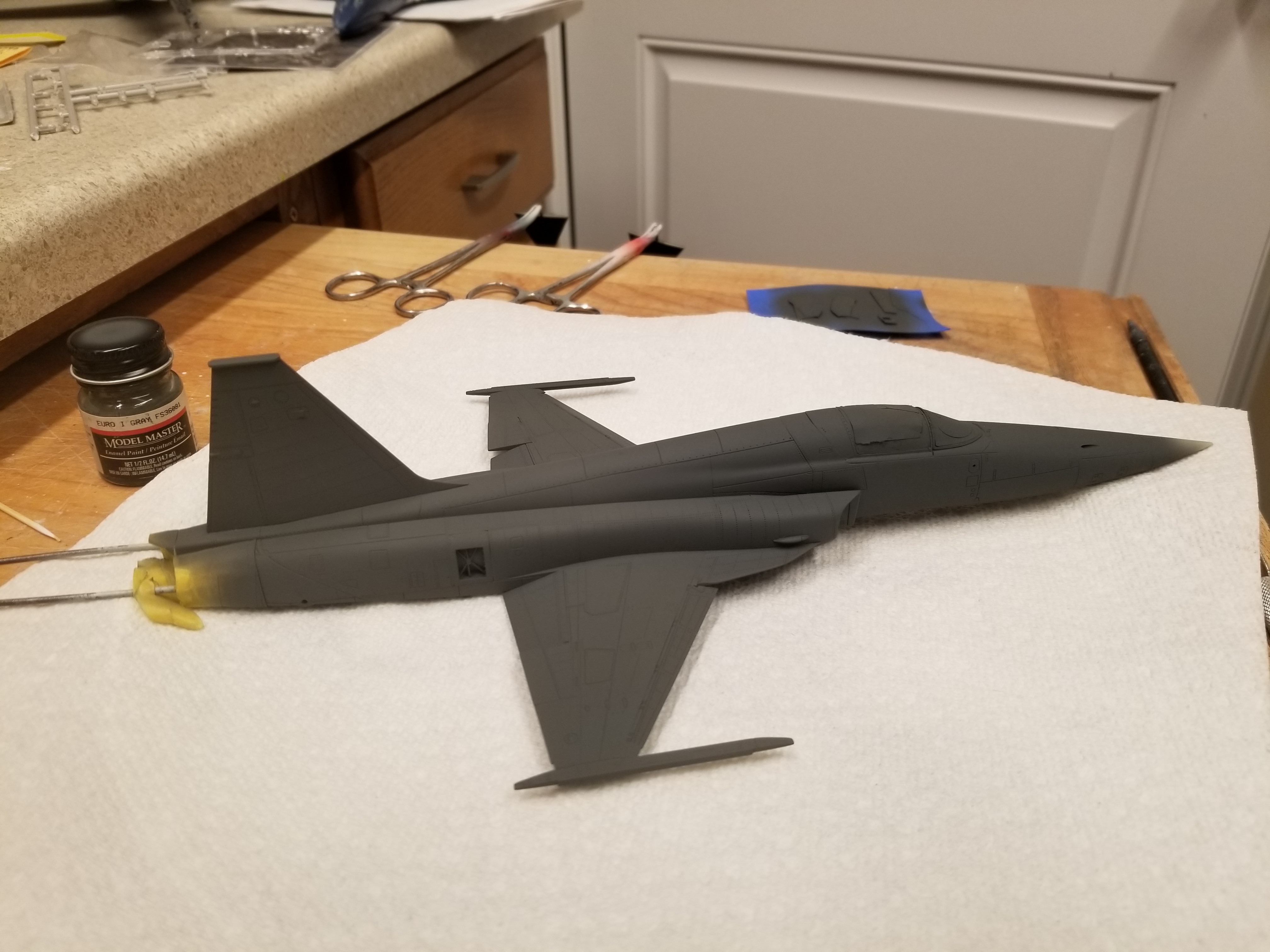

f5guy Posted January 28 Author Share Posted January 28 Thanks for your kind comments Steve and BastianD 👍 Okay, the Euro One gray (FS 36081) for #04 is on! As you can see in the pic, the paint used is my much trusted and missed, Model Master brand. Tomorrow (Tuesday), I will give it a coat of Future to seal the dark gray. Wednesday I hope to start masking. Speaking of which.... I've decided to use the set of masks that I got from Aeromask, instead of the ones that I had made by Gatorzmask. I like the yellow tape style masks of Aeromasks better than the plastic film style used by Gatorzmask. Aeromask seems to adhere better. More to follow. Fred. Quote Link to post Share on other sites
