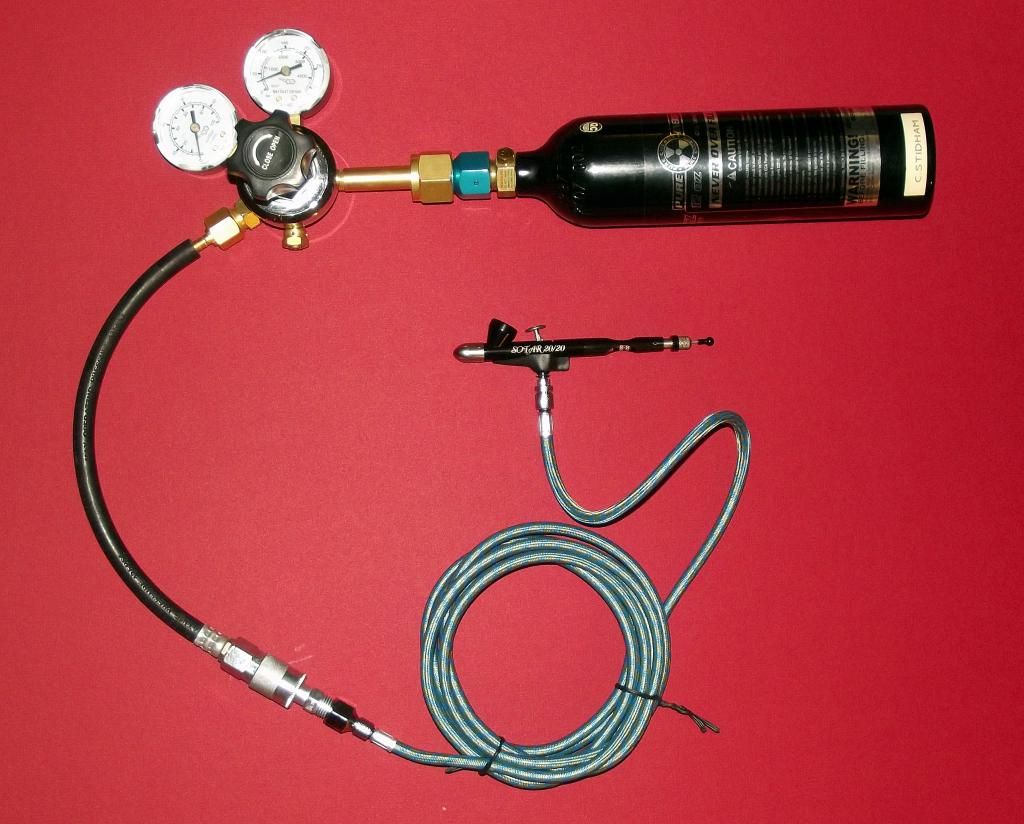

Netz Posted November 5, 2015 Share Posted November 5, 2015 For a Co2 set up, use what ever regulator you can afford, they will all regulate down to "0" pounds, but you can also double regulate if the cheapie regulator does not have fine gauge readings, use the regulator at the bottle and a second regulator at the end of the hose where you'll attach your A/B to, you can set the tank to say 50 lbs, then fine tune with the second regulator. I bought a $25 Harbor Freight reg for my portable paint ball set up and it works fine. If you already have an garage type air compressor you can just buy a regulator with water trap and use that. Curt Quote Link to post Share on other sites

Netz Posted November 6, 2015 Share Posted November 6, 2015 This is my primary set up and what I use the most, all connections are with air chucks,you can run as much hose as you need, my compressor stays on the service porch and I run hose to my table and regulator. And just to play around I set up a portable co2 rig using a paint ball tank. If you are interested in co2 go visit your local welding supply shop and see what kind of exchange program they have, I can get an exchange of a 20lb bottle for $35.00, my shop does not refill just exchange, which is actually to my advantage as they said they will take an out of date (inspection) bottle, so I can find a cheap used bottle at a garage sale and exchange that, no need to buy a new bottle just to let if go on exchange. Quote Link to post Share on other sites
Whiskey Posted November 6, 2015 Author Share Posted November 6, 2015 Cool, thanks for the ideas. Just for the sake of easement I will probably start with something like your smaller, portable CO2 rig. It seems a little bit more logical with the way I have my workshop put together in a small place within the garage. I recall seeing an image of a homemade airbrush booth I think made out of plywood and a computer fan on top of it? Anyone seen this before? I thought I saved the link or at least the picture but can't find it at all. If I remember correctly I think it only cost the user like around $40. Quote Link to post Share on other sites

Netz Posted November 11, 2015 Share Posted November 11, 2015 Netz, Just out of curiosity, what does that setup minus the AB and hose approximately go for, and how long will that tank last? I just went for a Iwata Jet Plus pro with duel regulators and connections. Set me back $467.00. My wife just couldn't take the long painting sessions with my Husky Scout compressor making all that noise when it went on, and I couldn't paint late at night or early in the morning. Joel I have about $65.00 into the mini tank set up, $25 regulator $17 adapter $21.00 co2 tank new and filled $5 for air chucks. If I were to go with a 20lb set up you can delete the adapter, and add about $60-$100 for a tank. As mentioned I spoke to my local welding supplier and they do a bottle exchange for $35, and will accept and out of inspection bottle, that will save me $ on the initial cost of getting a 20lb bottle, I can find one cheap and just exchange it with them, no need to buy a new bottle because they will take it and give you a different bottle as they do not refill them just exchange. But if I "had" to buy a new bottle I can find them for $100. As for life span of the 24oz bottle, I don't know. I've painted at least 2 models and have not seen any noticeable drop on the gauge. I gave it to one of my model club members to run it out as I was curious myself, but he never used it.... Some have commented on a 20 LB bottle lasting from 6 months others up to 3 years. My concern would be just running out at the most un-opportune time. There is a gauge that shows the PSI in the bottle, so there should be no surprises. Quote Link to post Share on other sites
