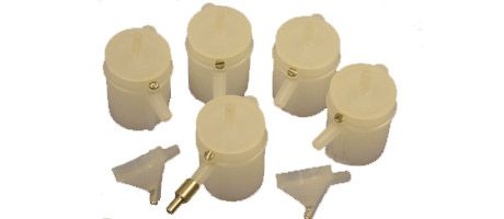

Andy Mullen Posted October 22, 2009 Share Posted October 22, 2009 As with Stew, my enamels cleanup is with Cellulose thinners (US = Lacquer), and because mine is the Eclipse SBS (sidefeed), I take off my paint pot, replace with a clean one and spray neat Cellulose into my cleaning station until clear. If it is the last paint of the session, I pull the needle and clean with Cellulose, reassemble and spray a few drops of Medea Airbrush Cleaner through to finish. If I am not using the airbrush for a while (longer than a month), I will coat the needle with Medea Super Lube, and reassemble. If not the last paint I attach another paint pot and carry on. Pots are easily cleaned after I am finished. Quote Link to post Share on other sites
