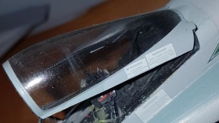

Keroburner89 Posted April 10, 2019 Share Posted April 10, 2019 Hi all, Just wondering if anyone else has this issue. If I dip my canopy in Pledge One Go, after a year or 2, it almost has this sticky residue/film on it. It's very strange but I can't get it off with water or a rag and it accumulates dust and really ruins the build. I'm wondering if it's a canopy dip specific problem or if it affects canopies in general. Attached image as an example of what I'm talking about. Quote Link to post Share on other sites
BaconRaygun Posted April 10, 2019 Share Posted April 10, 2019 Do you smoke? Or, are your models near your kitchen? Quote Link to post Share on other sites
dnl42 Posted April 10, 2019 Share Posted April 10, 2019 If it's future, have you tried Windex? I had a reaction apparently like that right when I removed the masking tape after I was done with flat coating the model. Windex helped, but didn't eliminate the issue (it's still "rough"). Quote Link to post Share on other sites
Fly-n-hi Posted April 10, 2019 Share Posted April 10, 2019 This doesn't really help you now but I stopped dipping canopies in Future several builds ago. I used Novus for many builds and recently switched to Tamiya Polishing Compound. Canopies are crystal clear. Future dipping has become totally unnecessary now. Quote Link to post Share on other sites
Jonathan S Posted April 10, 2019 Share Posted April 10, 2019 I'd use WD40 first. Apply to a que-tip and only clean the canopy, try not to touch the paint too much. Quote Link to post Share on other sites
Keroburner89 Posted April 10, 2019 Author Share Posted April 10, 2019 Thanks for the input guys, it's a real shame, I've had this happen to just about all of my canopies. I don't smoke, but models are kind of near the kitchen and my apartment is rather small. You might be right there regarding oils floating through the air. I've also stopped dipping, polishing enough eliminates the need. Interesting, I'll try WD-40 and windex. Cheers gents :) Quote Link to post Share on other sites
TheRealMrEd Posted April 12, 2019 Share Posted April 12, 2019 Try Goo Gone. There are several other "look-alikes", such as label removers, etc. but they do not work as well for this. I use it to remove masking residue, etc. and it won't hurt the plastic. Ed Quote Link to post Share on other sites
habu2 Posted April 12, 2019 Share Posted April 12, 2019 On 4/10/2019 at 11:48 AM, Jonathan S said: I'd use WD40 first. Both WD40 and Goo Gone contain petroleum distillates but Goo Gone makes a formula specifically for removing sticky adhesives. Quote Link to post Share on other sites
echolmberg Posted April 17, 2019 Share Posted April 17, 2019 (edited) On 4/11/2019 at 11:24 PM, TheRealMrEd said: Try Goo Gone. There are several other "look-alikes", such as label removers, etc. but they do not work as well for this. I use it to remove masking residue, etc. and it won't hurt the plastic. Ed Ed (or anyone else who might know), I've used Goo Gone in the past to remove tape or Bare Metal Foil residue from canopies, but does anyone know if it'll harm enamel paint? I have some canopies similar to Keroburner's but I've been hesitant to try the Goo Gone trick out of fear of it harming the surrounding enamel paint where some of the tape/foil residue is located. Eric Edited April 17, 2019 by echolmberg Extra description for clarification. Quote Link to post Share on other sites
TheRealMrEd Posted April 18, 2019 Share Posted April 18, 2019 Doesn't seem to bother either Alclad II or Colourcoats or Model Master enamels -- can't speak for anything else. I usually mask canopies with either Tamiya tape or Parafilm "M", and I use the Goo Gone for removing residue. Ed Quote Link to post Share on other sites
