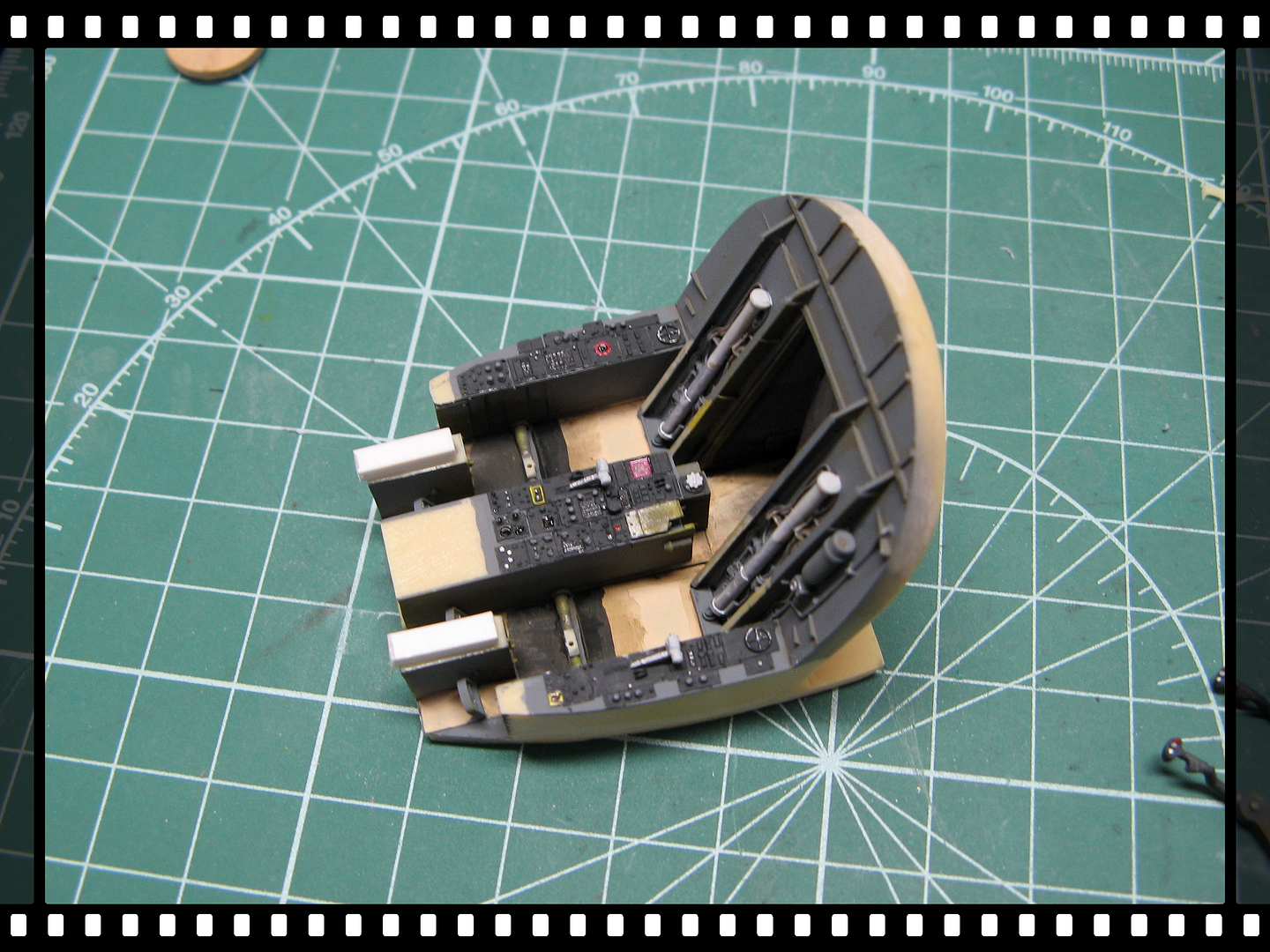

Greetings all,
I hope you all are well and safe.
I've made pretty good progress on the Viking's cockpit so far. I still need to paint a few things but, for the most part, the tub, center console, sticks and, the IP are finished. I need to add a few things to the seats so I can work on those next. Then the entire cockpit can be weathered, especially the floors.
I also finished up the tailhook well and decalled the hook. Once I flat coat the tailhook, I'll paint the hookpoint and this can be assembled.
Thanks for taking the time and having a look, until the next update ...
Steve

Greetings all,
Today's updates,
Some final pics of the finished cockpit, minus the seats, before it gets glued together.
I added some Testors clear parts cement to the dial faces to represent the glass.
I also added some small wires to the bottoms of the flight sticks to attached them to the cockpit floor. This is a lot easier and a more solid connection.
This is about as good as I could get the cockpit to fit, it's not glued just yet, there's probably @ 3 hours of test fitting here. Sadly as nice as the Black Box cockpit is, the front IP is twice as tall as the kit one. So a lot of the test fitting was for finding the correct angle for the IP so it wouldn't interfere with the glass. Once the tub is glued into the fuselage I'll have to make a IP coaming cover and again, making sure it doesn't come in contact with the glass.
I also got the tailhook well finished up and test fit to the fuselage.
At this point I think I will turn my attention to the Wolfpack wings and get the inner wings attached to the fuselage before I glue everything together. Since the wings are resin, I want to epoxy them from the inside for a more solid connection.
That's all for today, thanks for following along.
Steve
Great job on the cockpit! I like your idea of using the clear parts cement for the dial faces. I'll give that a try.
Smart to get the wings solidly attached to the fuselage halves prior to joining them. I saw a S-3 WIP using these wing folds, and the builder had issues with one of the wings not securely fastening to the fuselage.
With the weight of the resin wings, will you be upgrading the main landing gear?
Looking forward to this portion of your build.
Mike
