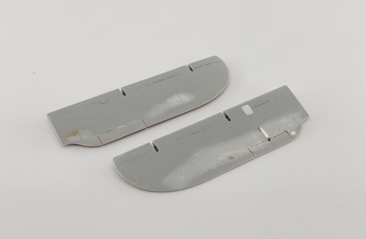

My next area of focus was the elevators and ailerons.  The kit elevators are not the correct shape on the inside where they face the sides of the fuselage.  If you go back to my post on September 25, you can see how I correct the fuselage area. To fix the elevators, I had to grind away material.  The image below shows the before and after result.
ADCreHeYuFpiW79M3M7llMSodQbsFIN40cLrFChw
I had to force the top and bottom halves together when gluing.  I was also left with an uneven surface, so I used some Apoxie sculpt sanded down to smooth it out.   This removed the kit ribbing, but it’s way too pronounced anyway.
ADCreHcceeEMEMUIgM3z9gjRyAvZxeQV32EoSzWZ
ADCreHeOOSvgKjQh0lwLqhfSjoU7aC5qEoq6QH2w
ADCreHfHwmZnTxAraaYbCUY-x8b1dEbCWOLZGckg

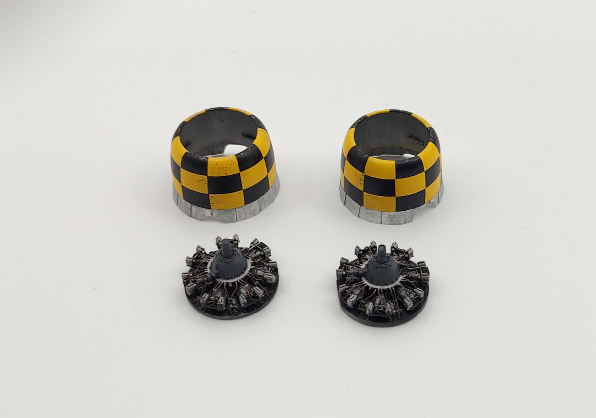

The checkerboard pattern on the cowlings were painted by first painting the entire cowling in yellow.  I then divided the cowl into three circumferential rings and masked off the middle one.  I divided the rings into evenly spaced blocks, using the tape to mask over the yellow blocks.  Then I painted the black blocks.  I removed all the tape and then masked off the inner and outer rings.  Again, I divided this ring into evenly spaced blocks and repeated the same process for the middle ring.  Below is the result.
ABLVV87dRtDYGPYDLtsNdFBFsIQ_sTBBj-Jyz94S
I think the cowl flaps on this particular bird were unpainted.  Since I scratchbuilt the partially opened flaps from an aluminum can, these didn’t need to be painted.  I just masked them off while I painted the cowls.  I still need to spray the inside of the cowls.

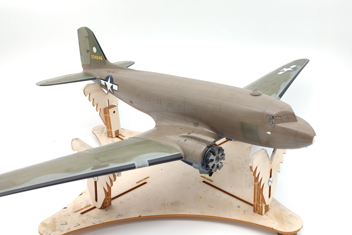

Hi everyone, one more update before I call this one finished.  Weathering is now complete.  I started by creating some chipping using Tamiya enamel silver X-11 applied with a sponge as well as a small brush.  I then followed up with an AMMO panel line wash, then sealed it with a coat of Mr Color GX113 clear flat.  With the previous steps sealed, I applied oil paints for general weathering.  Since I’m depicting a war-weary plane, I wasn’t afraid to go heavy with the weathering, following reference photos for guidance.  Many photos of planes with the larger carborator intakes show fluid leads around the shroud, so I replicated this with Abteilung 502 Starship Filth oil paint.  I also applied heavy weathering around the top of the wings around the fuel ports where the ground crew would regularly walk.  On the outer green sections of the wings, I applied some oil dot filters using olive green, yellow ochre, brown umber, and starship filth.  I faded the national insignias on the upper wing and fuselage sides with a light tan oil paint.
To replicate the round gun fixtures in the side windows, I used the Foxbot C-47 stencil decal set.  These are the only decals I used from this set, as my reference photos show few if any visible stencils on wartime planes.
As you can see, this model is too big for my photobooth!
