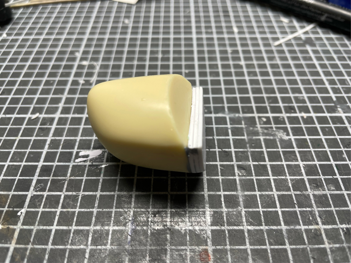

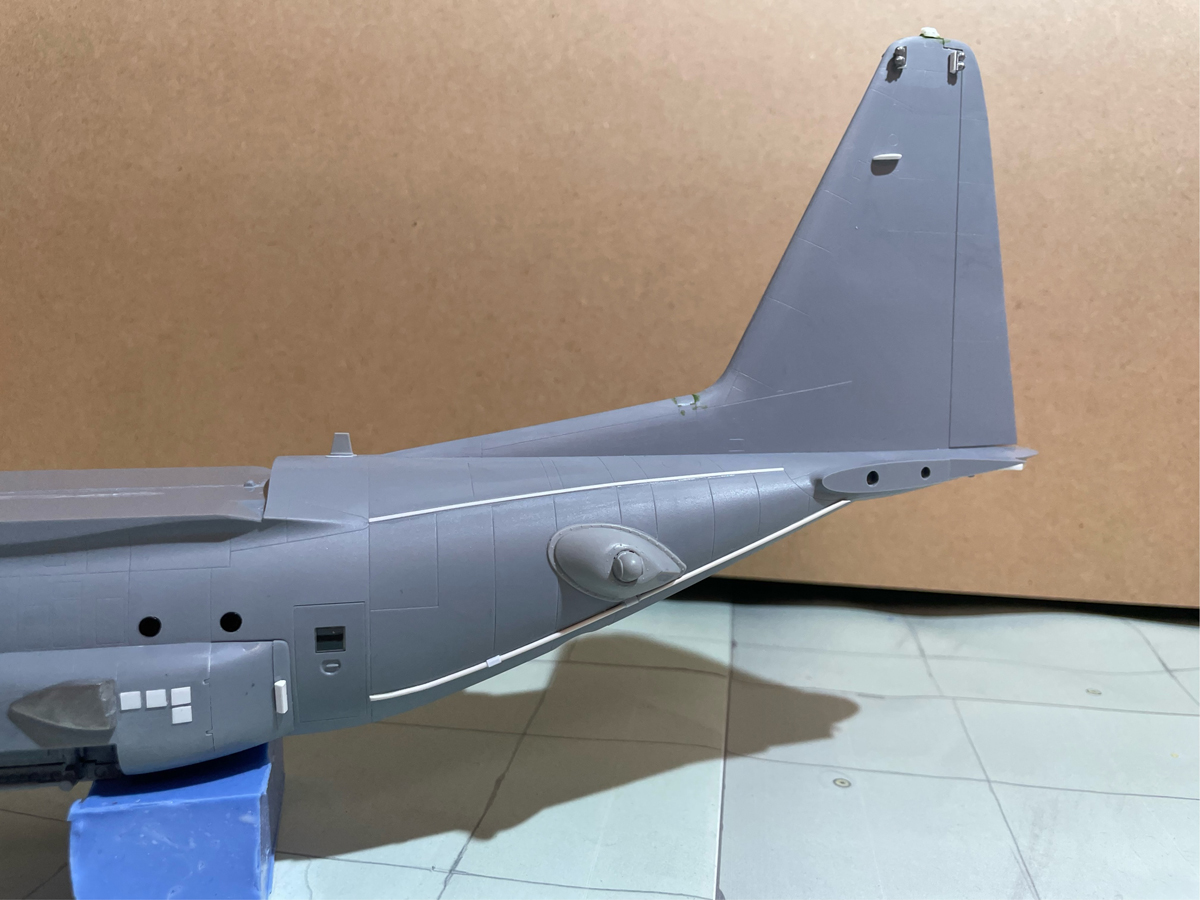

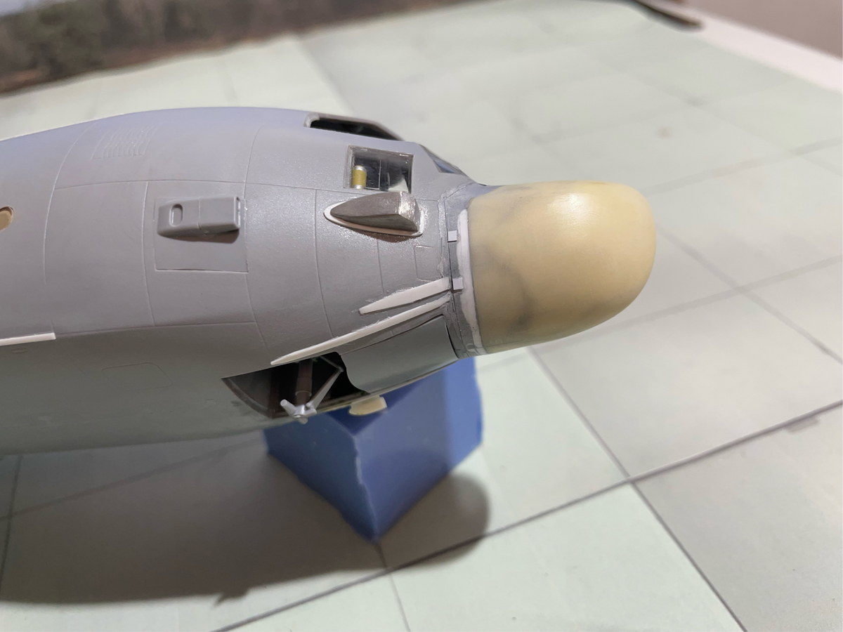

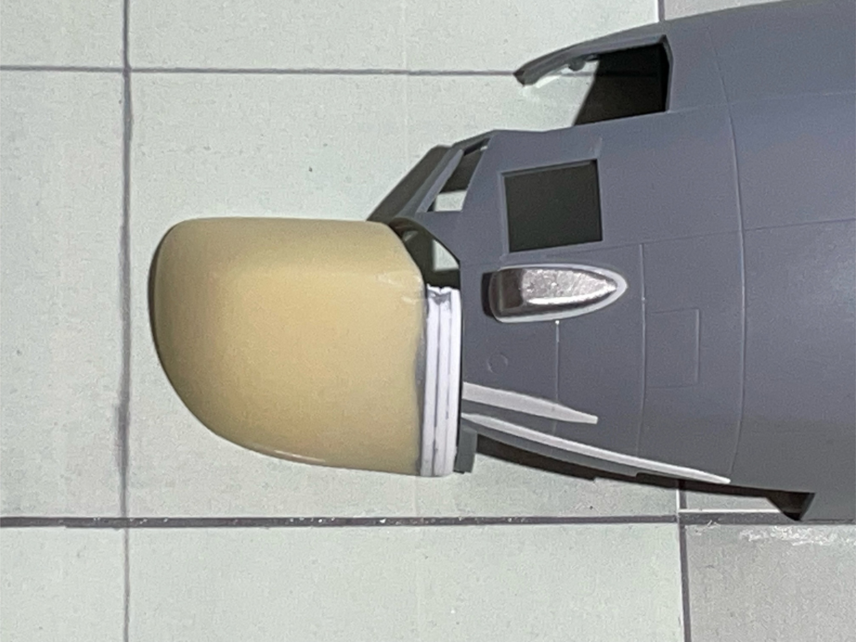

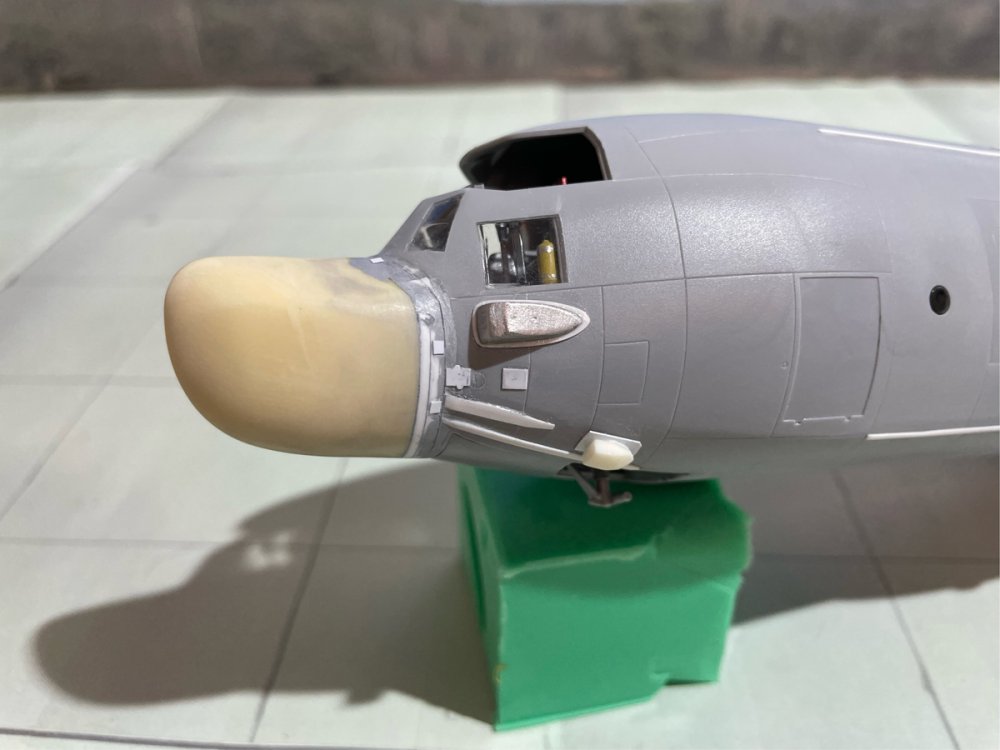

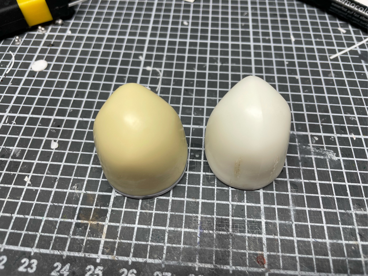

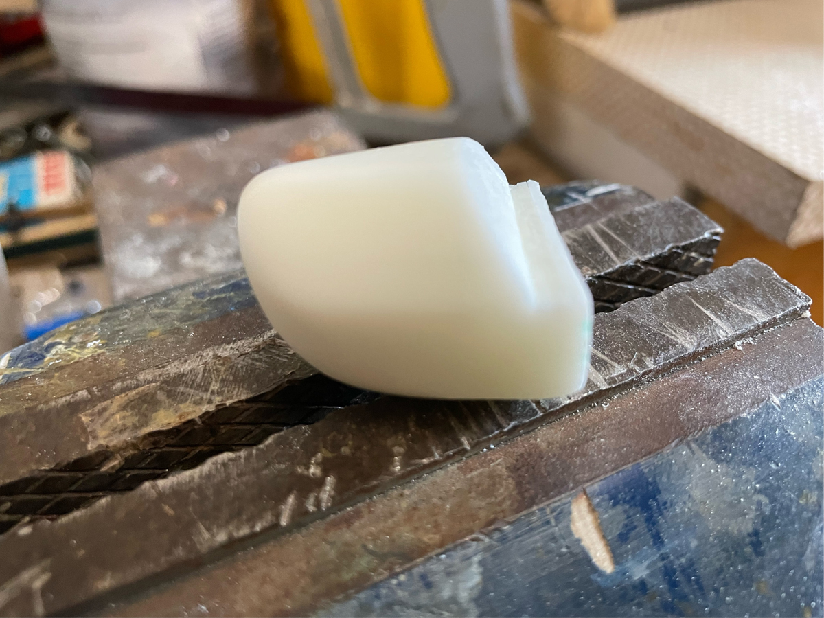

AWACS-RESIN Posted June 30, 2024 Share Posted June 30, 2024 (edited) This is the start of the build of a Lockheed MC-130H Combat Talon II. In addition to my own parts, I also use the Flightpath conversion kit for the Talon II. Flightpath states that the kit can be used for Italeri and Zevzda. However, the nose dome does not fit on the Zevzda fuselage. It is much too wide. What to do? The only option is to cut the nose in half and sand the two halves to size. When measuring, I discovered that the dome is 3 mm (.118 '') too short. This will now simply be extended. In case I mess up the dome when cutting it, I have made a mold. This way I can make a new dome. Edited June 30, 2024 by AWACS-RESIN Quote Link to post Share on other sites

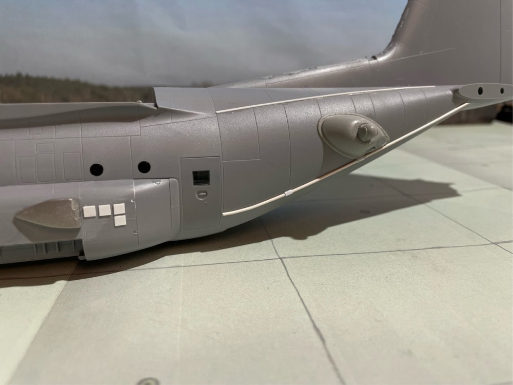

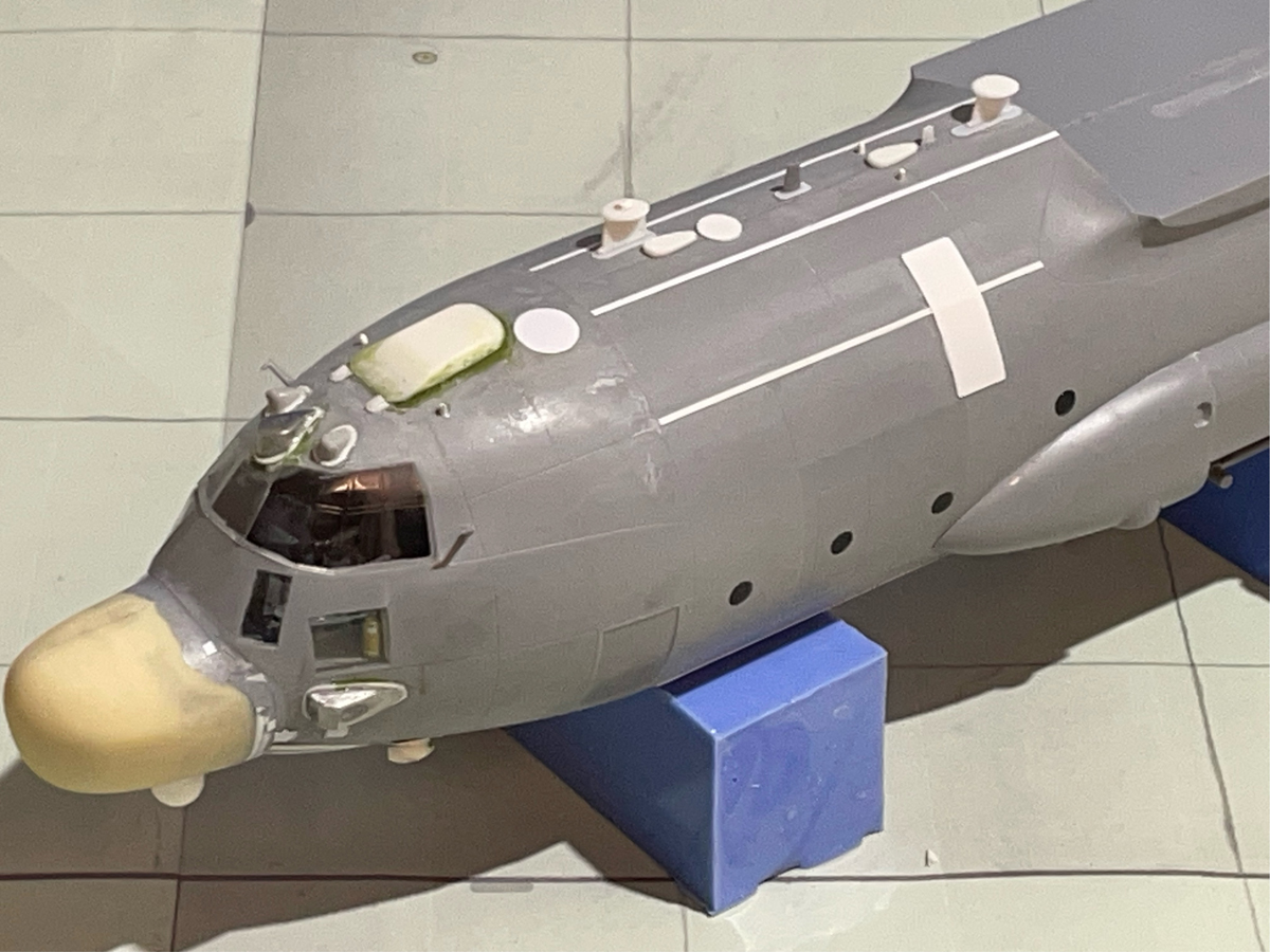

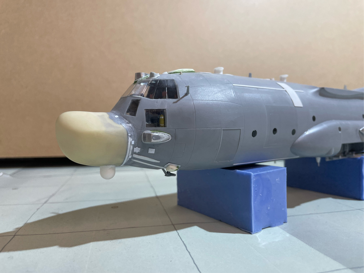

AWACS-RESIN Posted July 9, 2024 Author Share Posted July 9, 2024 Update on the MC-130H. Nose dome and some add ons fitted. Thanks for looking. Quote Link to post Share on other sites

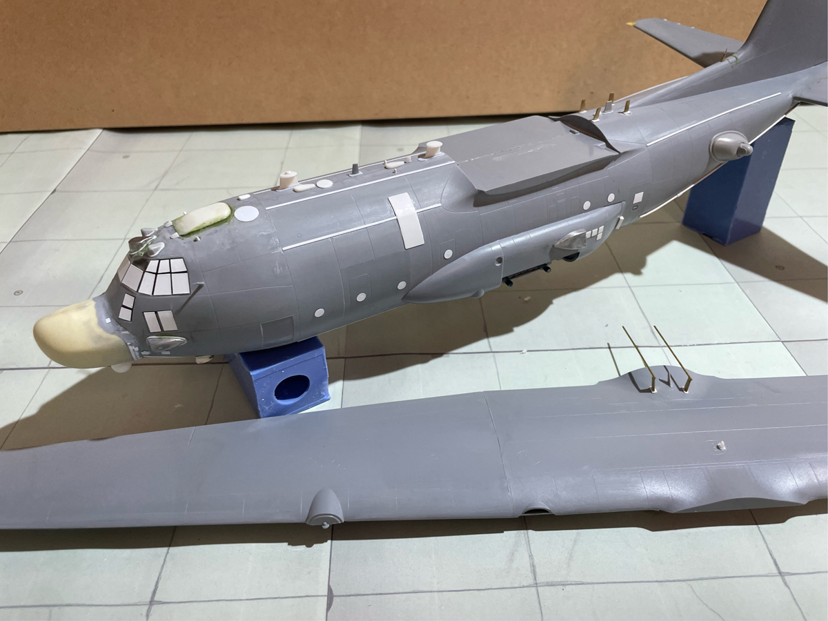

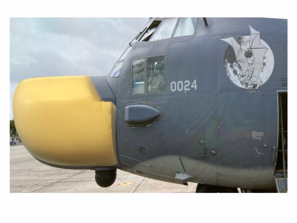

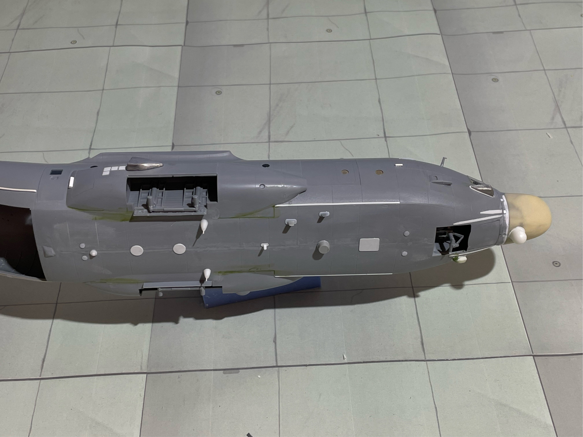

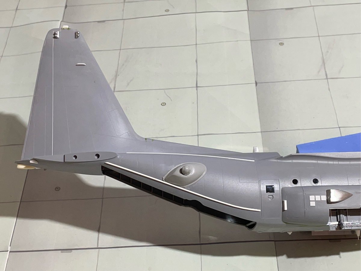

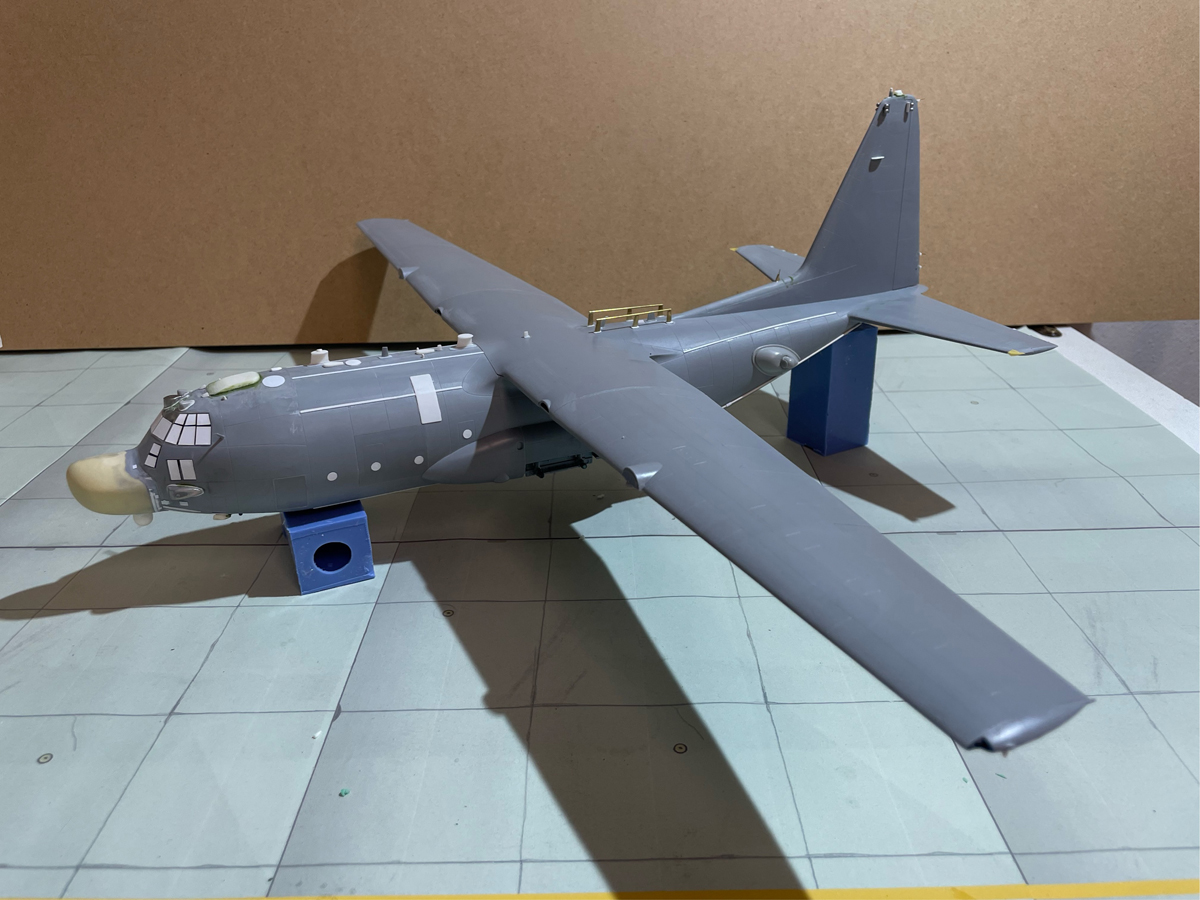

AWACS-RESIN Posted July 21, 2024 Author Share Posted July 21, 2024 The fuselage is almost done. Only a few antennas and a reinforcement plate left. The FLIR is a bit to big. I will see if I alter it. Thank you all for your comments. Quote Link to post Share on other sites
A-10 LOADER Posted July 21, 2024 Share Posted July 21, 2024 WOW, outstanding job on all the lumps, bumps and, antennas Jost. Some appear to be metal, are those lead castings ? Steve Quote Link to post Share on other sites
AWACS-RESIN Posted July 21, 2024 Author Share Posted July 21, 2024 57 minutes ago, A-10 LOADER said: WOW, outstanding job on all the lumps, bumps and, antennas Jost. Some appear to be metal, are those lead castings ? Steve Thanks Steve. Yes, there are a few metal parts out of the Flightpath conversion for the Talon II. I was not so happy with the quality of the kit and only used a few parts of it. I was thinking of making my own but was to lazy. Best Jost Quote Link to post Share on other sites

AWACS-RESIN Posted July 26, 2024 Author Share Posted July 26, 2024 5 hours ago, Norm DUbay said: Specifically the strengthening bands Hi, I used 0,25 mm (.010“) for the plates and side bands. For the fwd upper fuselage 0,16mm (.0065“) Sanded all a bit with 400 and 800 grid especially the edges. Cheers Quote Link to post Share on other sites

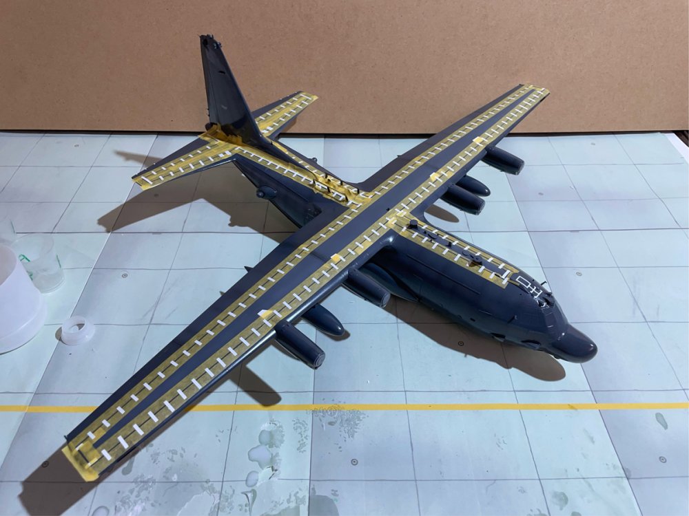

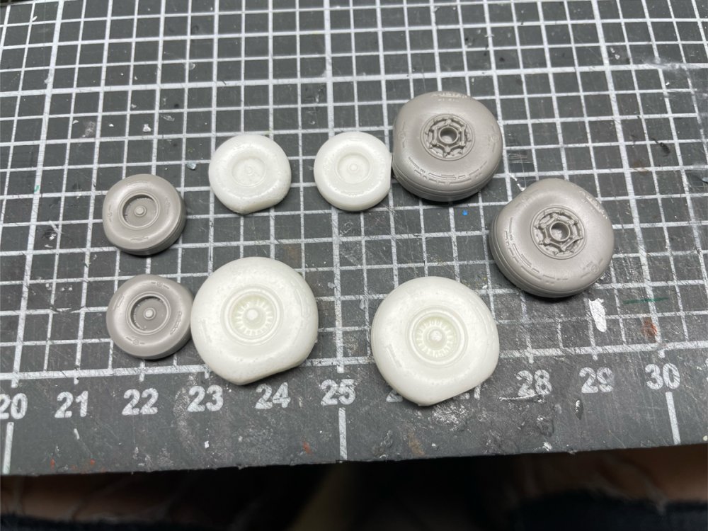

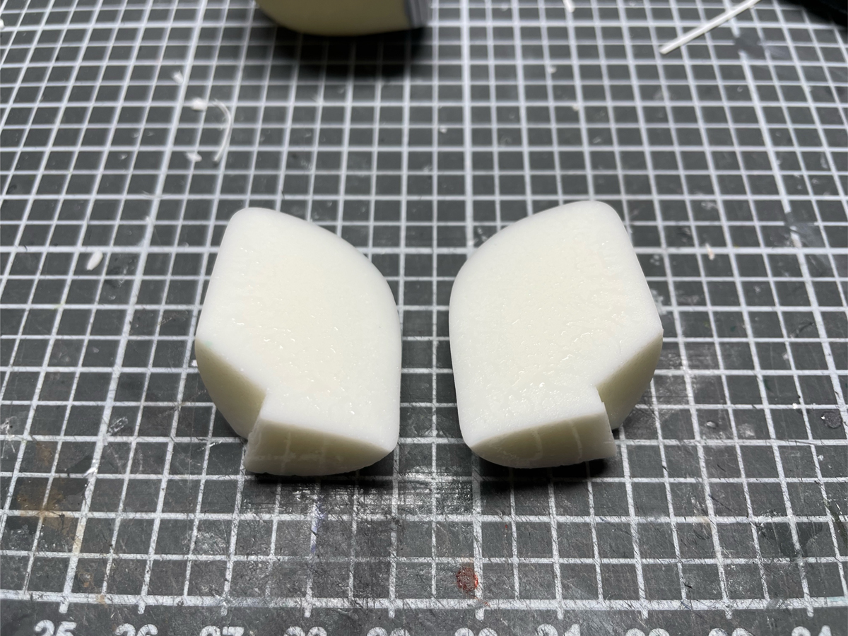

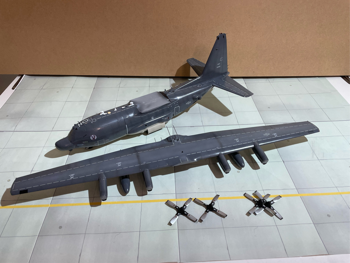

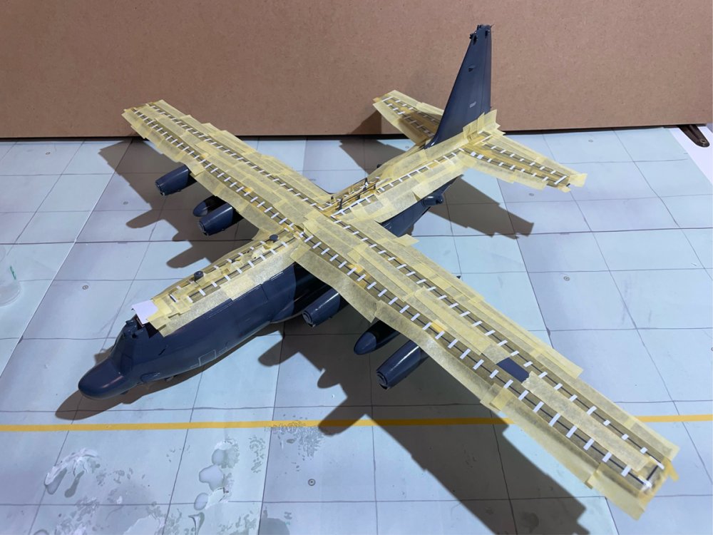

AWACS-RESIN Posted September 22, 2024 Author Share Posted September 22, 2024 Here too, work will continue after the summer break. Since I want to build a few more Hercs, I bought a set of Eduard wheels and cast them. That saves some time. The model was prepared for the paint application and then sprayed. I masked off the walkways and then sprayed them on, because the ones from the Italeri kit are not the size of the Talon II. Most of the decals are self-made, some are from the Italeri kit of the MC-130E Talon I. Quote Link to post Share on other sites
