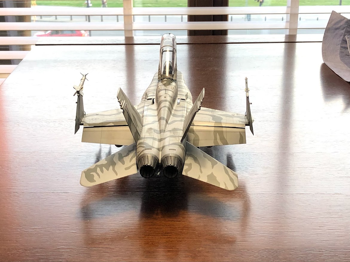

Thadeus Posted July 23, 2024 Share Posted July 23, 2024 16 hours ago, f5guy said: I had two sets of the Aires exhaust cans and neither fit. To be sure that it wasn't just me, I tried them on a second kit, and had the same issue. I'm glad that they worked for you. Your Hornet looks great! Love the tiger scheme 👍 Fred. Thanks! I must have been lucky then. I've had a few Aires sets that felt a little underscale but I always thought they were kind of made this way. Quote Link to post Share on other sites

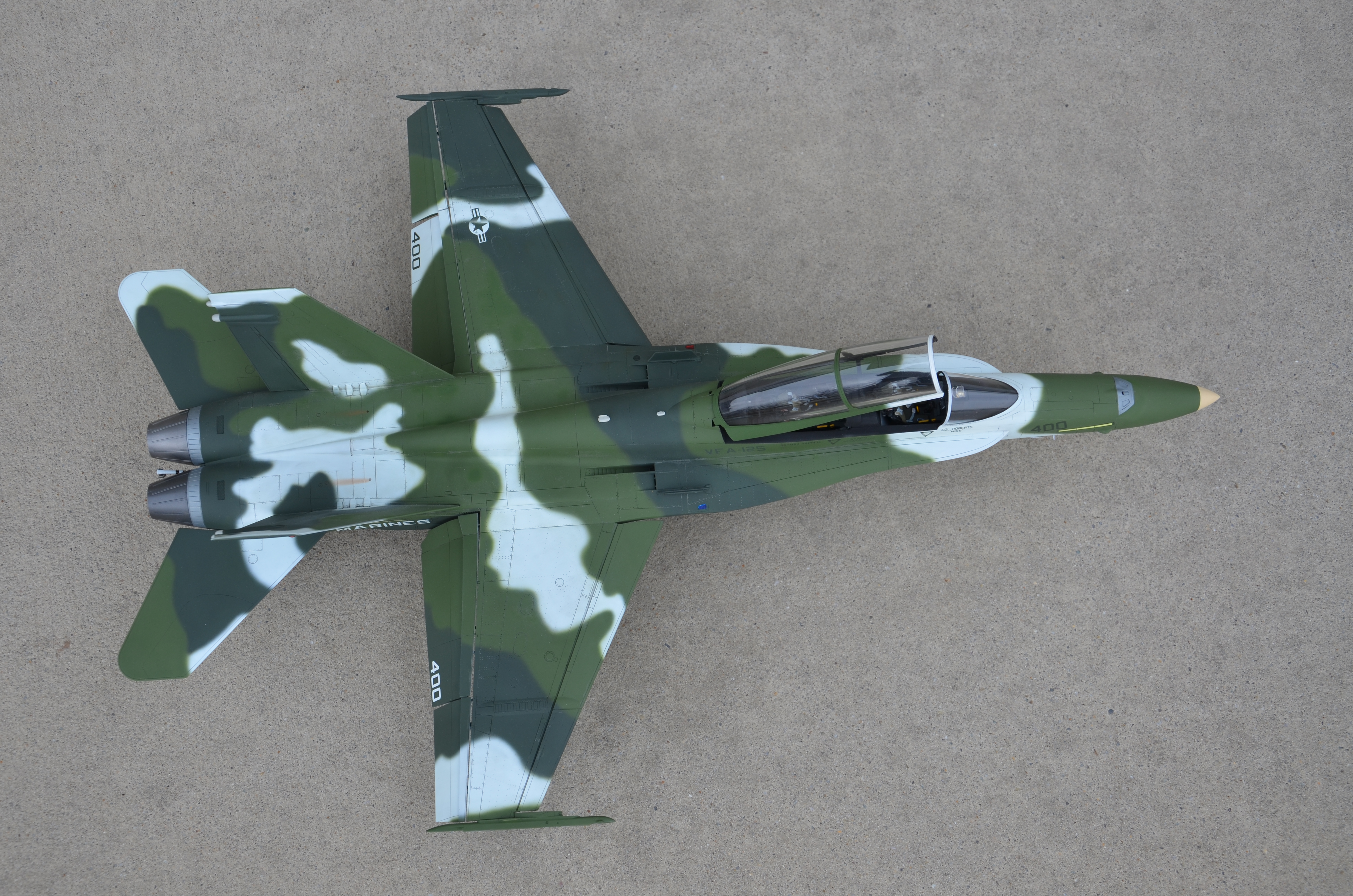

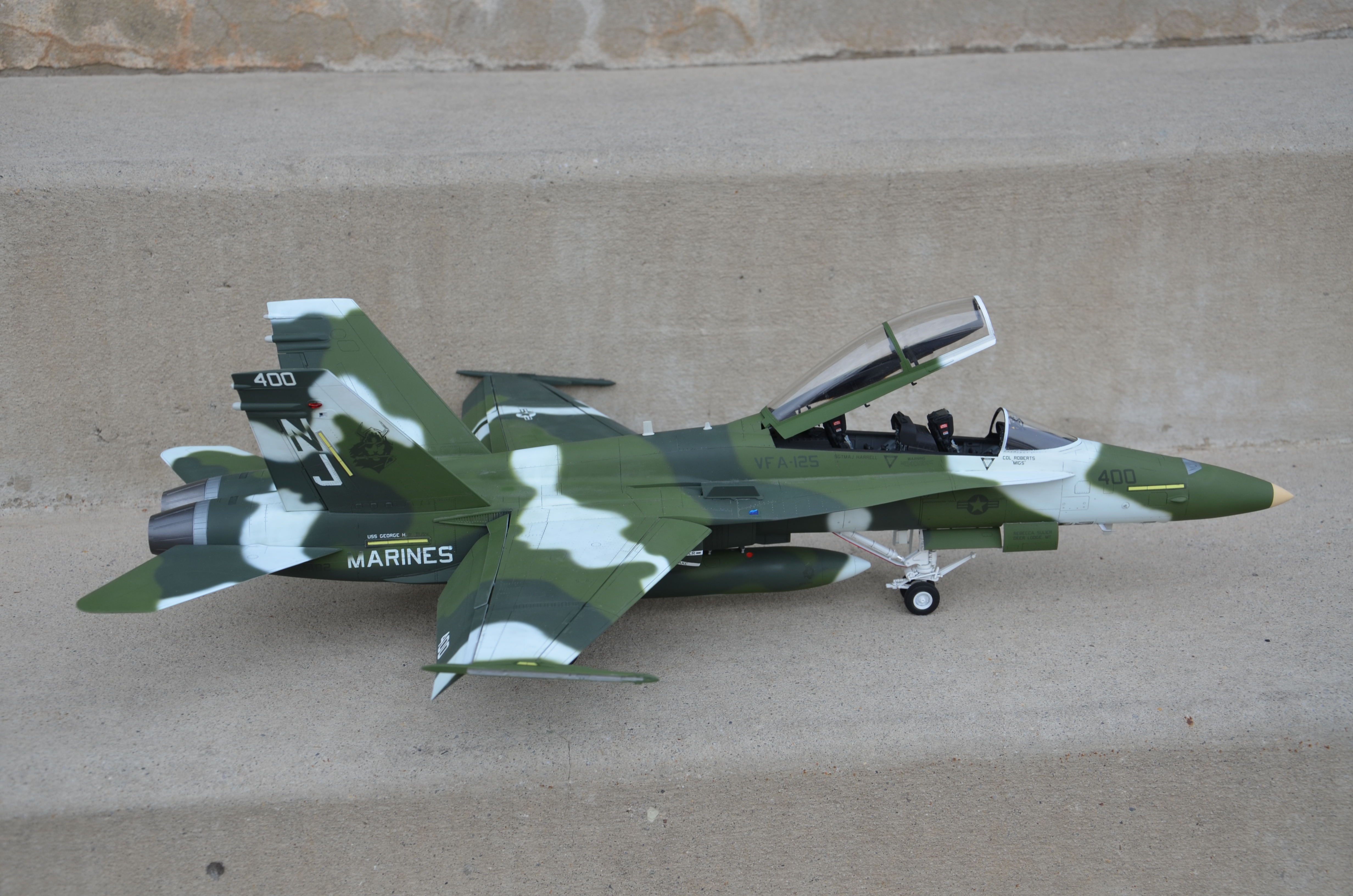

kg4kpg Posted July 23, 2024 Author Share Posted July 23, 2024 Great builds f5guy and Thadeus, two great schemes. I haven’t decided if I want to do a scheme from the kit or an aftermarket set. I did this one in 1/72 and was thinking of doing it again on this build. Quote Link to post Share on other sites
f5guy Posted July 23, 2024 Share Posted July 23, 2024 2 hours ago, kg4kpg said: Great builds f5guy and Thadeus, two great schemes. I haven’t decided if I want to do a scheme from the kit or an aftermarket set. I did this one in 1/72 and was thinking of doing it again on this build. Looks great! I did this jet in 72nd scale using the Academy kit, and some Wolfpack resin wings with the drooped flaps. Unfortunately, I really goofed the wings up, so I'll probably redo it at some point. It should look awesome in 32nd scale if you can find the kit. Just FYI, if you can't find the Academy D version in 32nd scale, the Kinetic kit in the pic attached is the Academy kit with all of the parts necessary to build an A/B/C or D. During my build of the green Hornet I dropped the canopy and put a nice big crack in it. I contacted Academy for a replacement, but after a year and a half of phone calls, emails and waiting, no joy. A fellow ARC'er clued me in to the Kinetic kit, so I picked one up and used the two seat canopy from it. Eventually I'll just build as an A or C. HTH, Fred. Quote Link to post Share on other sites
Thadeus Posted July 23, 2024 Share Posted July 23, 2024 5 hours ago, kg4kpg said: Great builds f5guy and Thadeus, two great schemes. I haven’t decided if I want to do a scheme from the kit or an aftermarket set. I did this one in 1/72 and was thinking of doing it again on this build. Lovelly Hornet. Academy kit in 1/72 is quite nice kit too 😉 3 hours ago, f5guy said: Looks great! I did this jet in 72nd scale using the Academy kit, and some Wolfpack resin wings with the drooped flaps. Unfortunately, I really goofed the wings up, so I'll probably redo it at some point. It should look awesome in 32nd scale if you can find the kit. Just FYI, if you can't find the Academy D version in 32nd scale, the Kinetic kit in the pic attached is the Academy kit with all of the parts necessary to build an A/B/C or D. During my build of the green Hornet I dropped the canopy and put a nice big crack in it. I contacted Academy for a replacement, but after a year and a half of phone calls, emails and waiting, no joy. A fellow ARC'er clued me in to the Kinetic kit, so I picked one up and used the two seat canopy from it. Eventually I'll just build as an A or C. HTH, Fred. And IIRC it has the SAC gear as well. Pretty cool. They seem to be sold out though. Quote Link to post Share on other sites

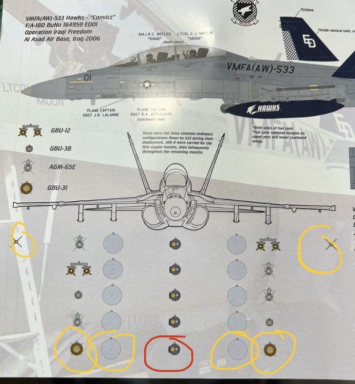

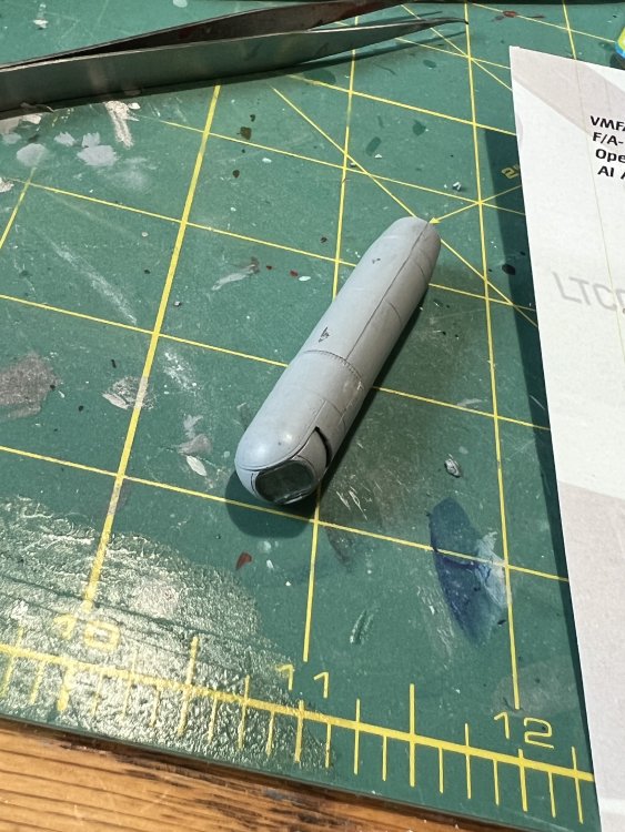

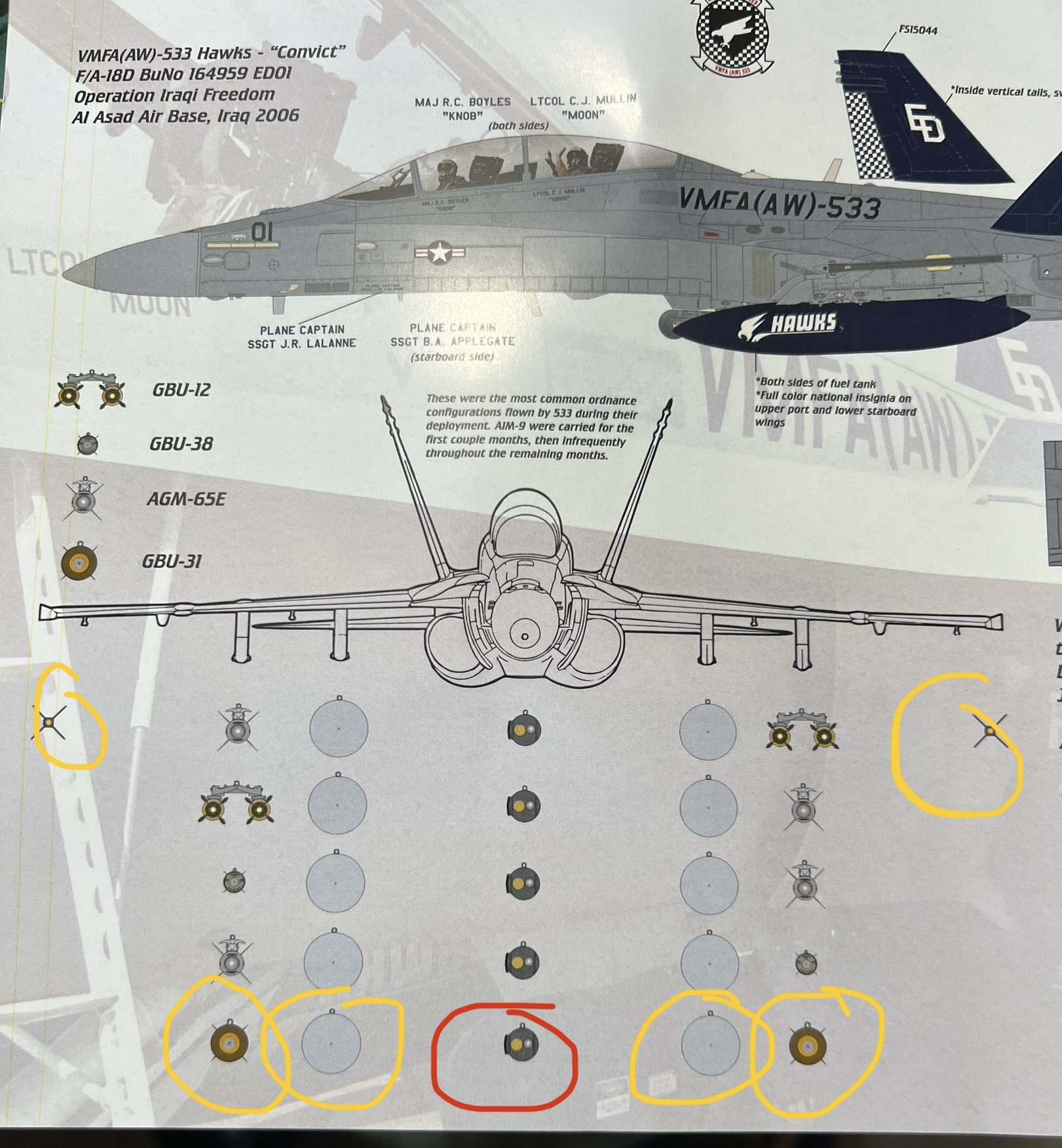

kg4kpg Posted August 23, 2024 Author Share Posted August 23, 2024 I’m getting close to wrapping this build up and have a question. I’m going to build mine with GBU-31’s. The decals instructions say it would be common for this plane to also carry an AN/AAQ-28. The kit includes an AN/AAS-38. would anyone have a -28 to trade for -38? I have assembled it, just need to finish a little painting. Quote Link to post Share on other sites
Thadeus Posted September 3, 2024 Share Posted September 3, 2024 (edited) I had the same problem when I built mine. And lack of GBU-12's in Academy kit. I didn't manage to solve my problem, but I got hold of an Academy F-16I that I robbed of this pod. Nowadays there is a nice Eduard resin set: https://www.mojehobby.pl/products/AN-AAQ-28-V-Litening-pod-23755893.html I know that's not what You asked for, but it's the second best thing. Edited September 3, 2024 by Thadeus Quote Link to post Share on other sites

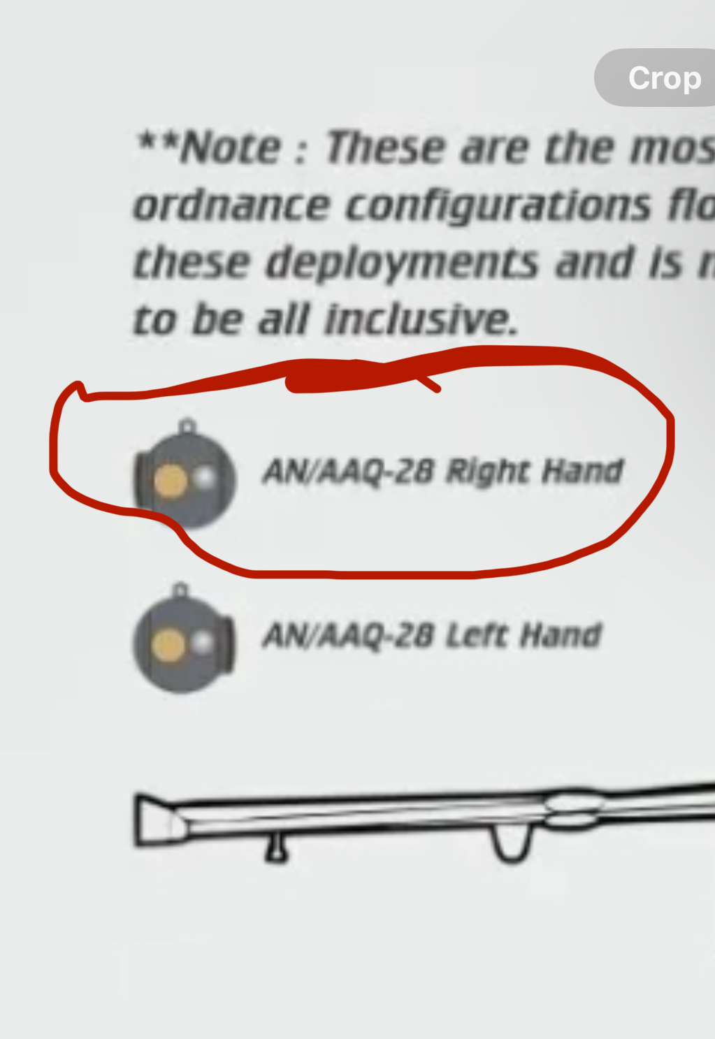

kg4kpg Posted September 4, 2024 Author Share Posted September 4, 2024 5 hours ago, strikeeagle801 said: Dave Roof has some excellent update sets for the Academy Hornets in his Flying Leathernecks line, including wheels, pylons, HUD and a LIGHTNING pod, both deployed and stowed. I would highly recommend them. Aaron Thanks Aaron. I saw a post Dave had on Facebook showing the new product so commented on it to look into it. The current release is a left hand version and I need the right hand version. He replied saying should be available in September, which is fine. It will just be the last item attached to the build. *break* Thanks for the info Thadeus, looks nice too. Chris Quote Link to post Share on other sites
strikeeagle801 Posted September 4, 2024 Share Posted September 4, 2024 2 hours ago, kg4kpg said: Thanks Aaron. I saw a post Dave had on Facebook showing the new product so commented on it to look into it. The current release is a left hand version and I need the right hand version. He replied saying should be available in September, which is fine. It will just be the last item attached to the build. *break* Thanks for the info Thadeus, looks nice too. Chris Got it. Eduard has one in their Brassin line as well. I think it is the right-handed version and is deployed. Aaron Quote Link to post Share on other sites

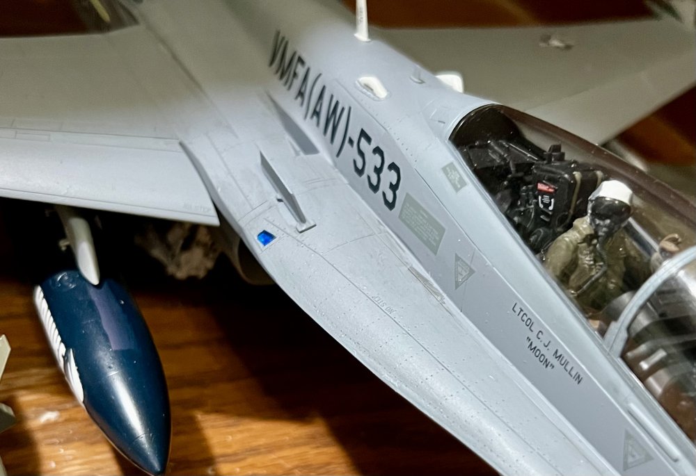

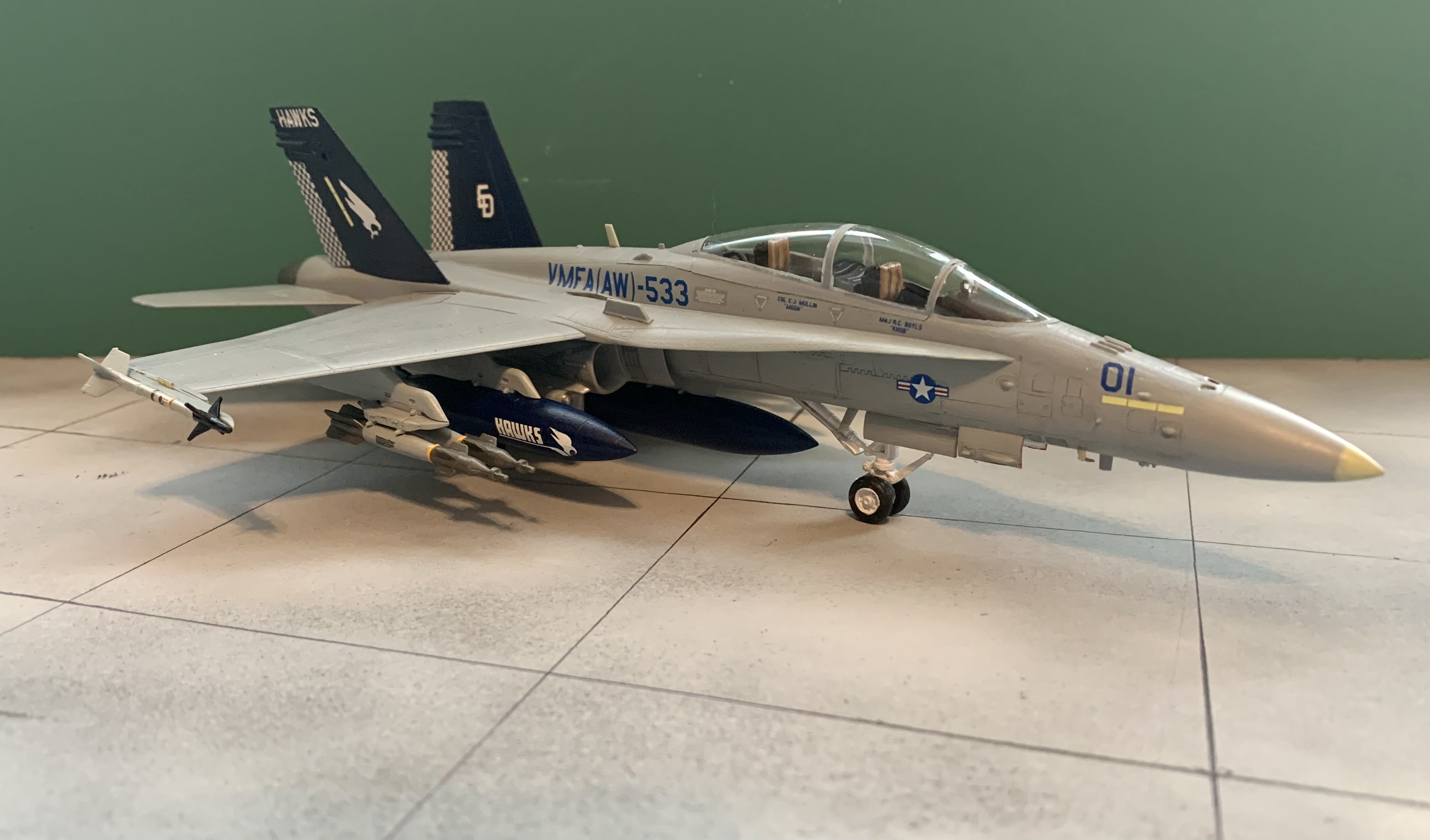

kg4kpg Posted September 14, 2024 Author Share Posted September 14, 2024 Mission complete. Just a taste. I have to figure out a good way to photograph it, being so big, yet incorporate a good backdrop, and hide any faults. 😬 Quote Link to post Share on other sites
RexKramer707 Posted September 16, 2024 Share Posted September 16, 2024 I am certainly not nitpicking, but shouldn't their helmets be camouflage? Or have camo covers. Regardless, I have woodland camo patern decal i could cut off some and mail it to you Quote Link to post Share on other sites
kg4kpg Posted September 16, 2024 Author Share Posted September 16, 2024 (edited) The instructions said white, so I googled it and although there were no clear pics, you could see that they had on white helmets. I’ll see if I can find it again. **still have them. Edited September 16, 2024 by kg4kpg Quote Link to post Share on other sites
habu2 Posted September 17, 2024 Share Posted September 17, 2024 I always assumed camo helmets were for in-theater only. Quote Link to post Share on other sites
kg4kpg Posted September 17, 2024 Author Share Posted September 17, 2024 12 hours ago, habu2 said: I always assumed camo helmets were for in-theater only. In retrospect, this is a Desert Storm scheme, so I suppose I could have went with a camo helmet, but that canopy was a tough fit, they’re going to have to stay as is. 😬 Quote Link to post Share on other sites
usmcski6502 Posted September 18, 2024 Share Posted September 18, 2024 (edited) 19 hours ago, kg4kpg said: In retrospect, this is a Desert Storm scheme, so I suppose I could have went with a camo helmet, but that canopy was a tough fit, they’re going to have to stay as is. 😬 Not necessarily. For the most part, USMC aircrew do use camo helmet covers, although there are exceptions. While assigned to training commands, “boat squadrons”, or new helmet systems (JHMCS, TOP OWL, et al), USMC squadrons will not use helmet covers over their taped helmets. Even while deployed, camo helmet covers are used over reflective taped helmets, affixed via Velcro so that they can be quickly removed in an emergency situation (when I flew on UH-1s on the MEU, we still used our helmet covers over our reflective taped helmets). It’s highly unusual to see operational deployed land-based USMC squadrons NOT using helmet covers, although there are, of course, exceptions. For a VMFA(AW)-121 scheme, especially in the later stages of ODS, helmet covers would be appropriate, but I would never say never… Hope this helps! Ski Edited September 18, 2024 by usmcski6502 Quote Link to post Share on other sites
