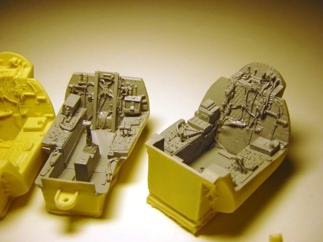

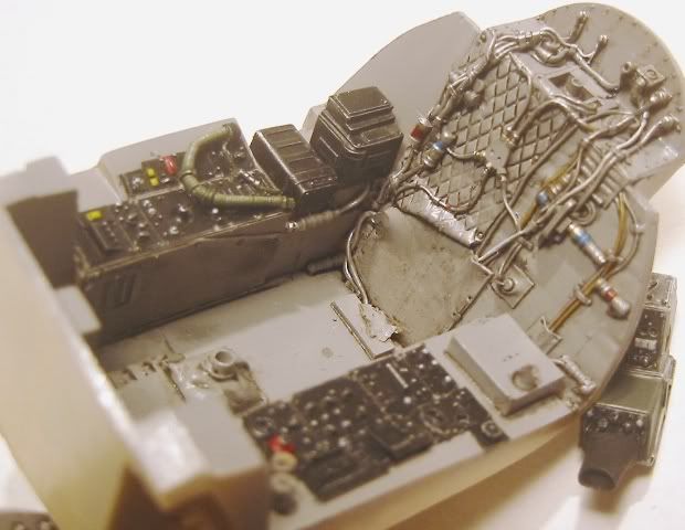

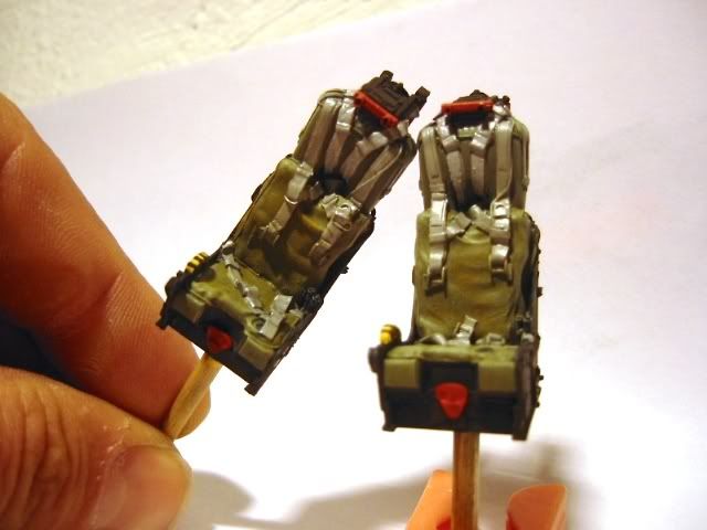

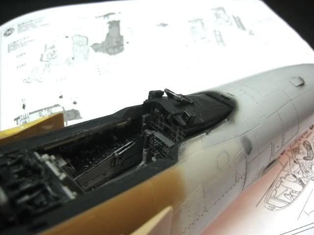

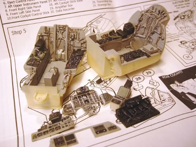

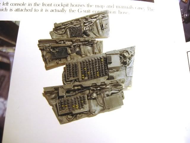

starflyer Posted February 4, 2008 Share Posted February 4, 2008 Hi everybody, I like introduce you my actual project, showing step by step (as possible) the work in progress. I will put more or less 6 photos per step to show the progress.....actually I am doing the painting step, but I will post all the steps until now....just give me time to upload the photos. I hope we can share wath I am doing and please tell me suggestion, dubts, opinion ect..ect.. I hope to learn more from each of you and improve my results in the future models. Cockpit is Black Box resin set, just painted and adjust to fit in the fusolage...... Bye Quote Link to post Share on other sites

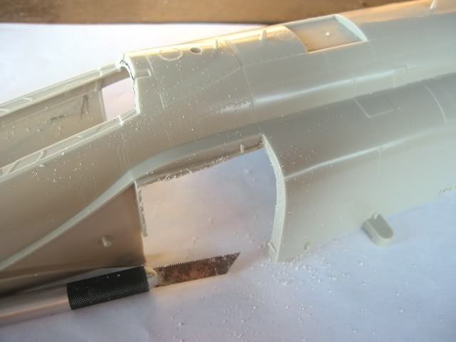

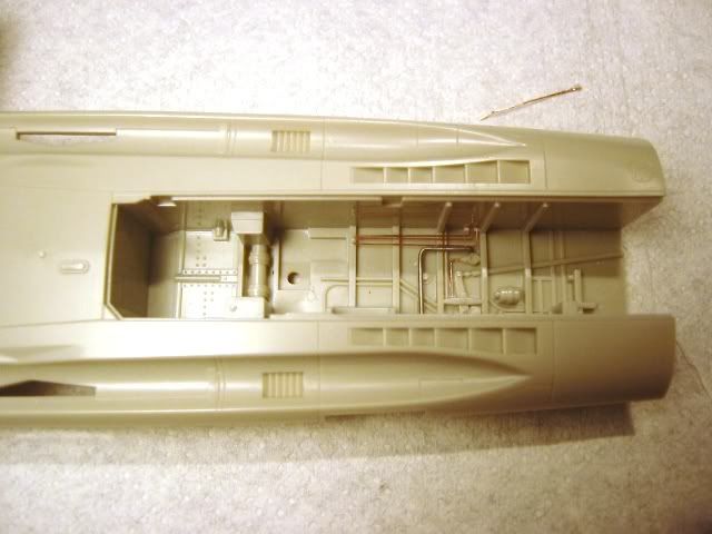

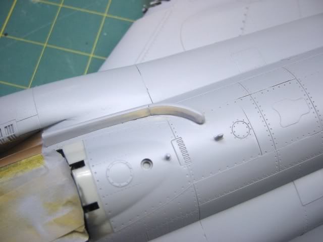

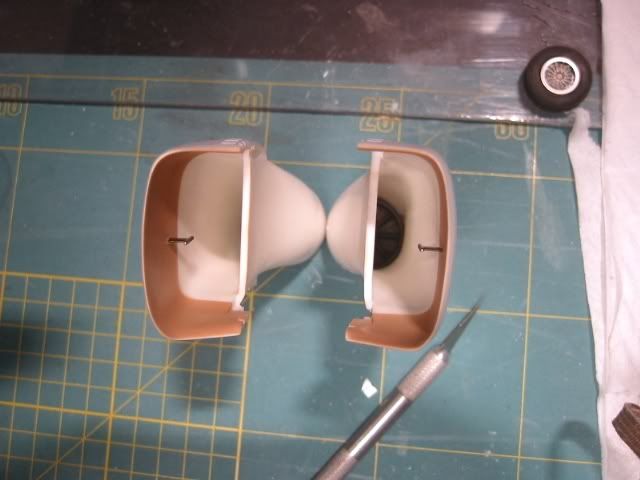

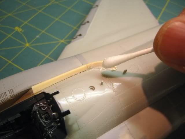

starflyer Posted February 4, 2008 Author Share Posted February 4, 2008 Step 02 Seamless Sucker air intake The air intake from Seameless Sucker painted and fittet to the fusolage.... Quote Link to post Share on other sites

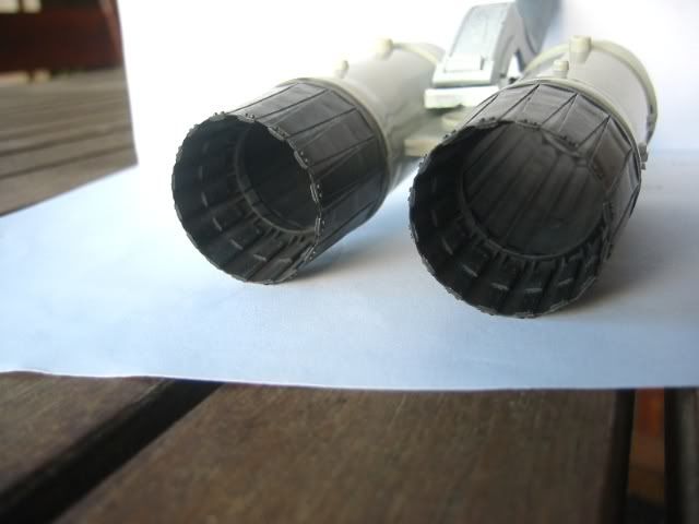

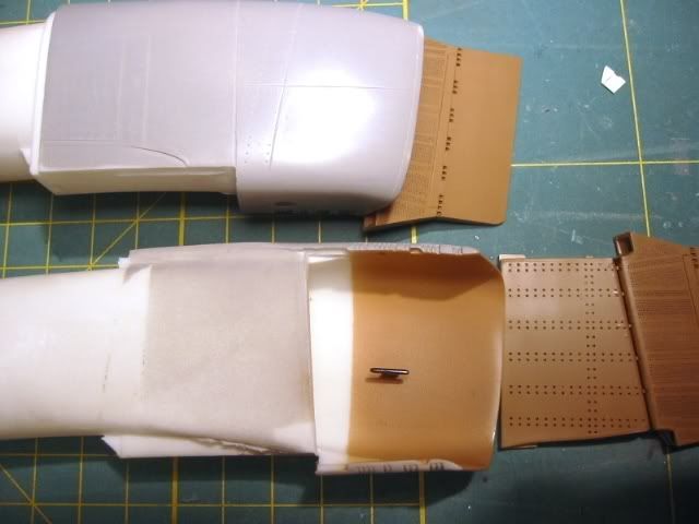

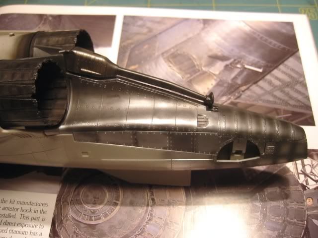

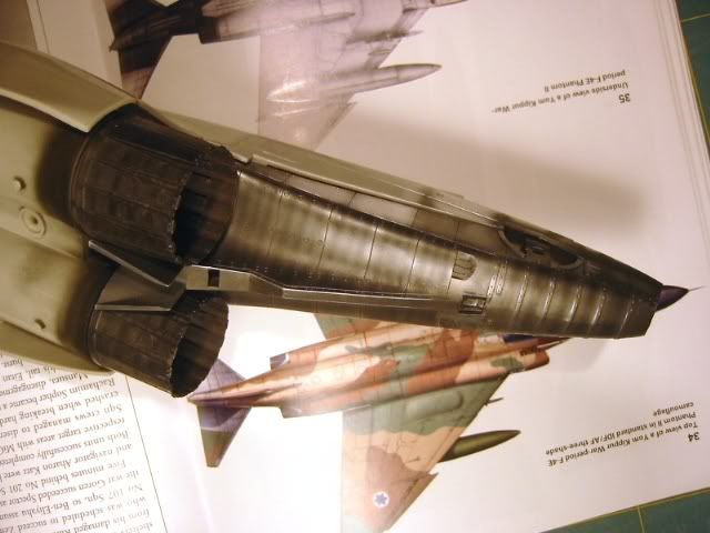

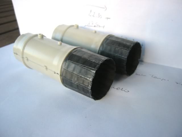

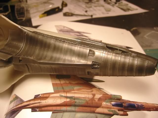

starflyer Posted February 4, 2008 Author Share Posted February 4, 2008 Step 03 exhaust area...... exhaust nozzle from Cutting Edge, good quality, just painted and fitted...... Quote Link to post Share on other sites

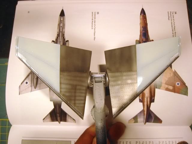

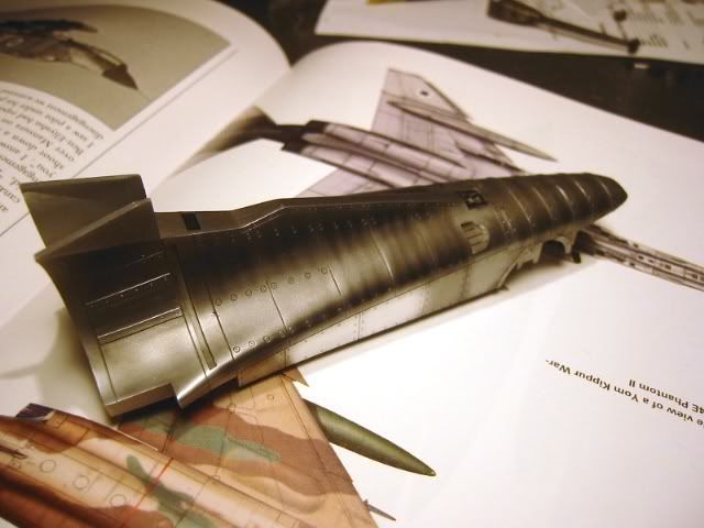

starflyer Posted February 4, 2008 Author Share Posted February 4, 2008 (edited) Step 04 Horizontal stabilizers Testor metalizer & AlcladII painted.....camoufage with XtraColor Edited February 24, 2008 by starflyer Quote Link to post Share on other sites

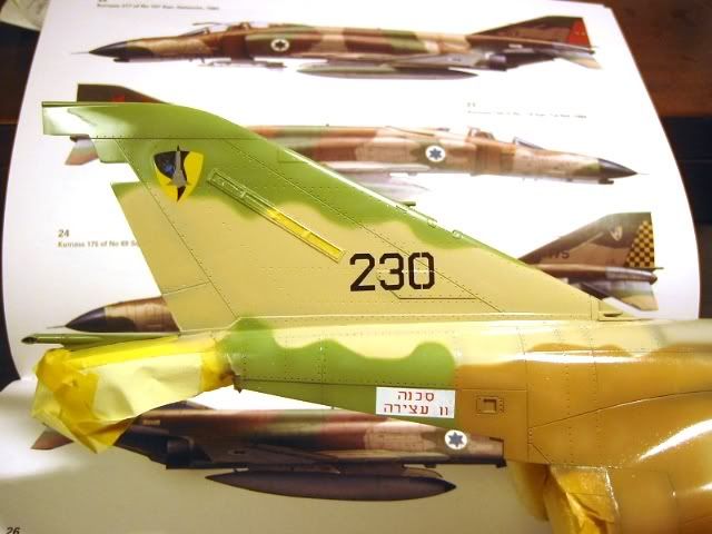

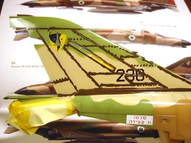

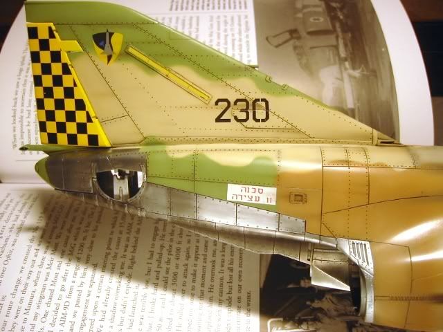

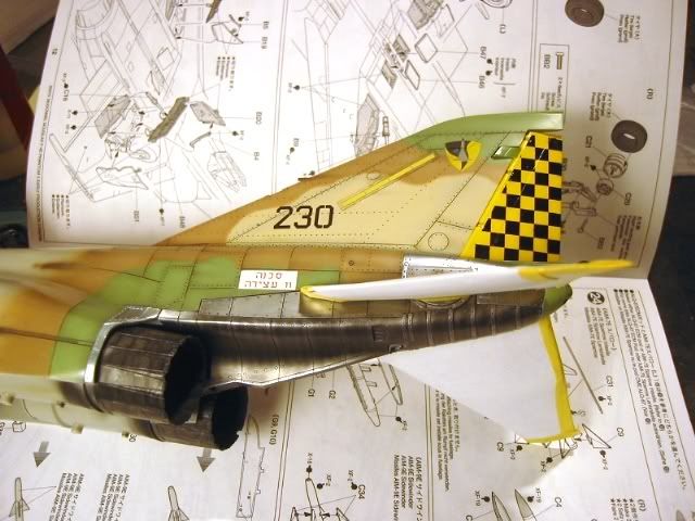

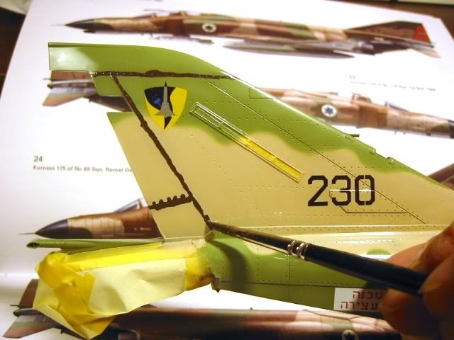

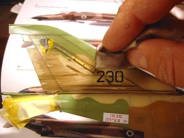

starflyer Posted February 4, 2008 Author Share Posted February 4, 2008 (edited) Step 05 Tail painting XtraColor for the camufage scheme, oil wathering and decaling.... Edited February 4, 2008 by starflyer Quote Link to post Share on other sites

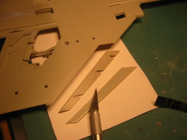

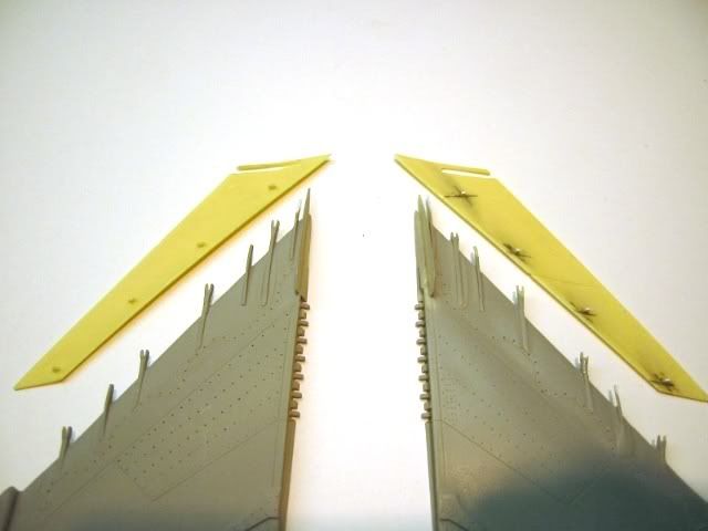

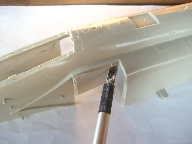

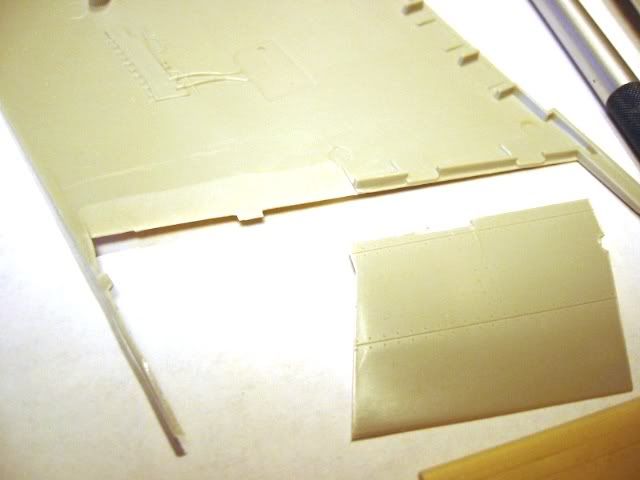

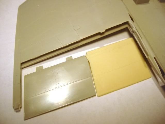

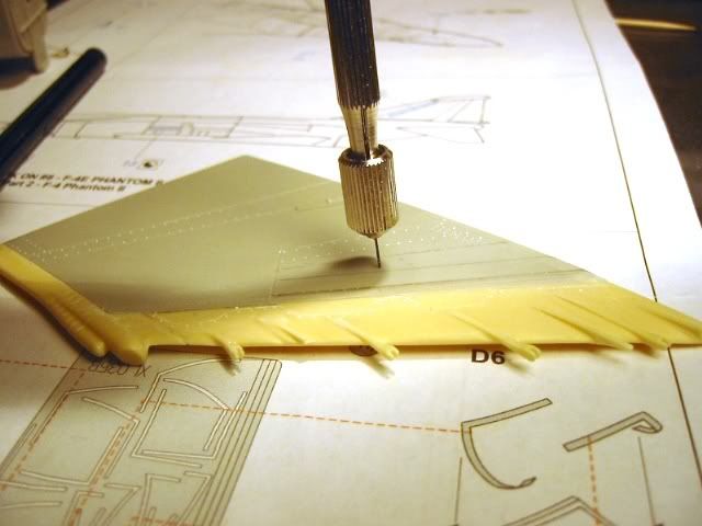

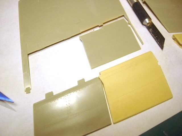

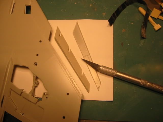

starflyer Posted February 4, 2008 Author Share Posted February 4, 2008 Step 06 Slats/Flaps Slats/ Flaps cutting and fitting...... Quote Link to post Share on other sites

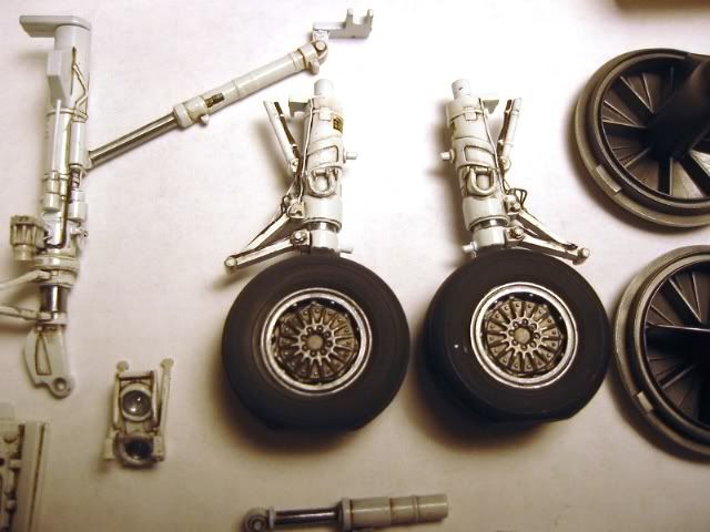

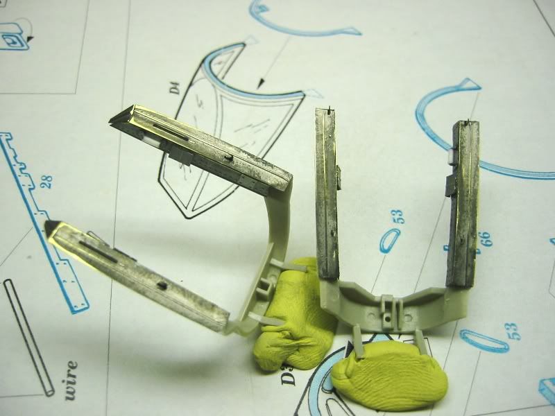

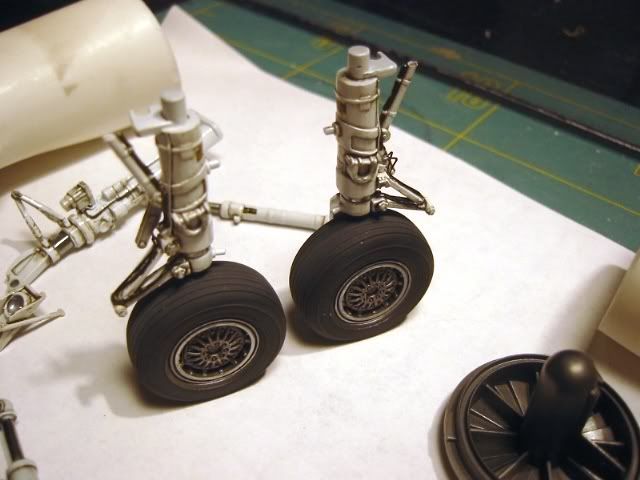

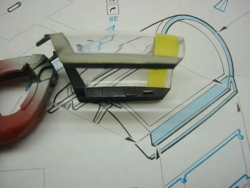

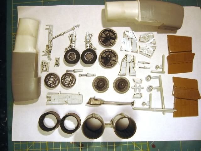

starflyer Posted February 4, 2008 Author Share Posted February 4, 2008 Step 07 Miscellaneous.... Undercarriage, small parts, etcc..etc.... Quote Link to post Share on other sites

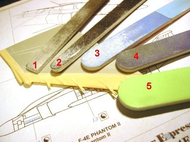

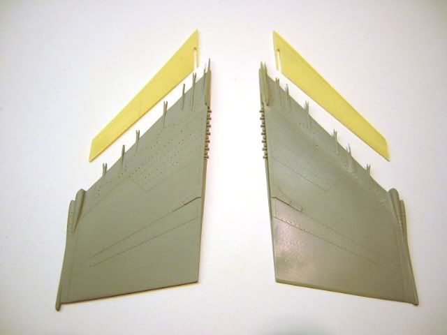

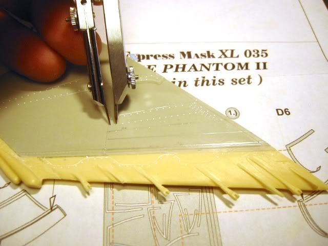

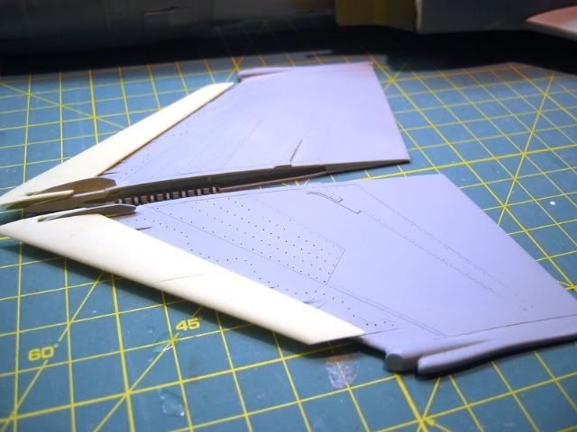

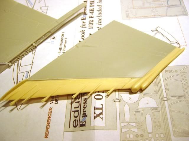

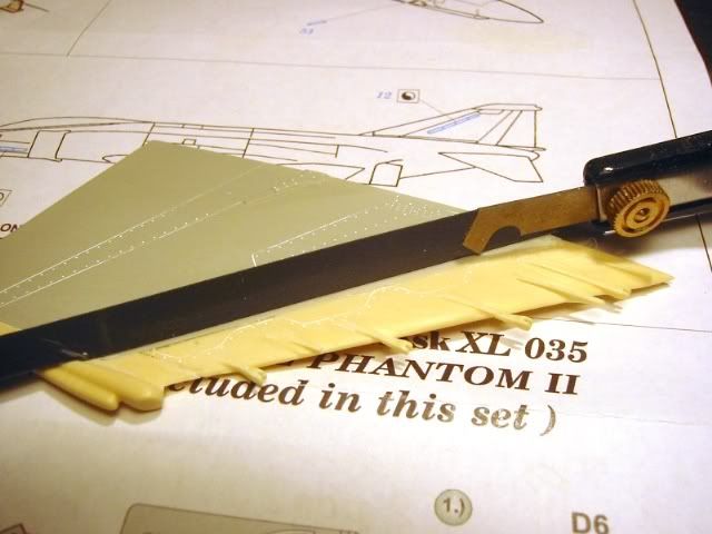

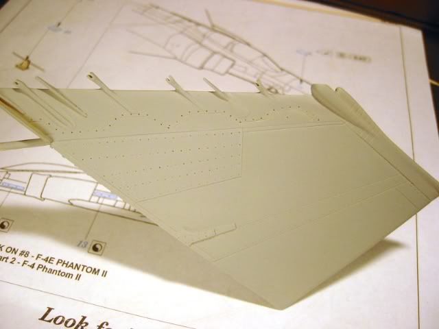

starflyer Posted February 4, 2008 Author Share Posted February 4, 2008 Step 08 External wings and slats Very hard job to fit the slats resin set...... Quote Link to post Share on other sites

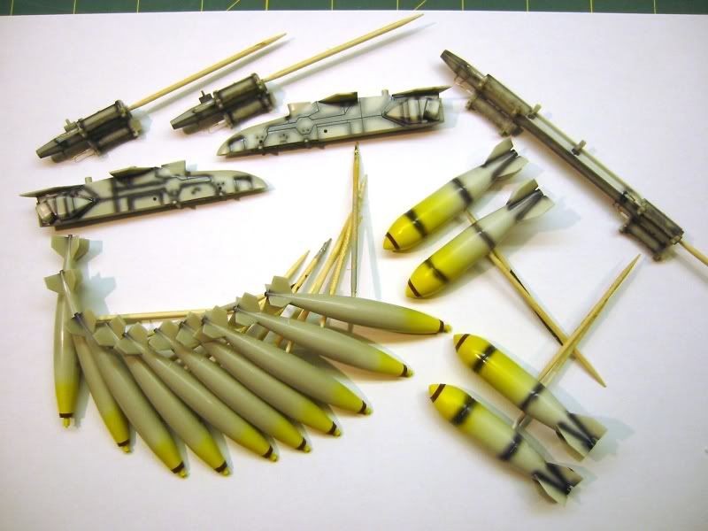

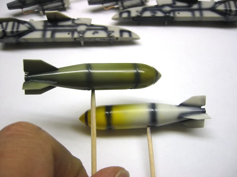

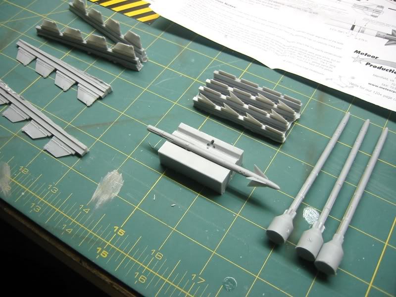

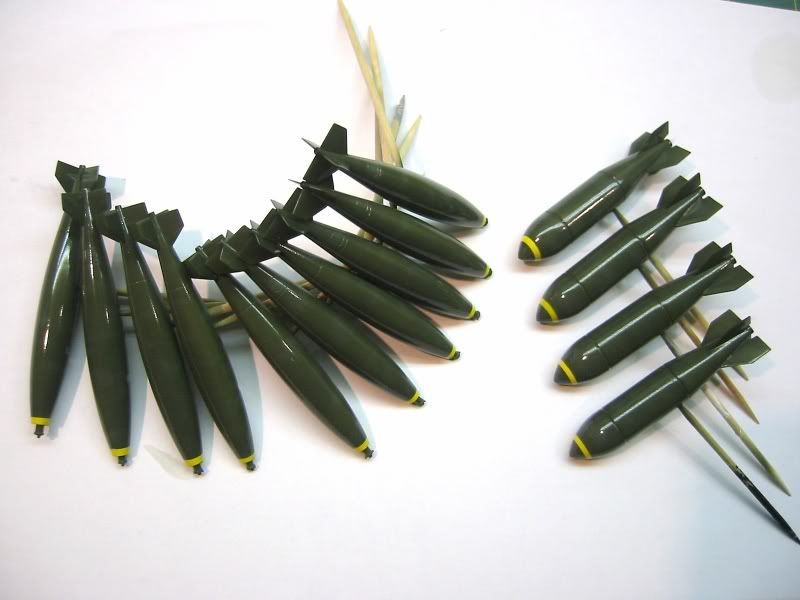

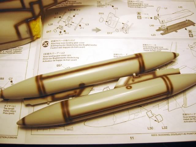

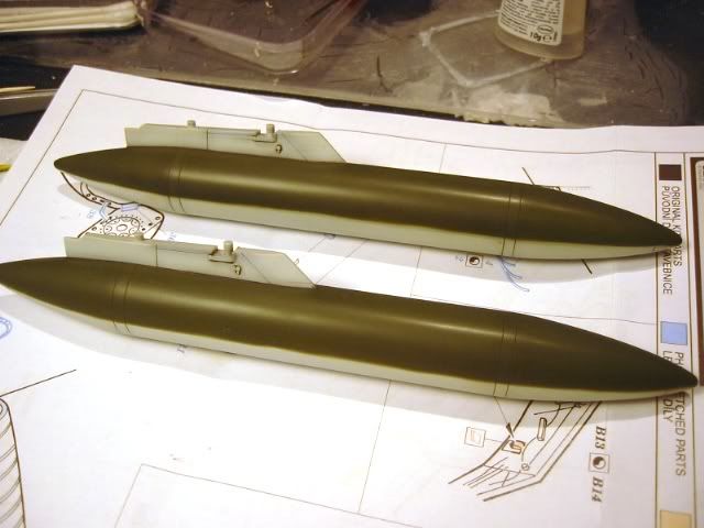

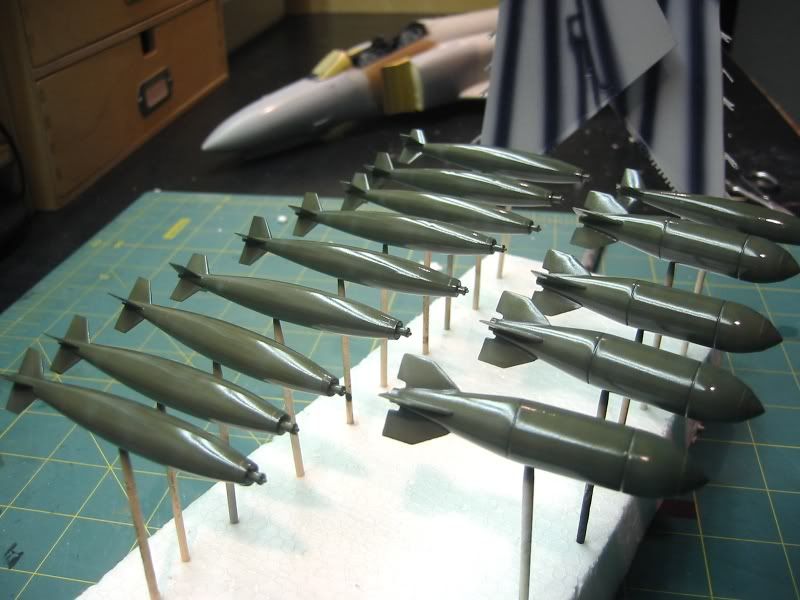

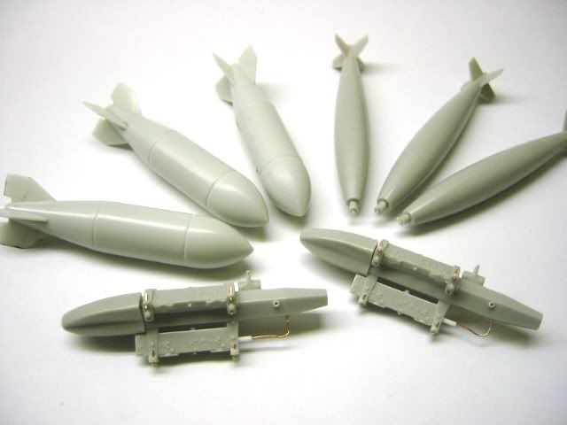

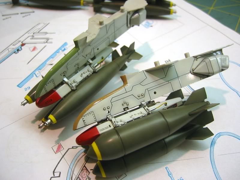

starflyer Posted February 4, 2008 Author Share Posted February 4, 2008 Setp 09 Underwings warloads Painting......... Quote Link to post Share on other sites

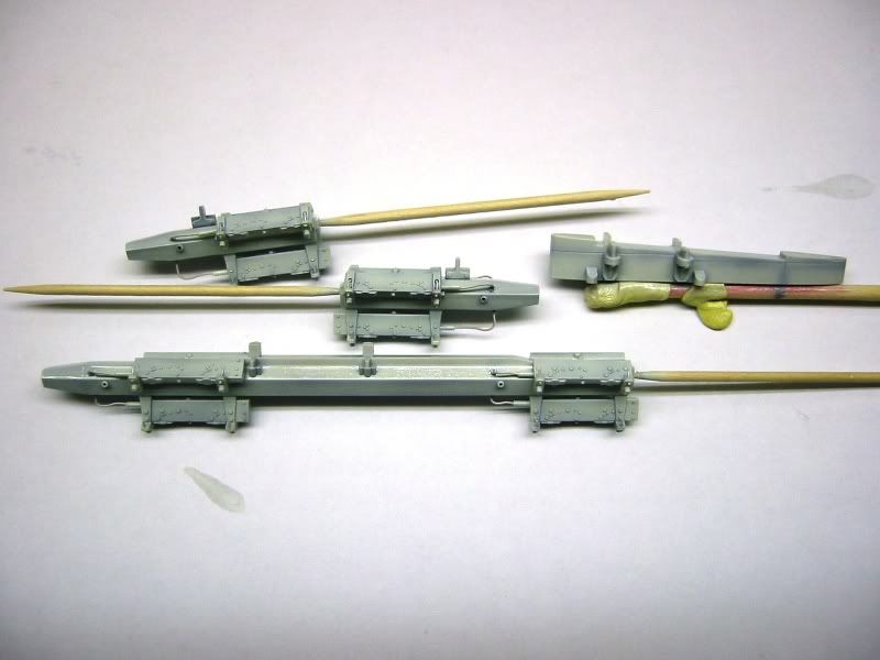

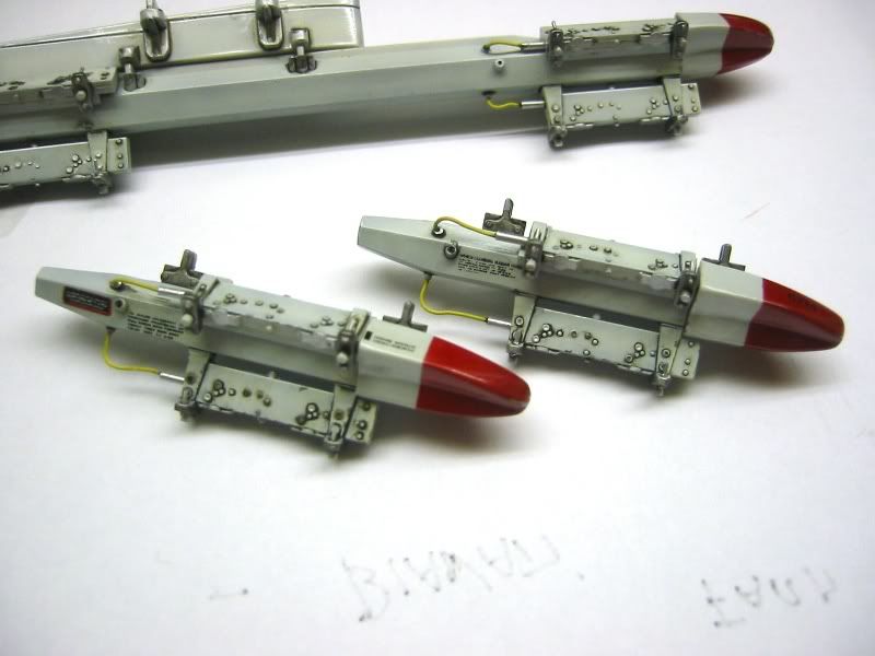

starflyer Posted February 4, 2008 Author Share Posted February 4, 2008 Step 10 Underwing pilons Paintin & assembling... Quote Link to post Share on other sites

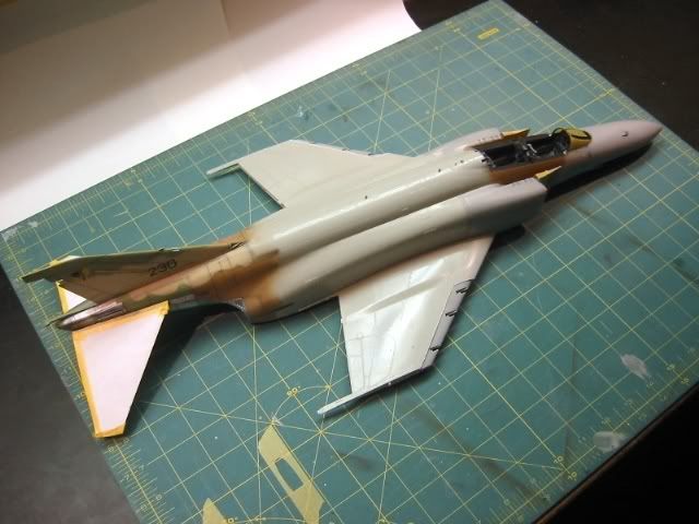

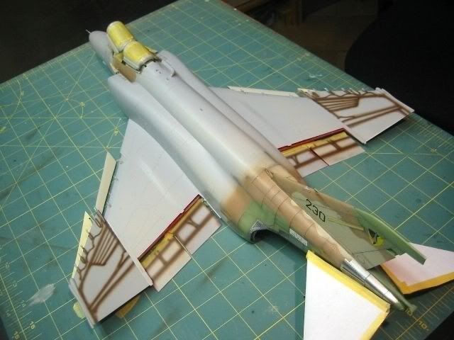

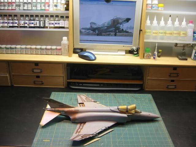

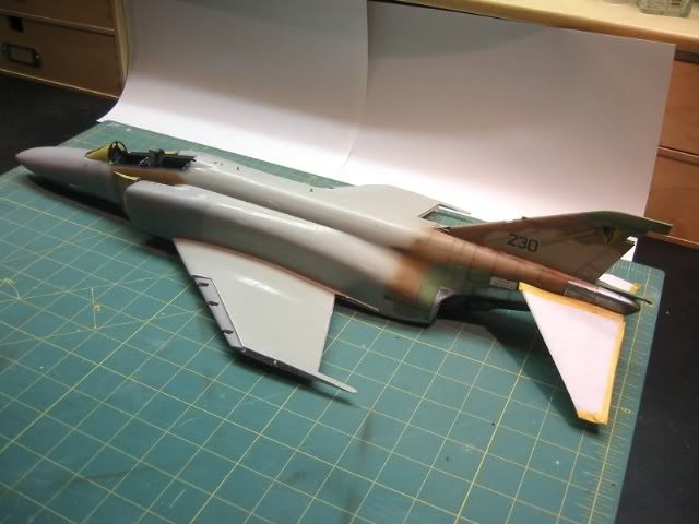

starflyer Posted February 4, 2008 Author Share Posted February 4, 2008 Step 11 general assembly Quote Link to post Share on other sites

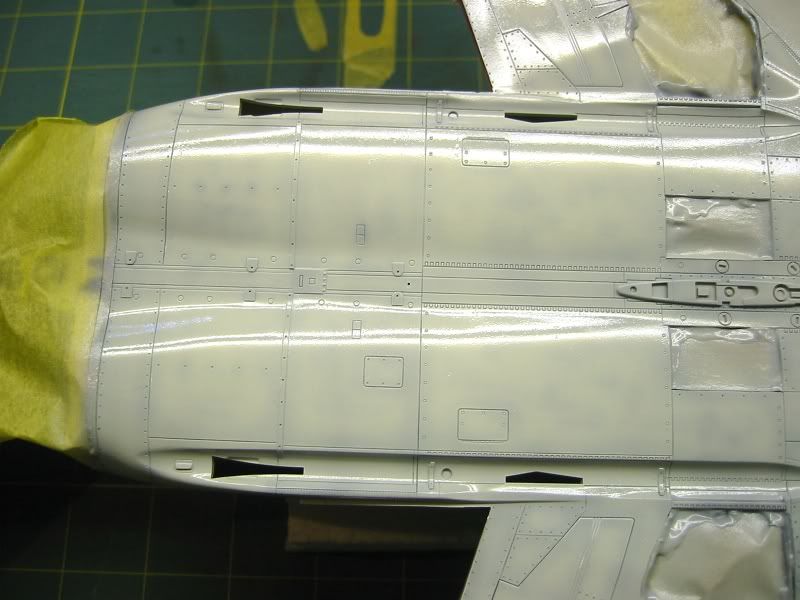

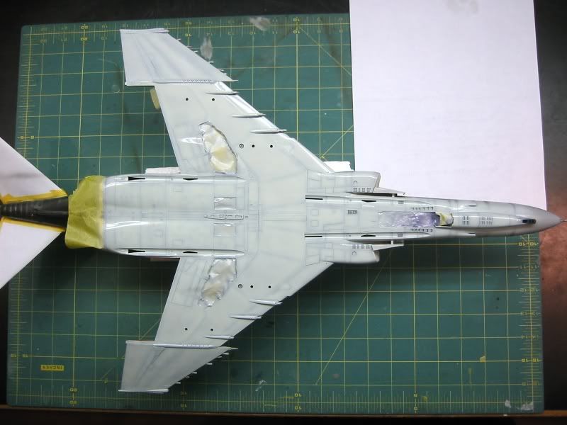

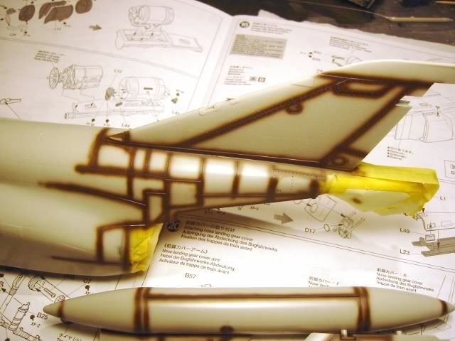

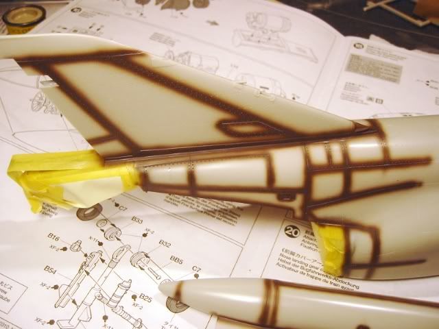

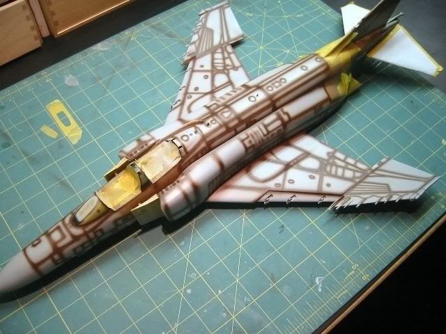

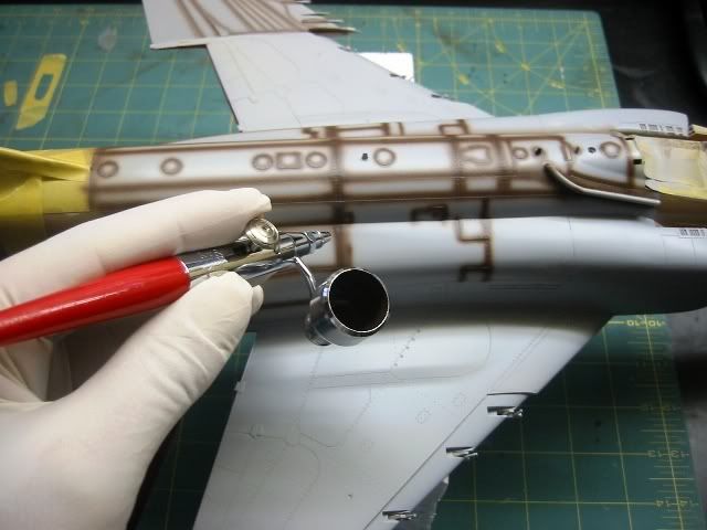

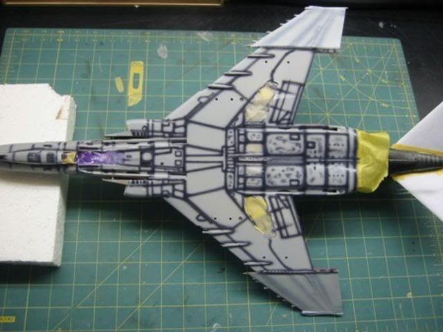

starflyer Posted February 4, 2008 Author Share Posted February 4, 2008 Step 12 Preshading Start of painting section from preshading, dark blue undersrufaces, dark brown uppersurfaces.....very long process on 32 scale model.... Quote Link to post Share on other sites

Musical_Box Posted February 4, 2008 Share Posted February 4, 2008 (edited) :D A couple of questions about the oil wash: did you apply the paint straight out of the tube? How long did you wait before wiping it off? Was that section clear coated before applying the wash? P.S. avevo giàvisto un paio di articoli sul tuo G-91 (sempre che non si tratti di un caso di omonimia), ma qui siamo veramente su un altro pianeta... complimenti Edited February 4, 2008 by Musical_Box Quote Link to post Share on other sites
rom Posted February 4, 2008 Share Posted February 4, 2008 AWESOME JOB!!!!!!!!!!!!!!!!!!!!!!!!!!!!!!!!!!!!!!!!!!! I want to call you the airbrush master!!!!!!!!!!!!! One question, why are your paintings so shiny? keep that amazing job up!! Quote Link to post Share on other sites
starflyer Posted February 4, 2008 Author Share Posted February 4, 2008 (edited) A couple of questions about the oil wash: did you apply the paint straight out of the tube? How long did you wait before wiping it off? Was that section clear coated before applying the wash? P.S. avevo giàvisto un paio di articoli sul tuo G-91 (sempre che non si tratti di un caso di omonimia), ma qui siamo veramente su un altro pianeta... complimenti Ciao, yes you are right!, the Fiat G91's are mine..... about oil was on the F-4E, I dont apply any kind of transparent paint before it, since Xtra color are gloss and good resistant to oil wash. But the mixing of oil that I dit is not so liquid in that case, and the solver is "olietto diluente" for art oil colours. If you use acquaragia solvent for mixing, in that case the Xtra color or Humbrol enamel will be destroyed from oil wash, you should MUST apply acrylic transp paint. Ciao Edited February 4, 2008 by starflyer Quote Link to post Share on other sites

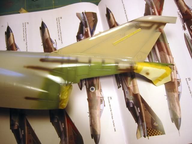

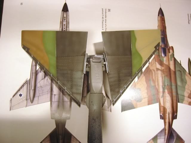

starflyer Posted February 4, 2008 Author Share Posted February 4, 2008 Step 13 Painting I start from the undersurfaces with Xtra Color, the shade of preshading came out well, I am satisfied about this session. in few days I hope to show you the rest..... Quote Link to post Share on other sites
