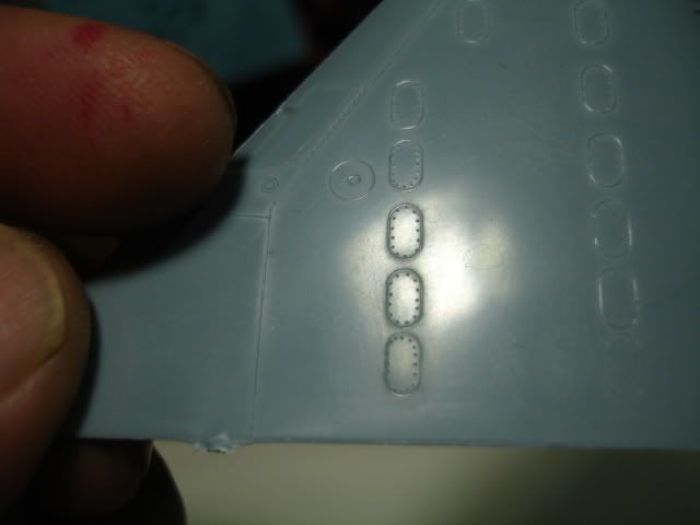

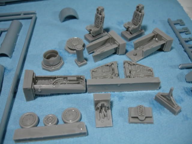

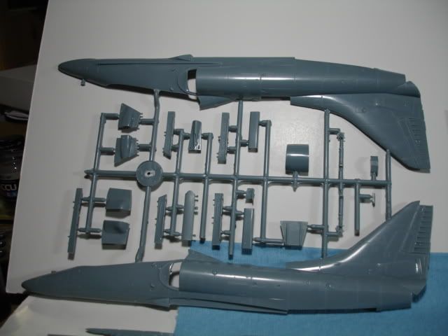

markiii Posted July 1, 2008 Share Posted July 1, 2008 Hey All, just got this in the mail today and got started right away. Before starting, I inspected all the parts and took inventory,so far so good until I got to the seats. They are a bit short shot on the sides, so before doing anything I flowed super-thin CA around the thin areas and hit them with accelerator. Better now. Then on to washing, pics after the bath: I hope to make steady progress on this one, and now back to my regularly scheduled build, an Il-2. Mark Quote Link to post Share on other sites

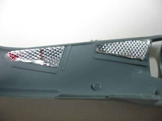

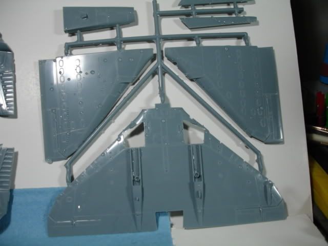

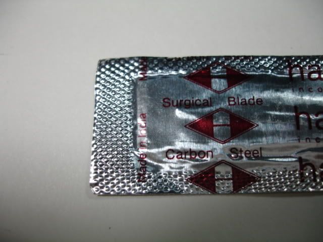

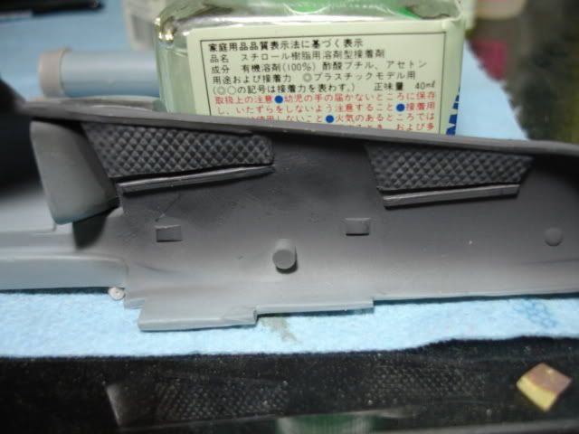

markiii Posted July 4, 2008 Author Share Posted July 4, 2008 I'm back with a small update. I wanted to replicate the quilted pattern on the sidewalls. I used the foil packaging from surgical knife blades, the edges have an pressed pattern that looks the part. Just cut to size and ca'd on. I started putting rivet details on the wings. Thanks for looking. Mark Quote Link to post Share on other sites
Eastern Posted July 4, 2008 Share Posted July 4, 2008 I'm back with a small update. I wanted to replicate the quilted pattern on the sidewalls. I used the foil packaging from surgical knife blades, the edges have an pressed pattern that looks the part. Just cut to size and ca'd on. Wow! One more terrific idea of using the foil! Looks nice! Suppose it woulld be a very nice build. :D Cheers and happy modelling! Alexander. Quote Link to post Share on other sites
Jack-Swiss Posted July 4, 2008 Share Posted July 4, 2008 Nice tip there!!!!! thanks alot! Cheers Quote Link to post Share on other sites

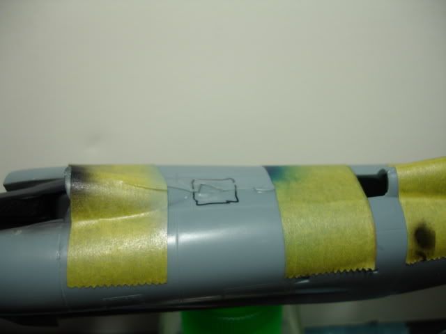

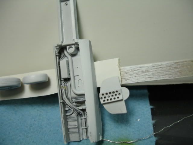

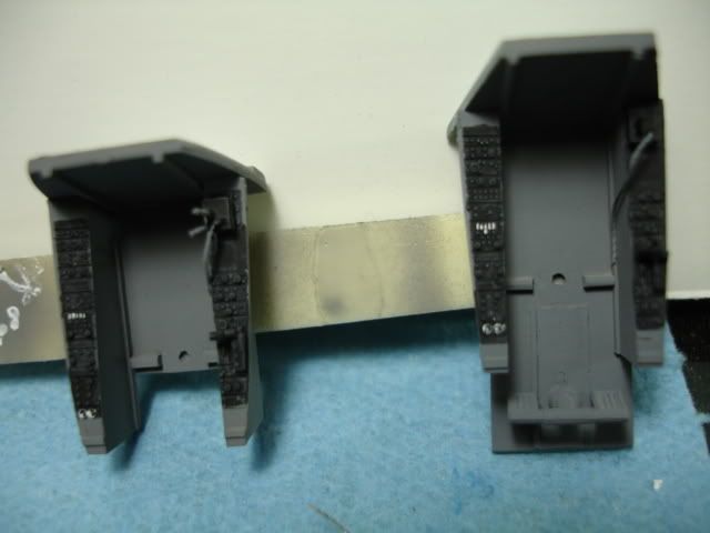

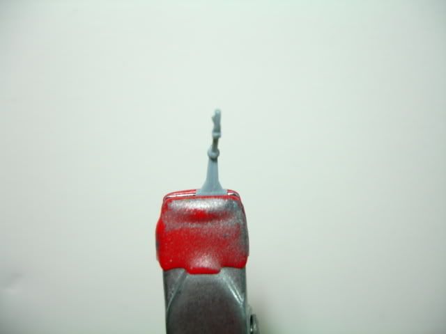

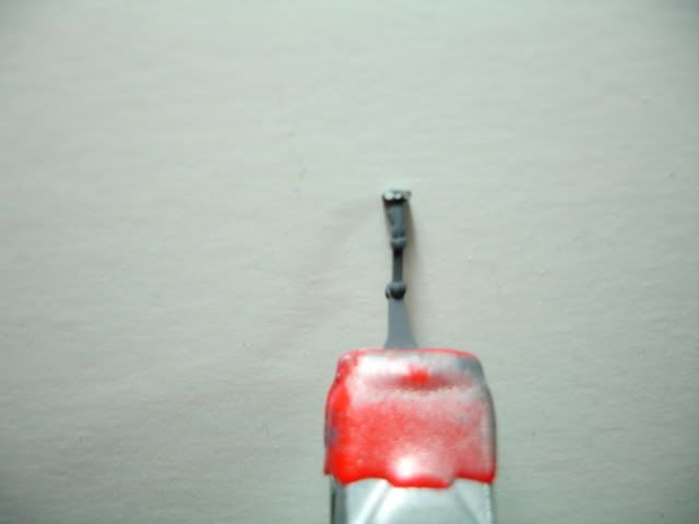

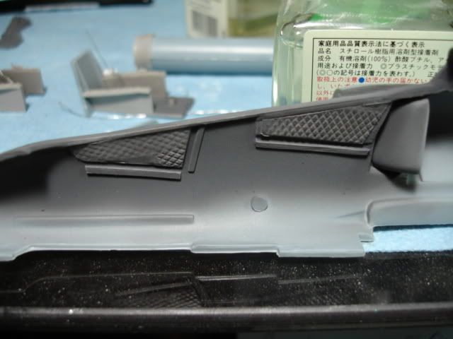

markiii Posted July 14, 2008 Author Share Posted July 14, 2008 Another small update, have not worked on it as much as I wanted to. Here I have the sidewalls painted & drybrushed a little with MIG faded grey oil paint. This ^ is what the control stick looked like in my kit (looks short shot) and what it looks like after my mod. Sorry about the crappy pics. In this picture, I have outlined in black an area that has a funny depression, it is supposed to be a retangular shaped duct. So I have cut that area out and will insert a spare part from a Hasegawa kit. Started painting the cockpit tubs, I added some hoses and the box(?) that the hoses come out of, plus the throttle control (funny they are not included since there are holes for them).Still more detailing to do Nose gear bay painted & weathered a little, still some more work to do. Thanks for looking. Mark Quote Link to post Share on other sites

GreyGhost Posted July 14, 2008 Share Posted July 14, 2008 Nice updates Mark ... Cool idea using the foil to replicate the quilting ... Gregg Quote Link to post Share on other sites

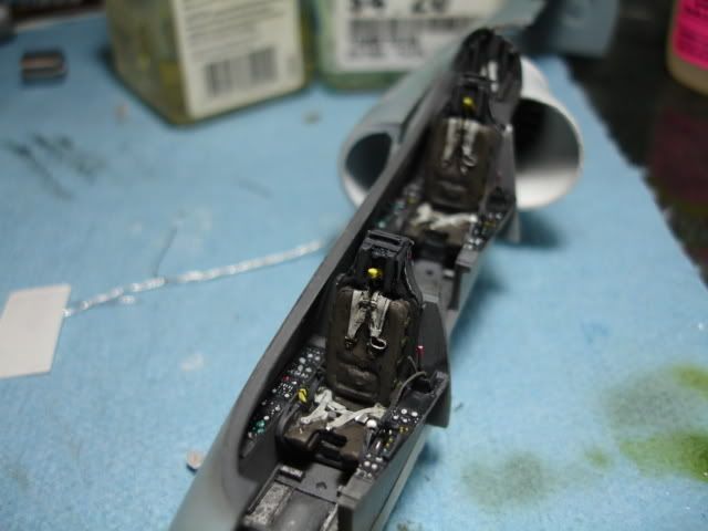

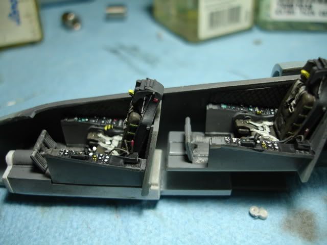

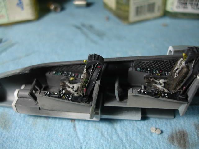

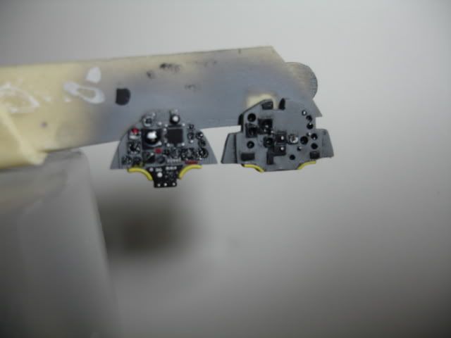

markiii Posted July 17, 2008 Author Share Posted July 17, 2008 Back with a mid-week update. Still working on the cockpit. Cockpit shot, seats in just for photo. Still have some details to add to them. Instrument panels all painted up. The left panel is a spare from a Hasegawa kit. That's all for now, I'll have another update this weekend. Mark Quote Link to post Share on other sites
pacific mustang Posted July 17, 2008 Share Posted July 17, 2008 great going. I am building this one myself. Your panels look superb, although you may want to check some rfs re the cockpit quilting, as I do not think rthe two seaters had it. Most jets seem to have had the unquilted sound proofing as CA have moulded. Fantastic idea with the foil though and regardless it will certainly add some texture and detailing to the cockpit. I am quite happy with the fit on mine, although you may need to thin down the intake trunking a little so the fuselage closes OK. You certainly look like you got a kit with QC problems, mine was OK. Keep posting update pics please. For all the excitement the release of this kit generated, yours is the first build I am seeing Regards Bruce Quote Link to post Share on other sites
Jack-Swiss Posted July 17, 2008 Share Posted July 17, 2008 Wooow markii...the painting is top notch indeed!!! i really like your job and the job done on the IP is superb,really makes it like a aftermarket IP...great job dude!!! Cheers Quote Link to post Share on other sites
