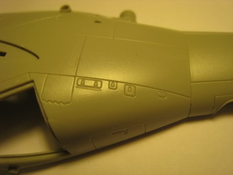

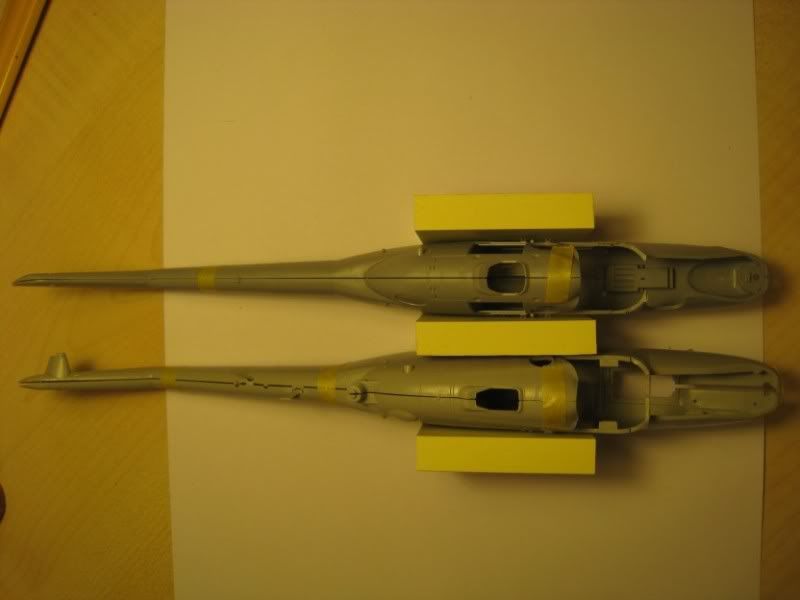

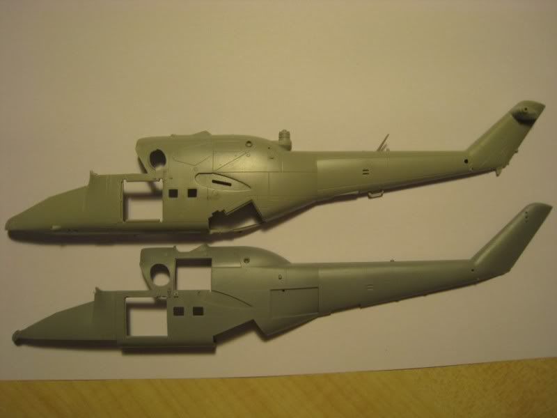

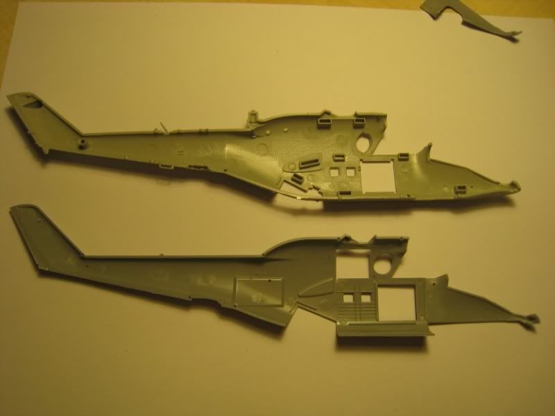

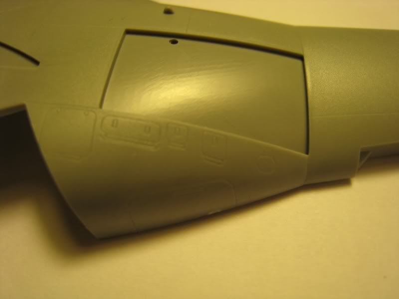

cvrle Posted September 22, 2010 Share Posted September 22, 2010 Now for some comparison pics: Hobbyboss up, Zvezda down: Interior side: Top view (Zvezda top, HB bottom) Here we see a discrepancy - the Zvezda main rotor mast opening is more square that the rectangular HB one... The HB one corresponds to the 4+ plans, but looking at photos, I'm not sure that Zvezda is incorrect. I'm actually leaning towards thinking that Zvezda is the more accurate one. And, finally, comparison of the engraved detail: Zvezda: HB: Zvezda's panel lines are really, really, fine... Maybe too fine for some. There are some I'll add definition to, but others I'll leave as is. Btw, Zvezda's access panels in the above photos seem to represent the original with more fidelity. Both good kits, I like Zvezda more, but that's subjective. Quote Link to post Share on other sites

Laurent Posted September 22, 2010 Share Posted September 22, 2010 The HB one corresponds to the 4+ plans, but looking at photos, I'm not sure that Zvezda is incorrect. I'm actually leaning towards thinking that Zvezda is the more accurate one. I don't have the Mi-24 4+ book and I don't intend to buy it but I have several 4+ books. The plans are nice and detailed but I would be very cautious about their accuracy. Quote Link to post Share on other sites

cvrle Posted September 24, 2010 Author Share Posted September 24, 2010 I don't have the Mi-24 4+ book and I don't intend to buy it but I have several 4+ books. The plans are nice and detailed but I would be very cautious about their accuracy. You're completely right, Laurent. As i've mentioned, the main rotor mast opening in the top fuselage is depicted as rectangular on both the plans and the HB kit, but looking at the pictures, I'm thinking that the Zvezda kit with its more square opening is actually correct. I mean, both kits look like a Mi-24, and are light-years ahead of the competition, but, for me, Zvezda is the one to go with. I just like it more, and it seems better to my eyes... Quote Link to post Share on other sites
MiG31 Posted September 24, 2010 Share Posted September 24, 2010 For what it may be worth, here is an oblique photo showing the top of a de-rotored Mi-24V. From first glance it looks like the HB kit has it right, but I won't say for certain, since the angle doesn't help too much. Quote Link to post Share on other sites
pollie Posted September 24, 2010 Share Posted September 24, 2010 For what it may be worth, here is an oblique photo showing the top of a de-rotored Mi-24V. From first glance it looks like the HB kit has it right, but I won't say for certain, since the angle doesn't help too much. Not that it matters a great deal (probably), but that is actually a Mi-24D, not a V. Quote Link to post Share on other sites
MiG31 Posted September 24, 2010 Share Posted September 24, 2010 Thanks. I'm not surprised, as Airliners.net has the occasional mis-captioned photo (KC-135Es mistaken for -135Rs, for instance). The thought did occur to me that the opening may be different between variants, and I wish I could find a better top-down view (of a Hind-E). Quote Link to post Share on other sites
Berkut Posted September 24, 2010 Share Posted September 24, 2010 (edited) Looking at the pictures i have saved on my pc, it seems there is a shape difference in that area between models of real Mi-24. If it is shape difference regarding the "hole" it self or not, i am not sure. Anyway, to me it looks like the Zvezda is correct one when comparing it to the pictures. And lets just say i honestly trust Zvezda more. Thank you very much for the comparing, it is very interesting to see so many subtle differences. (door, tail, exhaust pipe size, cockpit size etc...) Edited September 24, 2010 by Berkut Quote Link to post Share on other sites

Flankerman Posted September 25, 2010 Share Posted September 25, 2010 In what sence are you talking about assymetric? the tail surface or is it somewhere else? If you look at a real Mi-24 from directly head-on, the front cockpit is perfectly vertical. But immediately behind the rear cockpit, the whole fuselage is tilted to starboard by about 2.5deg (IIRC). This is the counteract the offset thrust from the main rotor and take some load off the tail rotor. The 'twist' is very subtle - but you can definitely see it directly from the front. You can also see it in the rear bulkhead shown in the Zvezda sprue shots. I have a drawing - and a photo - showing the twist - but I am away from my home computer just now. Ken Quote Link to post Share on other sites
