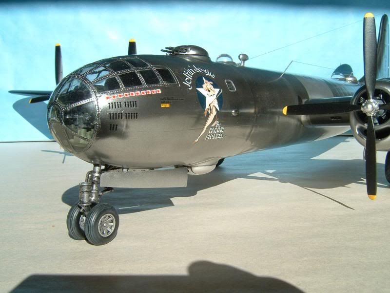

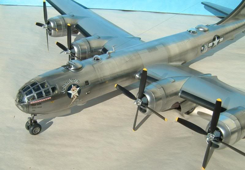

Bill the plastic fondler Posted July 26, 2010 Share Posted July 26, 2010 This is my recent almost OOB build of the Revell/Monogram boxing from 1998. This was a poor molding as you can see the excessive sink marks on the fuselage giving it a ribbed effect. It would've taken too much work to correct, so I left it as is. I replaced the kit props with an old set of Hamilton Standards from 299 models. The model was first airbrushed with gray auto primer, wet sanded and then given a several coats of gloss black enamel. The Fuselage was first painted Alclad II Chrome then the nose and aft crew areas masked and the entire model painted with Highly Polished Aluminum. The control surfaces were painted in Alclad II aluminum and the wing midsection was a mix of Alclad II aluminum with some gray added. Then the whole model was brushed with Future, the decals were applied and then sealed in Future. Quote Link to post Share on other sites

moeggo Posted July 26, 2010 Share Posted July 26, 2010 Ohhh... Shiny! I love it... the sink marks do give a nice effect! I wonder if Monogram did that on purpose? Quote Link to post Share on other sites
Ro-Gar Hobbies Posted July 26, 2010 Share Posted July 26, 2010 Very..very nice!!! You did an incredible job on it. Not a kit you see completed and posted regularerly. I have to agree with moeggo, the sink marks give it a nice stressed effected. Robert Quote Link to post Share on other sites
GEH737 Posted July 26, 2010 Share Posted July 26, 2010 From the photos - oddly enough, the sink marks do seem to add to the effect of stressed skin. Really well done! Hitch Quote Link to post Share on other sites

haneto Posted July 26, 2010 Share Posted July 26, 2010 Nice built! Very real effect!! I wonder how much weight you added into the nose section? I remember there's not very much space there... Cheers, Yufei Quote Link to post Share on other sites
model junky Posted July 26, 2010 Share Posted July 26, 2010 Beautiful Job! Every project I do that needs the natural metal finish is always a learning experience. How did you do the vertical shading? I am not talking about the 'stressed' frame that the others are referring to but rather that streaking effect? Great job, very inspiring. Quote Link to post Share on other sites
strikeeagle801 Posted July 26, 2010 Share Posted July 26, 2010 If you had not pointed it out, I would've thought that the stressed skin effect was intended/part of the model. I think it actually adds to the model, not detracts from it. That is one thing that amazes me about the B-52. I saw one at an airshow this weekend, and there are wrinkles everywhere over that thing! It's almost like it's a Boeing trademark. Aaron Quote Link to post Share on other sites
Boman Posted July 26, 2010 Share Posted July 26, 2010 Fantastic!!! ;) :) I remember building the old Airfix B-29 in 1/72 in these markings - the story of Joltin Josie was written on the instruction sheet if I recall correctly - anybody know where I can find more details on her? Wiki turned up only the preserved aircraft, but not her story? Quote Link to post Share on other sites
Bill the plastic fondler Posted July 26, 2010 Author Share Posted July 26, 2010 (edited) This beast takes lots of weight. Just about 13 ounces to get it to sit. Packed most of it in the bomb bay, the some in the nose under the cockpit floor and some in the forward gun turrets. Edited July 26, 2010 by Bill the plastic fondler Quote Link to post Share on other sites
