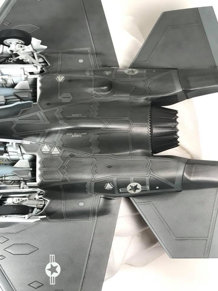

1 hour ago, Mr Matt Foley said:
Does anyone know if the lighter panel taped ares have the sheen as well?
From all the photos I've seen, no, the taped areas don't have the sheen. Look at the photo below. You can clearly see that the taped areas don't have the sheen.
8886290994_2bf8b4f04d_b_1
You would think engine gray would be too dark but I really like the result. I think I am going to stick with Mission Models FS36170 and see how it turns out once the flat coat is applied. I experimented with FS36270, FS36251, and FS36231 for the RAM tape.  I likely with go with FS36231.
