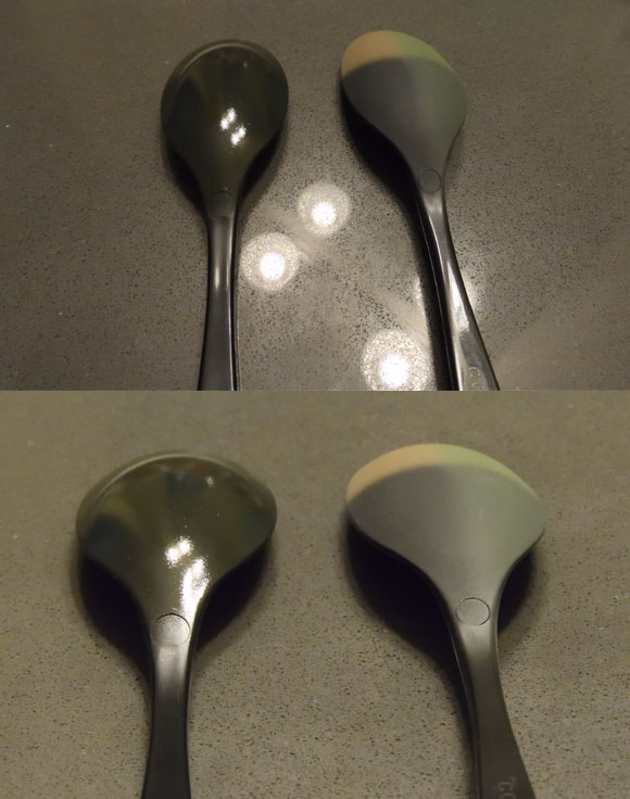

RichardL Posted April 16, 2018 Share Posted April 16, 2018 2 hours ago, Tato said: Hi Richard, I tried Gunze H20, but I didn't like to much the result. I'm sure there's something I'm not doing good. I didn't got a flat surface, may be it was the thinner... How are you applying the gloss clear coats and the flat clear coats? Below is a picture I just took showing Tamiya X-22 thinned with Tamiya X-20A on the left spoon and Gunze H20 thinned with Gunze Aqueous thinner on the right spoon: Both were applied with my Iwata gravity feed airbrush with a 0.5mm needle. As you can see, Tamiya X-22 is glossy and Gunze H20 is flat. Quote Link to post Share on other sites

Tato Posted April 17, 2018 Author Share Posted April 17, 2018 Hi Richard, Thank you very much for the photos, very clarifying. I'm using Gunze H30 Gloss Clear which it's working relatively ok. But for the H20 Flat Coat, I'm not having good results. I'm pretty sure is the thinner. I've notice that I'm using a different one from the one you have. I think is for the other type of gunze paints (not the aqueouse ones). 21 hours ago, RichardL said: How are you applying the gloss clear coats and the flat clear coats? Below is a picture I just took showing Tamiya X-22 thinned with Tamiya X-20A on the left spoon and Gunze H20 thinned with Gunze Aqueous thinner on the right spoon: Both were applied with my Iwata gravity feed airbrush with a 0.5mm needle. As you can see, Tamiya X-22 is glossy and Gunze H20 is flat. That gloss coat is beautiful! Definitively gonna give it a try! 3 hours ago, dagger00 said: Hello: I usethe ones from AMMO MiG Gimenez. But, in order to obtain a gloss finish, you must apply 2 or 3 thin layers. Another brand I use is K-4, a chilean one, and the best for me, Sicko, wich is a local brand here (Argentina). Happy Modeling! Hi Dagger, thank you for your help. I tried the one from AMMO, the Lucky Ultra Matt. Didn't like it that much, found it very difficult to handle. Never heard that K-4 made clear coats, may be I should give them a try! Regards! Tato Quote Link to post Share on other sites

RichardL Posted April 23, 2018 Share Posted April 23, 2018 On 4/18/2018 at 10:25 AM, Mstor said: I recently switched to Tamiya X-22 thinned 1/2 and 1/2 with Gunze Mr Color Leveling Thinner. Beautiful smooth high gloss finishes. I found a hobby acrylic gloss clear that's even smoother and more glossy: Gunze H-30. Here I airbrushed two clear spoons with two coats of Gunze H-12 Flat Black: I waited 24 hours before airbrushing the gloss clears over the same two spoons. On the left is Gunze H-30 thinned with Gunze Aqueous Thinner. On the right is Tamiya X-22 thinned with Mr. Color Leveling Thinner: Both went down beautifully. Only two coats of clear were applied to each spoon. Quote Link to post Share on other sites

speedlimit Posted April 26, 2018 Share Posted April 26, 2018 On 4/22/2018 at 11:08 PM, RichardL said: I found a hobby acrylic gloss clear that's even smoother and more glossy: Gunze H-30. Here I airbrushed two clear spoons with two coats of Gunze H-12 Flat Black: I waited 24 hours before airbrushing the gloss clears over the same two spoons. On the left is Gunze H-30 thinned with Gunze Aqueous Thinner. On the right is Tamiya X-22 thinned with Mr. Color Leveling Thinner: Both went down beautifully. Only two coats of clear were applied to each spoon. If you don’t mind my asking. What is the ratio you use for both clear to thinner and What pressure you set your airbrush to? Quote Link to post Share on other sites
RichardL Posted April 26, 2018 Share Posted April 26, 2018 9 hours ago, speedlimit said: If you don’t mind my asking. What is the ratio you use for both clear to thinner and What pressure you set your airbrush to? Ratio is 1:1 for both (one part clear to one part thinner). Air pressure is 16 psi, and airbrush is Iwata Revolution CR gravity feed. Quote Link to post Share on other sites

RichardL Posted April 27, 2018 Share Posted April 27, 2018 2 hours ago, Mstor said: MRP (Mr Paint) also makes a gloss clear coat that I assume needs no thinning. I tried MRP gloss clear coat and was not very impressed. It's not very glossy after three coats. Will try snap some pictures later. Quote Link to post Share on other sites

RichardL Posted April 28, 2018 Share Posted April 28, 2018 8 hours ago, Mstor said: Maybe it will work as a final Semi-glossish coat. It will indeed work as a final semi-gloss coat. Here is a picture I just took: MRP is on the right. It is more of a satin finish. Hopefully you will be able to tell the difference based on the reflection on the spoons. Quote Link to post Share on other sites
