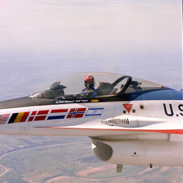

Dutch Posted June 8, 2020 Share Posted June 8, 2020 I wan to build one of the Early YF-16s with the row of flags underneath the cockpit. So which YF-16 (72-1567/68) or YF-16A (75-0745/50) carried the Israeli flag and when? After checking the F-16.net website, I can only discern one photo of YF-16 72-1568 circa Sep 80 at the Rome AFB hangar without nosecone that shows the israeli flag replacing the Iranian flag. K/r, Dutch Quote Link to post Share on other sites
82Whitey51 Posted June 8, 2020 Share Posted June 8, 2020 (edited) 36 minutes ago, Dutch said: I wan to build one of the Early YF-16s with the row of flags underneath the cockpit. So which YF-16 (72-1567/68) or YF-16A (75-0745/50) carried the Israeli flag and when? After checking the F-16.net website, I can only discern one photo of YF-16 72-1568 circa Sep 80 at the Rome AFB hangar without nosecone that shows the israeli flag replacing the Iranian flag. K/r, Dutch According to the caption here from the F-16 In Action book (No. 53, the first one on the F-16), it was aircraft 01568, No. 2 prototype, in July on 1979. It also looks as if by then the earlier STENCIL seat has been replaced by the ESCAPAC seat here. [/ Edited June 8, 2020 by 82Whitey51 Quote Link to post Share on other sites
Dutch Posted June 8, 2020 Share Posted June 8, 2020 Thanks Andy. Quote Link to post Share on other sites
