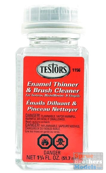

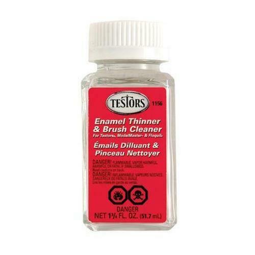

ReccePhreak Posted April 20, 2020 Share Posted April 20, 2020 (edited) Is there any difference between these two Testors thinners? I usually use the square bottle to "top off" my bottles of paint, for brush painting, and the can for thinning for airbrushing. It'd probably be cheaper to order the can for every use, since local sources are closed and I need to order online. Edited April 20, 2020 by ReccePhreak Quote Link to post Share on other sites
