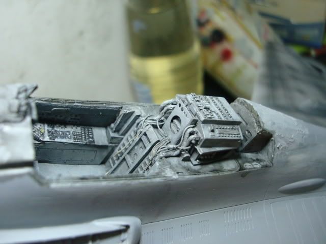

NazaruddinHashim Posted September 15, 2011 Author Share Posted September 15, 2011 Hi Alexander….thanks to drop by .....appreciated :worship: I just try my best, the most important I can finish off the whole Miggy…., Thanks for url link as well, I saw the product, your work are awesome….so do to Chris, smart skills combination also… btw, we miss out an update...i think I’ve to stick on previous one….Thanks again Alexander… Some update on the cockpit area….a huge mistake I did on this step…few pictures are missing as well ….. Started a cockpit with CAM….i can use full set of Eduard….but then….i decided to mix and match both….. I used CAM as a basic platform , but the details by Eduard…meant, I’ve to scrape it and replaced…so sorry pic’s of the progress are gone…no back up file…. Few pictures are missing …had a disater on my computer...mother board burn...…. Platform removed...i just take the portion i need... attach to Eduard PE Platform... After task complete…I realize it….i miss look this page…. I shouldn’t make a mistake…. To reduce the guilt….another surgery had made…. Cut according to zacto instruction.... As for cockpit edges on fuselage...i'll need a solution...input are welcome... Cockpit is painted…I’ll share it later….thanks for viewing guys… Regards Naza Quote Link to post Share on other sites

NazaruddinHashim Posted September 18, 2011 Author Share Posted September 18, 2011 I did some sanding work on forward fuselage….I is not sure if there any different….i attaches real pictures of Miggy….original Revell nose n forward fuselage as for comparison…. The basic paint n primer on a cockpit area….a minor modification to blend Eduard, CAM and my own details that I added http://i241.photobucket.com/albums/ff79/NazaModelArt/DSC04630.jpg[/img That’s all for a time be….thanks for viewing guys….as usual C&C are welcome….next task is... A big thanks to Zactoman aka Chris for an input…. Seee you all in next post….HAPPY MODELING… Thanks and Regards Naza Quote Link to post Share on other sites
