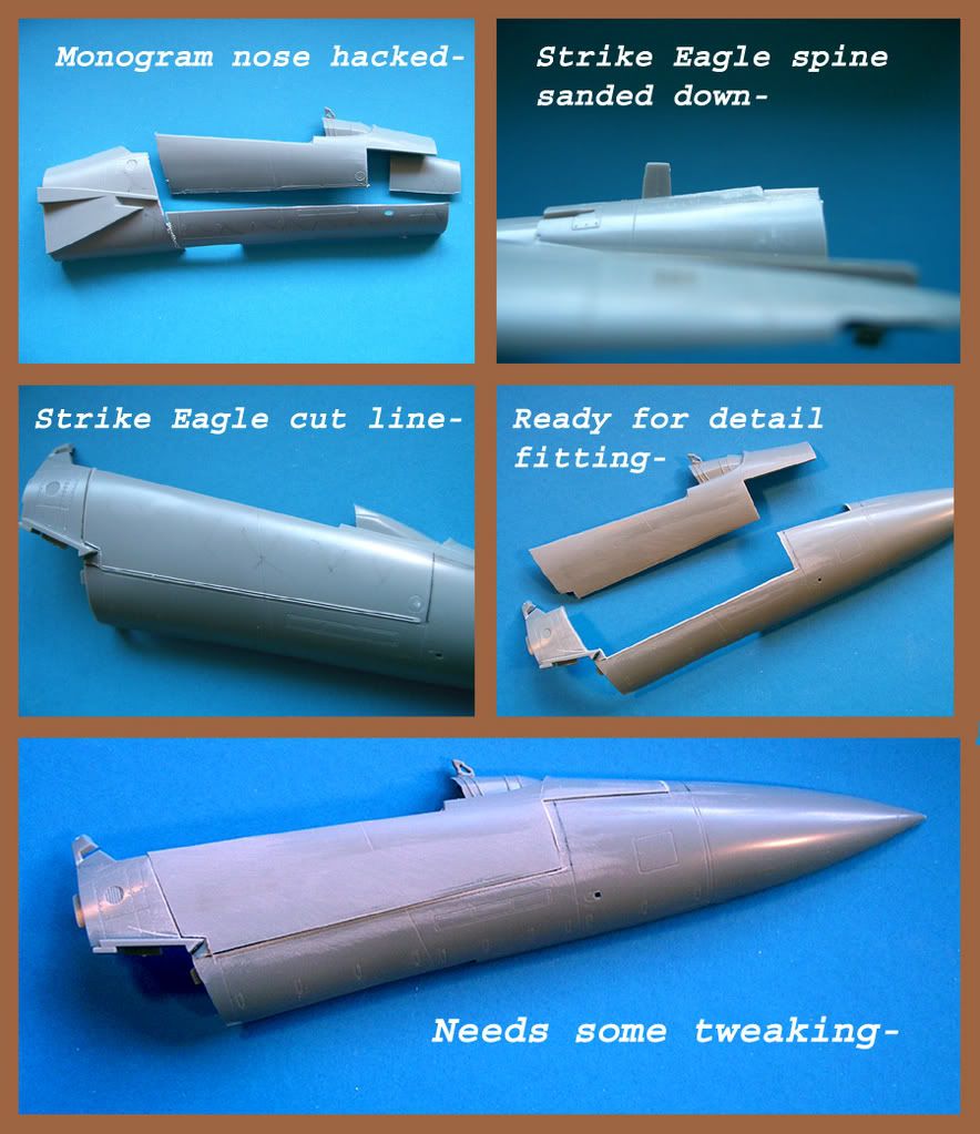

kenlilly106 Posted June 6, 2007 Share Posted June 6, 2007 Hey Guys,Another great thread with tons of info that would be hard to find elsewhere. But, how about this, could the forward fuse. from the Mono. -C kit be grafted onto the -E model main fuse? Has anyone measured this for proper "diameter" or even better completed this conversion. Something to think about. Yes and no. (great answer, eh?) I had the idea to take a rescribed Mono C forward fuselage and graft it to the R/M F-15E main fuselage, and actually got the parts together and was working on this seam when the model slipped and fell about 6' to a concrete floor. The main gear doors can be sanded down flat if you back them with putty, and it's not that hard to remove the gun door bulge. The respective height/diameter of the Mono C forward fuselage fits almost perfectly in terms of diameter and height (kinda, more on this later) to the R/M F-15E main fuselage IF you shave off about 1/8" from the aft end of the forward fuselage. The big problem is that the R/M spine curves up due to the 2 place canopy, the C spine is a lot flatter. Normally this wouldn't be much of a problem, except that the E kit has the large vent about 1/8" behind the seam, so any major seam work will run the risk of destroying this detail. I built up the area between the C and E kits with putty and carefully sanded it, it looked fine from a seam filling standpoint, but the upward curve of the spine looks odd, plus the E spine has more of a pronounced 'peak' than the C one, so I'm not sure how to handle that part, I thought about cutting strips out of the E spine and forcing it down and gluing and puttying over the cuts, but you're back in the same boat with the vent detail. I also had the idea of taking the E kit and turning it into an F-15DJ, this project was easier since you didn't have to worry about trying to mate 2 different fuselage parts, and the other bits to make it a D won't take that much work, but I shelved the project early on, I think I had it assembled, but not much beyond that. Ken Quote Link to post Share on other sites

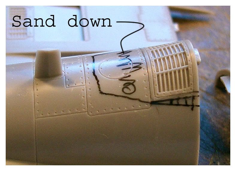

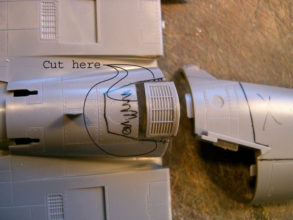

Impatient Pete Posted June 6, 2007 Author Share Posted June 6, 2007 Thanks for the input Ken. Good stuff! I took a look at the conversion (this is where I usually stop from analysis paralysis) and this is what I came up with. replace the tub only with the Monogram C tub (see pic), cut the vent from the E and sand down the small area aft of it. Try to keep the cuts clean so the work stays on the outside of the vent. The main part is to cut the tub area from the C and install it in the E. After all, the tub detail in the C is outstanding! That way you get to keep all that sweet detail in the C pit! What do you guys think? Pete Quote Link to post Share on other sites

kenlilly106 Posted June 6, 2007 Share Posted June 6, 2007 And...the Revell kits are available at Michaels for $18.00 with the coupon You must be in an expensive area, around here the mudhens are $25 w/o coupon, so I can get one for a shade over $13 with tax. Dug out my half built kit, the C canopy frame is a shade larger and longer than the cutout in the E kit, I'd guess it was .010 or .015 wider than the E fuselage, but only at the bottom. The 'hump' difference appears to be only 0.40 higher on the E kit than the C kit. Personally, I wouldn't try and graft the forward fuselages together, too much cut and patch work, I'd keep the E forward fuselage and fix the spine area and use the C canopy and cockpit parts. After doing the work though, I think that the E kit is more suited to be converted into an F-15DJ due mainly to the ease in converting one 2-seater into another 2-seater. Ken Quote Link to post Share on other sites

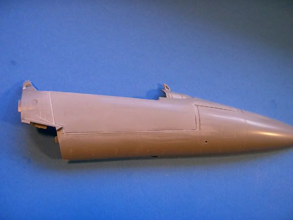

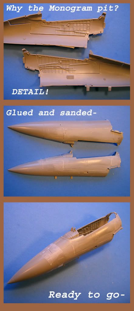

Impatient Pete Posted June 7, 2007 Author Share Posted June 7, 2007 Finished the splice- For the blend between the upper fuse and the rear of the cockpit area, I am going to force the little "tabs" of the hinge area down against the rear bulkhead of the C pit and that will help establish that shape. Then, I'll glue the vent in carefully and do a little blending. Hatchet...Maybe one day they will cut molds for a reduced version of their beutiful E model in 1/72nd scale. It sure is a lovely kit. Pete Quote Link to post Share on other sites
