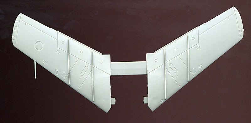

Jennings Posted July 26, 2008 Share Posted July 26, 2008 Looks quite nice! I took your image and measured the wing sweep to see if they'd copied Tamiya's incorrect sweep - they didn't! I measured it at 35.5 degrees at 1/4 chord, and the real thing is supposed to be 35 degrees. That's certainly within the margin of error when measuring from a fuzzy photo! Decals are pretty pathetic, but there are, or will be, scads of MiG-15 decals available. The good news is, I don't think any MiG-15 was ever flown in truly 'natural metal' - all had a coat of clear varnish (according to Russian sources), so you don't have to make 'em shiny. I'll probably be grabbing a couple of these! J Quote Link to post Share on other sites

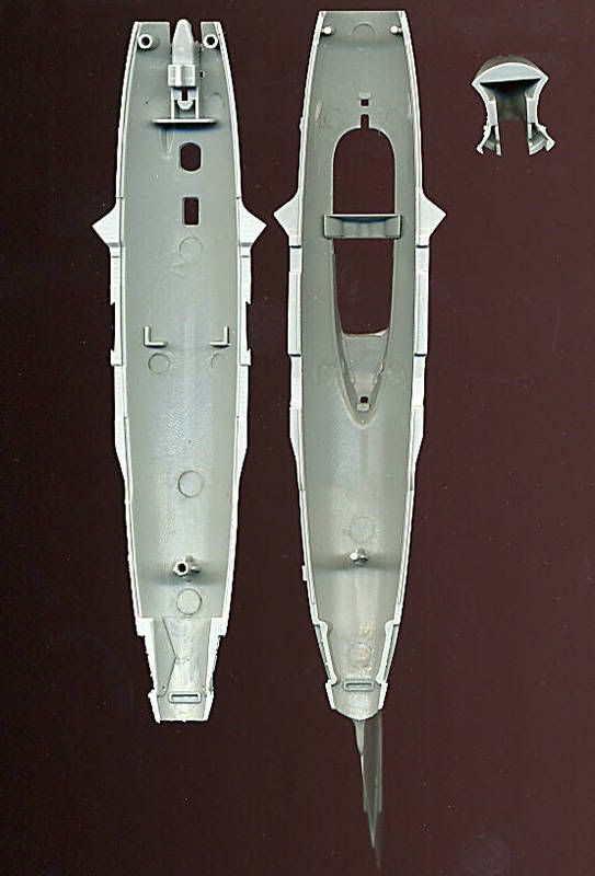

Irving Babbitt Posted July 26, 2008 Share Posted July 26, 2008 Is there any space for nose weight? Dumb question, I know, but it looks like the fuselage halves are pretty close to solid. Quote Link to post Share on other sites

Gene K Posted July 26, 2008 Share Posted July 26, 2008 Jennings, Here's a "sharper" wing scan with which to do your magic. Appreciate your comments on accuracy since I'm "away from my refs". Irving, The fuselage is anything but solid, as you can see. There's a little room in the intake splitter (which can be hollowed out at the top). There's also a small space under the cockpit tub that could be used, and the tanks are hollow. No idea yet as to how much weight it will require. As for the lack of instrument panel and console detail, I'll likely try to scale down the Eduard 1/48 set for the single seater, but have to do some research to see what the UTI arrangement is. In that regard, any pointers to photos, web pages, etc would be appreciated......Moritz. Gene K Quote Link to post Share on other sites

Jennings Posted July 26, 2008 Share Posted July 26, 2008 I wouldn't worry too much about adapting other cockpit bits (especially in other scales) to fit it. I can foresee much aftermarket made to fit this kit. Give it a few weeks... The wing scan is actually skewed a little more than the previous one, but the result is just about the same. The wing has the correct sweep within 1/2 degree (close enough for jazz). J Quote Link to post Share on other sites

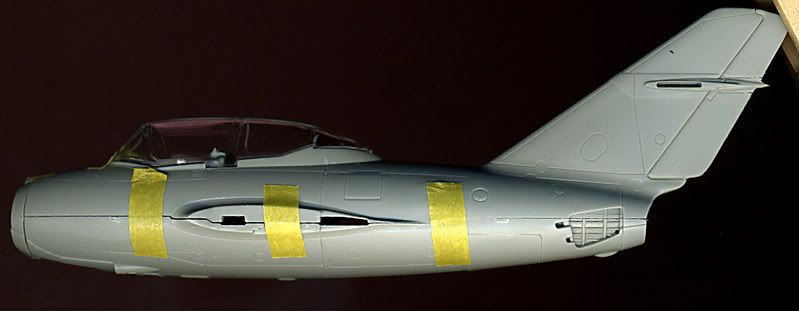

Gene K Posted July 26, 2008 Share Posted July 26, 2008 (edited) WOW!!! Glad I asked! Thanks for the great info! You're welcome.... I should have included the following: and I just cleaned up the parts and assembled the major pieces - absolutely no problems. As noted in the first sheet above, I recommend removing the locating pins and lugs in the upper and lower nose sections as they are too visible through the intake; and the cockpit tub needs a backrest/bulkhead to close the gap there. Anyone have a picture of that area? A nice kit! Gene K Edited July 26, 2008 by Gene K Quote Link to post Share on other sites

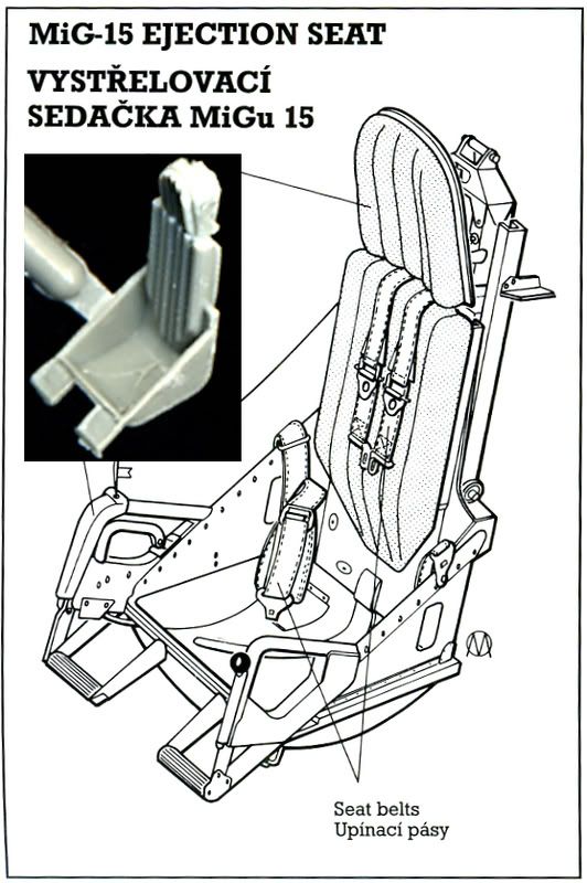

Gene K Posted July 26, 2008 Share Posted July 26, 2008 (edited) I pulled out some of my MiG-15 refs (including those from Squadron, KoKu Fan, 4+, and Ace) and determined the best set of drawings are in the 4+ publication. Layed the kit parts over the plans, and ......: excellent match - almost as if those plans were used to design the kit! The only noticeable discrepancy was that the kit's vert stab is a millimeter or two taller than on the plans. Pretty impressive, in my book. A couple of further observations: the speed brake wells appear to have "extra" horizontal stringers (I realize there were different speed brakes shapes, but have no idea which is more correct/prevalent): The seats appear to be good representations of the real thing, needing only ejection handles, harness/straps, and some trimming of the "foot rests": Lastly, the nosewheel strut (MiG-17 style) appears over-compresssed, while the mains appear under-compressed. I'll post a picture or two tomorrow comparing drawings/photos with the kit parts. Will be interesting to see how the assembled model sits (especially keeping in mind how bad the gear was on the HB Sabre). Been a good afternoon with what appears to be a really nice kit! Go for it, Old Blind Dog. Gene K Edited July 26, 2008 by Gene K Quote Link to post Share on other sites
