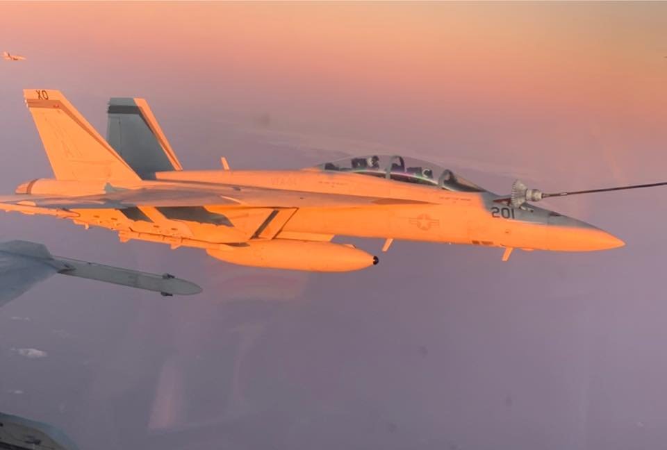

Boeing is working on a Block III Super Hornet that will have conformal tanks, glass cockpit, sat-comm antenna, and an IRST in the nose of the centerline tank. I've seen pictures of VX-23 jets with the CFT's and the IRST, but I just found out that VFA-94 Mighty Shrikes took on cruise this past summer/fall. It would make for a unique Super Hornet model.

From their Facebook page.
Cool, I can see the IRST. Guess I'll have to go to the Boeing page to see what the tanks look like (unless my old eyes are missing them).
There is a gentleman on Facebook that posted pictures. The forward half is new while the rear section is the standard centerline tank.
IRST
Article with independent images-The/Drive

I never understood why a standard targeting pod couldn't be upgraded to do this job instead of the tank mounted option.   Is the IRST that much more powerful / capable than the latest generation targeting pods?
The standard pods are normally carried in place of one of the two fuselage-mounted AIM-120C's, by going with the tank mount the aircraft can carry a full set of air to air missiles. The IRST is normally used for BVR air target acquisition.

That was voiced and looked at during testing.
Would it be any different from the IRST on the F-14D? That was front and center for cats and traps.
A primary contributor to FOD during takeoff and landing is the landing gear/wheels.  The F-14 design placed the sensor in front of the nose wheel, this design places it behind the nose wheel.
On the Tomcat, the IRST was in front of the nose gear/shuttle, stuff being thrown up by the cat was not a factor.
The issue isn't FOD, it's the grease and steam spray from the cat.
And actually, the primary contributor to FOD during takeoff/landings are loose fastners, landing gear/wheels are very low on the list of FOD contributors.
