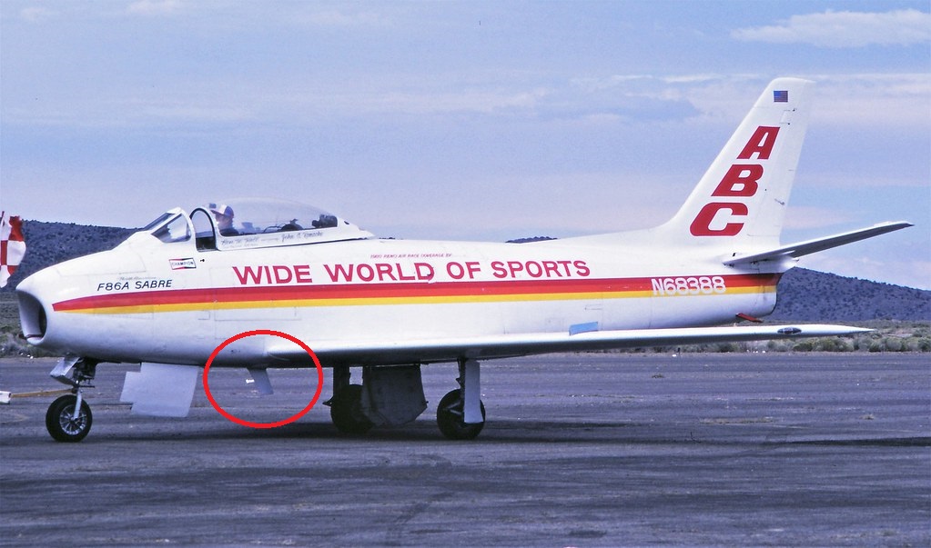

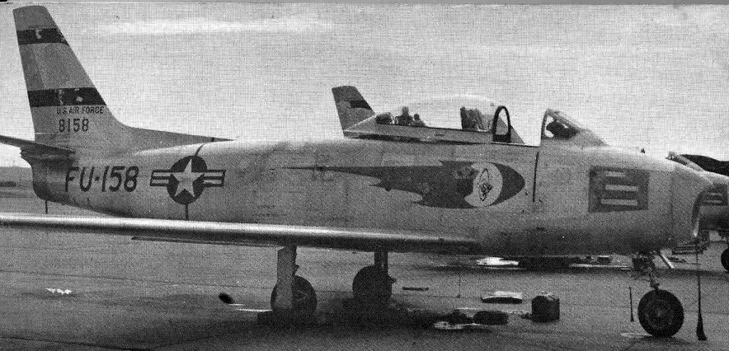

dai phan Posted January 9 Share Posted January 9 (edited) Hi all, Besides the wing fences, a vertical bottom antenna will need to be added to. Dai Edited January 9 by dai phan Quote Link to post Share on other sites
Sabrejet Posted January 9 Author Share Posted January 9 If you go into detail on this then you'll need to dig into the references: all wheel wells were white, as were the speed brake wells. The cockpit was also mainly white and this aircraft carried a second seat for a time too. Quote Link to post Share on other sites
dai phan Posted January 10 Share Posted January 10 4 hours ago, Sabrejet said: If you go into detail on this then you'll need to dig into the references: all wheel wells were white, as were the speed brake wells. The cockpit was also mainly white and this aircraft carried a second seat for a time too. I am not that OCD but I want to make sure the wing is correct. Dai Quote Link to post Share on other sites

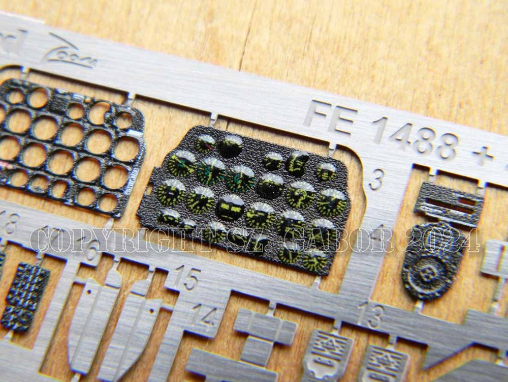

Scooby Posted January 10 Share Posted January 10 On 12/25/2024 at 8:00 AM, ya-gabor said: As mentioned before the radioactive „glowing” paint used for instrument dials with time (decades) changes to distinct yellowish colour. While initially they were perfectly white. So for a period cockpit white dials would be needed. Here is a close up of the Edu painted instrument panel for the Clear Prop! F-86A kit in 48 th scale. It has yellow dials and that strange bulging drop of gloss over the instruments. In February next year another photoetch will be released, this time for the AirBrick Sabre. The instrument panel colours were changed to white, just as the firing handle to yellow. Have to add that on very few period images there are red firing handles can be seen just as yellow. Best wishes for Xmas to everyone around the worlds! And in hope for a peaceful new year, or should I say peace in new year? Best regards Gabor Now that I see the Eduard product, it is too yellow. Although I don’t agree it should be perfectly white, we used to repaint instruments with radium and it wasn't white when new. But it certainly wasn’t as yellow as Eduard depicts it as. Quote Link to post Share on other sites

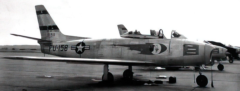

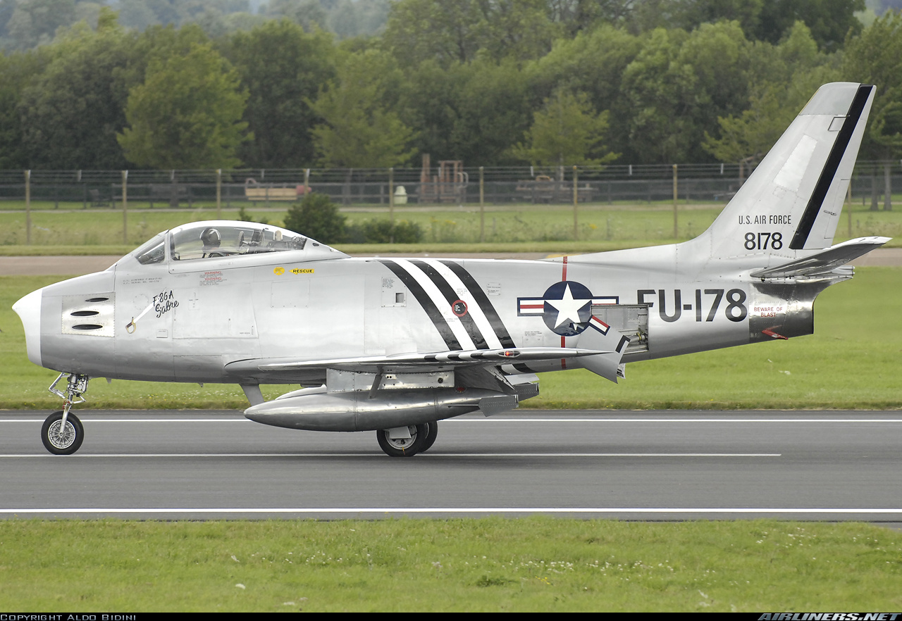

dai phan Posted January 11 Share Posted January 11 (edited) Hello all, Looking into the Ben Hall’s restoration project of the 86A revealed the white scheme one is now painted in USAF Korean scheme and in flying condition. There are many photos of this bird on the Net. As Duncan stated, it has narrow chord with slats shut and wing fences added. You can tell it is the narrow chord variant by looking at the wing’s root. The root does NOT overlap the ammo door. Without this hint it is very difficult to know which is which. 6 inches at the root for the 6-3 wing wouls be 3.175 mm in 48th scale and this small amount difference is hard to detect in 48 and harder in 72. I will let Draw Decal know to correct this information on their site as they listed this restored bird with wider chord. Dai Edited January 11 by dai phan Quote Link to post Share on other sites

dai phan Posted January 11 Share Posted January 11 On 1/9/2025 at 9:04 PM, Scooby said: Now that I see the Eduard product, it is too yellow. Although I don’t agree it should be perfectly white, we used to repaint instruments with radium and it wasn't white when new. But it certainly wasn’t as yellow as Eduard depicts it as. I wondered why on CP decals the instruments are yellow and now I know. Dai Quote Link to post Share on other sites
Snowbird3a Posted January 11 Share Posted January 11 11 hours ago, dai phan said: Hello all, Looking into the Ben Hall’s restoration project of the 86A revealed the white scheme one is now painted in USAF Korean scheme and in flying condition. There are many photos of this bird on the Net. As Duncan stated, it has narrow chord with slats shut and wing fences added. You can tell it is the narrow chord variant by looking at the wing’s root. The root does NOT overlap the ammo door. Without this hint it is very difficult to know which is which. 6 inches at the root for the 6-3 wing wouls be 3.175 mm in 48th scale and this small amount difference is hard to detect in 48 and harder in 72. I will let Draw Decal know to correct this information on their site as they listed this restored bird with wider chord. Dai I already told Draw Decal about the wing mistake, he probably will do nowt about it Tony Quote Link to post Share on other sites
dai phan Posted January 12 Share Posted January 12 1 hour ago, Snowbird3a said: I already told Draw Decal about the wing mistake, he probably will do nowt about it Tony I am so lucky Duncan points out the fact it has narrow chord rather than what Draw said. Imagine I grafted the 6-3 wings only to find out it was a total waste !!! Upon research I discover the hint of the 6-3 wing was the wing root overlaps the ammo door. That is why when the door was opened, the tip of the wing root was removed. Thank you again Curtis! Dai Quote Link to post Share on other sites

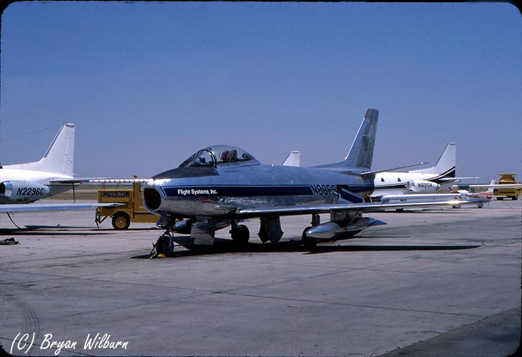

CF104 Posted January 12 Share Posted January 12 On 1/8/2025 at 7:12 PM, BWDenver said: I reviewed the threads offered and it left a few questions with the wing on N89FS and N86FS. Would both of these have the 6-3 hard wing as seen in the photos? I don’t see any evidence of slats drooping. Is N86FS an Ex RCAF bird or German??? Yes, it's ex RCAF with a 6-3 hard wing. Here's more information. https://www.aerialvisuals.ca/AirframeDossier.php?Serial=17006 Quote Link to post Share on other sites
dai phan Posted January 12 Share Posted January 12 5 hours ago, CF104 said: Yes, it's ex RCAF with a 6-3 hard wing. Here's more information. https://www.aerialvisuals.ca/AirframeDossier.php?Serial=17006 Looks like 6-3 as the wing root overlaps the ammo door. Dai Quote Link to post Share on other sites

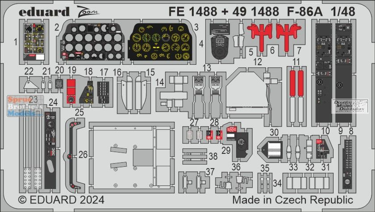

dai phan Posted January 21 Share Posted January 21 (edited) Hi all, I have used this Eduard FE 1488 for my second 86 and I found out the side console PE are oversized in width (parts 9,10,24) making the fit of the seat impossible. I had to trim the sides of the seat to make it fit. Sanding or cutting the PE parts will not work as you will delaminate the printing. I would avoid this set and use Kelik, Quinta or Eduard Space as you can trim the sides if needed. Dai Edited January 21 by dai phan Quote Link to post Share on other sites

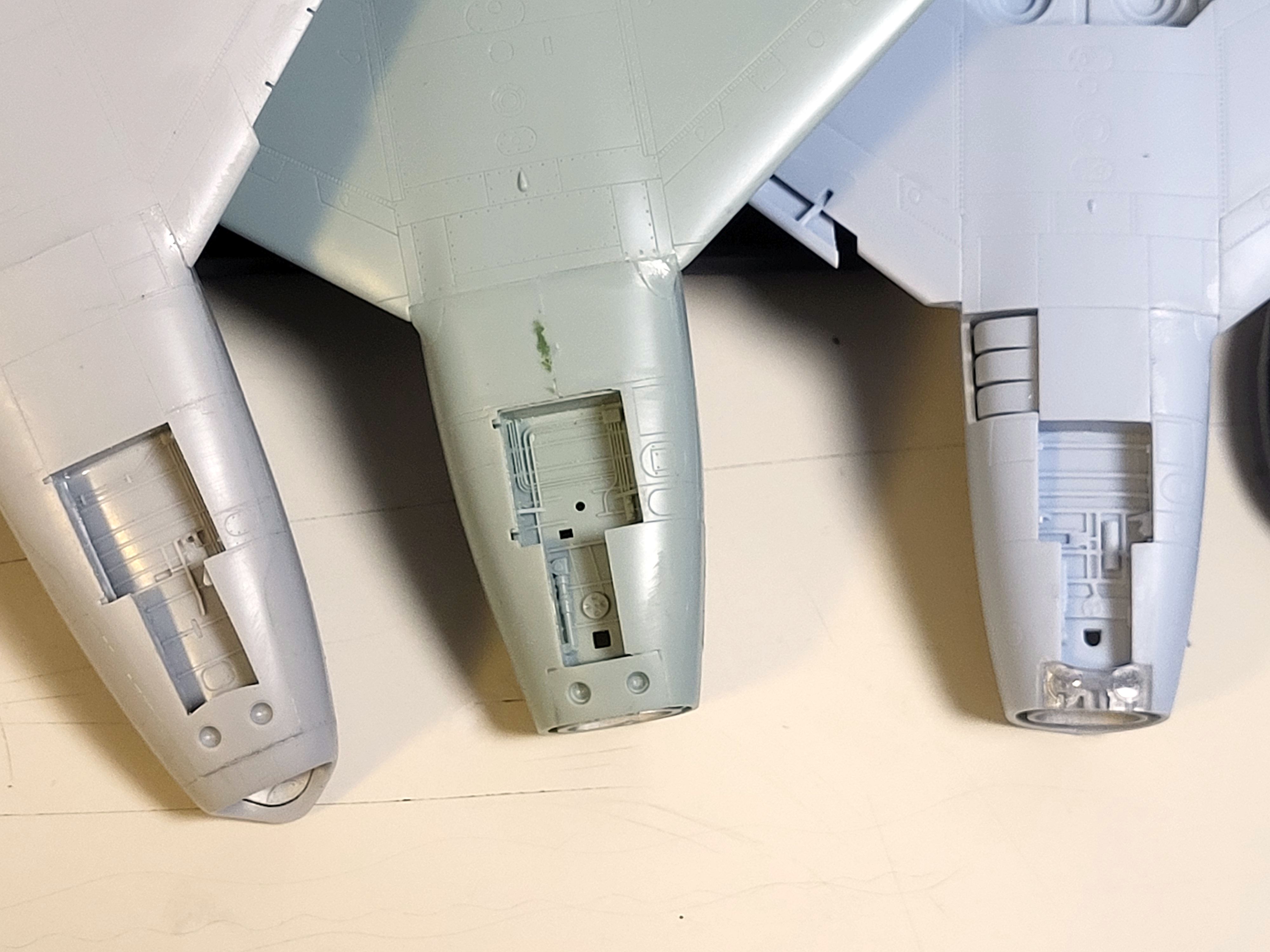

anj4de Posted February 16 Share Posted February 16 (edited) Hello all I received my CP Sabre from them a good week ago. I started the build right away. So far a very mixed bag of fleas. Very fine detail combined with sometimes terrible fit issues and a part break down that makes you wonder which devil did ride the designer. Now..by reading here, I learned that they use low presure molding but is this really the reson for parts demarcation running wildly throuh the panels? The front and rear fuselage buttoms are the worst! Now...I got the basic bird together but I will have to do a lot of re-scribing and riveting. I wonder if the molds start wearing out already, the fit reminded my a lot on a Revell Tomcat that I got recently for fee, a very late release made from a totally worn out 40+ years old Monogram mold and removed from the injection machine too early. It requiers pysical strengh and a lot of CA to get the parts together. thanks Uwe PS: The front wheel well is wrong just like on almost any other kit...only Acydemy got it sort of right! CP on the left... Edited February 16 by anj4de Quote Link to post Share on other sites

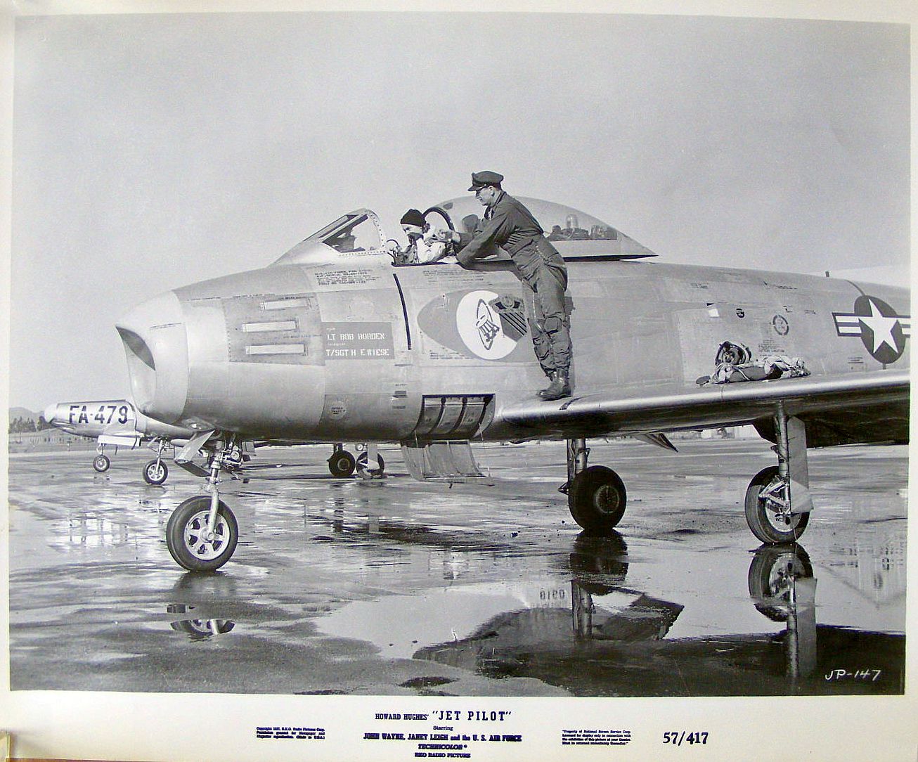

anj4de Posted February 16 Share Posted February 16 PS: Here are pictures of the bird i want to do...A for Anna calling S for Shannon... 😉 Quote Link to post Share on other sites
BWDenver Posted February 17 Share Posted February 17 Jet Pilot is one of those films that is best viewed with the sound off... Quote Link to post Share on other sites
