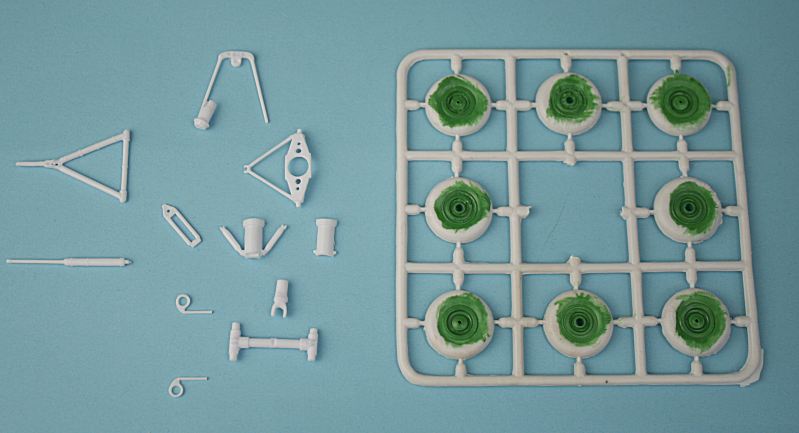

Flankerman Posted May 23, 2010 Author Share Posted May 23, 2010 (edited) The rear wheelbay 'box' is done....... The 'arch' at the bottom holds the mounting axle of the undercarriage 'truck' - and it should be possible to slide the arch (and wheels) in place at the end... Looking up into the well - Amodel have done a good job detailing it - superdetailers could go to town, but not much will be seen with the truck and wheels in place .... All I have to do now is make the fuselage opening bigger - so I can slot it in - then make good the hole!!! The parts for the rear undercarriage - every one of which had to be cleaned up. The axles are not very substantial - they need to be strengthened. Some of the wheel hubs are also not very well moulded - fortunately it's on the inside facing hubs. Edited May 23, 2010 by Flankerman Quote Link to post Share on other sites
