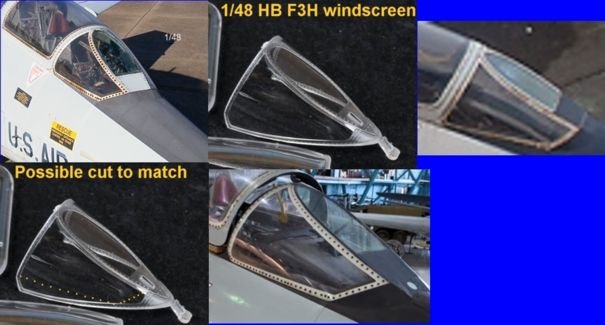

VADM Fangschleister Posted August 11, 2018 Share Posted August 11, 2018 (edited) I blurbed about this on the Monogram vs. KH thread but it got little interest. The HB F3H kit has a windscreen that looks suitable, with a little filing, to possibly make a nice F-101B windscreen. However, not having either kit to compare sizes and curvature, it may be a moot point. If anyone has both kits, maybe they can compare. It may also be possible to use an F-4E windscreen. Hasegawa has kits where the closed and open sets are both included...On first glance, the windscreen looks like a good candidate. Just a thought. Edited August 11, 2018 by VADM Fangschleister Quote Link to post Share on other sites

Nikolay Polyakov Posted August 11, 2018 Share Posted August 11, 2018 17 hours ago, VADM Fangschleister said: It may also be possible to use an F-4E windscreen. The Phantom’s windscreen had a very similar design, but I think it’s a bit narrower. Yes, it’s the first thing that come on mind... Thanks! Quote Link to post Share on other sites
skyhawk174 Posted August 11, 2018 Share Posted August 11, 2018 (edited) 20 hours ago, VADM Fangschleister said: I blurbed about this on the Monogram vs. KH thread but it got little interest. The HB F3H kit has a windscreen that looks suitable, with a little filing, to possibly make a nice F-101B windscreen. However, not having either kit to compare sizes and curvature, it may be a moot point. If anyone has both kits, maybe they can compare. It may also be possible to use an F-4E windscreen. Hasegawa has kits where the closed and open sets are both included...On first glance, the windscreen looks like a good candidate. Just a thought. I have the F3H kit and personally I think it is too long and too high to use as a substitute. I am surprised no one has come up with a replacement as of yet considering how long the KH F-101A has been out. Maybe there is no interest in an update as yet? I wish Quickboost will issue the new intake for the starboard side and maybe a few other things like antennas. I know they have done this before for other kits so there is hope. Now with soon to be more versions of the Voodoo available they will do something? I seem to recall that there is a tab to suggest subjects on their web site so I will try there. Edited August 11, 2018 by skyhawk174 Quote Link to post Share on other sites
