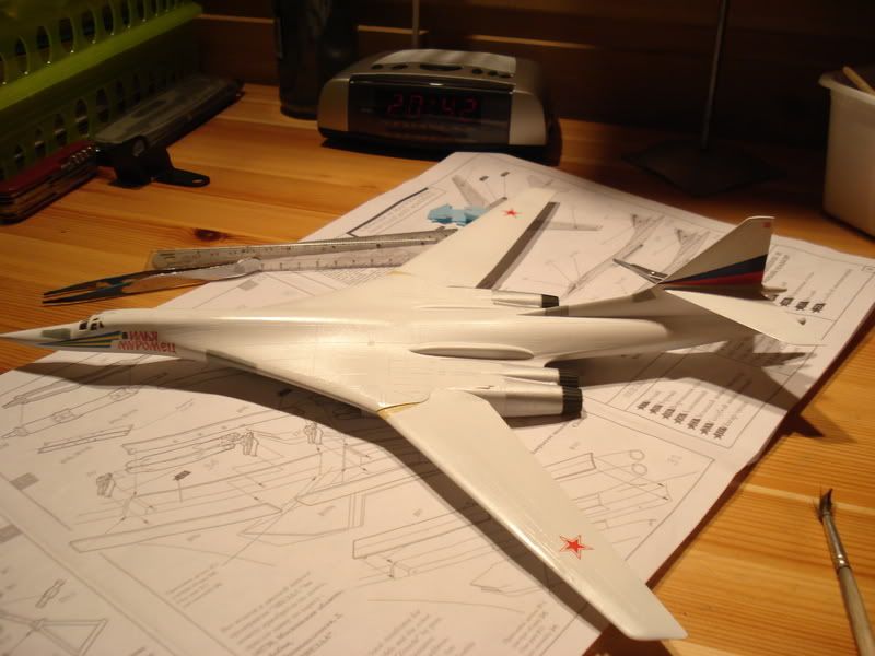

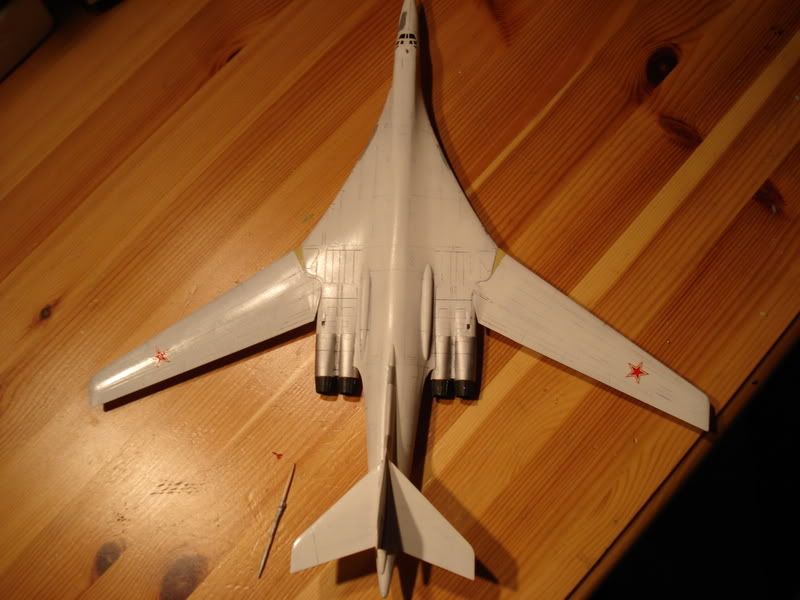

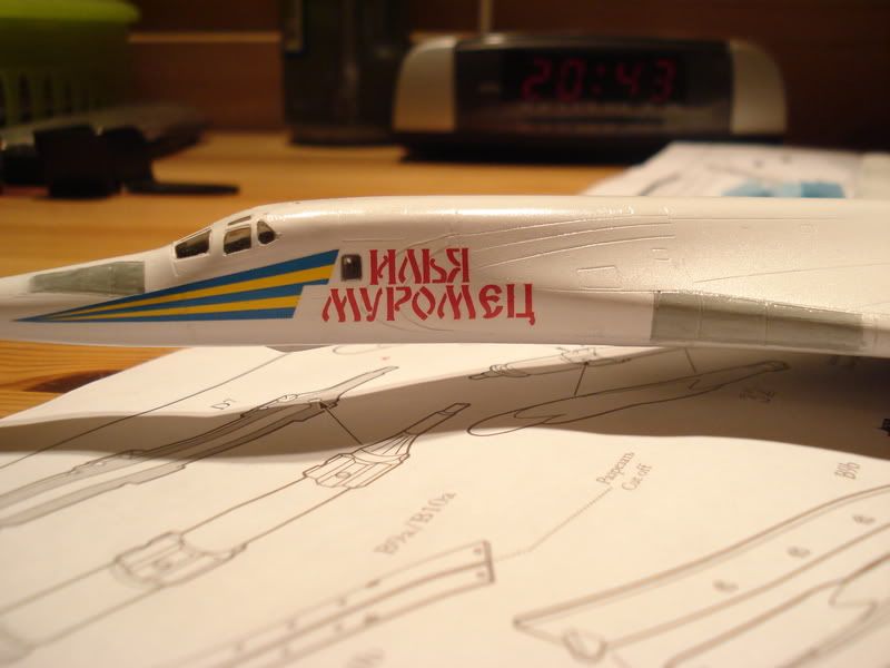

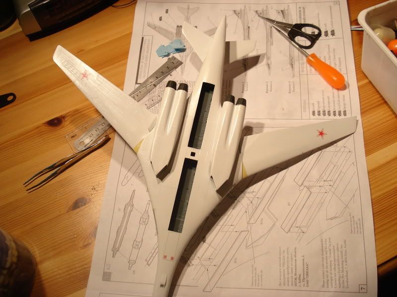

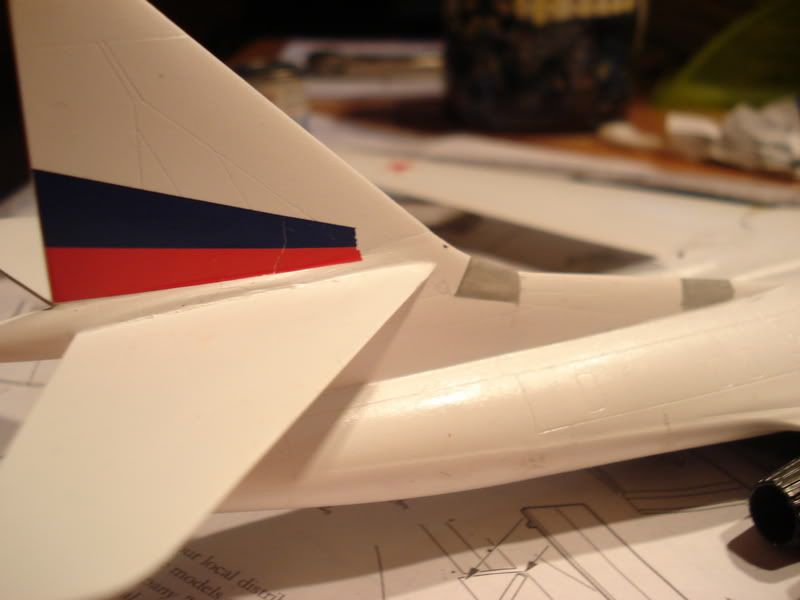

Berkut Posted April 3, 2007 Share Posted April 3, 2007 (edited) Hi, am 16 years old boy from Norway. (i live in Norway, but I am from Russia.) Currently I am building Zvezda Tu 160 (1/144) But one of my decals broke, could someone help me out? More info here: http://www.arcforums.com/forums/air/index....howtopic=116784 Here are some photos of my model: Here is my problem: I have not weathered the plane yet, because I am not finish with decals. This is my 5 model. Any comments? PS: More here: http://www.ipmsnorge.org/forum/index.php?topic=2414.0 Edited April 3, 2007 by Berkut Quote Link to post Share on other sites
AnthonyWan Posted April 3, 2007 Share Posted April 3, 2007 (edited) Well what a coincidence, I am 16 too You definitely did a great job on the Tu-160 , let me take a look at that link you have, and i'll see if i can help EDIT: Your problem should not be very hard to fix if you have the section of decal that is ripped from the flag. If you do, soak it in water, and then apply a nice puddle of water to the decal already there, you should be able to align the broken-off section without much difficulty. After this, gently use a soft paper towel to soak up any excess water, then apply a decal setting solution of your choice (I recommend Microscale Micro Sol) and you should be fine. If there is small mismatch, wait until decal is completely dry, then use a small brush and a bit of paint to touch up. HTH man Edited April 3, 2007 by AnthonyWan Quote Link to post Share on other sites
Berkut Posted April 3, 2007 Author Share Posted April 3, 2007 (edited) Well what a coincidence, I am 16 too ;)You definitely did a great job on the Tu-160 , let me take a look at that link you have, and i'll see if i can help Cool, I was thinking that it is only people here that is older 50 years... No, that will not work... It is because that decal bit is on Tamya tape... My plan B is to paint whole thing. Edited April 3, 2007 by Berkut Quote Link to post Share on other sites
AnthonyWan Posted April 3, 2007 Share Posted April 3, 2007 Cool, I was thinking that it is only people here that is older 50 years... :lol: No, that will not work... It is because that decal bit is on Tamya tape... My plan B is to paint whole thing. Hmm...you dont have to paint the whole thing. Just after you apply the clear coat over the decals, use some really low tack tape (like tamiya or possibly 'drafting tape') to mask. Then spray. You should be able to get a nice replacement. Quote Link to post Share on other sites
Berkut Posted April 3, 2007 Author Share Posted April 3, 2007 (edited) Hmm...you dont have to paint the whole thing. Just after you apply the clear coat over the decals, use some really low tack tape (like tamiya or possibly 'drafting tape') to mask. Then spray. You should be able to get a nice replacement. Yes, I could also do that. But I think it will look better if I spray whole thing. PS: I forgot to mention something. As you can see, plane have no wheels. My model will be "in flight". Edited April 3, 2007 by Berkut Quote Link to post Share on other sites

loftycomfort Posted April 3, 2007 Share Posted April 3, 2007 Hmm...you dont have to paint the whole thing. Just after you apply the clear coat over the decals, use some really low tack tape (like tamiya or possibly 'drafting tape') to mask. Then spray. You should be able to get a nice replacement. You can also use 3M Post-It notes as mask. It's very low tack and should work nicely. I hope this helps. Terry Quote Link to post Share on other sites
Backfire Posted April 3, 2007 Share Posted April 3, 2007 Very nice work on your Tu-160, Berkut! I built this same kit last year, as part of the Heavies Group Build, and I really enjoyed it. I built the "Ilya Muromets" version also, so I don't have the decals to spare Link to Build... The in-flight version you are doing will look really sharp. One question, did you trim off the white portion of the decals on the tail? Keep up the great work! Keith Quote Link to post Share on other sites

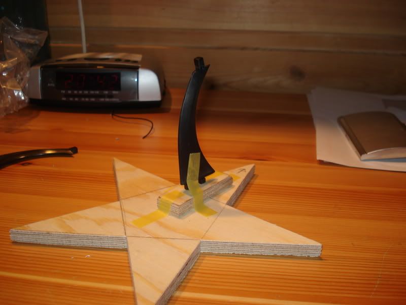

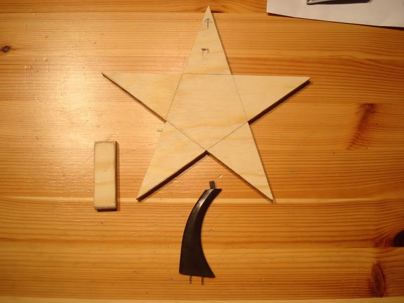

Berkut Posted April 4, 2007 Author Share Posted April 4, 2007 (edited) Very nice work on your Tu-160, Berkut! I built this same kit last year, as part of the Heavies Group Build, and I really enjoyed it. I built the "Ilya Muromets" version also, so I don't have the decals to spare Link to Build...The in-flight version you are doing will look really sharp. One question, did you trim off the white portion of the decals on the tail? Keep up the great work! Keith Yes I know about you build. I used it as insipiration. Very very nice model! :) Yes I did cut the white section away. That white section was actully wellow. I tried that "sun light" thing, it did not work. So I cutted it away. This is where my model will stand on: Edited April 4, 2007 by Berkut Quote Link to post Share on other sites
madmike Posted April 4, 2007 Share Posted April 4, 2007 Cool, I was thinking that it is only people here that is older 50 years... :) No, that will not work... It is because that decal bit is on Tamya tape... My plan B is to paint whole thing. Not all of us, I am just over 40 :P Welcome to ARC and that is a fine model you are building, nice work. Both my sons are into Warhammer 40K and Fantasy, not planes which is more the pity. I see the issue with the broken decal. Instead of removing the whole decal and repainting the whole thing, overcoat the decal in clear gloss or your equivalent of Johnsons Future. Let thoroughly dry and then mask the missing section with Tamiya tape and paint the stripes. You should be able to match the red easily enough. :) MikeJ Quote Link to post Share on other sites

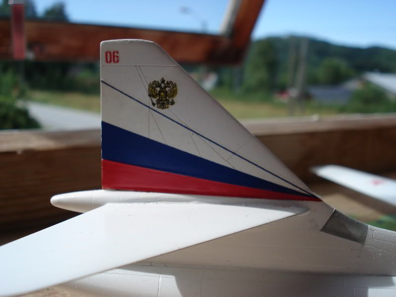

Berkut Posted July 13, 2007 Author Share Posted July 13, 2007 guess what?!!?! Kotey was so kind, he send me TWO decal sheets. Here is the new decal on the fin: I am going freaking bannana.... Quote Link to post Share on other sites

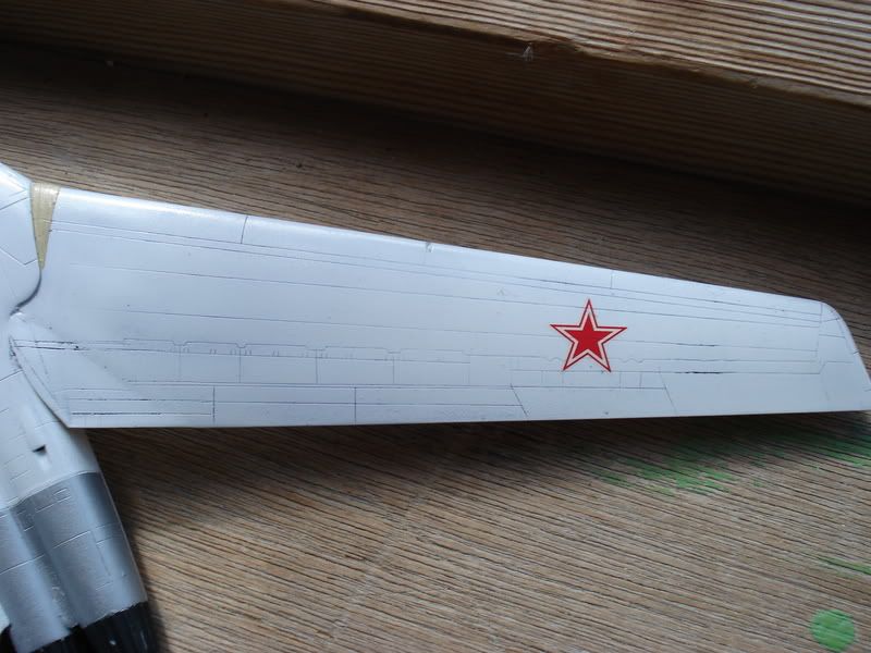

Berkut Posted July 20, 2007 Author Share Posted July 20, 2007 Weathering done on one of the wings. Quote Link to post Share on other sites

Lock n' Load Posted August 15, 2007 Share Posted August 15, 2007 Hey there! I'm also 16 (We should make a groupbuild for youngsters :D I'm building my 30th+ model.. F-18E (and still waiting for my AfterMarket Decal set to come from the U.S XD) You problem seems to be easy to fix! It has happened to me too, it gets a bit difficult when you have the colors,but not the correct tone,you can always use your good friends Black and White to make a closer match. I like the model overall! Looks very clean! Good luck with your decal problem! Quote Link to post Share on other sites
Su-34 Posted August 15, 2007 Share Posted August 15, 2007 And im only 13! I havent noticed the stand, until now, what can i say? Its just awesome! Great job on it!! And the rest of the Tu-160 is looking great! I cant wait to see her finished! Quote Link to post Share on other sites
